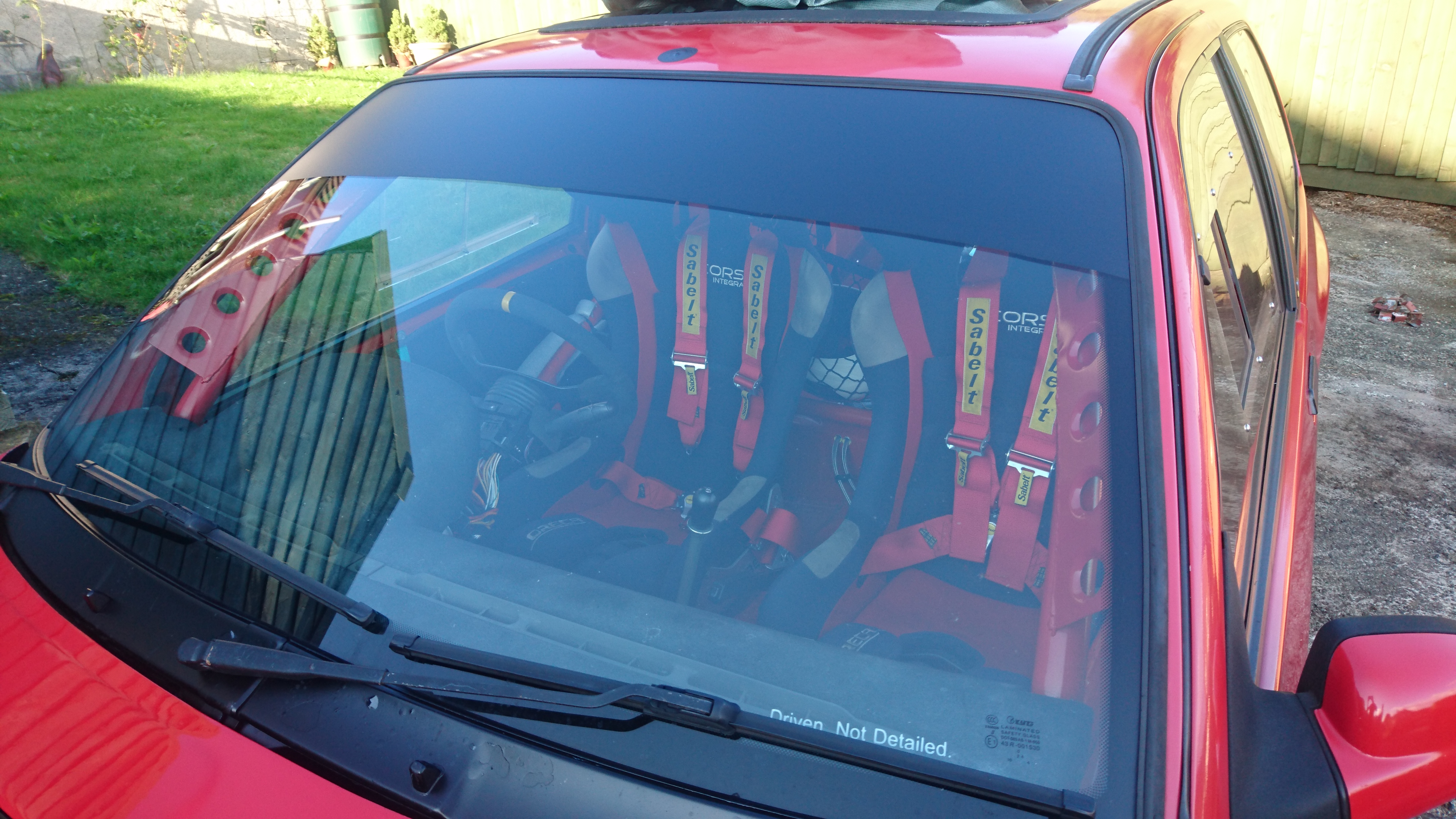

07-09-2017 Sunstrip Fitting
Popped over to @dann2707 place to fit new sunstrip, not the most exciting addition but looks much better than the awful attempt I made last time!

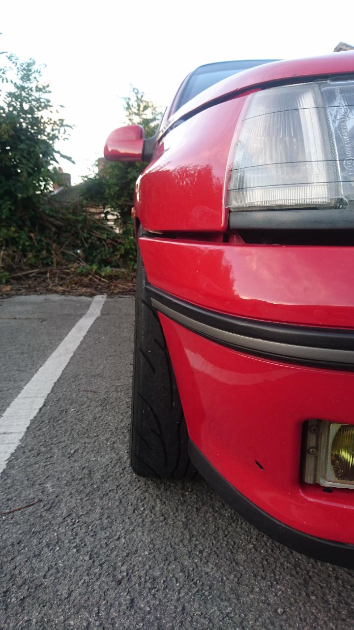

14-09-2017 Spacers on front Axle

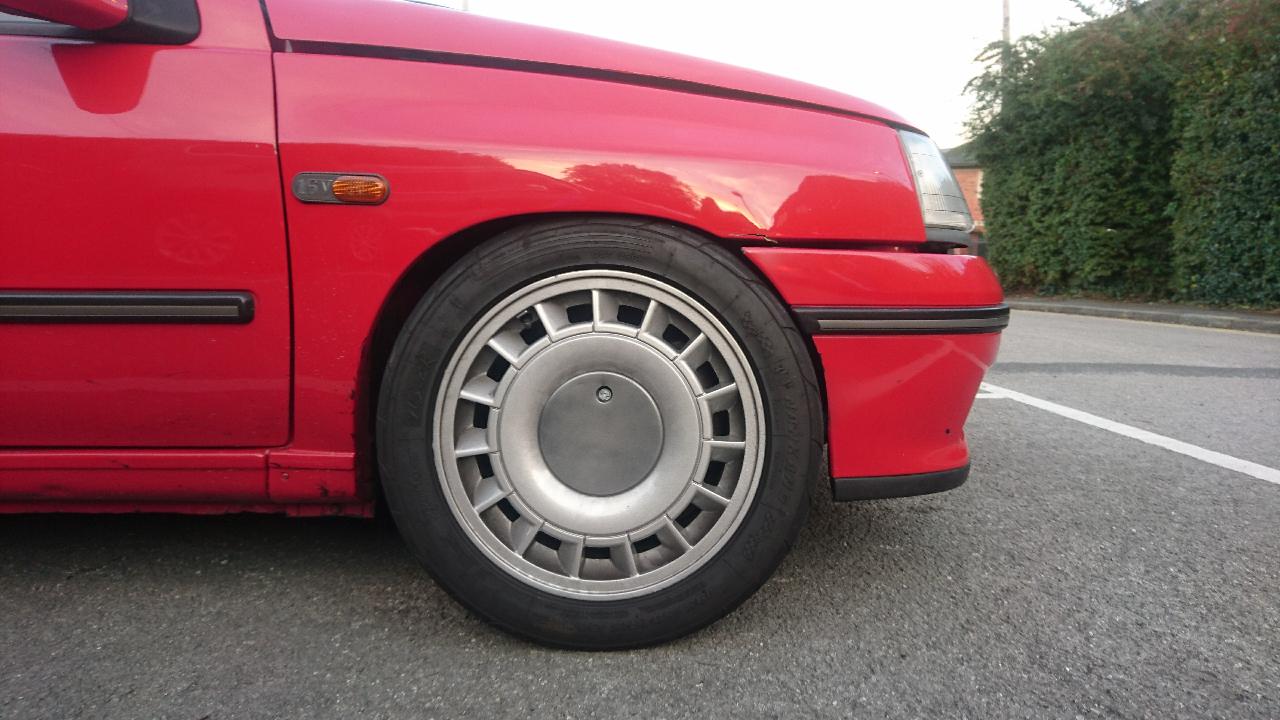

I wanted to get my stud and nut conversion onto the front axle as well having being running it on the rear for months. However the issue was to run the setup I either needed to buy smaller studs or run spacers. Man maths said spacer time!!!

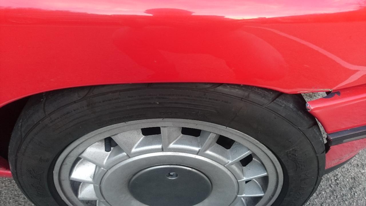

So fitted the studs, slapped on some 15mm spacers and then had to dremel the arches down to get the things to fit as the front track is now wiiiiiiide!
reason I needed to do this was the Speedline Maracanã wheels have centre caps that cover the wheel bolts, and the studs as they were would be too long to get the cap on. And I have to run these wheels as I like the fact the car has its sort of original look from the outside.....ish!lol!!!

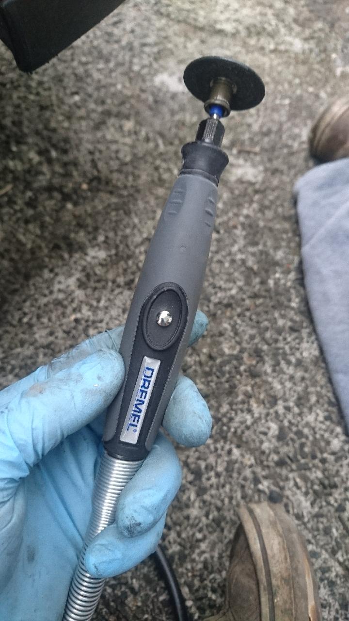

anyway, pics, arch with the lip, the fronts are plastic like the mk2 so easy to cut down
the tool for the job
and all fitted, they are very close and catch on manoeuvring on uneven ground or full lock, but the car feels incredible now, I stiffened the front shocks to 13/19 so can go stiffer but works for road and I can stiffen fully on track.
I will also more than likely remove the front spacers when running track wheels as they are 7J and the slicks are more like 205 equivalent so suspect rubbing with the spacers on may be more of an issue.
anyway (again!) pics!
and had a spin out with @dann2707 to test the setup, seemed decent enough and he grinned a bit :)

no idea how much wider than standard this setup now is, but i'm only just getting away with standard arches. which I don't want to change, want to keep the silhouette of the car as standard ish as possible.

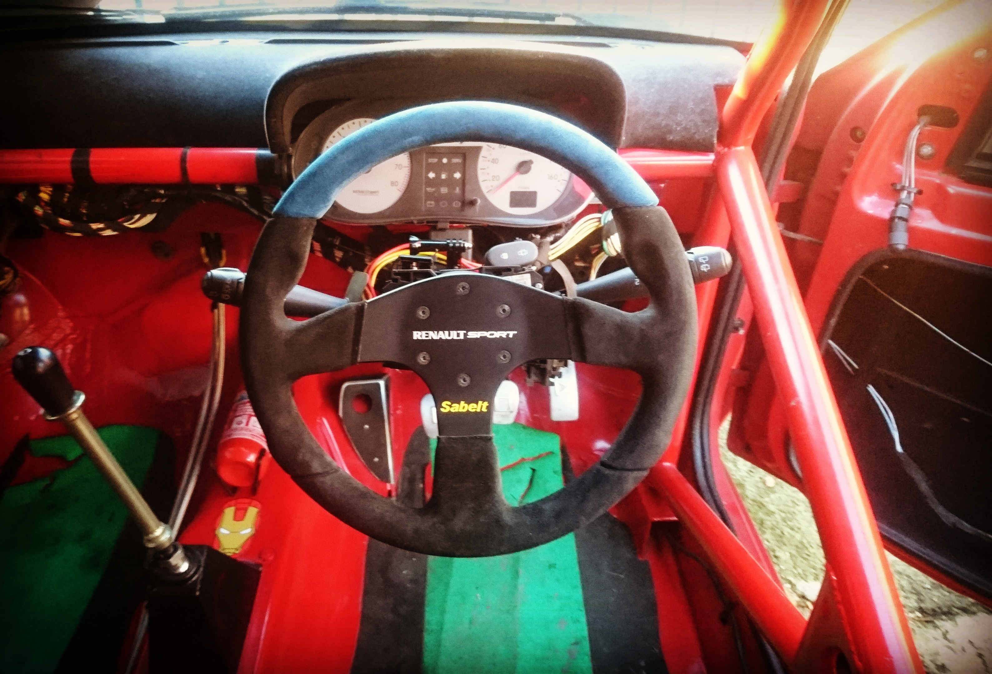

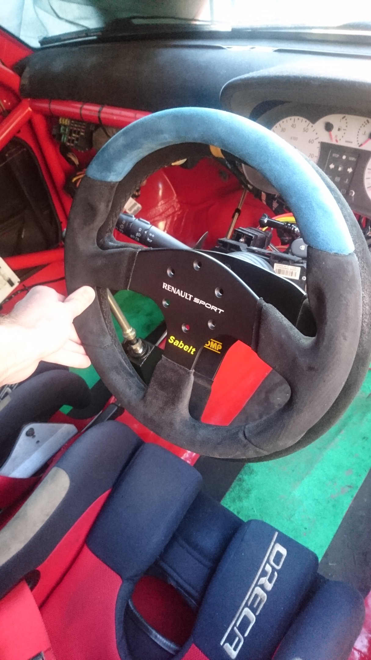

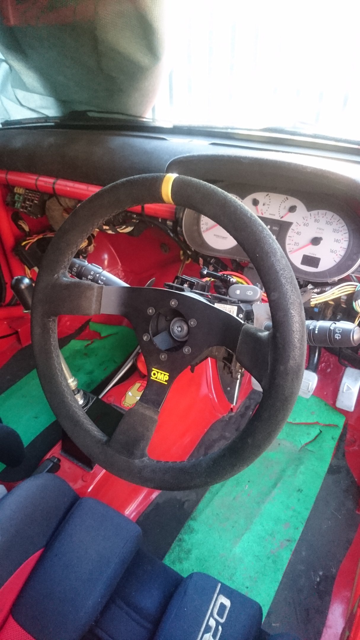

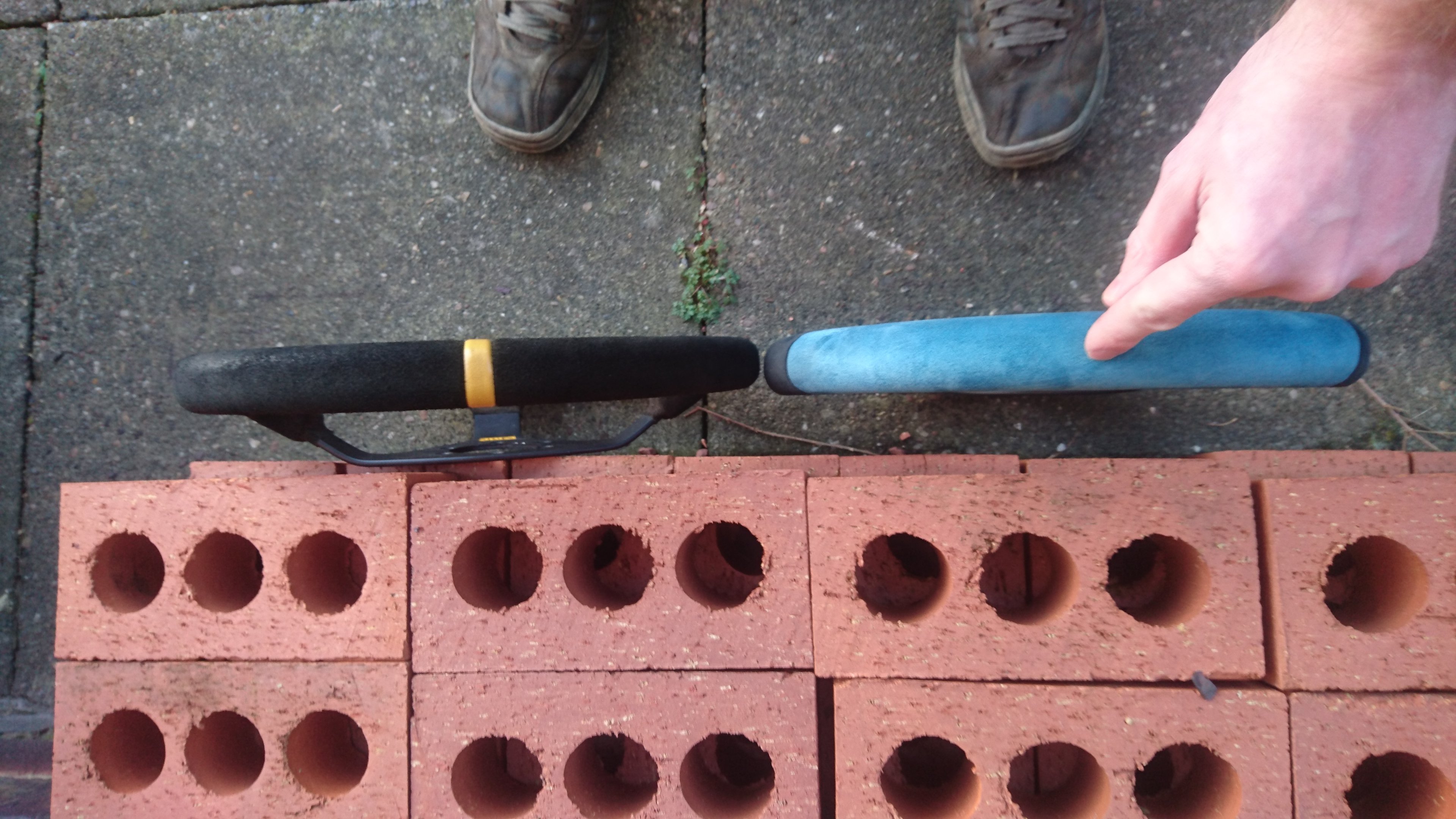

7-1-2018 New Wheel

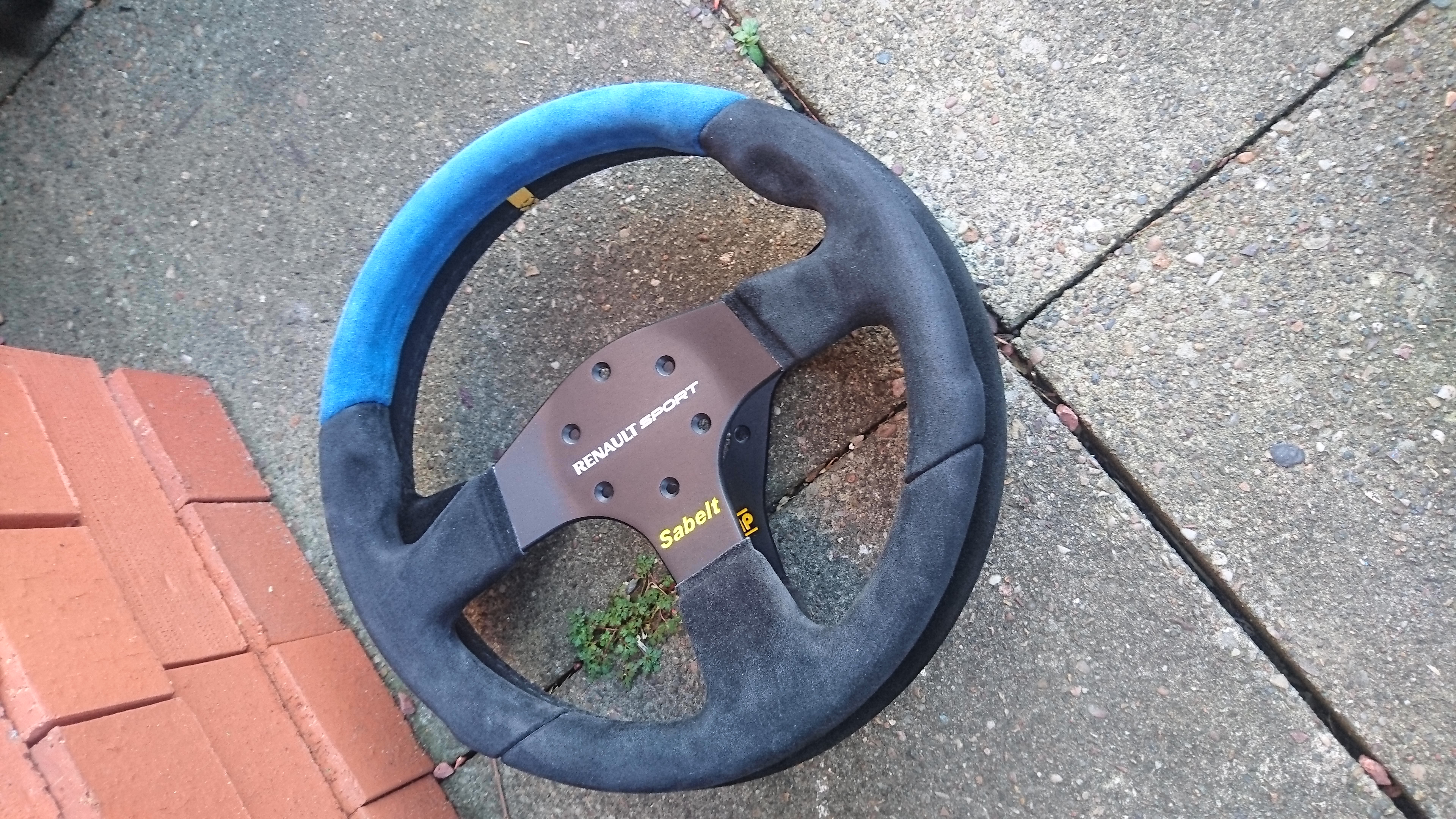

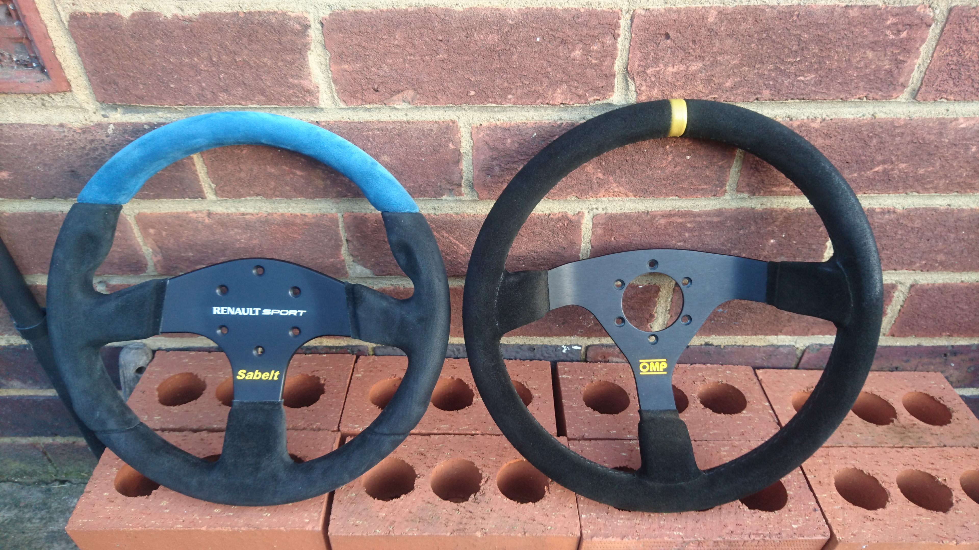

Purchased a sabelt wheel, 330mm instead of 350mm and flat rather than dished.
This means my arms sit better on the wheel from the seating position
Yet to drive the car with it but position definitely feels better.
Pics!
Old dished 350mm omp item
New sabelt held up in position
Side by side off the car
Overlayed, can just about see size difference, although difficult due to wide angle lens on the camera
And dish comparison

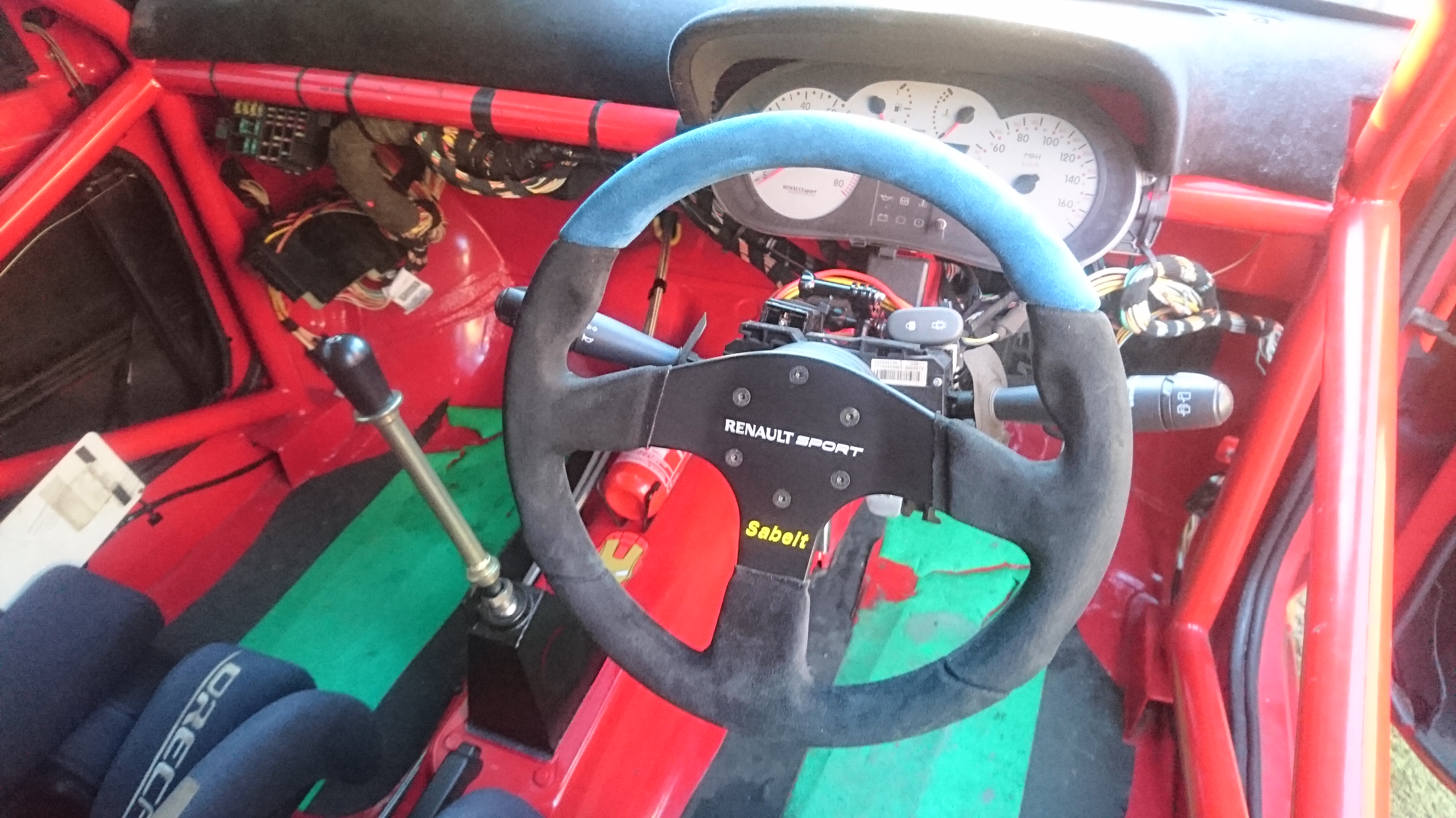

And finally, all fitted! Chuffed with it tbh although will have to get some gloves to attempt to keep it in decent nick
Cheers

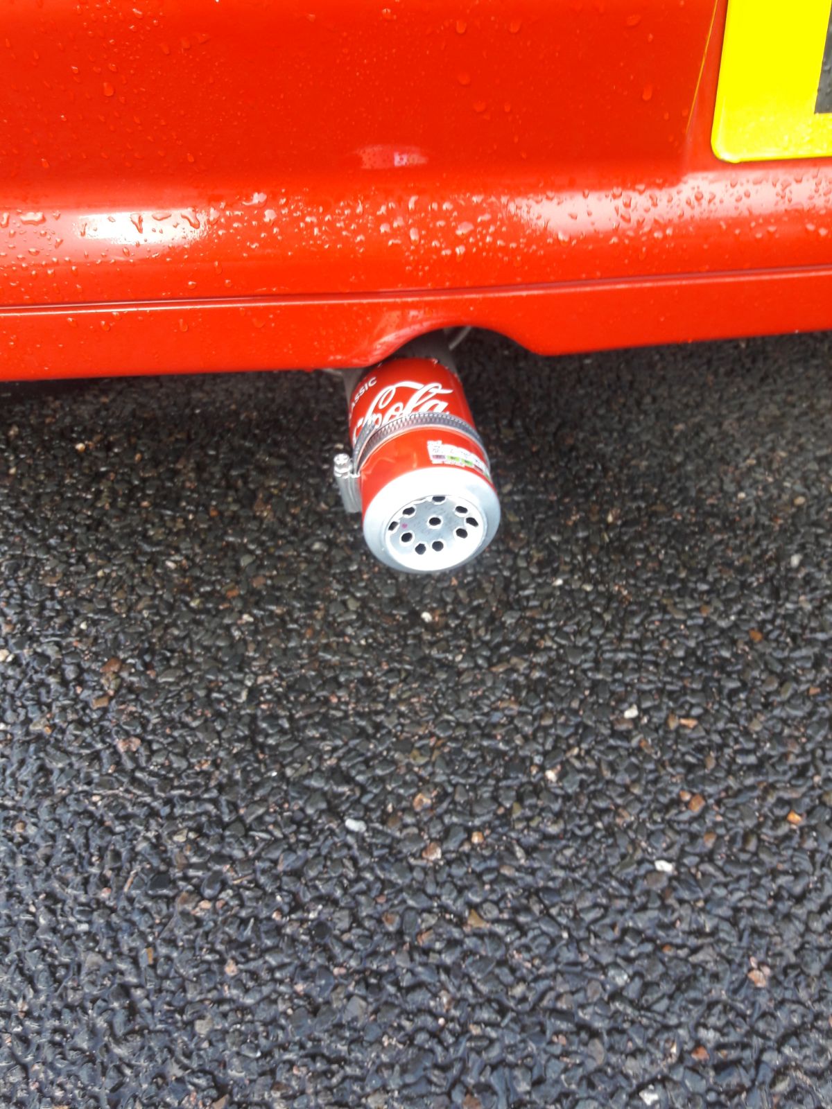

Went to Bedford for the first one of the year, had a terrible day in all honesty! Blew 97db static and spent all day on part throttle due to setting off the 4 mics trackside. 87db drive by limit is just madness, too quiet!
I'll admit the car has got louder, swear it blew 88db years back when I was last at Bedford so I presume the wadding has blown out the exhaust over the years.
Either way, part throttle all the time on the twisty sections where the mics were, which meant no heat in the slicks which meant crap time all round!
never mind, can't win them all and plenty more trackdays ahead of me!

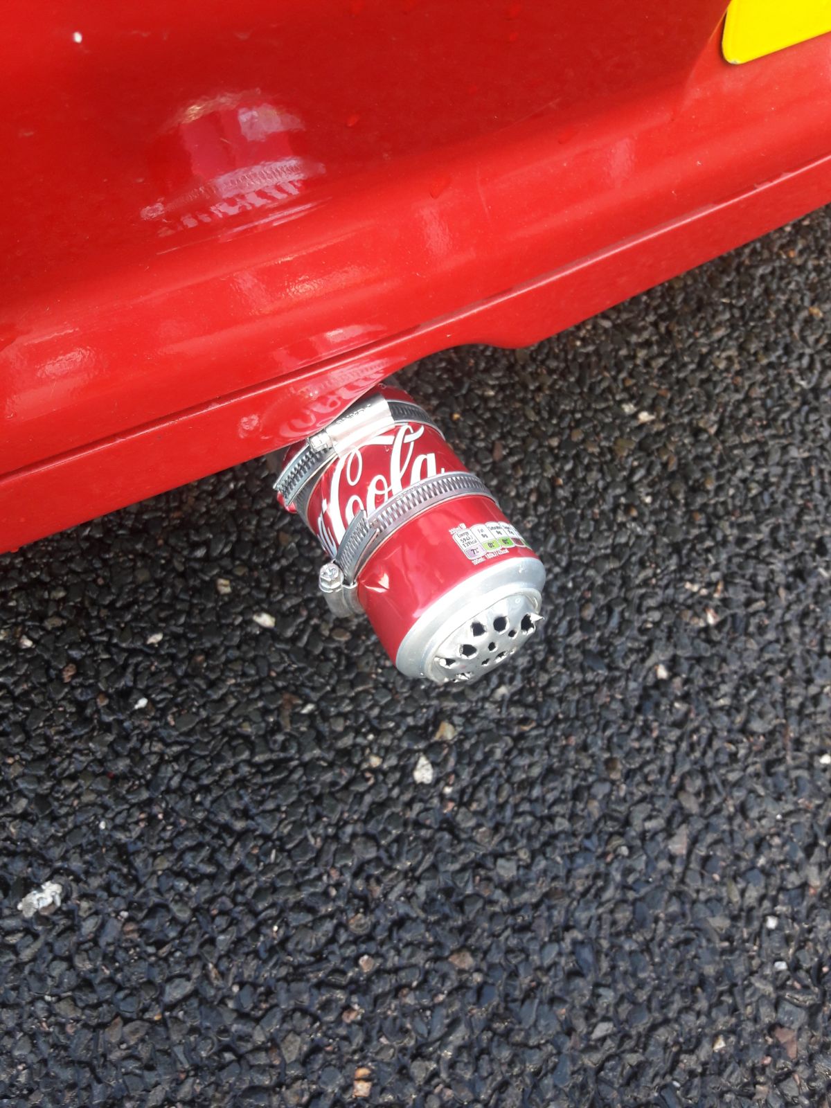

In desperation tried a coke can muffler upgrade......unwise, lost about 50% of the power then so was worse if anything, bit of a giggle though I guess!

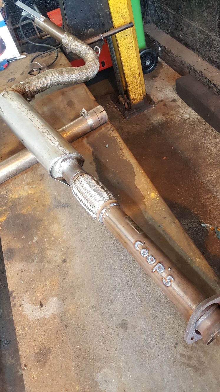

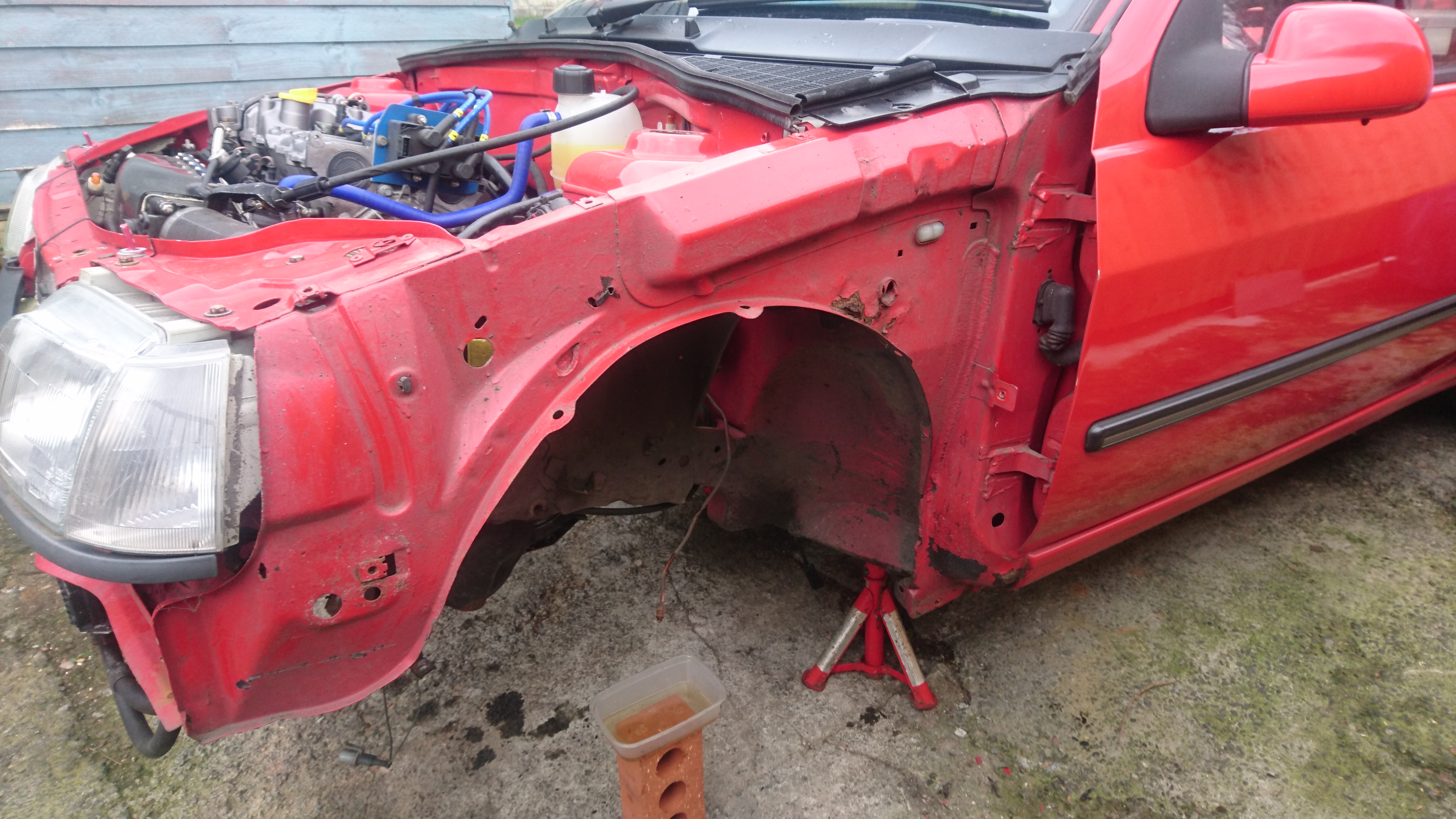

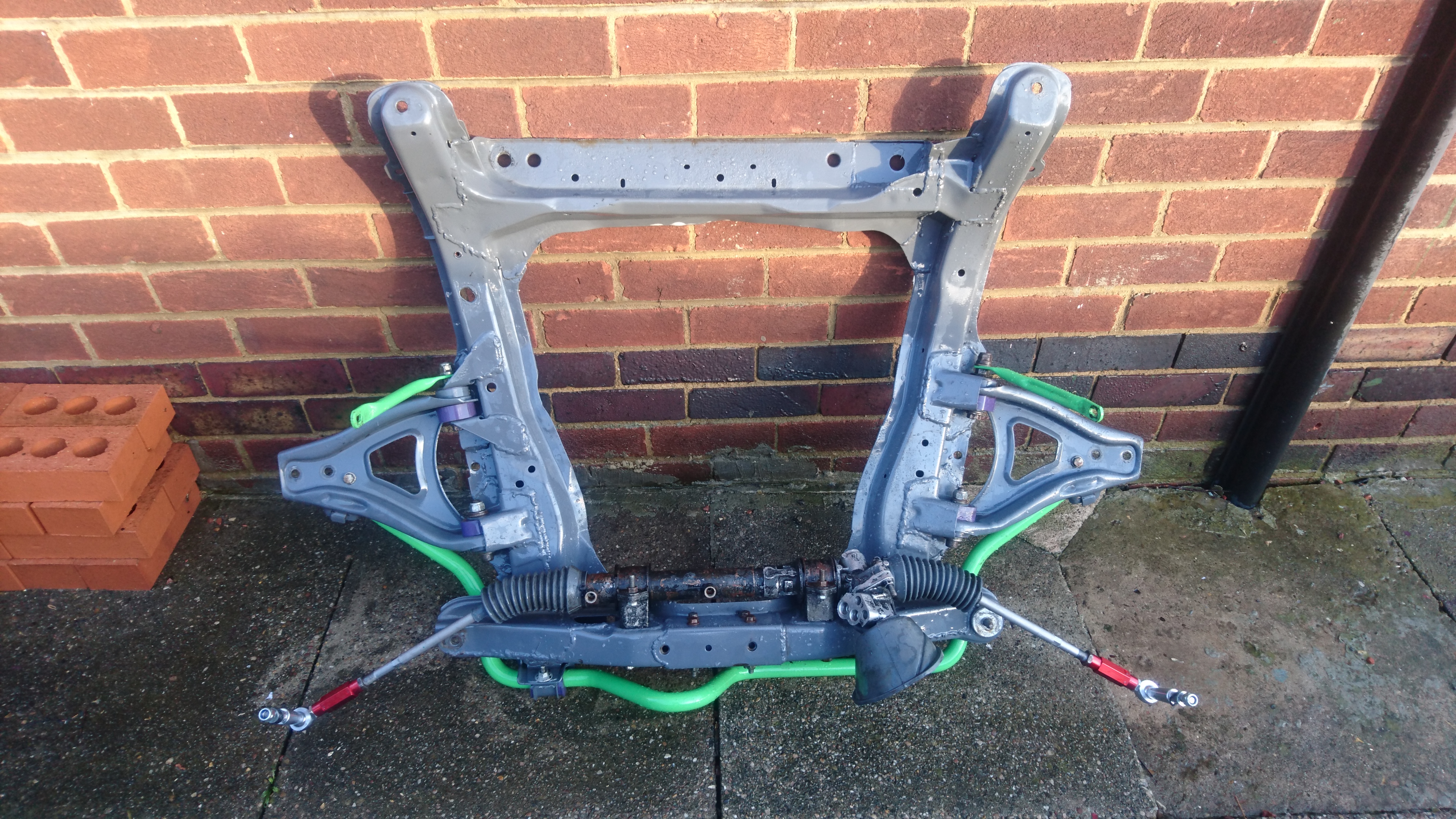

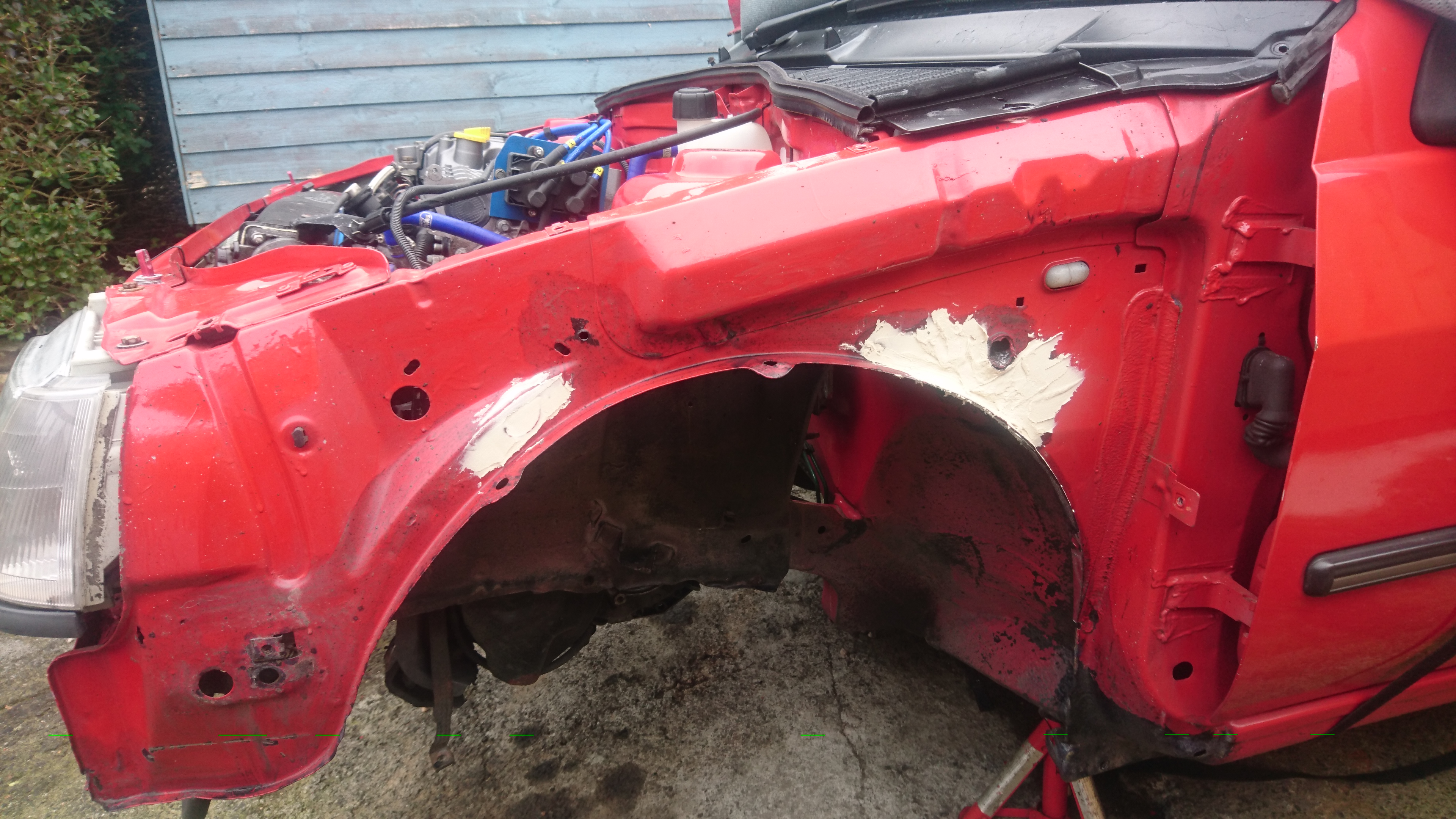

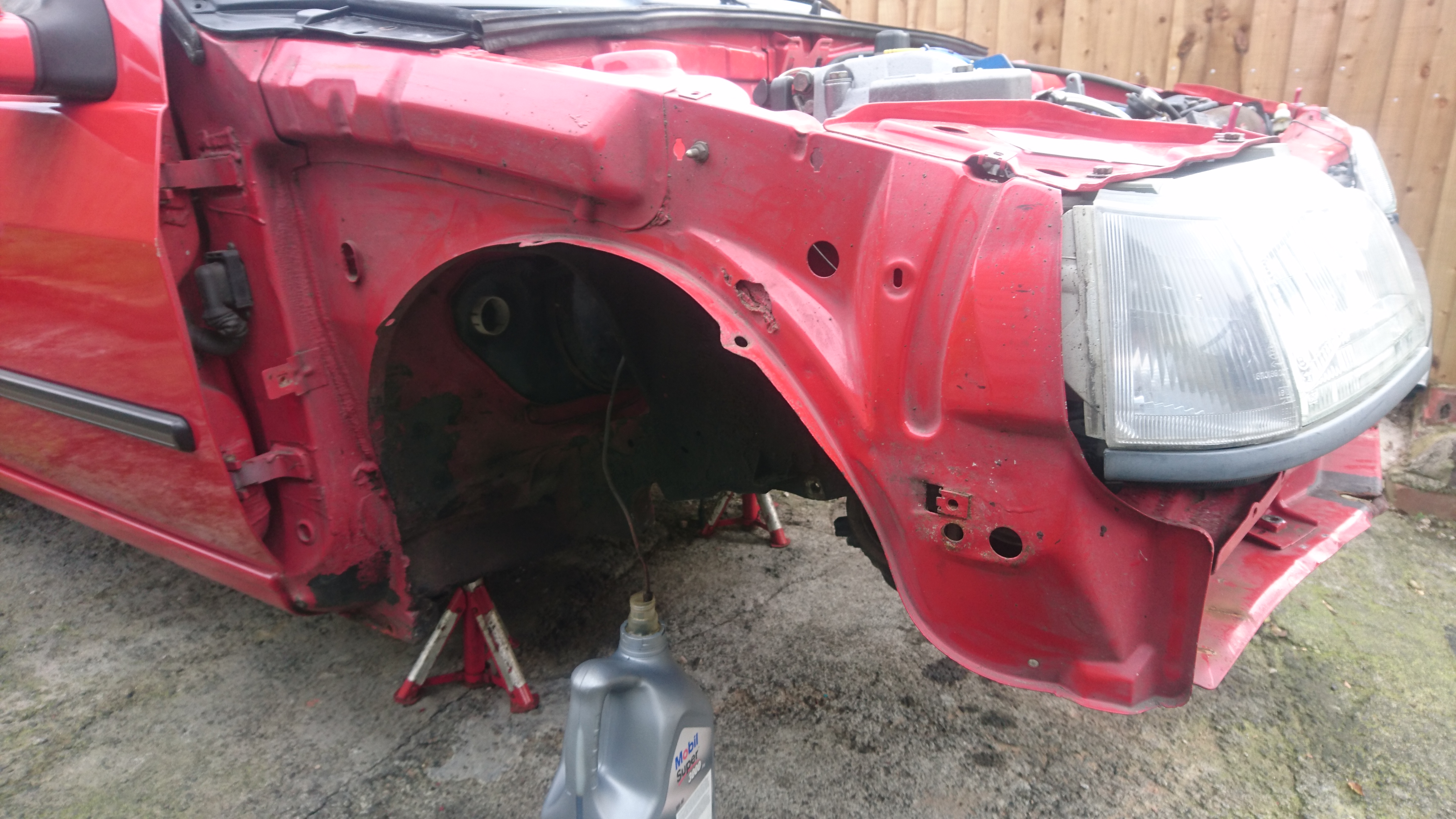

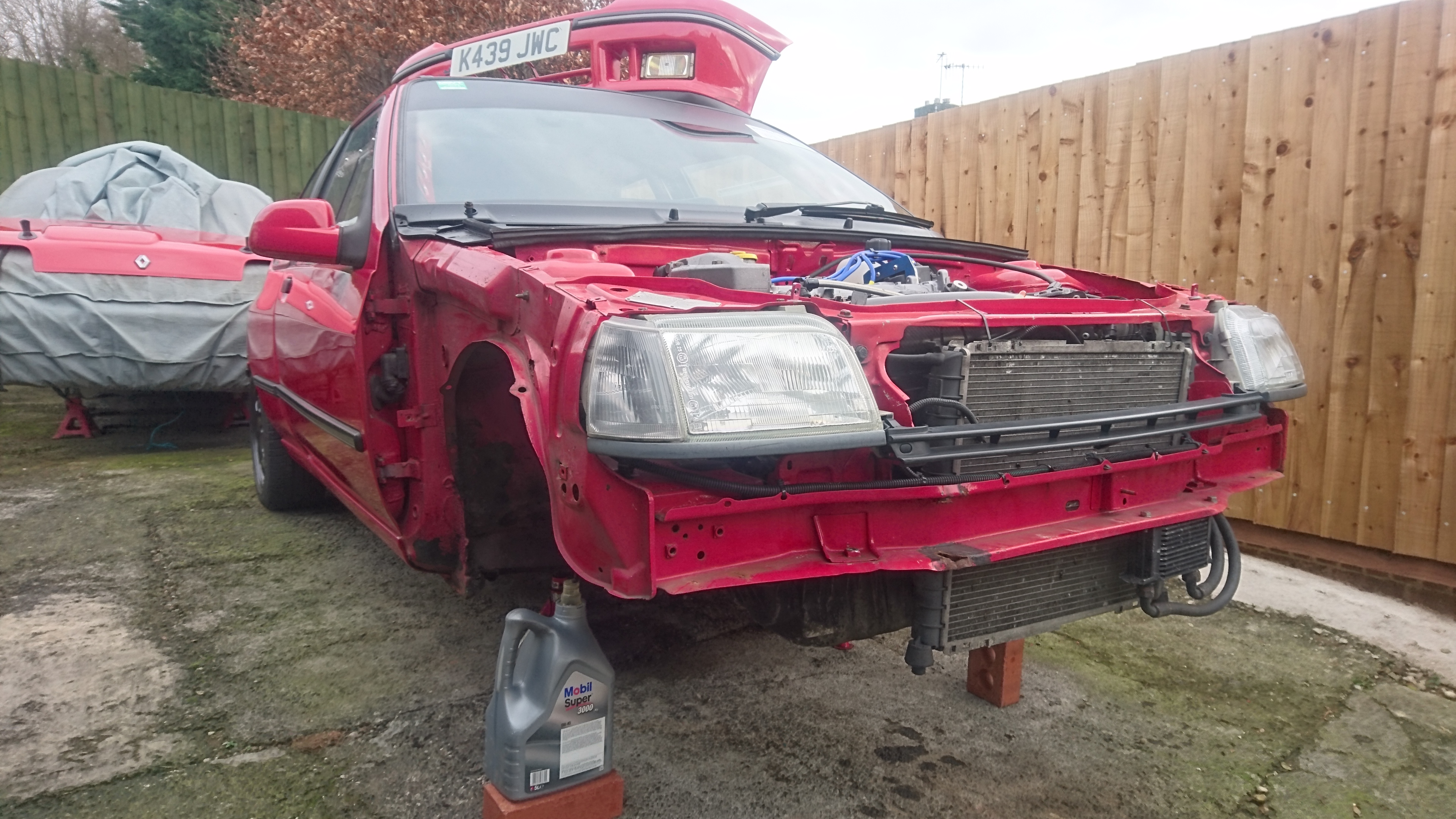

05-02-2018 - Strip Down

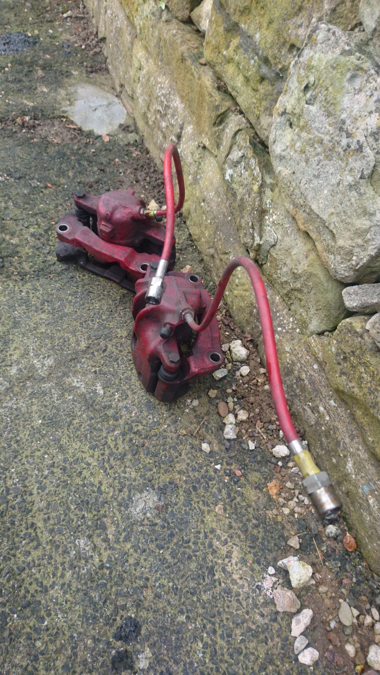

So after Bedford decided it was time to tackle the exhaust again, so fit the 182 manifold and also purchase a quieter system to connect to it
As such plan was to rip the front end of the car apart, remove the brakes and bodged up front brake lines and clean up the inner arches etc.
I also have the willwood 4-pots to fit when it all goes back together again!

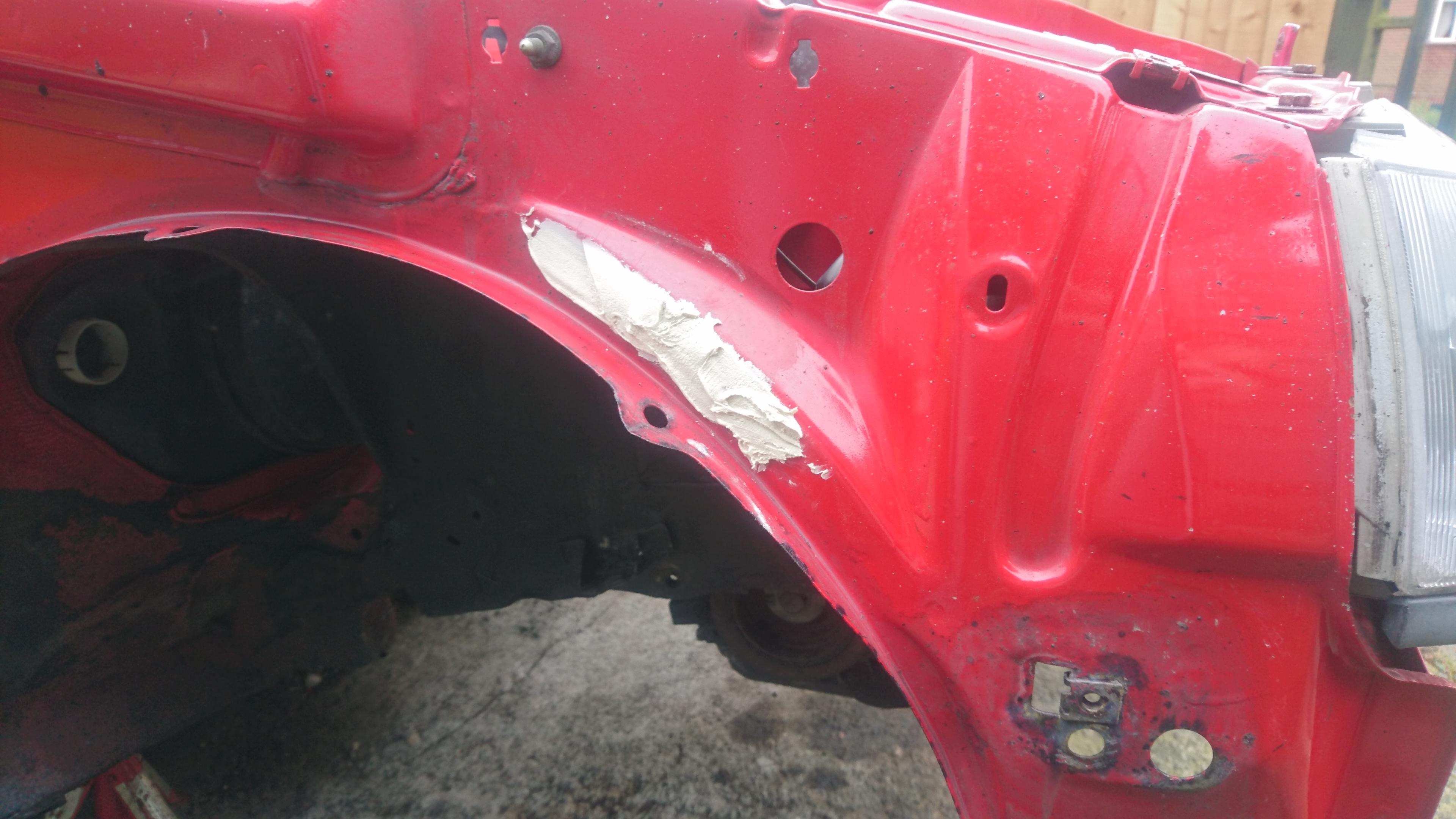

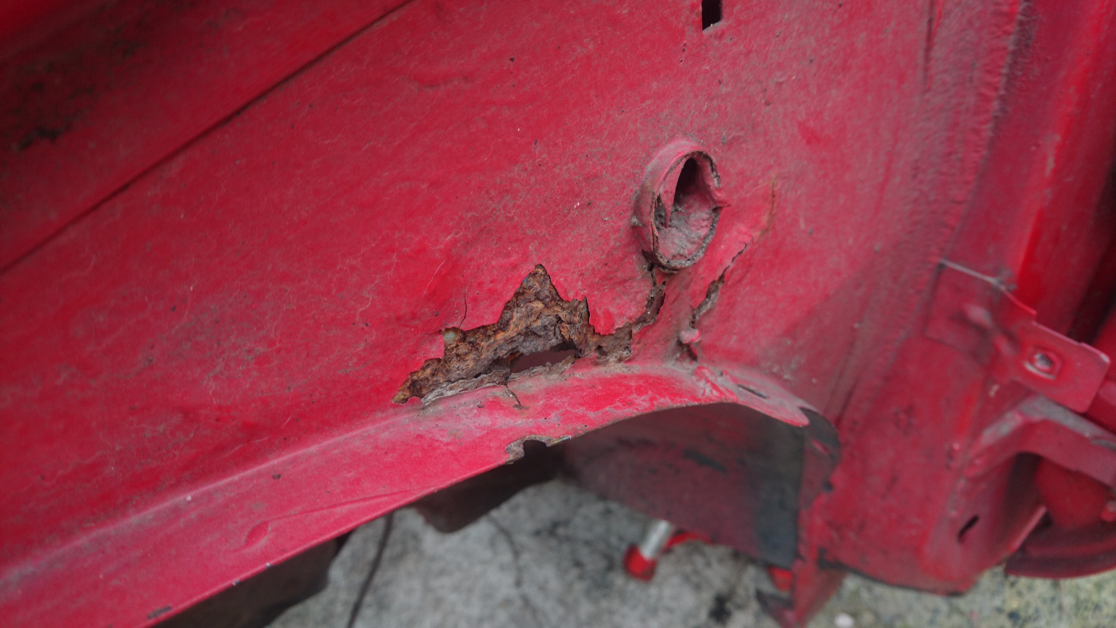

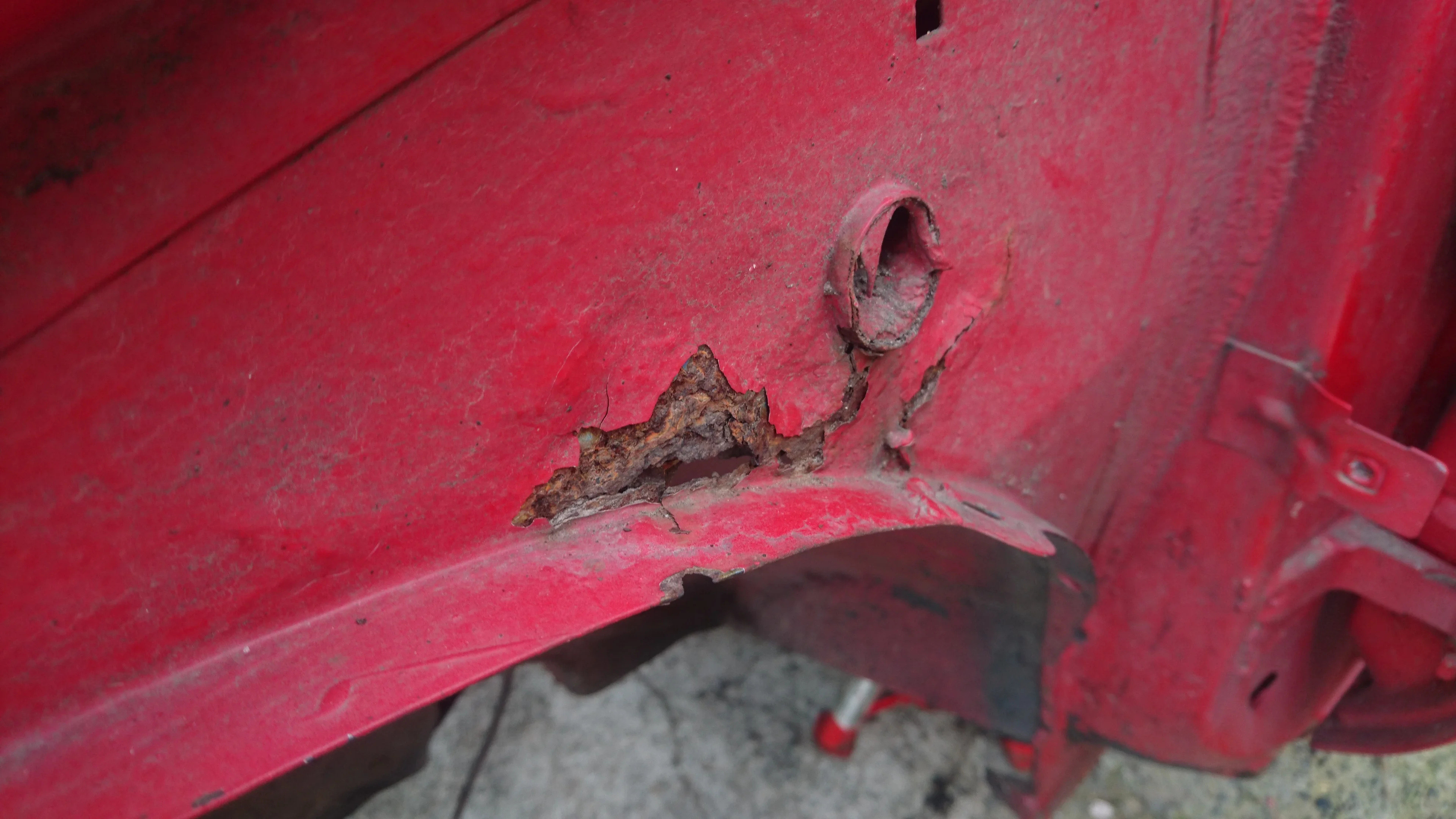

Found some small patches of rust, one that's a bit nasty on the inner arch that's going through to the scuttle area, I will treat and sure this up without a full repair for now and then get it properly fixed next time the cars in for bodywork.
Pics!
Subframe off:
brakes off
Panels off

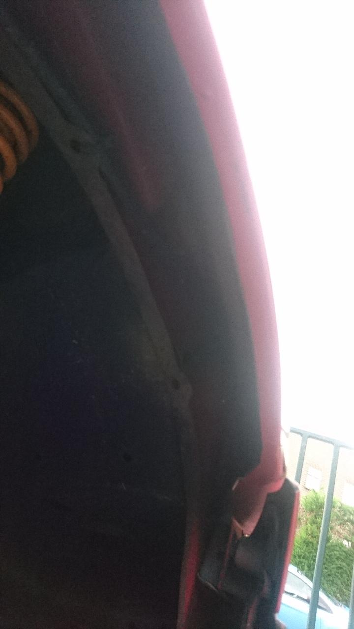

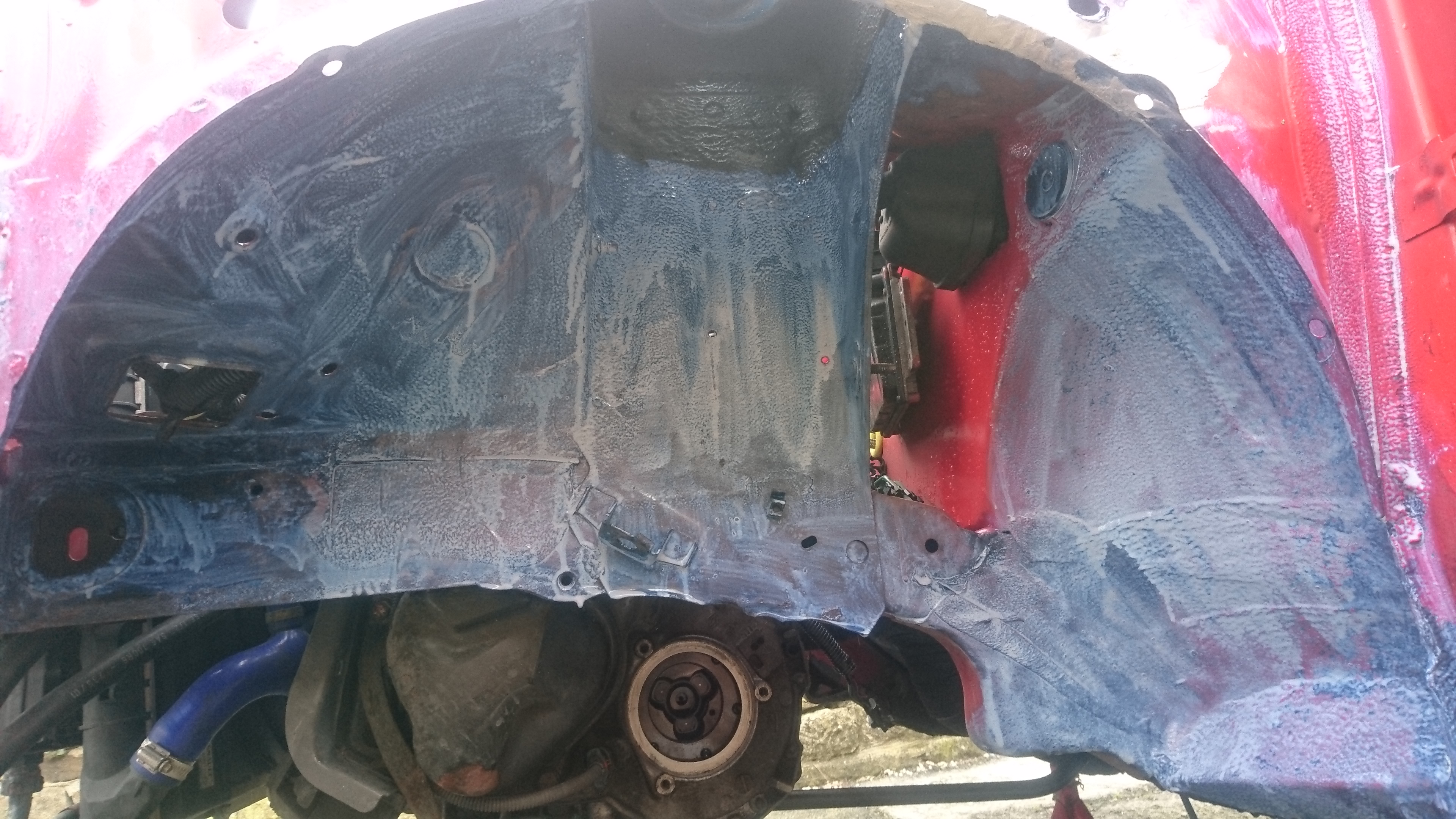

Inner arches are pretty clean overall for a 25 year old car, the paintwork being done 8 years ago by Danny helped
and the small patch of rust I need to sure up for now
cheers
Ben
18-02-2018 More Archery ...

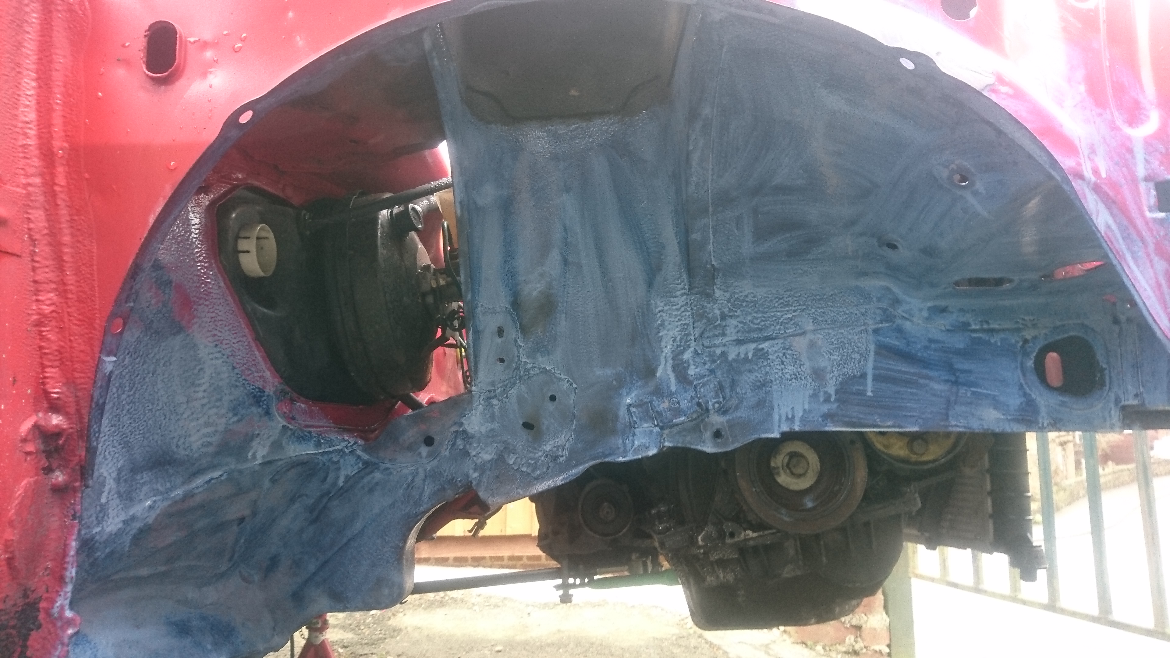

Another coat of rust nomming stuff added after wire brush drill attachment run over the inner arches.
Also bodged up the rust patches with filler which I need to let set and sand back , it'll do for now until I get it all welded in few millenia

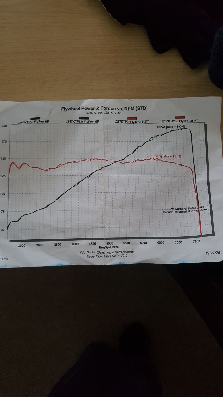

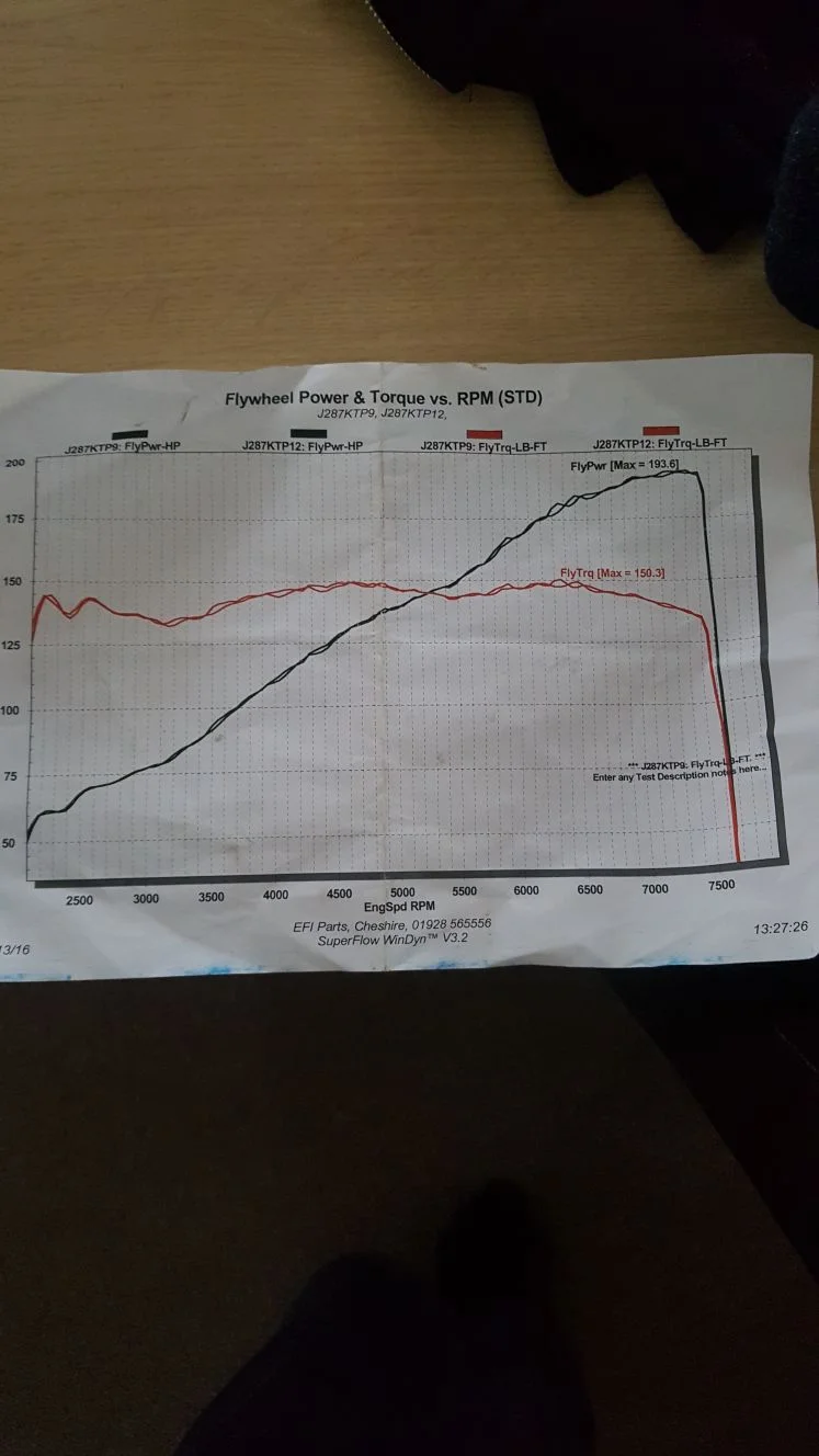

Oh and found pic of the RR graph from the rs2 remap :-)
Pics!!
