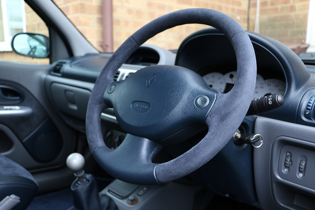

..... also just a thought - my (slightly later) Phase1 has a plain 'rubber' rimmed steering wheel - where as yours is leather, should mine have had a leather rimmed wheel too do you think?
PH1's didnt come with a leather steering wheel, it was fake leather so that is why it fell to bits. People fitted the rubber wheels from the base spec cars because it looks better than one that's fallen to bits.
I had mine covered in the leather/cloth from a PH1 rear seat.
I think I posted a pic of the wheel beforehand, it did seem rubbery as it had dents in it that leather wouldn't appear to wear like that.
As a quick fix some people strip the top/stitched layer off their wheel but snappy's re-trims are a work of art. He did have some alcantara seat material left over, it's grippier if you're going on track but it depends how much use the car will get as leather probably wears slower.

This car gives me goosebumps!! Thanks for the info on the steering wheel - I must admit mine feels remarkably 'fresh' given its age & 74k mileage so it would figure that it's been changed at some point - it has no stitching, it's just a plain rubber wheel & does feel quite 'base-spec'.

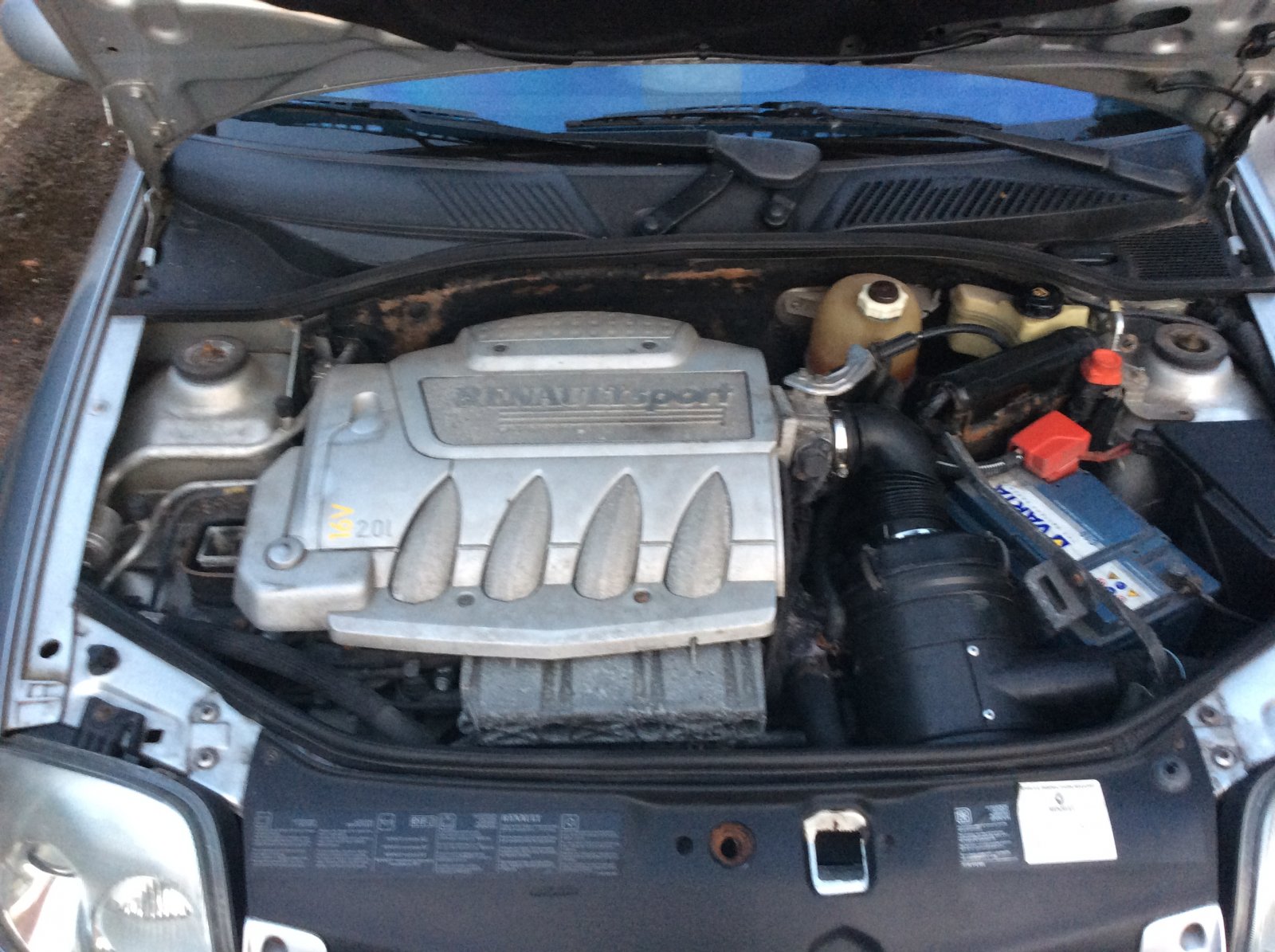

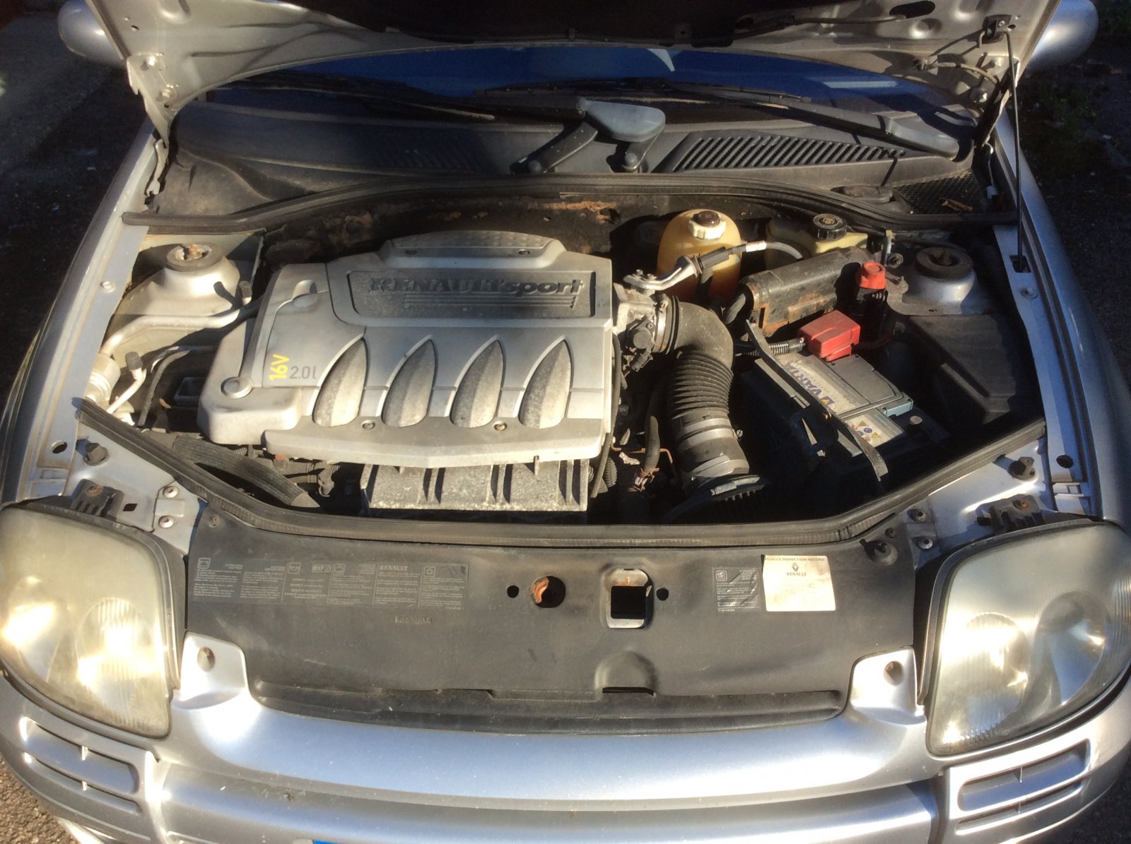

Thanks for all the kind words, I didn't get round to posting an update at the weekend but I have a few pictures of the work I've done on the engine bay to date.

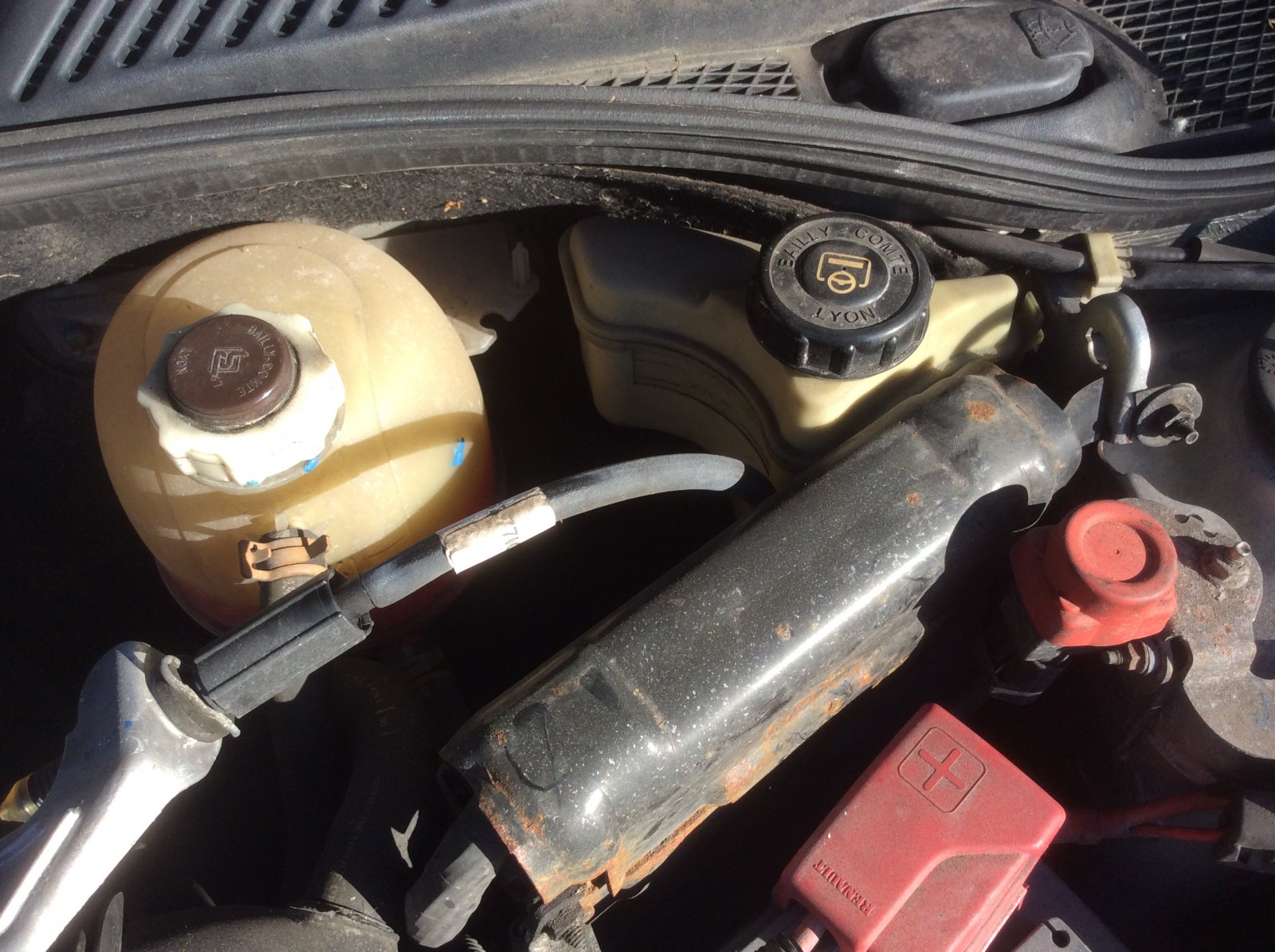

The bay was very dirty and in need of a decent clean.

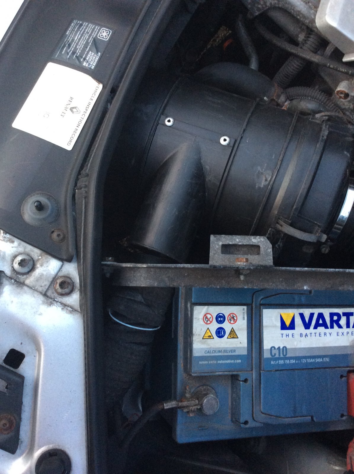

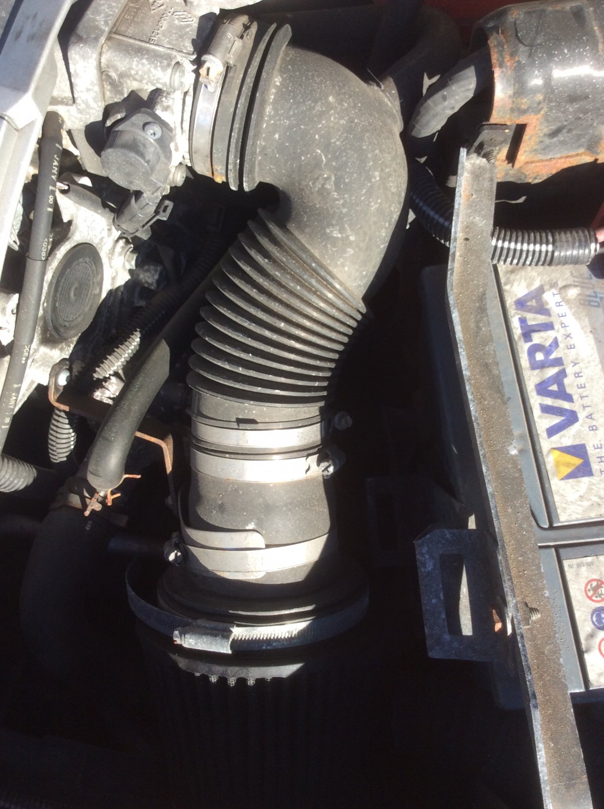

The car had an aftermarket K&N filter on, which, combined with the Magnex twin exhaust made quite a lot of noise. I sourced a standard airbox and fitted it but it was a massive pain and one of the cold air feeds gave up as I was trying to get it to fit.
New box fitted... with broken cold air feed! :angry:
After a bit of a spruce up it looked a tiny bit better...

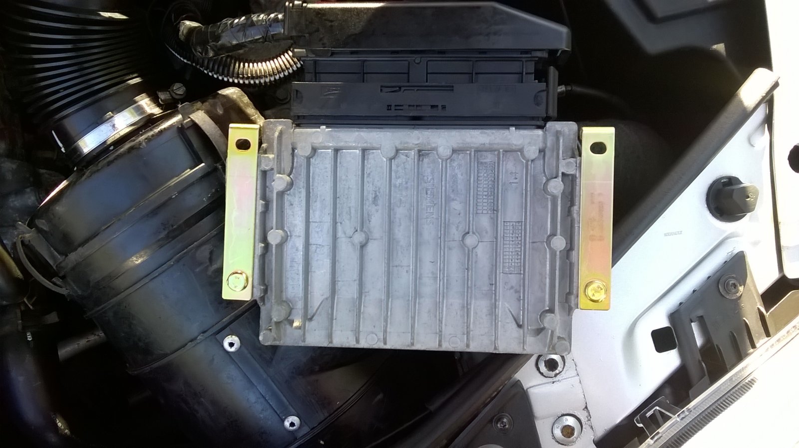

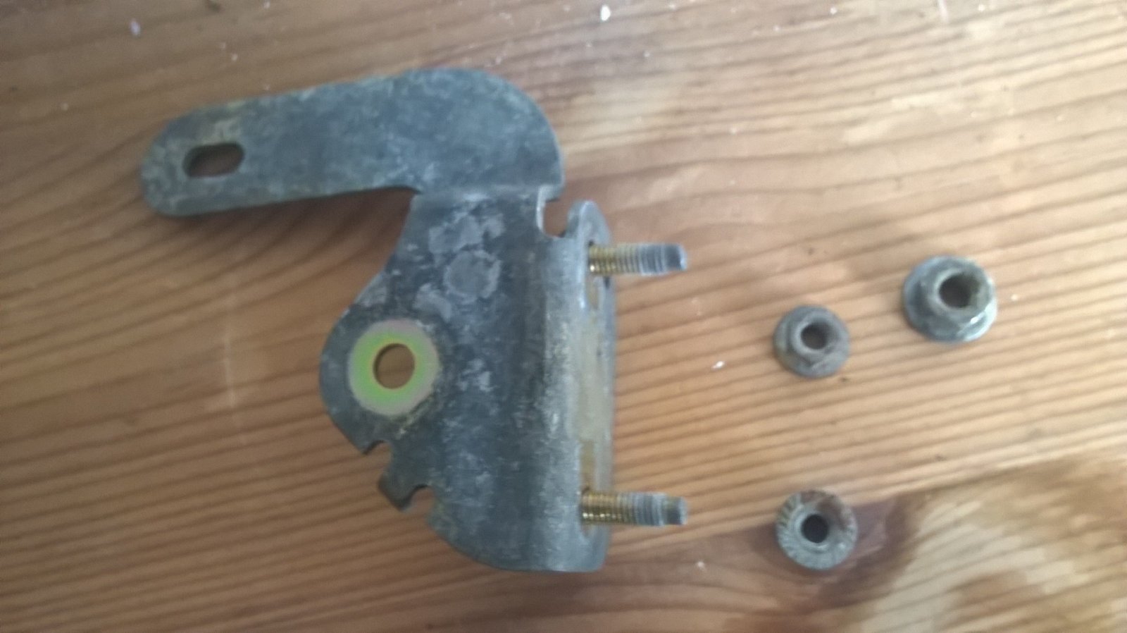

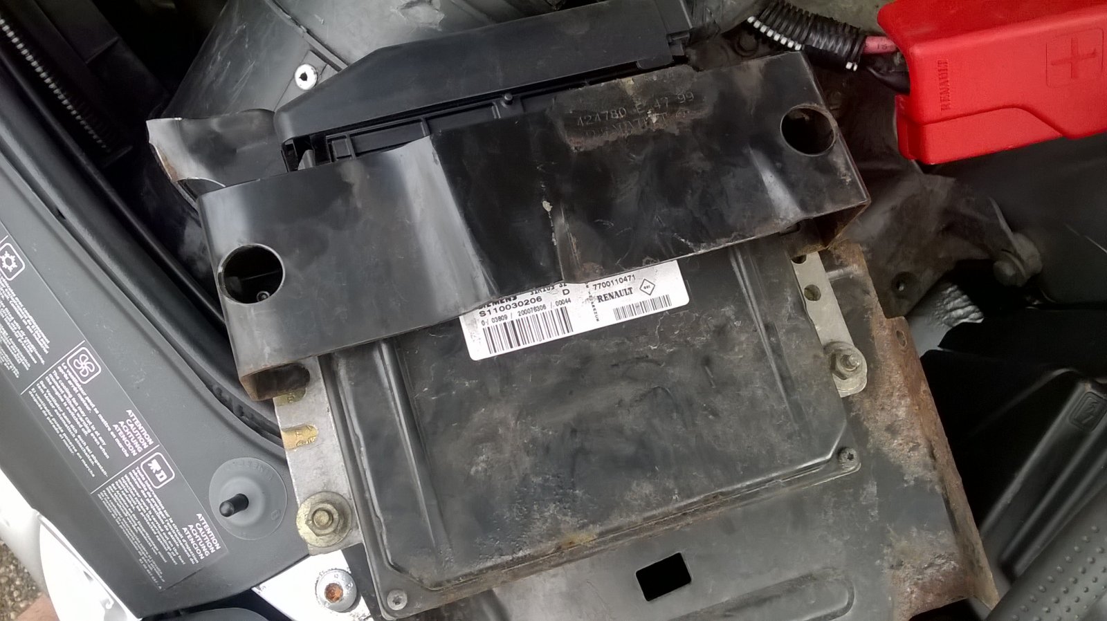

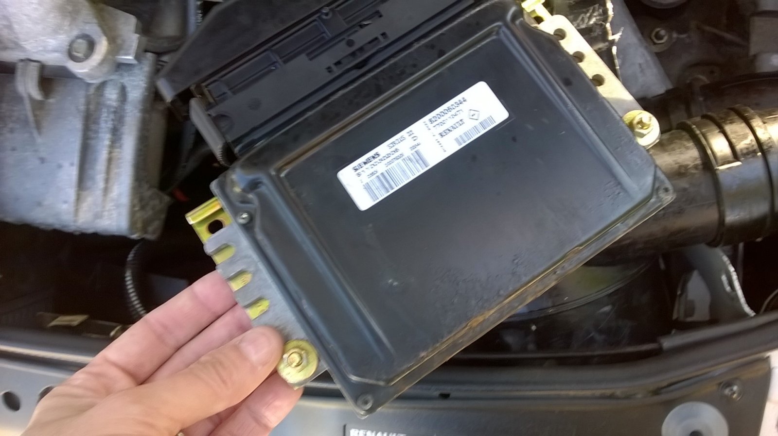

My plan was/is to strip the entire bay of parts, powdercoat them, zinc plate the screws etc and then put it all back together. I made a start with the ECU cover and battery brace as this was fairly easy to remove and the ECU cover was rusting away.

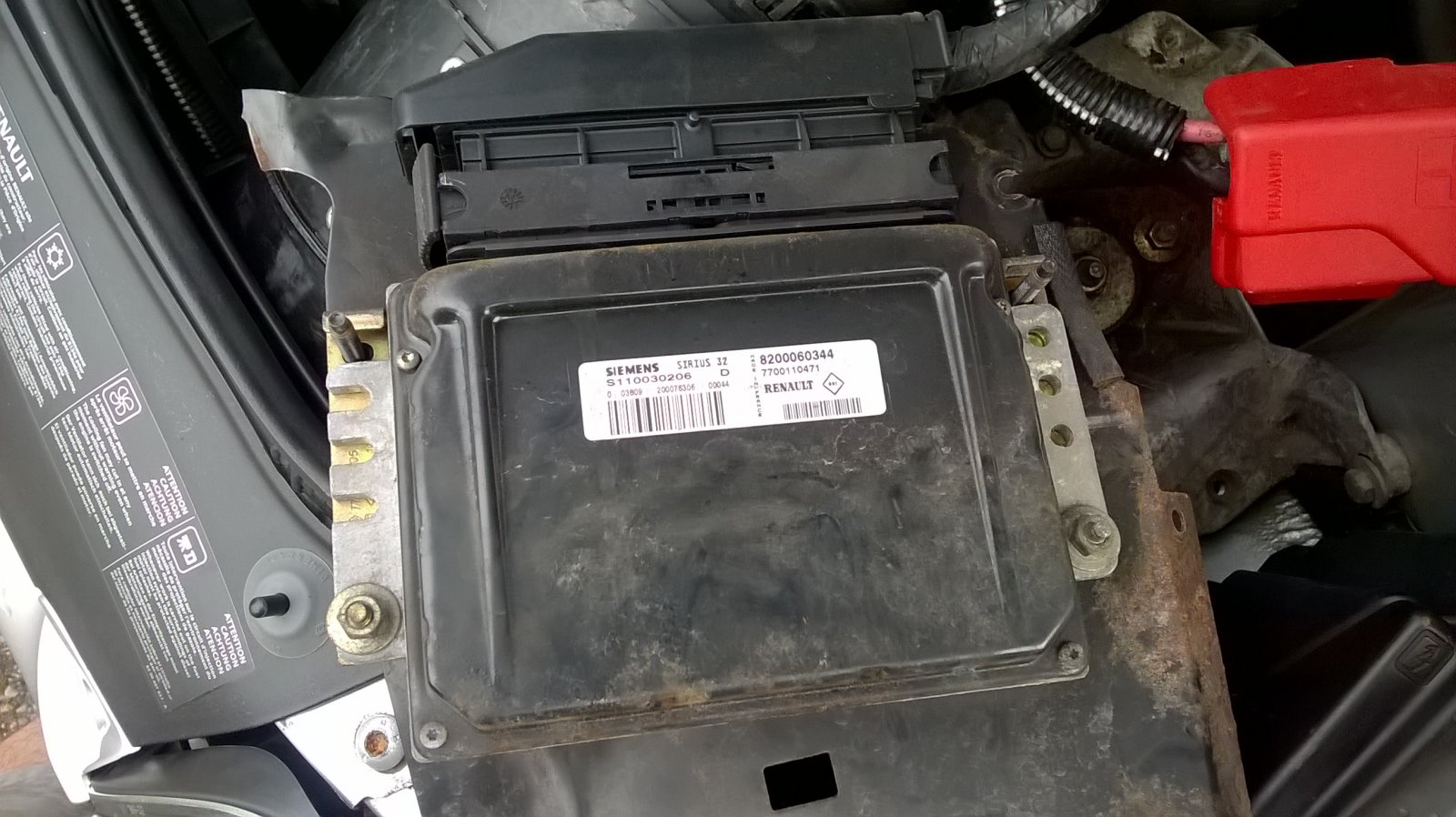

Area before..
ECU removed and being stripped down...

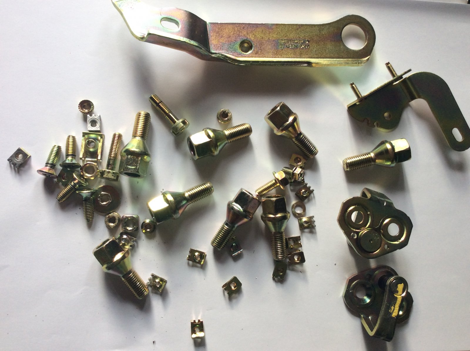

ECU bracket and bolts ready to be sent for zinc plating..
Various parts back from the platers including the ECU bracket
ECU rebuilt

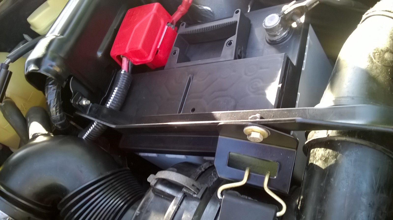

ECU put back together, battery brace powdercoated and reattached together with a new black battery in replace of the old one. I also sourced two cold air feeds and an airbox strap which got zinc plated. Everything else got cleaned and coated with Aerospace 303.

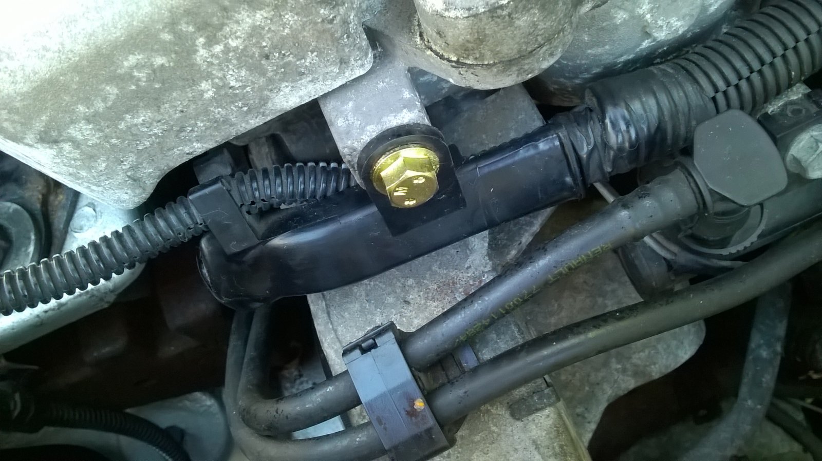

One more random bolt swap out just because I could. It looks a bit sad surrounded by the aged looking engine parts..

With regards to the steering wheel, I can only speak for a V6, but believe they were neoprine (that's what I saw listed in the brochure) I still have a pretty mint wheel as I swapped it out for a leather one which is much better. As for the mats, they look great! Costco used to sell some that were perfect, but they've not had them in years. I still have my originals as I took them out for some cheap ones.
