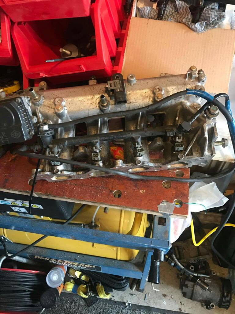

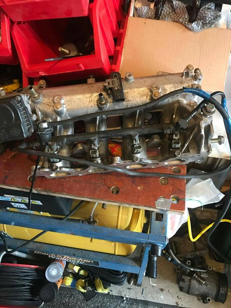

could just go with a centre fed rail or a return on the other end to the feed.
Danith
  MX5 ND2 184
Seems to be mentioned a fair bit, no idea how tho. Just weird that if it is down to a badly designed rail then why would it be more prevalent on cars with higher powered maps, wouldnt have thought maps would have anything to so with that

easy enough to sort a rail out, wonder if you could do a twin feed even? one from each end? remind me and i'll speak to chris about it when you go.
can sometimes just be something daft like harmonics in the pump/rail at certain revs etc...
