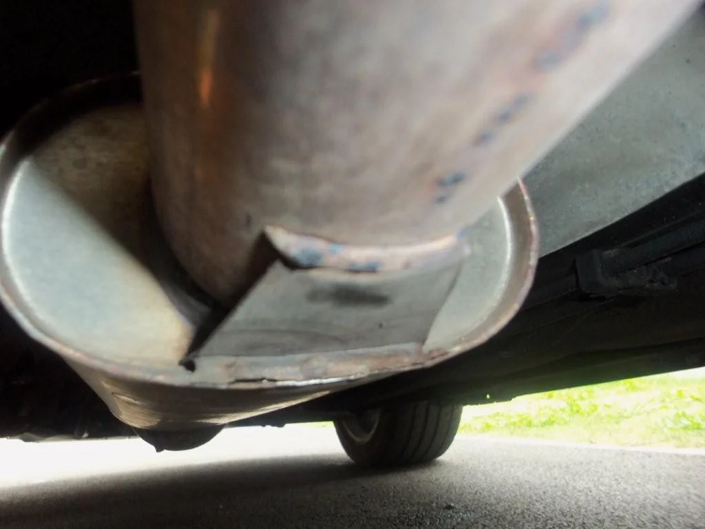

RS192's crack too.... :(
This after 2 years & 11,000 miles, Scorpion are replacing it tho under lifetime warranty.

Everyone says they crack, but it's largely forum b*llocks.
It's not a Milltek problem. Mine's been on the car for 50,000 miles and five years.

they are not all bad, but alot are. back when i had my GTTDI highline and i was into my VAG stuff there were reports of millteks cracking

cracking is usualy due to the rear/centre exhaust mount rubbers sagging and putting extra strain on specific parts of the exhaust.

I reckon a lot of the cracks occur where people try and force the exhaust into a position to get the tailpipes sitting perfectly in the bumper.
