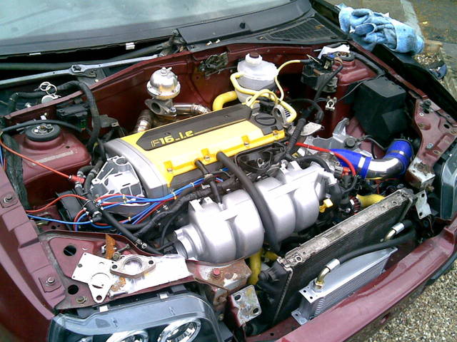

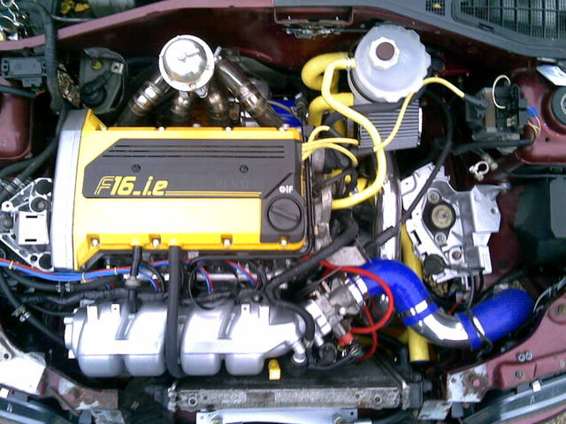

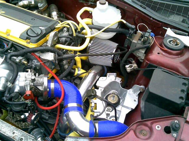

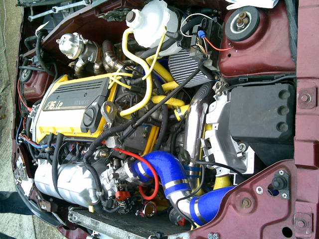

few recent pics for y'all

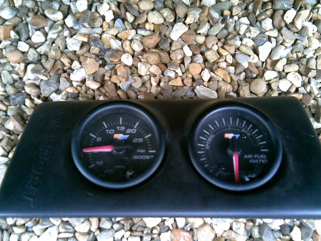

some new gauges
  Renault Clio 16v
money is the main thing, kinda run out at the mo! :(
not really waiting on anything at the mo but need to buy some vacuum pipe to plumb in the waste gate & the dump valve. also some more hose clips for some water pipes that still need clamping. then i need to finish the exhaust and sort out the ecu side of things.
  Renault Clio 16v
stock ecu mapped to suit. looking to use an aftermarket set up next year if the stock ecu parameters are insufficient :)

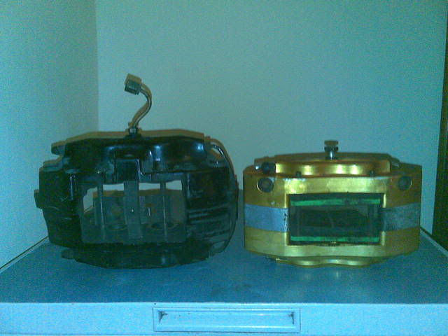

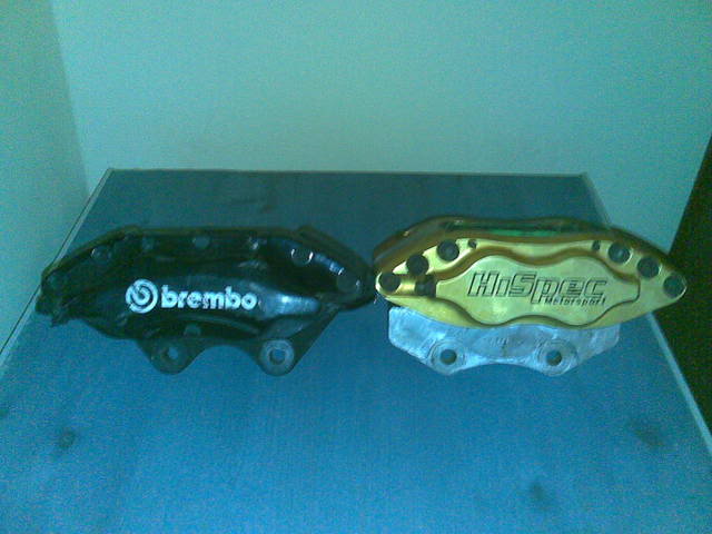

Bought some new brakes to fit instead of the hi-specs (main reason being future cost of parts is cheaper) and will be using RS 280mm discs instead of the 300mm bells and rotors

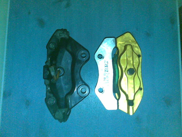

I introduce some 406 V6 Brembo's!! a few pics to show them next to the billet 4's

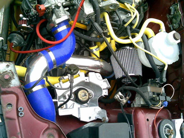

But if you can find a better place for the filter if you can ;)

loving the new brakes. Was wondering how you were going to stop this powerhouse car.
I take it the 406 brembos are going to require some custom brackets made up?

cheers. going to relocate the filter to the scuttle area maybe, or move the battery and put it there as iwant a MK1 Clio Maxi bonnet vent.

406 brembo's bolt right onto the mk1 clio hub. just need a washer to centralise the caliper on the disc

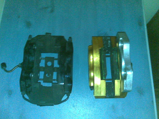

Little update

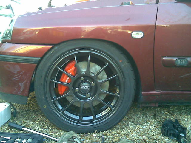

Got the fat f*****s bolted up with the RS clio discs :)

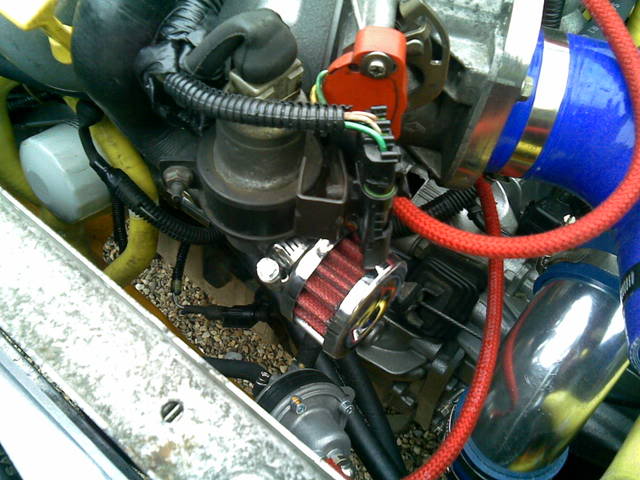

done a bit of work on the wastgate side of things too but no pics for that :)

What hole spacing do the 406 calipers use? I take it the hole spacing for mk1 and mk2 (except RS) brake is the same as the 16v mk2's use Williams/valver brakes...?
  Renault Clio 16v
i dont know anything about mk 2 non RS brakes, but i heard they're the same as 1.8/2.0 mk1 fitment ? if thats true then they should fit the lower spec mk2's
the 406 calipers fit straight on the mk1 hub, just needs a 3mm washer to centralise the caliper on the disc
Would brembo brakes bolt on to an RS clio?
Not unless you had brackets made
Nice calipers, what discs are you using with them?
Mk2 clio sport discs - 280mm
yes dave they would fit, same hub caliper spacing on 1.2/1.4/1.6 MK2 clio as the MK1 1.8/2.0 as said.....get it done!
