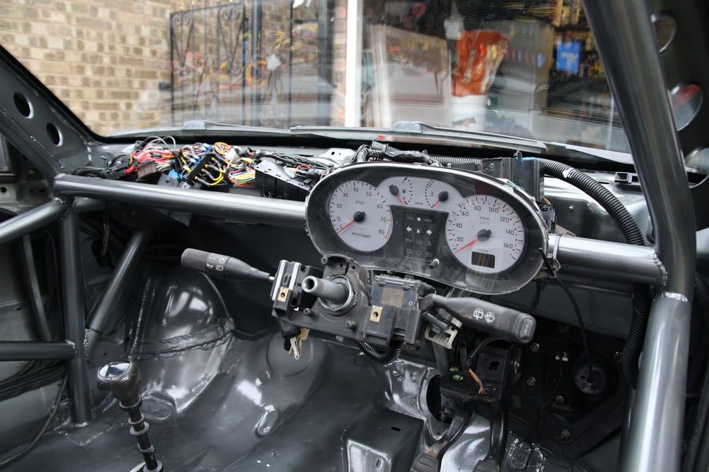

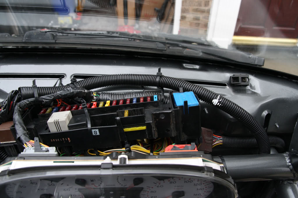

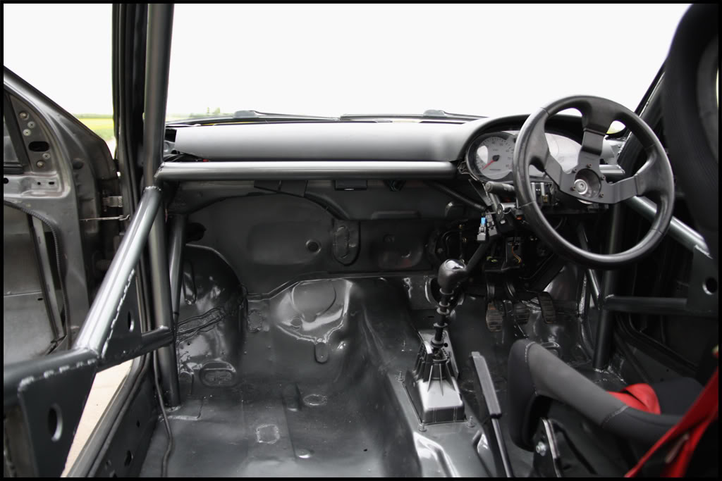

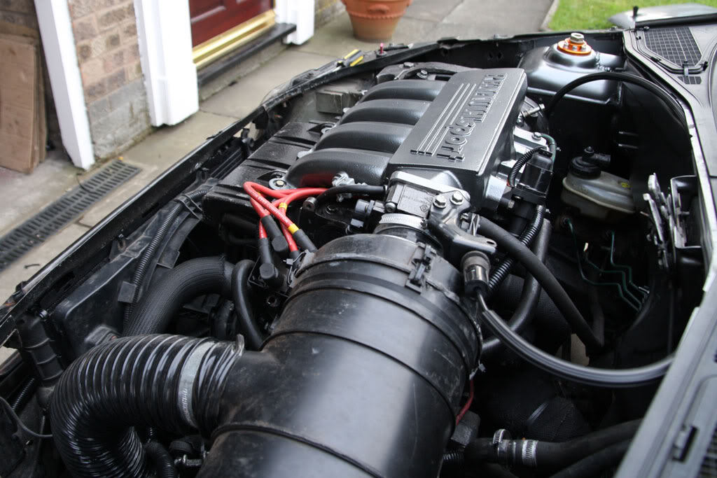

All sorted! Fully re-wired from fresh, everything is now working and its fully driving :)
Re-located fusebox behind the clocks, nice and tidy now when the dash top is back on - cant see any of it :)

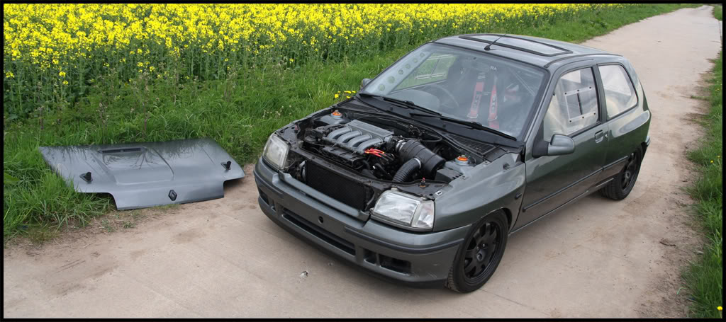

Engine back back to normal...
Better photos and proper update soon!

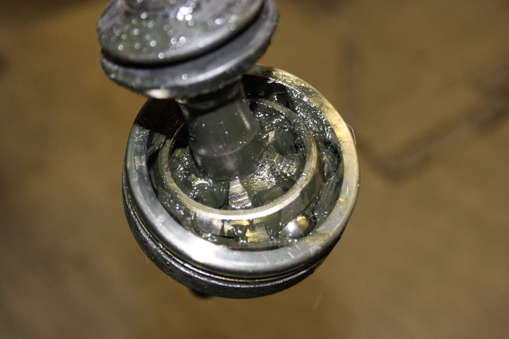

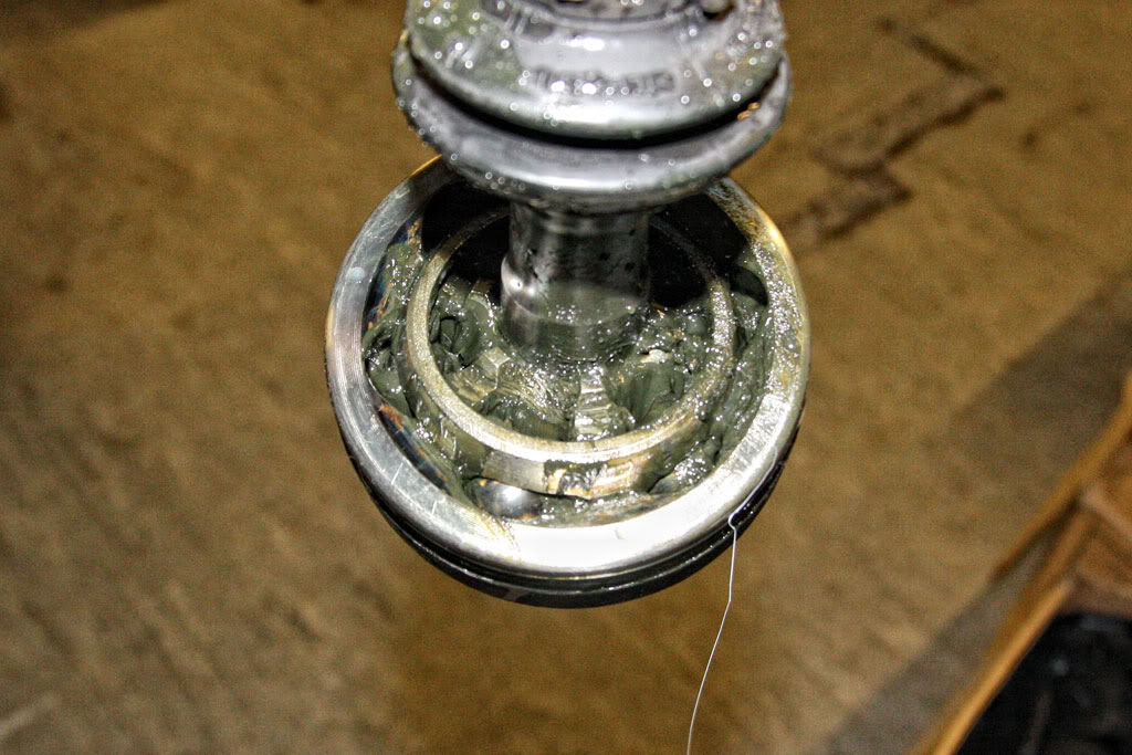

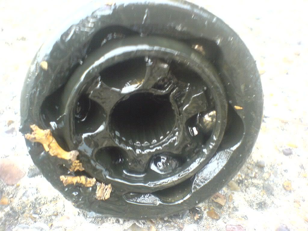

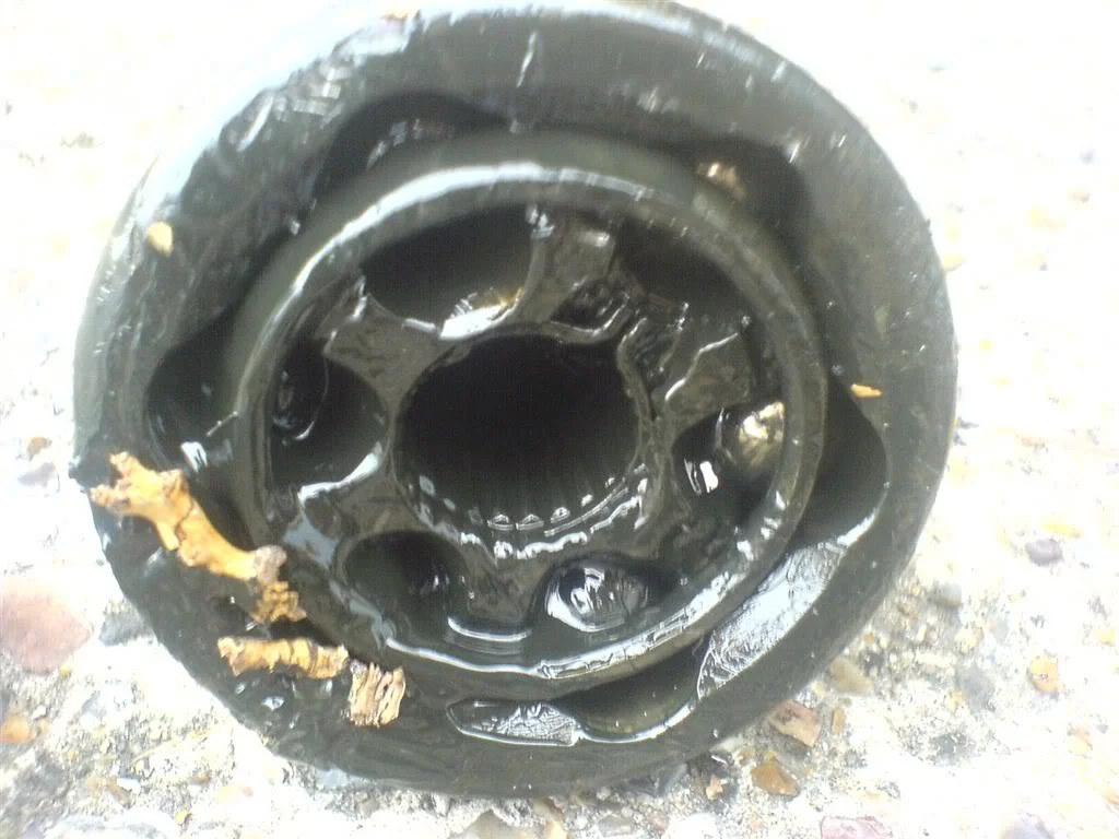

My N/S driveshaft thread (that the hub nut goes onto) has always been f*cked, and its always been a pain to get the nut on/off it. I considered cutting a few threads off the end of the shaft to make a fresh and hope it would be OK, but instead managed to get a scrap driveshaft from Whiteley that had a decent thread on the end...
Great I thought, il just swap the CV onto my shaft and all will be well. After speaking to Matteh, he showed me a picture of a Williams Driveshaft Outer CV Joint, and the circlip that holds it together...
To which I assumed a 172 shaft would be the same, so I got most of the grease off the 172 shaft but could not see a circlip in sight. By this point I was covered in grease and gave up...anyone removed the outer CV from a 172 shaft before?

172 cv joint iirc. it has an internal clip, just brae it with a copper lump hammer :D
Re: Mk1 F4R'd Track Car Project [2010 Winter Rebuild]
Apparently some of them had a circlip that was the same, but ive not had chance to have another look yet...

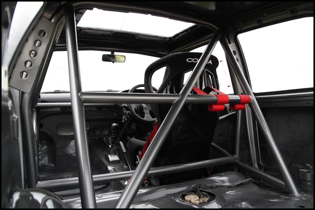

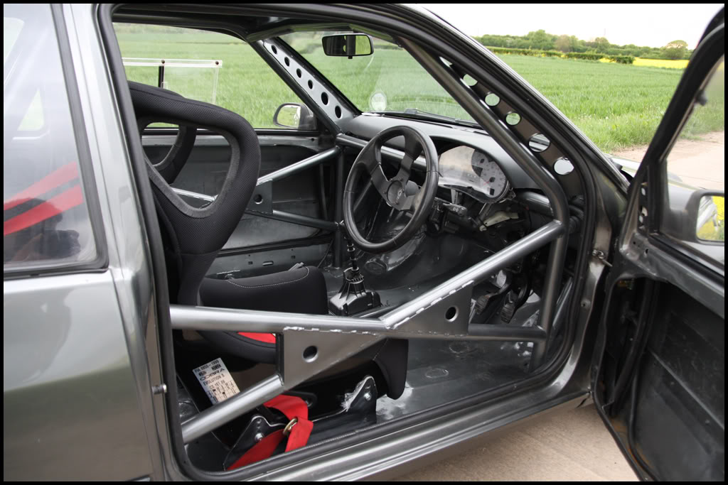

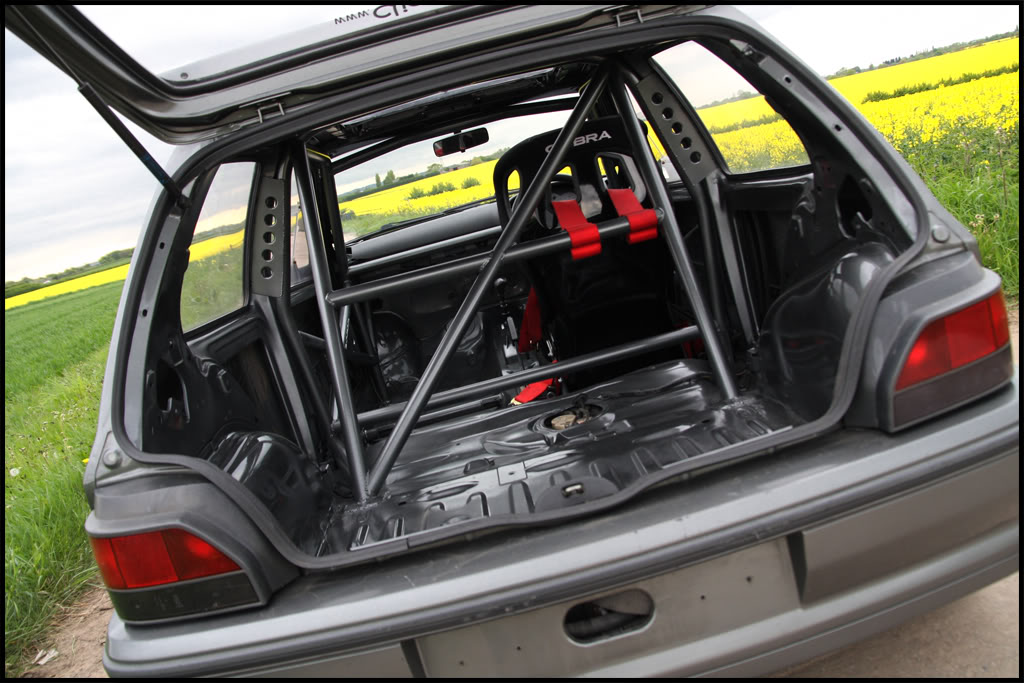

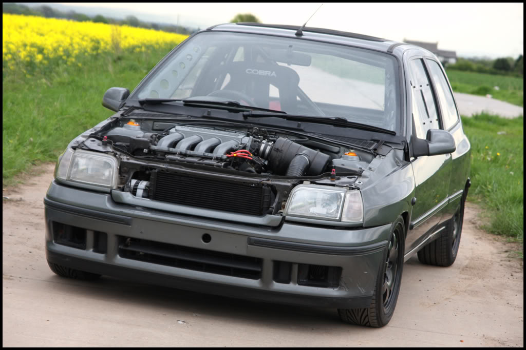

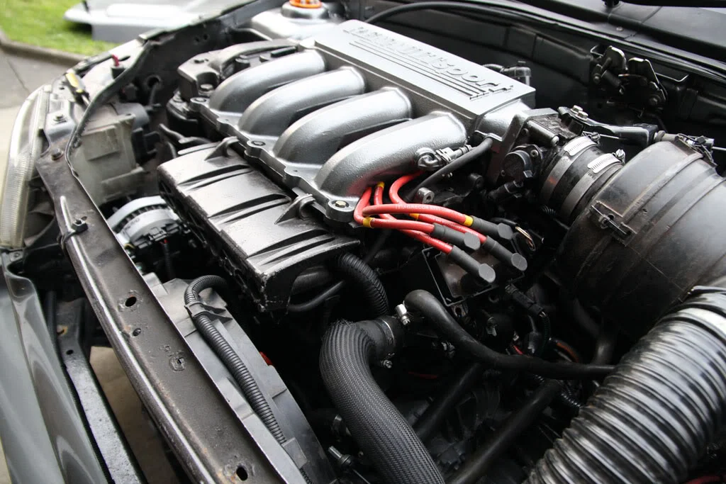

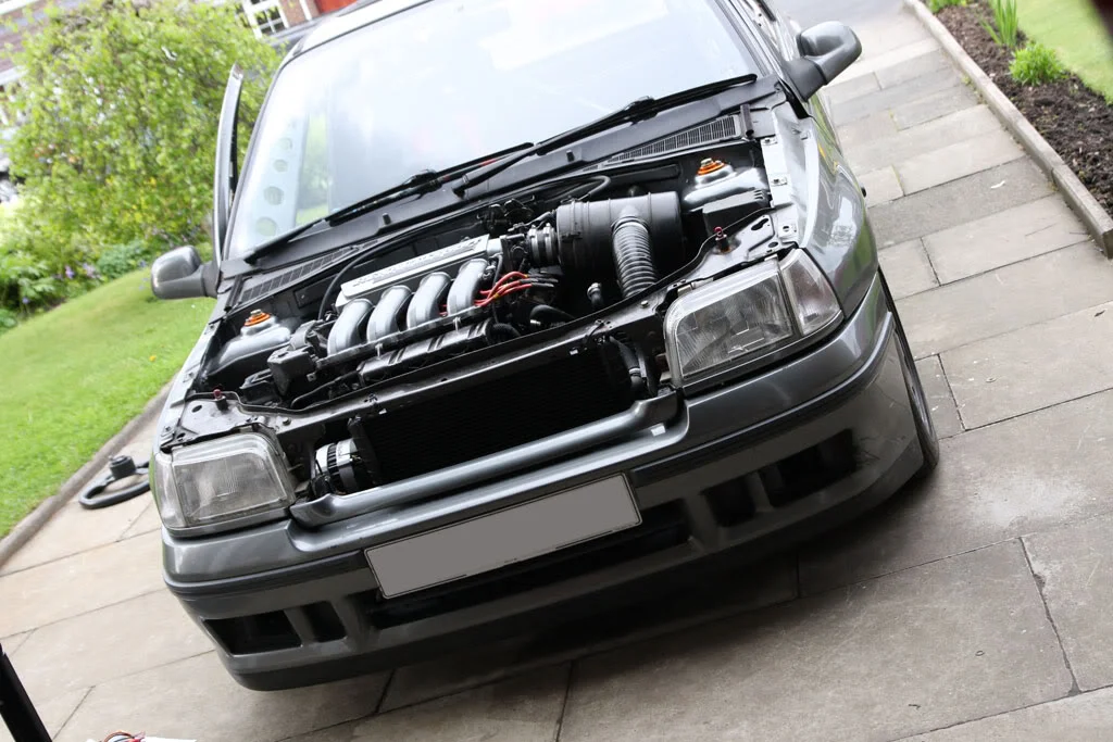

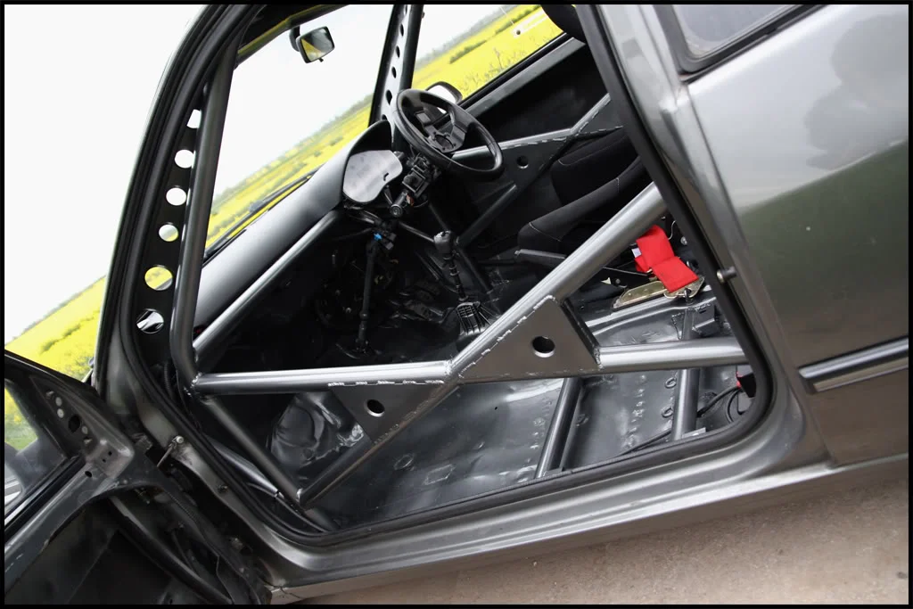

Few proper pics from earlier now its mostly rebuilt...
Nearly hidden most of the wiring/boxes - fusebox gone from the passenger underside as mentioned earlier. One or two small boxes left to hide then its all tidy :)
More updates soon!

very odd about that cv joint!
I can't imagine renault would make you replace the entire shaft if the cv joint goes!!... then again...
Well I had a PM from Andrew Cooke and hes bought a replacement 172 CV, and he said it didnt seem to come with a circlip I think, and it was just possibly a push fitment?!
indeed, unfortunately it's the wrong CV... however the machining detail looks similar to yours and I still think it's a case of selecting the correct sized hammer....

looking good, tho cant believe your still using the awful standard steering wheel, that was the 1st thing to go in the bin when i got mine
Had a new one here for the past 6 months with a weld on-pop off boss, but just not had chance to get it tigged onto the column yet!

Not tempted by some protection for the footwells? When I had mine stripped I went straight through the paint and it looked s**t after a short while!
Grip-tape on the way at some point! Also still got to add padding to the cage and a few other things to tidy up etc.
