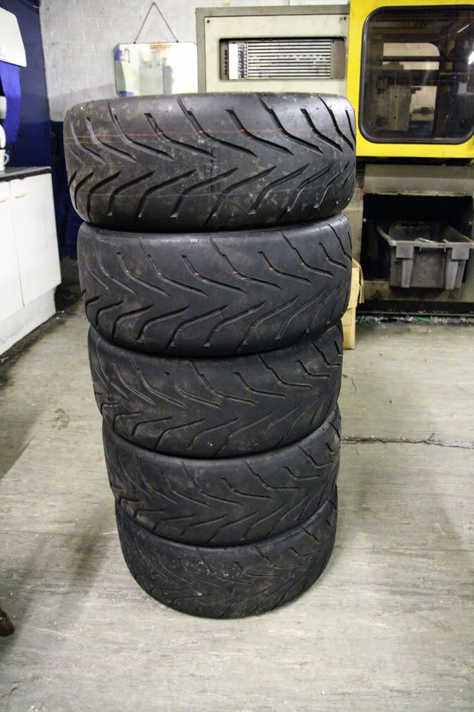

Will have to see how it goes with some more miles - got a stockpile of 9 x 205/50/15 GG R888s...
...to keep me entertained throughout the year too :)

205? With 7J yeah?
Tires seem wide :S Can't believe you spent so much on tires though, could never justify that much!

9 tyres for less than the price of one 205/50/15 R888, very expensive yeah ;)
205 is the best width for 7J too!

Glad you decided to use proper tyres now. Always thought you were skimping on the most important bit.
Re: Mk1 F4R/172'd Track Car Project
you WHAT!
Its not what you know, its who you know ;)
Yeah - got a feel for it last year and the tyres I used of varying types went OK. I was going to stick with them for this year, but these came up so cheap I would have been stupid to not grab them and use them for the year!

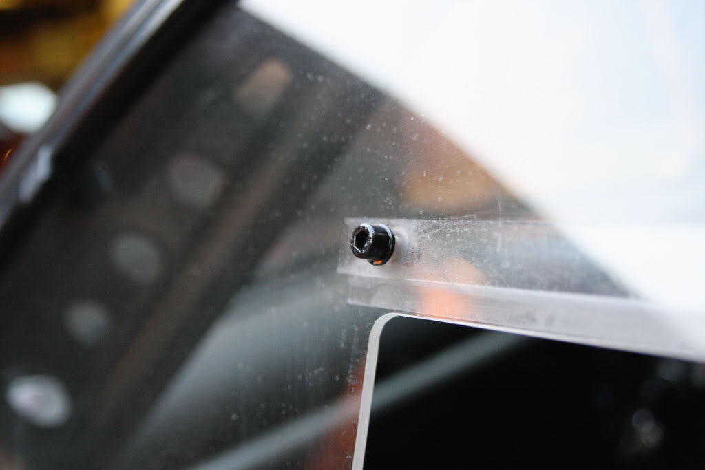

Few other bits done today - so f*cking hot I removed the front windows as it was like a greenhouse! Made up a center section hanger that bolts through one of the old seat mounts - sits alot higher now which is perfect.
Replaced all the window bolts with stainless items (of which I painted the heads black) - as the old mild steel bolts had gone rusty and covered the runners in c*ap. Cleaned them all up and got the bolts on...

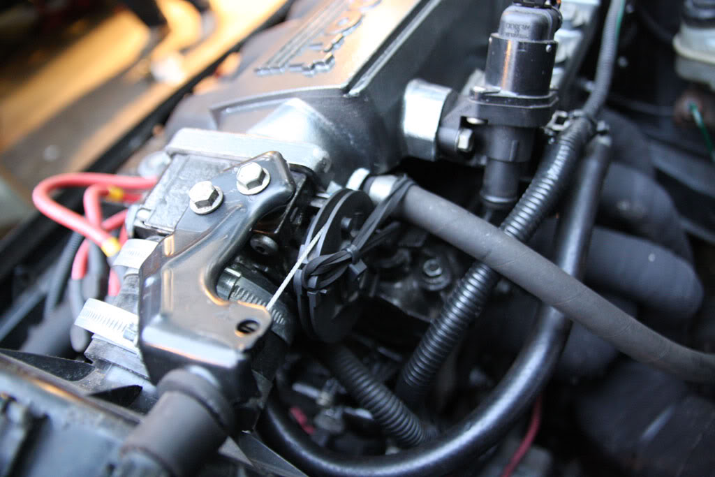

I managed to find a fix (rig-up) for my sticking throttle over the past week also. I didnt want to buy a second hand throttle body and it be the same, nor did I want to buy a new one from Renault. I removed the bonnet when it was idling high and you could see it was stopping just 1mm away from the idle grub screw - if you turned it the last mm it would idle perfectly.
Cue a few heavy duty elastic bands...
Not had the problem since - perfect :)

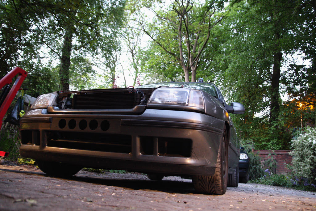

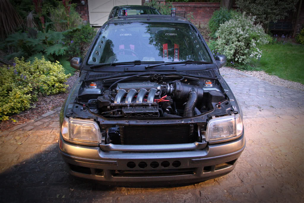

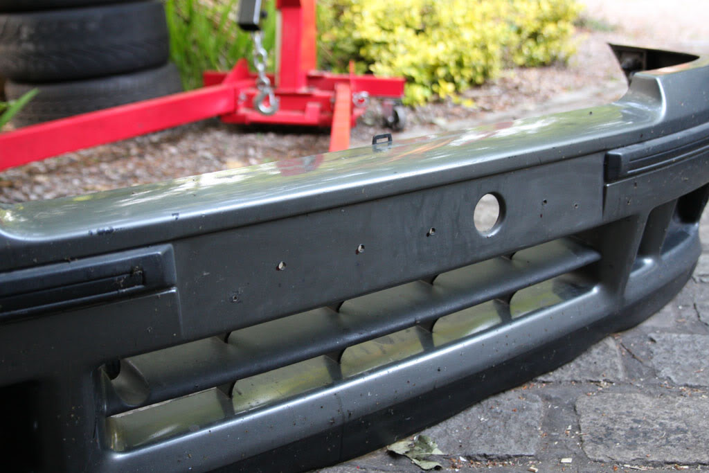

Lastly - ended up getting really bored. Removed the front bumper...
Got the drill out...
And went mad with the 70mm holesaw, lol. I have no idea why but I just ended up cutting some holes for the hell of it as I just hated how it looked with that one offset hole they have standard!
More soon!
Should've used a ruler Jord! lol
Looks great tho!! I'm assuming thats to get cold air to the engine?

Tyres will make the car so much more fun to drive than all the other little bits. Worth it
I did - got the 4 perfect - then the last one was a reet f*ckup (drilling where the old large hole was). Tried to make up a backing plate from a piece of wood for the holesaw pilot drill to go through, which I did fine. Spent ages getting it aligned right, then when I went to drill it f*cking moved, so the 4th hole is on the p*ss lol. Sigh!
Cold air wise - minimal as the slam panels behind it. It was more for looks tbh!

Hope so! Will see how it goes at Rockingham on the 14th :)
Night and day different mate, just watch the pressures. do 2 laps and come in and reset them. they take a while to settle down and you will be letting air out for a few goes. Unless you are in sessions then you will have to set them about 5-8psi lower than you want hot and see how they go.
im guessing 26-28psi hot for your car being lightish?

Its just under 840kg with a bit of fuel now - yeah I was going to see how 26psi hot went.
Its open-pit so should be able to have a play with the pressures along with the adjustable rear dampers its got on now too

ah ours is 850kg dry so try 28psi hot. were running (atm) 30 rear 28 front

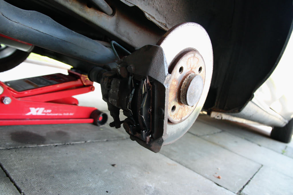

Got hold of another N/S driveshaft, thanks to Jams for picking it up for me! Not fitted yet but shall be over the weekend if I get round to it...

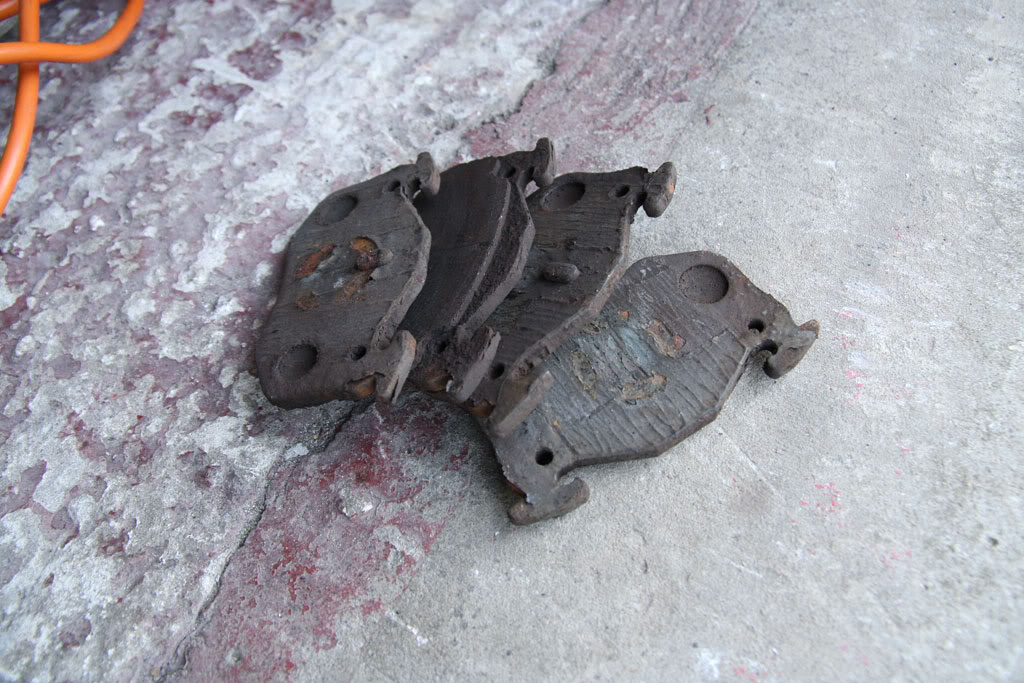

Picked up some awesome £6.50 rear pads from the factors earlier today as mine were pretty much completely shot. They dont do much anyway so on they went...
