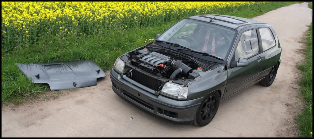

That image is brilliant :D
Top spec work Jord...
Re: Mk1 F4R'd Track Car Project [2010 Winter Rebuild]
Still needs a new clutch though unfortunately!
Hopefully it will last Rockingham in June and Cadwell at the start of July, might have time to replace it then I hope
Just had a look at the latest pics, the car is amazing mate!

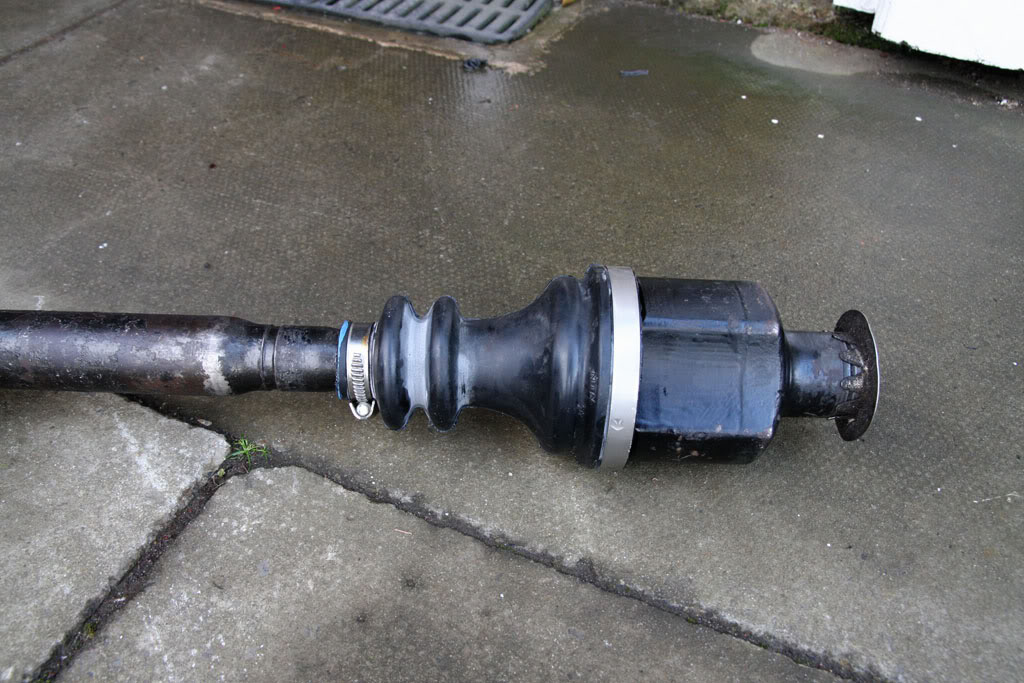

Righty then - driveshafts finally sorted.
As mentioned a few pages back I have always had problems with the hub nut thread on the N/S driveshaft, i.e. the nut not going on. I got a scrap driveshaft from Whiteley and attmpted to swap the whole outer CV over. I couldnt get the CV off the end so gave up and tried to repair the thread on the original shaft.
After a few hours with files, grinders and new nuts I finally got it sorted - threads perfectly now thankfully.

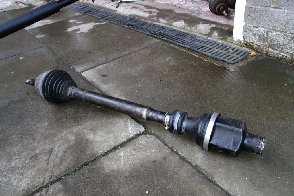

My next problem was the inner O/S driveshaft gaiter. It had split when we towed the car to get the welding finished - and seemed to have a really hard time trying to get hold of a replacement! No factors could match it, the only option was Renault and it was going to be silly money compared to the price of an outer CV gaiter. Luckily sideways danny has a spare kit that he had never used, so got that from him and went about fitting it...

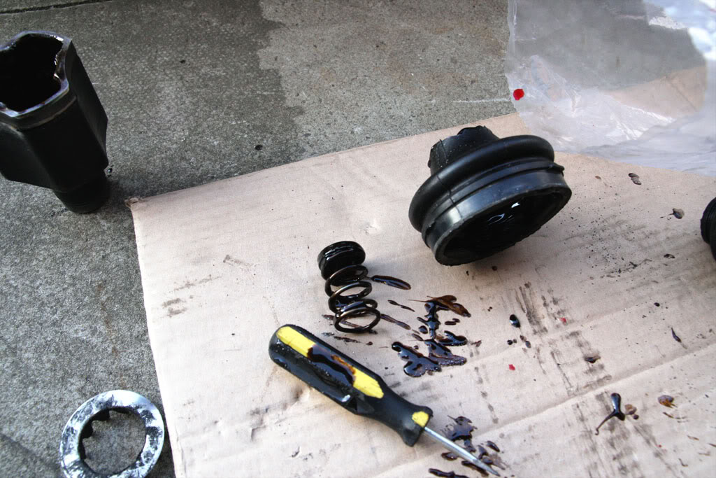

Old one cut off...

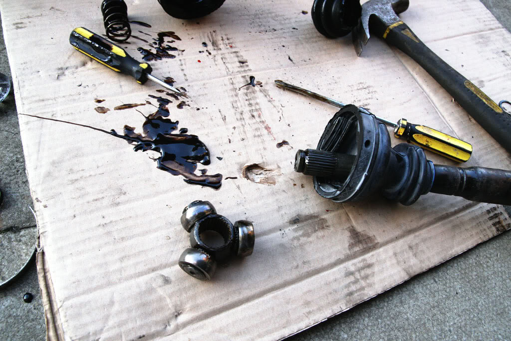

Tripid off, new gaiter on...

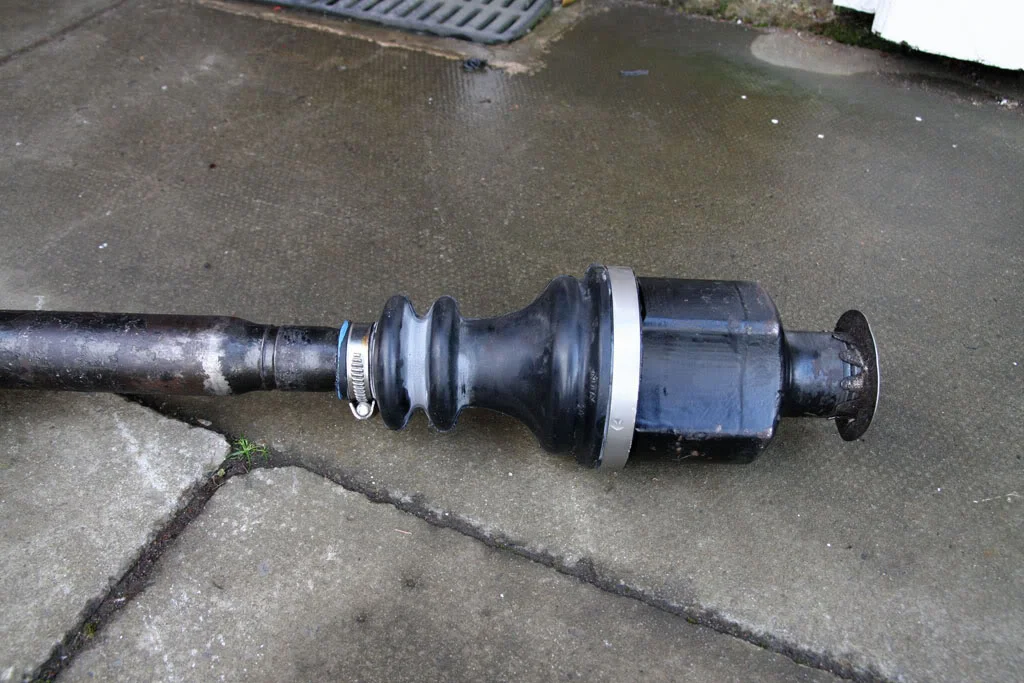

Then after yet more hassle with the inner clip, done!
I ended up having to use a jubilee clip to secure the smaller one, as it split in half when it was crimped - good 'ole Renault quality. Outer one crimped perfectly and then fitted it back to the car.
Hopefully I will never have to do another gaiter/cv joint - messiest f*cking job ever. The N/S driveshaft that I had lent had a split in it that we didn't know about - and when I came to swap it back for mine there was grease everywhere. Just cleaning the grease up took 3x longer than acctually swapping the driveshaft - f*cking joke!

will that shaft be all right with a jubilee clip on, will it not affect the balance of it. also is that the only way to change that side boot, would a cv cone not be upto the job
it is horrible stuff, got two to do over the weekend not I'm looking forward to it.
Done about 100 miles since fitting and it drives spot on, its not come off yet either lol!
