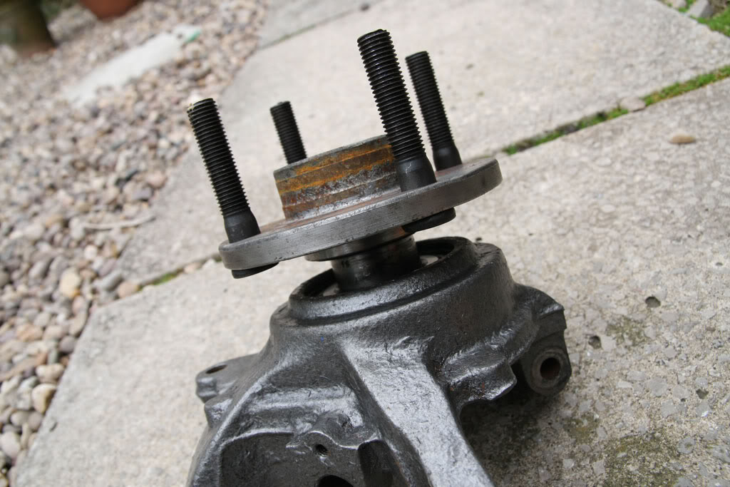

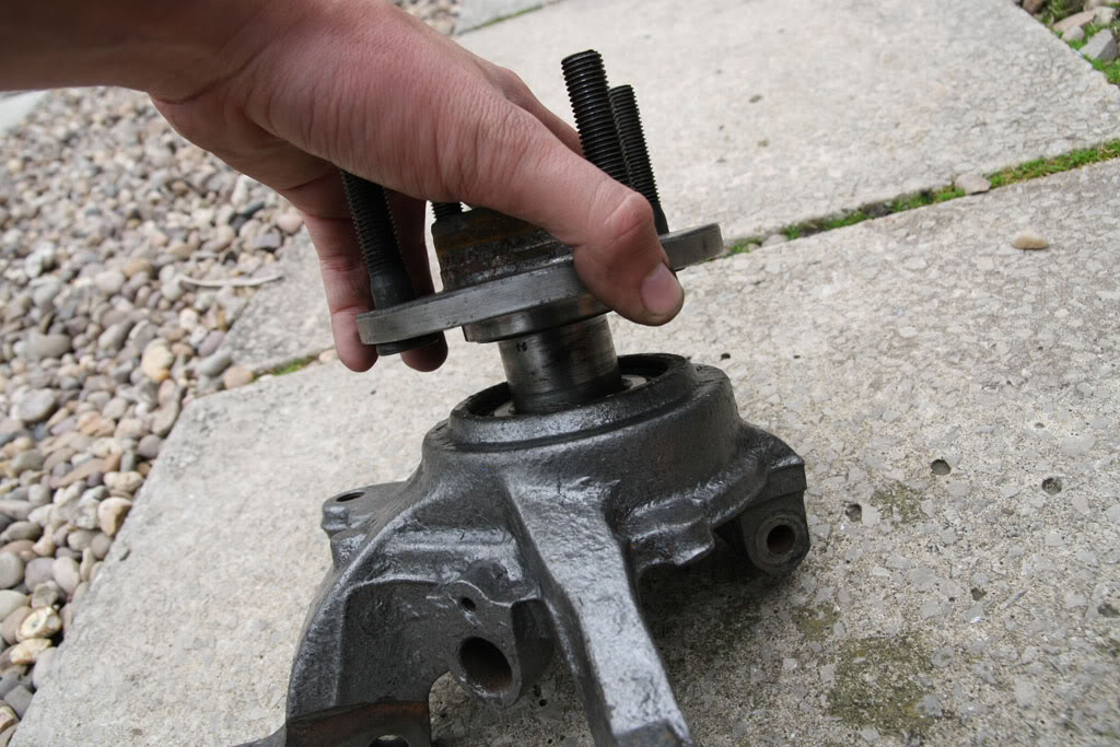

There is something immensely satisfying about assembling hubs.
I can't see any copperslip on those threads, do you use it?
Re: Mk1 F4R/172'd Track Car Project
Cool - thanks for the link, looks like it could be far easier!
Which threads do you mean, the actual stud/nut thread? I put some on the inside of the new nuts before screwing them upto the wheel so the whole thread would not be covered in it...
yep, those. should be fine at that, you're obviously just a lot neater with it than I am :D

Good work, however I would be concerned about the material you removed on the stub axel as you want as much strength as possible there for safety, especially as yours is a track day car and experiences high load. If you ever use slicks you will put even more load on them during cornering. The thing I don't like about it is that you don't know where the safety margin lies with regards to how much material you can remove.
If I am right, you have now removed material from:
- The uprights to fit the 172 suspension struts
- Material on the the axel stub
- Holes for the studs.
Surely you have weakened the whole setup now?
Not having a go but what was wrong with a £40 stud kit off ebay and glueing/bonding the studs in? would have been a lot less hassle?
The shock mounting faces on the uprights were overhanging by around 1mm before they were machined to fit the Williams shocks. By that I mean the shock mounting faces were wider than the stucture going upto it... We take 2mm off each side, as the Williams shock is 4mm narrower than the 172 item. That meant the shock mounting faces are now 1mm narrower than the structure leading upto it. When you compare a 172 upright to a Williams/Valver upright, it is generally lot bigger/fatter in its construction, to which I assume is for the extra weight of a 172 (200kg+ over mine), and/or because of the larger driveshaft/bearing setup. The 172 upright is probably still a lot stronger than a Williams/Valver upright even its machined (2mm each side) state, due to it having more material everywhere else. Ive had no worries about it because of this, and its been on the car since October 2008, covered 15+ trackdays and never had a problem...
When you compare a Williams stub to a 172 stub, it is narrower in the first place. I have taken the 172 stub down to aid with clearance, and because I dont see any problem with it considering the Williams/Valver/Mk1 item is thinner in the first place. The only reason a Williams/Valver/Mk1 stub was not pressed in is because the spline for the driveshaft is smaller, useless for me as im running 172 shafts.
The holes were drilled out to 1/2", basically just removing the thread. 1/2" is 12.7mm, what exact hole size does an M12 thread usually have? Must have only removed 0.2/3mm from each side of the hole if that when they were drilled out...
I could have got an eBay kit, or one from elsewhere etc, but ive heard about the studs winding out after a few trackdays time and time again on quite a few different forums. It always seemed to happen when people had done a trackday and come to change back to their road wheels, they would undo the nuts and the stud would come out with it - something I didnt want to be happening after the f*cked threads Ive had before! Im sure Andrew will reply and comment on the 'screw in' kit he recieved for his 5 before he did the press stud conversion if he reads this, the studs were pretty much monkey metal!
Going from that im quite confident that it is still just as strong, if not stronger than a Williams/Valver hub. Fair enough if any serious heat had been involved like we mentioned a few pages back (Welding or whatever), the metals properties may have changed/weakend etc, but its had nothing like that near it. The stubs were taken down on slow cut, and the uprights machined on a mill - nothing anywhere near the level of heat welding would generate. I went ahead with the idea as Andrew has ran it on his 5 racer, with the same press studs, same width machined stubs (his were Laguna hubs) and full slicks - Im sure if he'd had any problems he wouldnt have recommended the idea to me :)

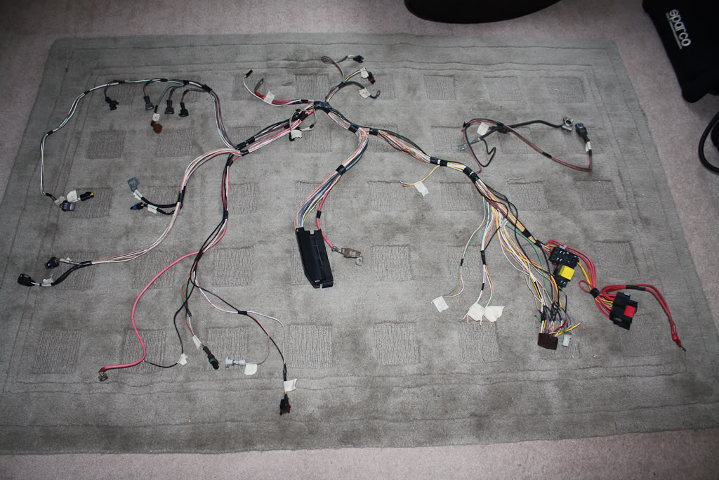

Not mine but Adam's -
You can see the brown and white (Mk1) connector blocks at the bottom of the image. Basically all you are doing is removing the 172 engine loom connector (Thats what the main table in my guide is) and connecting the wires upto the Mk1 connector blocks, so it all matches with the car..
patrick its honestly not that had to do, just work threw the guide at your own pace and all will go well.
ah ok, that makes so much more sense to me now!! so you are literally just cutting off the 172 connector and adding the mk1 connector so it can plug to the rest of the car! I dotn know what i was so confused about before! :o
Why are some of your wires open ends with no plugs?
yeah basically
they look to be wires to do with the 172 dash that adam was putting in his car, i left mine in also in-case i want to add a 172 dash later
Adam hadnt connected them up yet, was a work in progress picture ;)
As wilky said really, just work through it and its not too hard, literally just swapping connector blocks!
Now you set it out like that it appears you have put some thought and 'science' into this and like you say its tried and tested by 15+ trackdays. Guess it just a case of keeping a close eye on things and regular inspections.

I would think you can probably get away with running the studs without taking material off the stub axle, but I didn't want to risk it and press them together with new bearings and find out they caught on the upright - as it would be a pair of bearings wasted! Although, next time Ive got a wheel off I will take a proper look as it would be ideal to just drill the thread and press the stud without having to do any machining. My next trackday is Mallory so I will see how it goes, hopefully no problems :)
I don't believe you will have a problem, the standard hub is 12mm which means that the bolts get 1D of engagement, barely enough, indeed, the MSA require 2D of engagement for wheel nuts.... I measured a set of ford hubs at the 9mm we are using.
btw, I still think you should buy better wheel bearings, see how these last, but I now only use genuine ones.

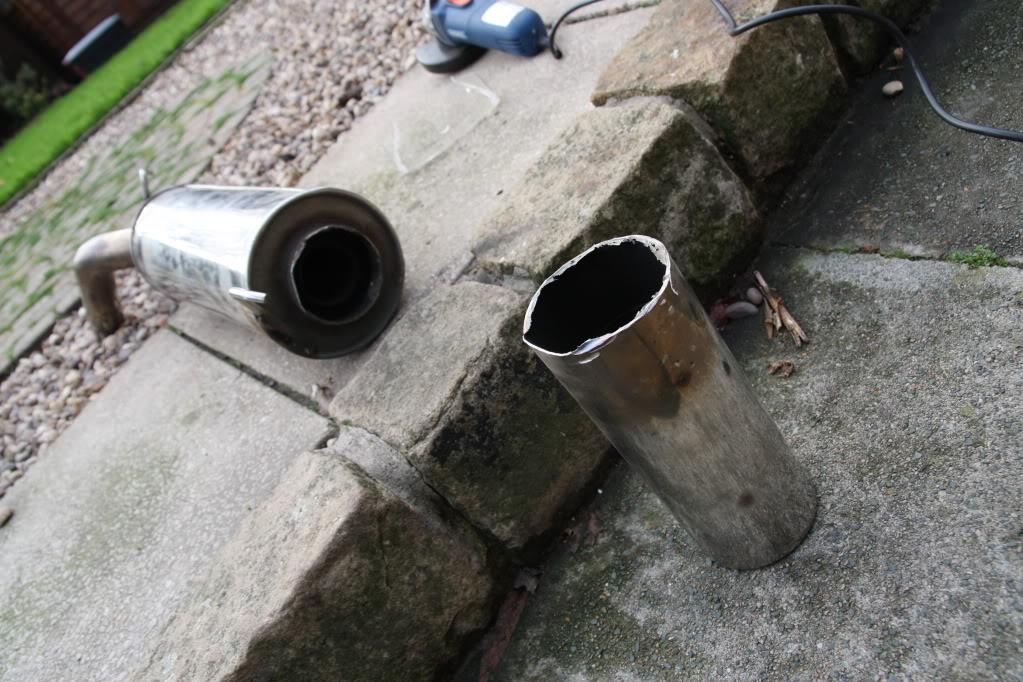

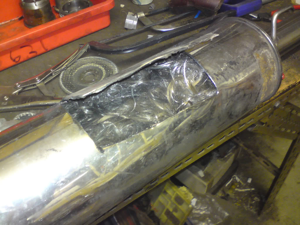

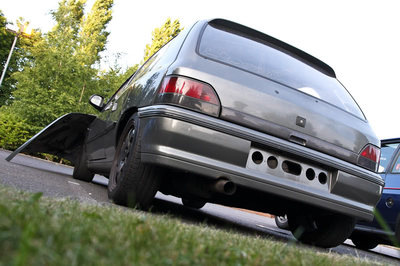

- Decat/Downpipe
- Modified Mongoose Center Section with Silencer Removed (2.5")
- Modified Mongoose Backbox with 2.5" Tip (And half the internal wadding removed)
Backbox Cut Open & Half of The Wadding Removed
Tip Removed
New Tip Welded On

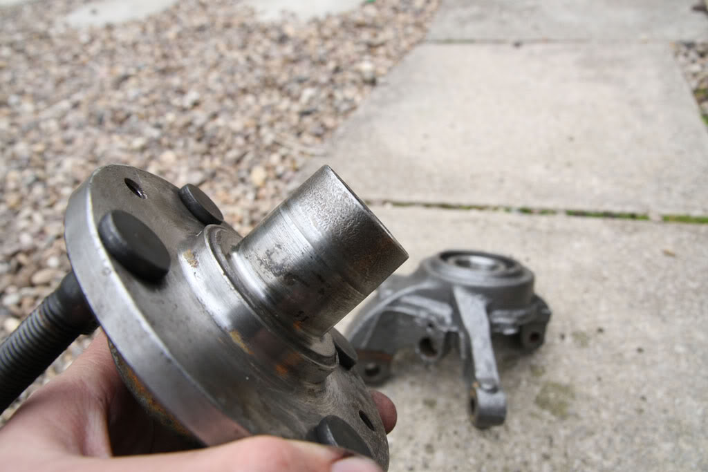

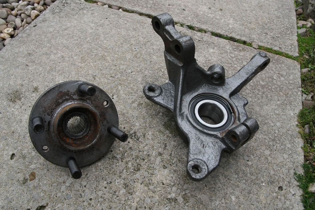

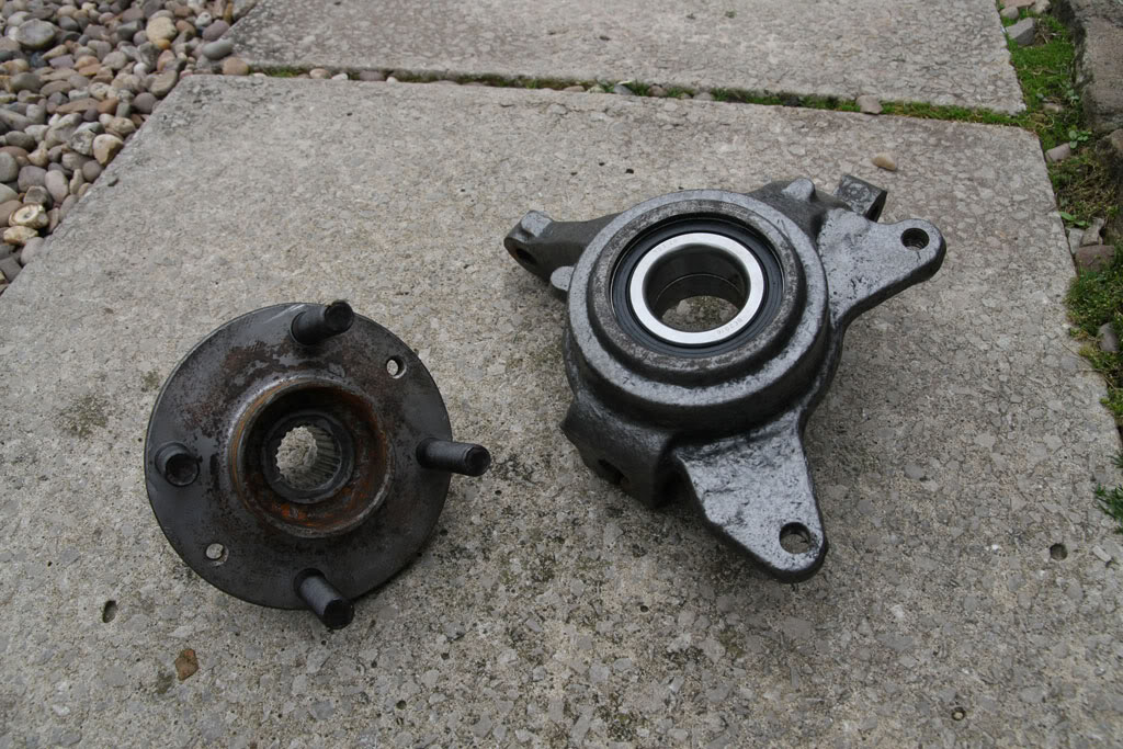

Had the car off the floor the other day and noticed a bit of play in the drivers side hub bearing (few hundred miles old). I thought the bearing was knackered already, so ECP agreed to replace it free of charge if I returned the pieces of the 'broken' bearing. When I removed the hub it was a different story, the stub was moving inside the bearing but only at one end. Either way I pressed it apart which destroyed the bearing, so pressed the new one into the upright so its ready for whenever I sort it..
When looking at the stub, you can see the right hand half of the part that presses into the bearing is smaller. When measured with the verniers it is around 0.2mm smaller than the left hand side - how I have not got a clue, never noticed it last time!
As you can see, it can just be dropped into the bearing with no force required at all, itl only go halfway before it gets tight (to the proper width), where it needs to be pressed in...
No idea whats caused it as ive never noticed any play previously...looks like its new stub/machining/studs time :(
When they turned down your hub thickness did they polish your bearing surface with emery cloth?
it looks like it has had surface rust then been cleaned up
Unsure, I turned them but had another guy clean them up for me... The other one is perfect with zero play and took a fair amount of force to press it in fully (as its always been), just wierd how this one is a loose fit and now useless!
i have seen such failure on some cars, not always renault!
all off them had really bad bearings, with almost a lot of play!
i guess that some/one off the bearings balls got milled and did destruction...
i have a hub part that looks exactly like yours, its from a opel!
handle it like a piece of scrap, it will destruct any new bearing!
Yeah - at the time the bearing itself seemed perfectly fine (only covered a few hundred miles) but no doubt it would have got worse - its just wierd that the outer half of the stub was a smaller size, it literally drops into the bearing with room to spare whereas the inner half is a very tight fit (requires pressing). Not sure how just half of the stub's bearing face has reduced in size thats the thing!
Ive got four new studs, I just need a new hub/stud now so it can be machined down and pressed together. The other side (N/S) is perfect!
