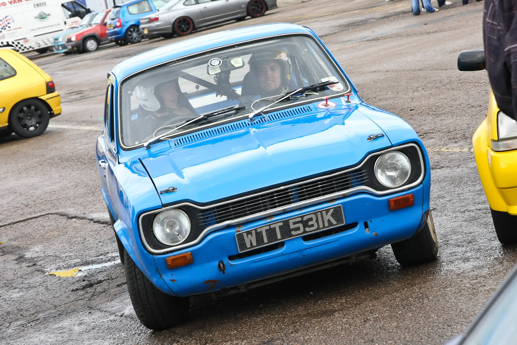

I saw that, i cant work out if it was him or his missis driving in the vids, my mate danny was going round in a blue mk1 escort aswell, not very quickly, but very sideways lol

I saw the mk1 escort drifting all over the place infront of me was awesome, looked in good nick too :cool:

Re: Mk1 F4R/172'd Track Car Project
This one?
  clio 1.8 16v, civic vti
yep, thats danny driving, the owner, and the passenger is the owner of the yellow 5 next to it...,with my old mk1 fiesta arches on it believe it or not!

that escort looks sweet.
Yeah, they were parked next to us all day, I remember the passenger in the picture driving the 5. Cant remember who was driving in the video either, but I tried to find the guy after we had come in to find out more about the 5 but he was nowhere to be seen lol.
glad you had a good day and managed to not brake anything
