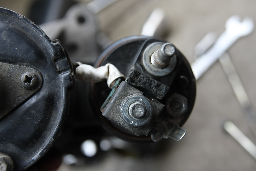

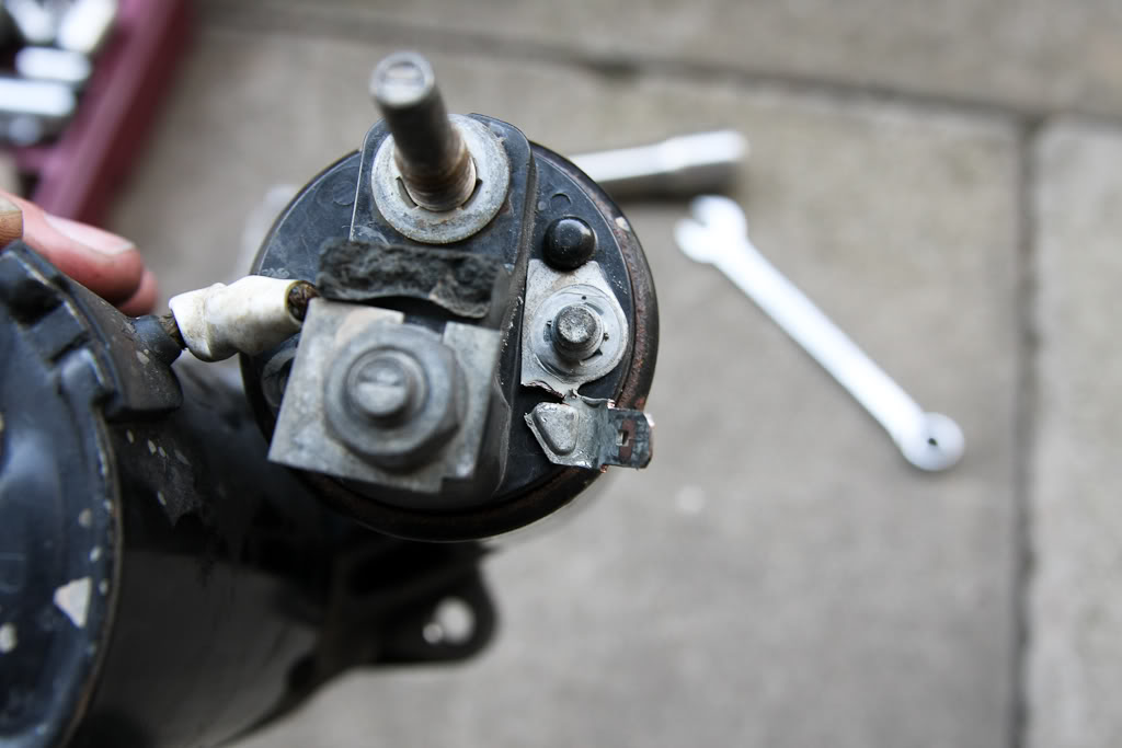

Well, the car lasted Oulton Park yesterday. Drove faultlessly, although it wouldnt start by itself so had to keep bumping it! Il do a proper update about Oulton later...
The new key barrel arrived yesterday when I was out, so I fitted that first to try it. Turned the key and nothing at all, exactly the same as yesterday. Ignition stage 2 comes on, the pump primes etc, but position 3 does nothing. So I guessed it has to be something to do with the motor/solenoid, as I dont even get a click when it goes to position 3. Ive just removed the starter and found this...
The solenoid spade connector is hanging on by a thread, its barely even touching. That might explain why position 3 was doing nothing as the solenoid wont have been getting enough power to do anything. Just about to replace the spade with one from another starter motor - so maybe its problem solved?

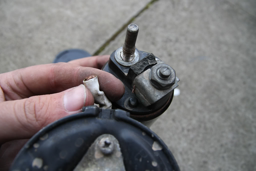

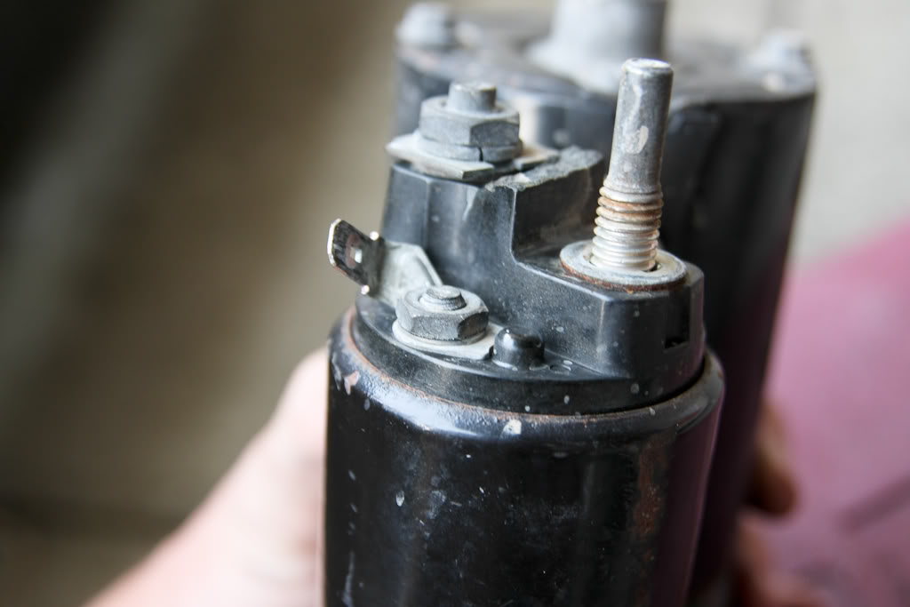

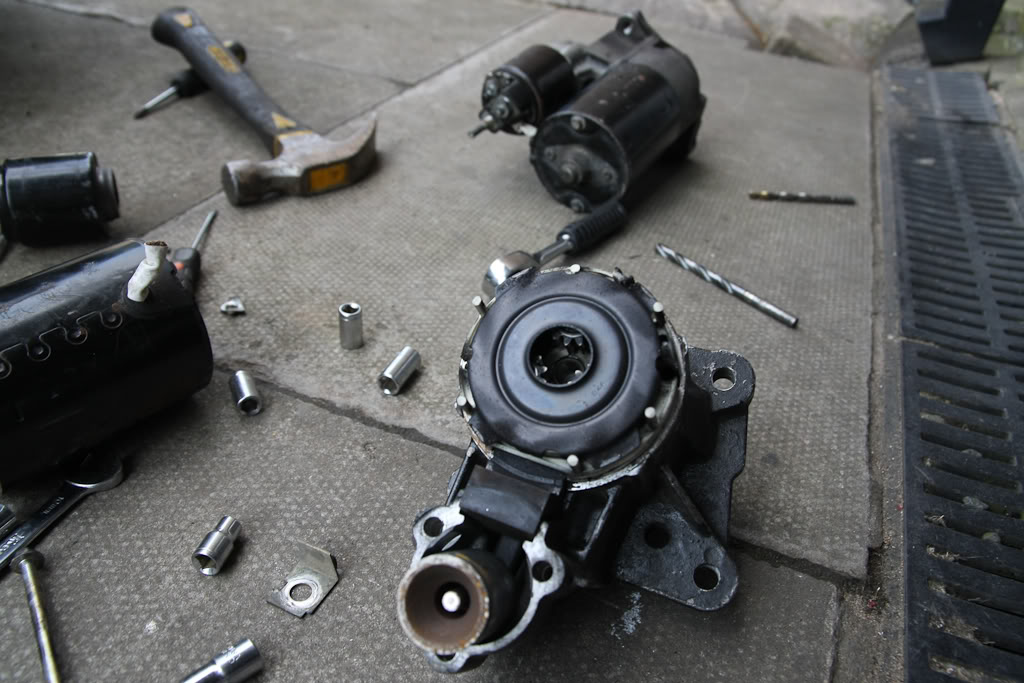

Along with the solenoid crimp I also noticed this...
That'l be why the motor wasnt turning over then. It was just resting on the metal contact but not properly connected... So I took both starters apart and made one 'good' one from the two broken ones, everything seemed OK..
Fitted it back to the car and it starts fine now, although it sounds like the motor itself is running for a splt second too long and catching the flywheel/freewheeling every time it starts. Not sure if there is something wrong with the motor or the key barrel isnt cutting the 12v to the solenoid wire straight away. Cant be bothered taking the motor off to have a look yet but im sure it has to be one or the other..
