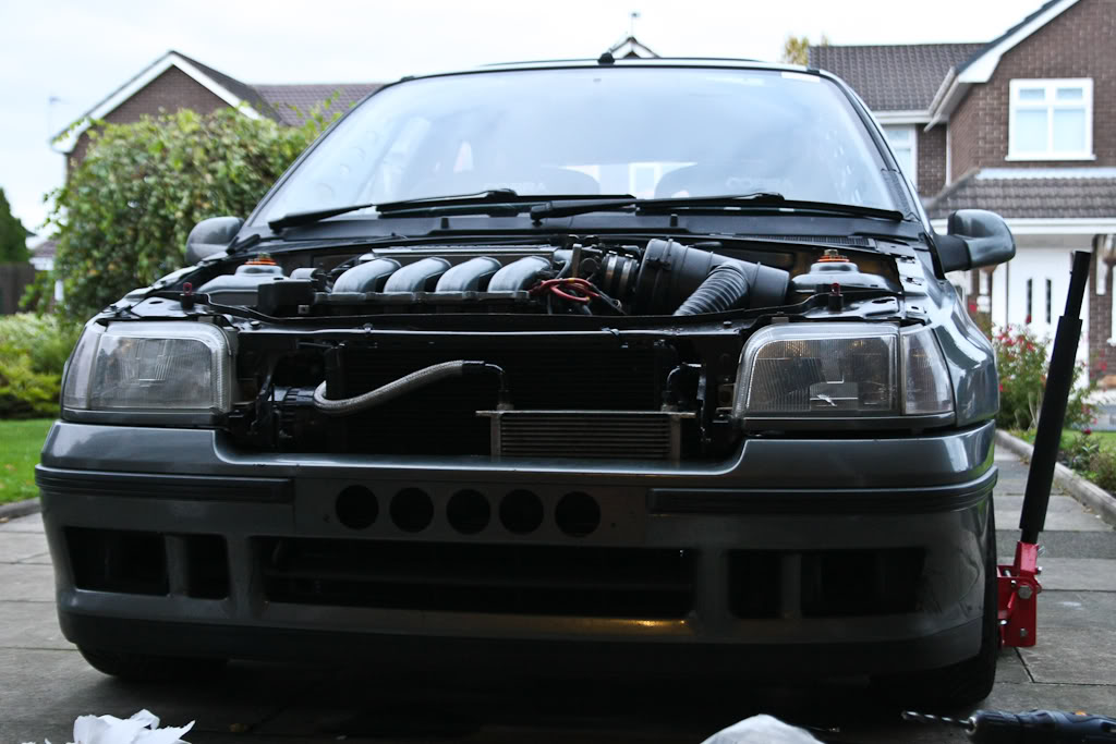

Not much been happening recently, only a few bits to sort before the end of October which will be the last day of the year at Angelesy.
Im waiting on another hub arriving so I can use the stub from it to leave me with studs on the front (as per a few pages back), after the stub I used was f*cked. Just needs machining up and new studs pressing in then it can go onto the car. Also had to replace the N/S balljoint after Oulton Park for the 2nd time this year, no idea whats making them wear out unless ive just been unlucky..

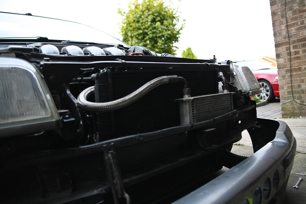

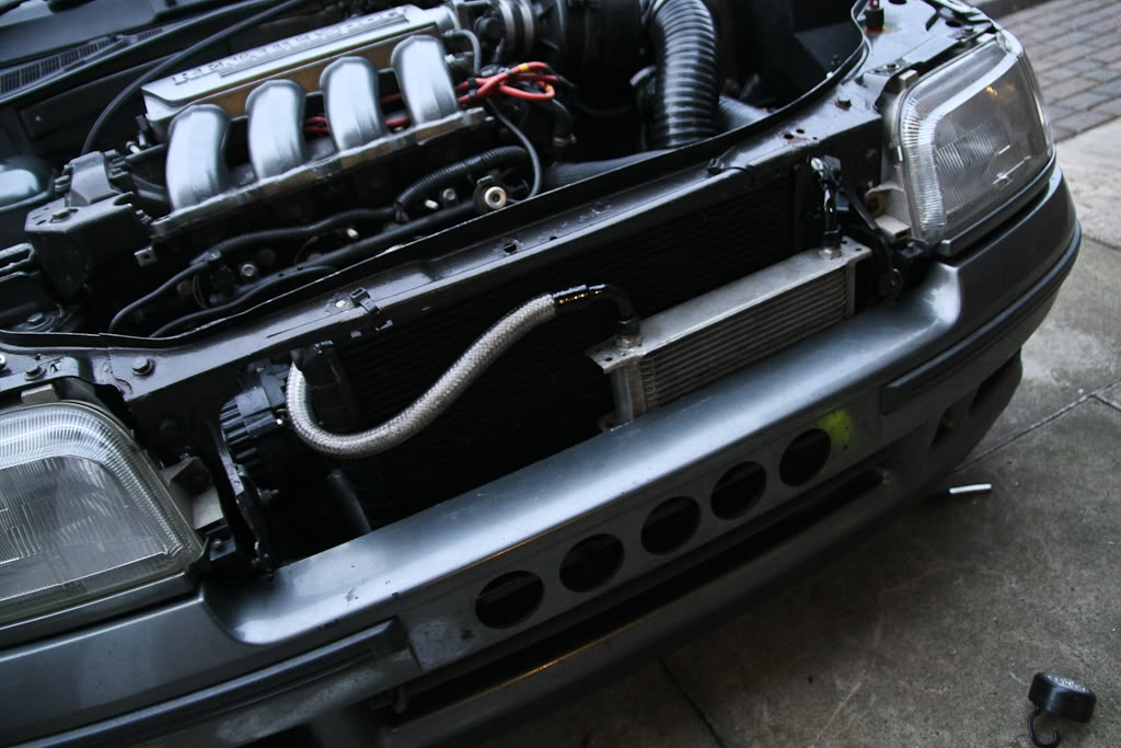

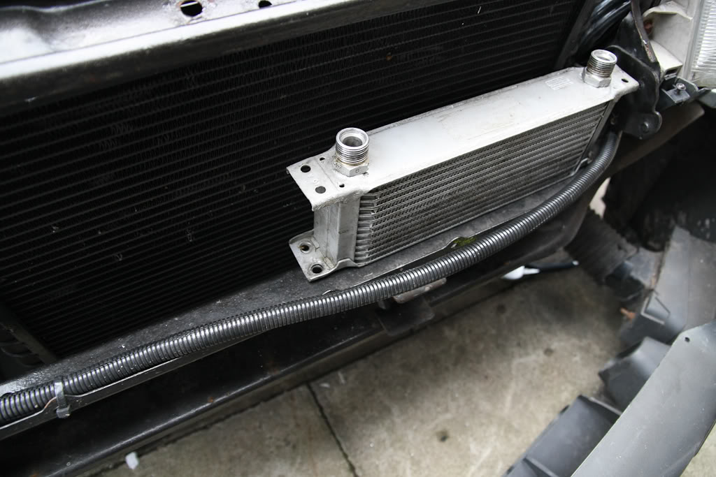

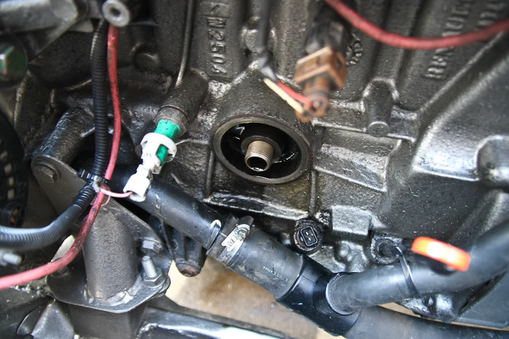

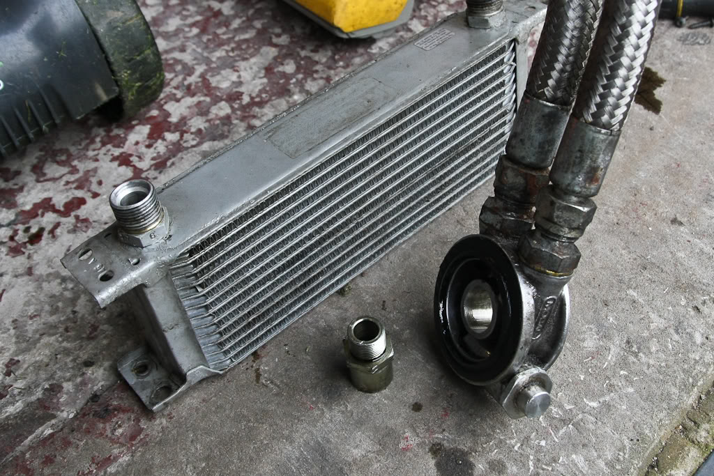

Anyway, a few days ago I lent a hand to 172Ben and removed the engine from his car for him as hes breaking it - in return he did me a favour and sorted me with his Oil Cooler. Ive never really had the need for one, as I run it on the cheapest oil and hammer it round track all day long - its never gone wrong yet over the past two years so the engine cant be coming to too much harm. Although, I suppose its a safety measure and keeps some of the heat away from the engine itself on track - dosent really matter either way for the price. So I set about fitting it today...

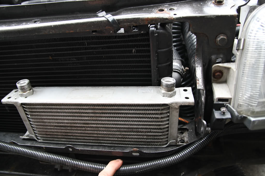

Removed the filter and decided on where I wanted the cooler. It seemed to fit well between the radiator and bumper, sat on top of the slam panel. I thought I was going to have to cut the bumper slightly but it sat well enough to not need it, and the bonnet cleared it fine once on..

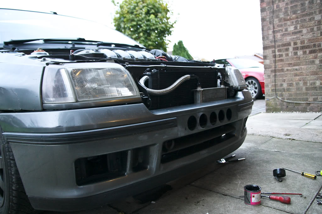

All seemed OK so drilled the holes and bolted it down to the slam panel. I had already checked the length of the hoses, plenty to play with so I decided on a route for them...
Ideally I would have liked them both down the same side, I might do eventually as its not too expensive to get a hose made to the same spec from Pirtek etc. After fitting the thermostatic sandwich plate, a new Halfrauds filter (£2.37!) and filling the engine with oil I cranked it over to get the oil round... After starting it and letting it warm up everything was fine with no leaks, so happy days. Bumper back on and you can hardly see it with the bonnet on - I was tempted to give it a spray of black to match the radiator, but that can wait for another time......
More soon!

Got a pic with it all back together inc bonnet ect
How much more oil does it take now ?? Not much more I suppose
Re: Mk1 F4R/172'd Track Car Project
I put about 3/4 of a litre more in than usual, maybe a tad more. Il grab a pic tomorrow with the bonnet on, was dark by the time I finished earlier..

Wondered what the collection of oil on the pass seat was for! It's not noticable at all with the bonnet on for sure. :)

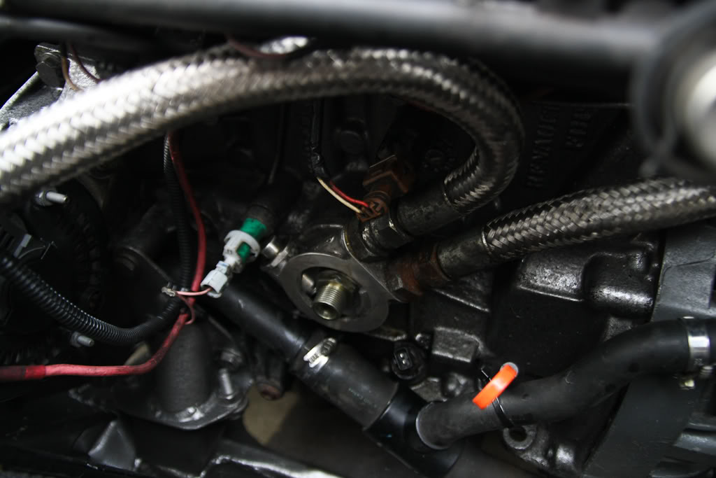

Did you renew the O ring on the sandwich plate? They have a tendency to leak if you reuse them
Should keep them temps down though so good mod
Carl
Carl
Didnt replace it, didnt even know a replacement could be bought! Checked it and cleaned it up, then ran some fresh oil round it and fitted it. Everything seems OK after checking earlier, no leaks as of yet - hope it will stay that way!
Have you got your 3 oil gauges wired up mate?
Nah I dont use the Renault ones, I run 172 clocks with a 1.2 dash top. They will work fine if wired up properly though...
Yeah you can get a replacement, keep an eye on it as mine sprung a leak on the RR after i re-fitted the sandwich plate to my new engine. Mocal recommend replacing the o-ring everytime you remove it.

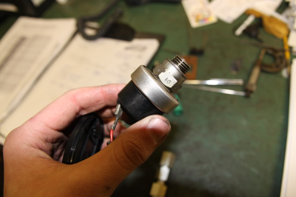

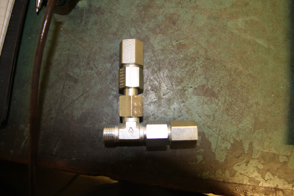

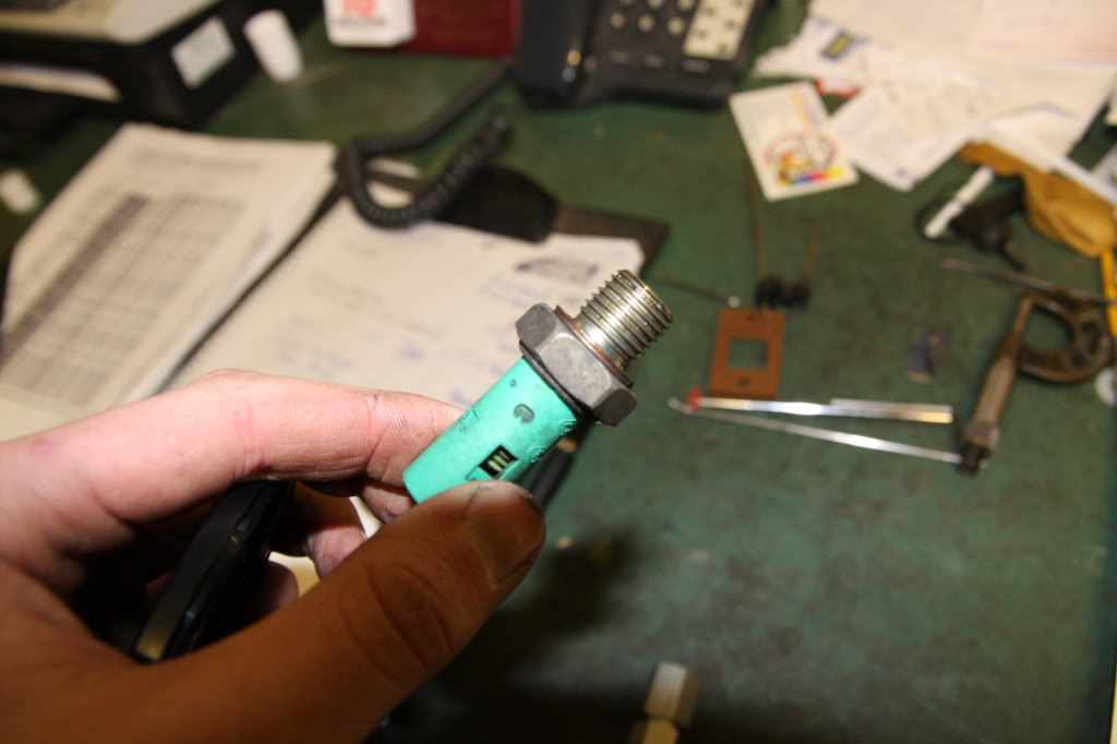

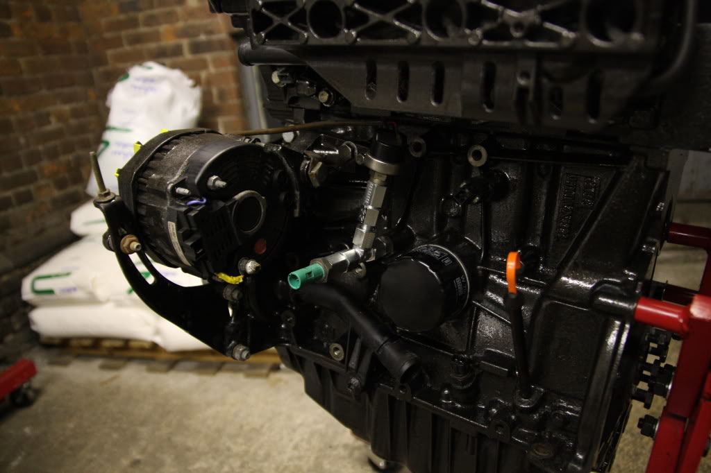

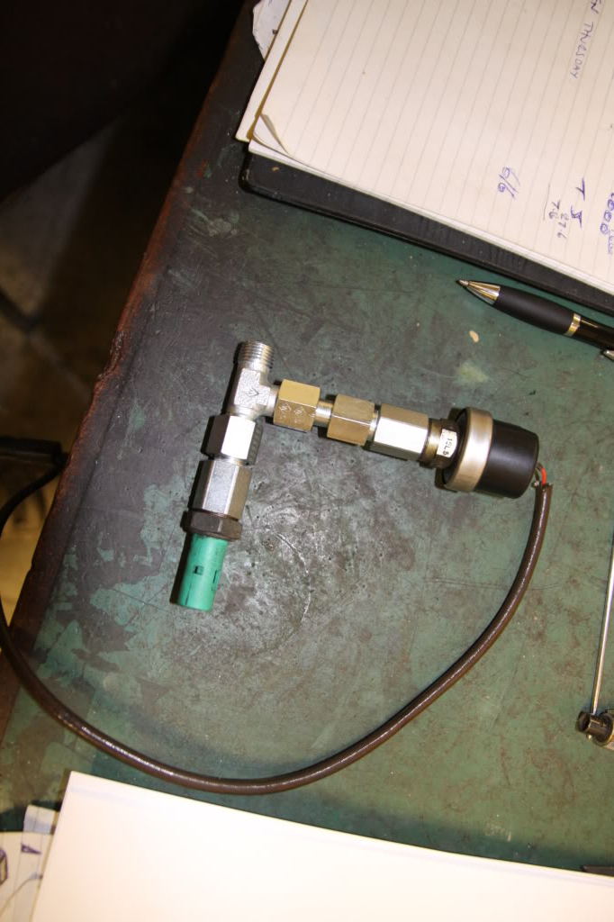

Here are a few more pics of the T-piece, the other pic was a bit crap...
Oil pressure sender...
Oil pressure sensor...
Assembled...
Fitted to the block...
Hi mate, is that oil pressure sender off the Mk1? If so where is it located? Also any details on the t piece? I have a pirtek dealer right near the workshop I use so can pop in there.

Yeah, the pressure sender is off a Mk1 - its usually on the back of the engine block drivers side. The thread is M14x1.5. The green oil pressure switch (for the dash) is the same thread, as is the hole in the block. If you go to Pirtek and say you want an M14x1.5 T-piece they should be able to sort it. Mine was a bit bigger than a normal small t-piece as I opted to have loose fitting ends, so I could position the t-piece at any angle - i.e. I could screw it in by just twisting the end and not spinning the whole thing round and round...
As for the wiring il find the PDF I made tomorrow and reply in here..
The Mk1 Oil Temp gauge isnt too hard - you need to screw the Mk1 oil temp/level sender into the engine instead of the 172 one (its like a dipstick with a connector on), then just run a wire through to your gauges to the right pin (Haynes shows the pins)..
which pirtek did you use cos pirtek in trafford said they couldn't make one up for me.
Used the Pirtek 'man' that comes to the factory (hydraulics for the machines). It took him a bit to get hold of it as he had to get the right fittings, but was spot on when he did. You could also try somewhere like Hose Solutions..
