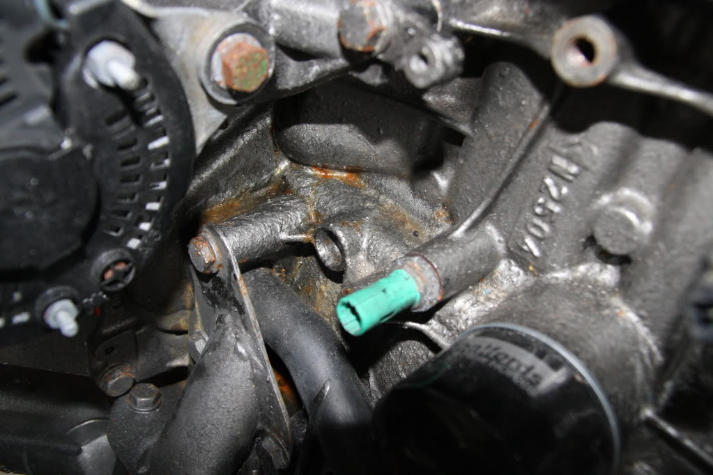

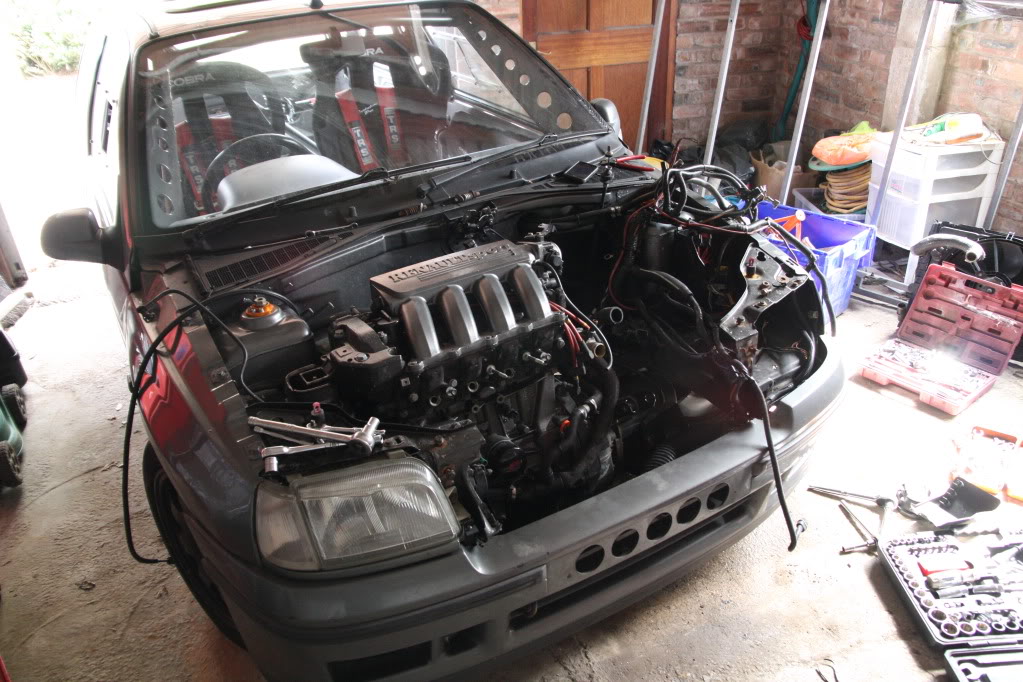

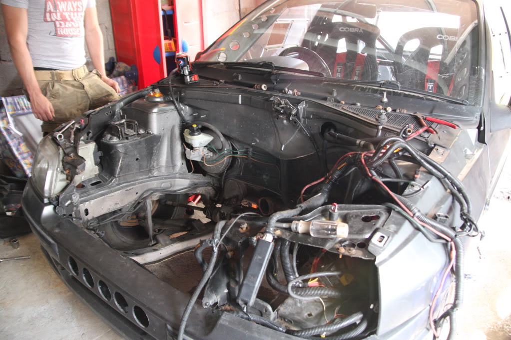

Although, got a pretty major coolant leak from the front of the block, so that will have to be looked at.
Well, a summary of this post is I have some major issues, so here goes with the details...

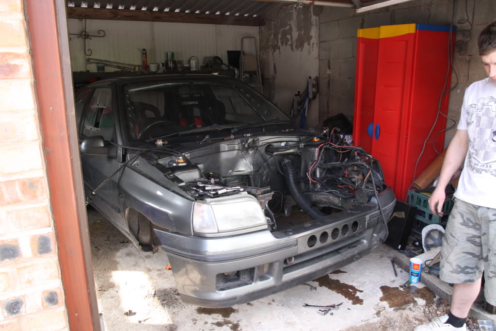

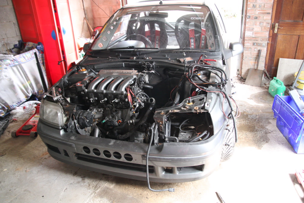

Finally got round to looking at the car today after putting it off for a couple of weeks. I was hoping the leak would be related to the plastic water pump pipe on the front of the F4 block, as I would have been able to swap it with one from another of my spare blocks, but unfortunately my hopes were not correct. First sign of it not being from the plastic pipe was water sat on the block, rusty bits in it and still weeping even though it hasn't been ran for two weeks.

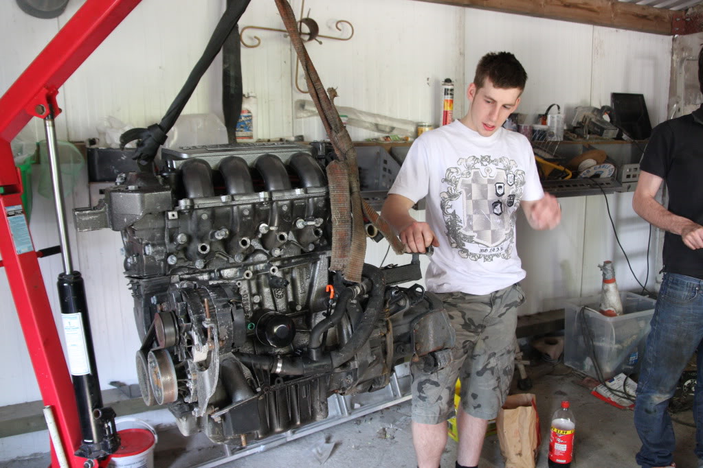

So started stripping it down ready for lifting the engine out to get a better look...

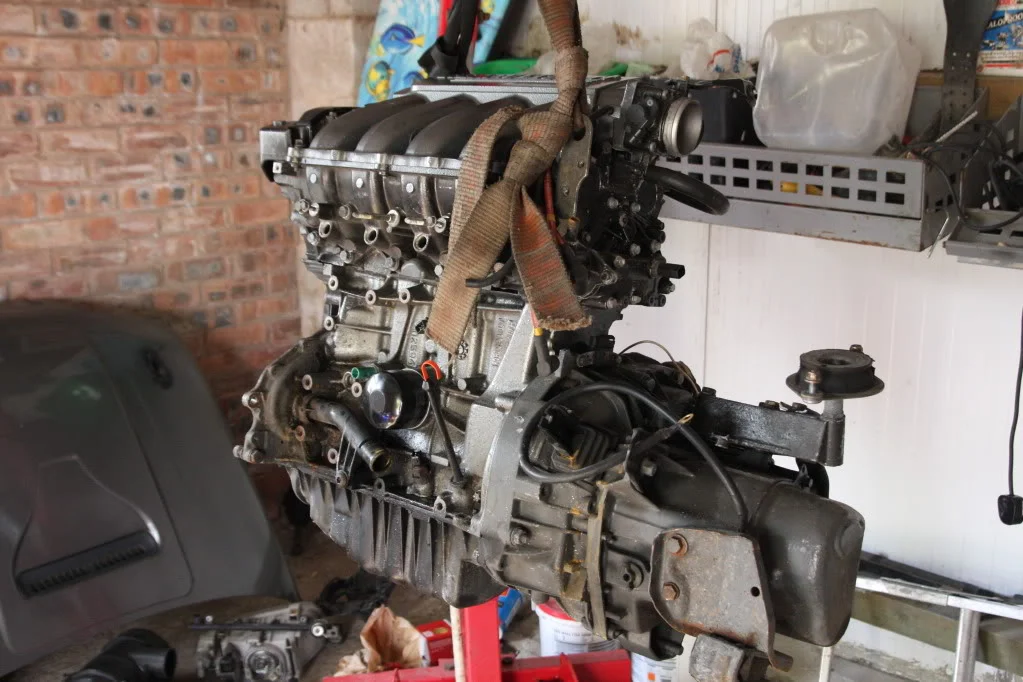

Out it came, along with Adam telling everyone 'this is how you do it!...

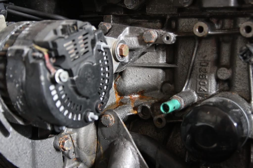

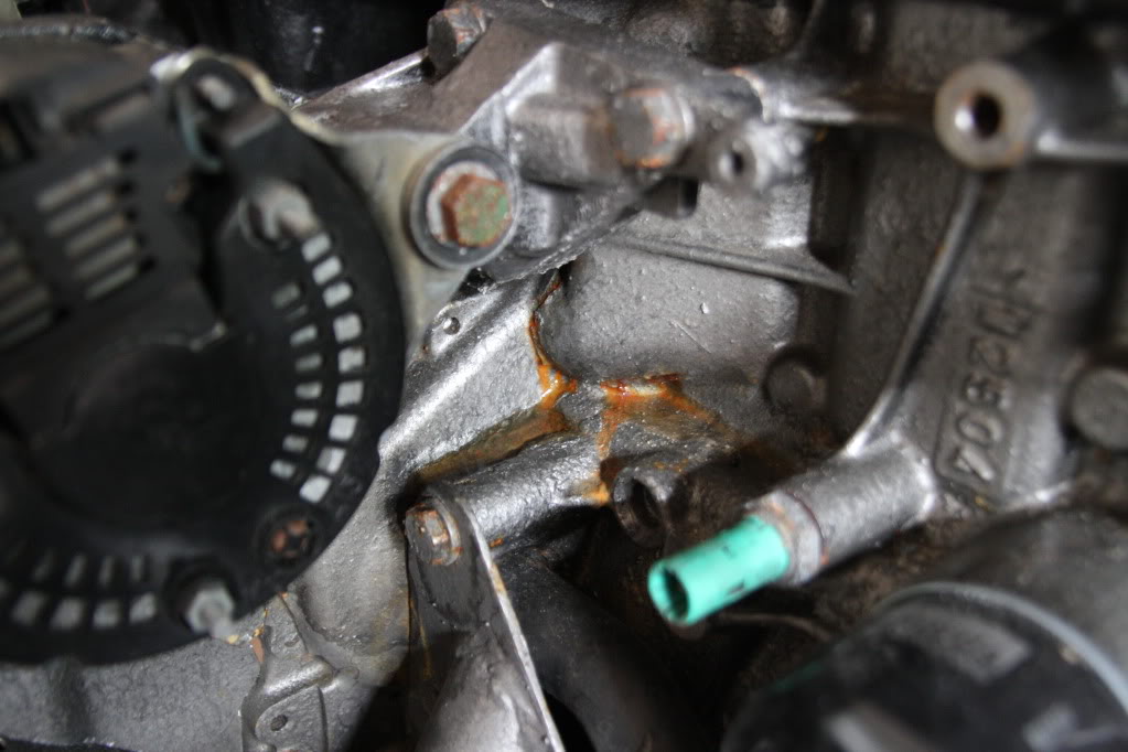

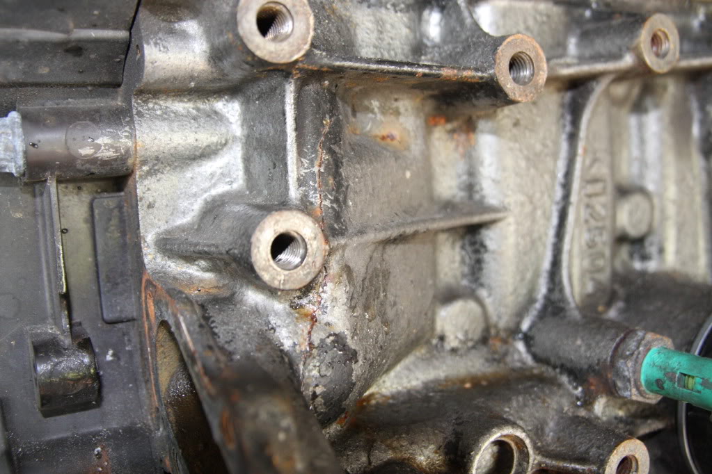

Then removed the 5th mount and Alternator setup to reveal the extent of the problem...

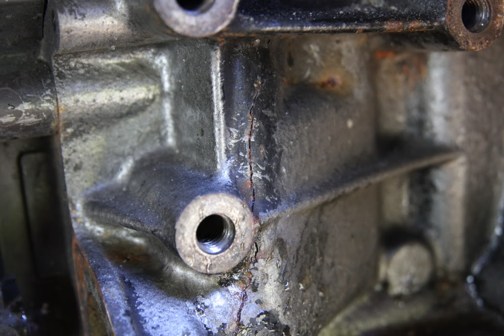

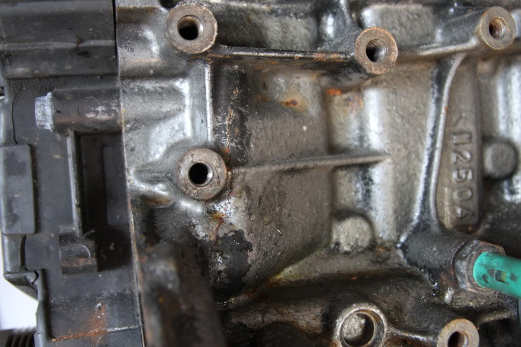

As you can see, that's one pretty hefty crack to the block. After removing the water pump and putting my finger inside the top hole, you could feel where the crack was and how everything had moved.
The weird thing is, this had 60/40 anti-freeze mix in and I started it around Christmas time (bearing in mind its been sat from October > April) which was after the worst of the winter weather and I never noticed a leak. Although its happened now and its probably just down to bad luck once again, like with the whole of this car :rolleyes:

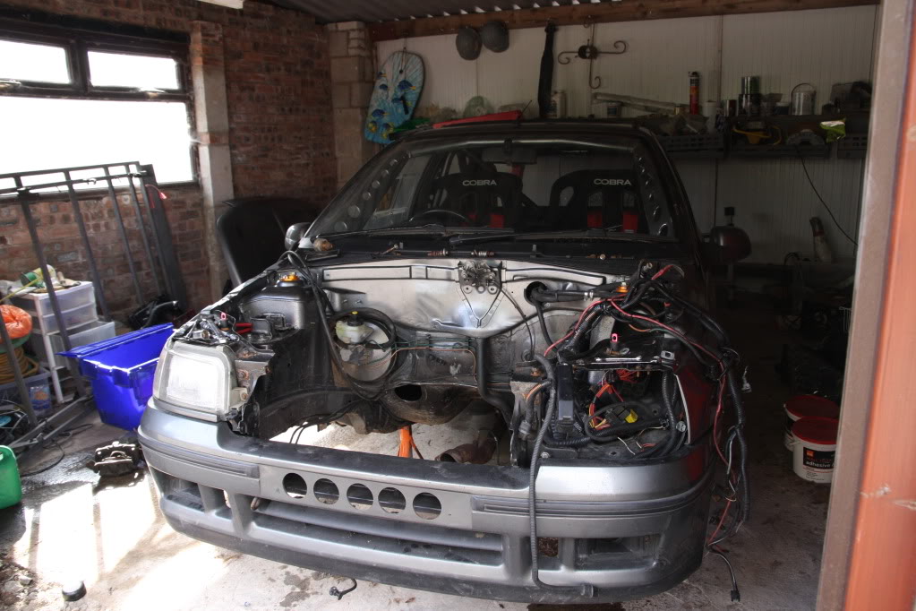

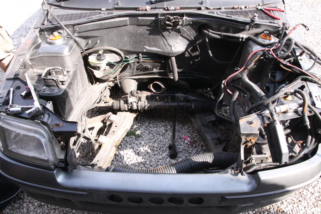

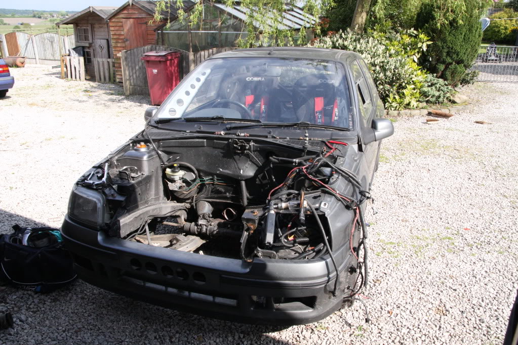

Anyway, pushed the car outside to turn it around...

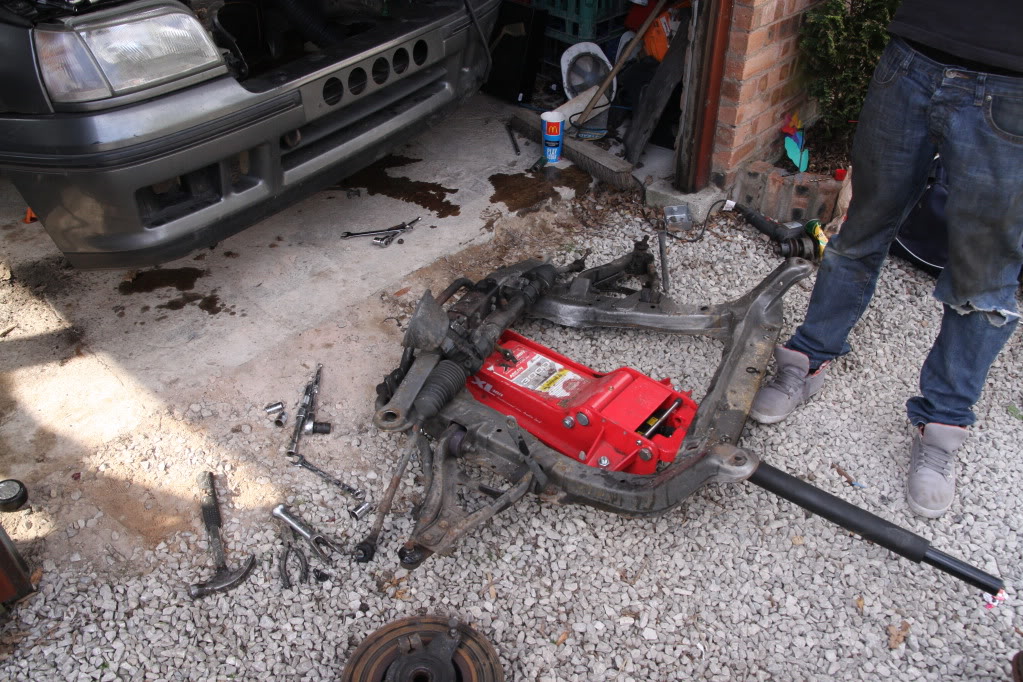

...as I had decided the subframe/wishbones etc are in a state, so just went ahead and removed the whole lot. Going to clean everything up and re-fit it all at some point along with new track rod ends and ball joints as all the boots/gaiters have split on them. Calipers need sorting too as the seals are split, along with new discs and pads to fit.
Threw that in the back of the car and left the Mk1 until I decide what to do about the engine, really don't know what the plan is yet.
I guess I've got some thinking to do :boring:

core plugs?
odd place for it to crack due to freezing, also its next to 3 bolt holes - a naturally weak area
simply from over tighening the bolts holding the bracket to the block can cause issues like that (not necessaryily in this case, normally common on ali blocks)
Re: Mk1 F4R/172'd Track Car Project
core plugs?
Yeah, the start of the crack was hidden behind the alternator 'block', ends just above the 5th mount. All the core plugs are fine both front and back... Never usually put bolts mega tight, just 'normal' i.e. the same tightness as they always have been. You can put your finger into the block with the water pump off and follow the crack along to the starting point, which I'm guessing is where coolant may have been sat considering it hadn't moved or even been ran.

Nah no leaks, didn't even notice it when I went to check/start it around Christmas time. Yeah, luckily its got a garage (in the pictures) local to me for now!
