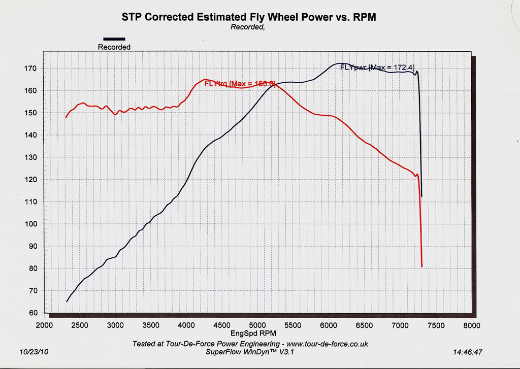

7800rpm, well it bounces past that on the clocks. Its just the data plot on the graph thats incorrect.
  JDM Dc2
Re: Mk1 F4R/172'd Track Car Project
ah right, just watched the video and thought 'yeh it bounces the limiter but why is the graph 500rpm short' lol

I'm surprised the remap keeps in closed look at full throttle, see how odd the torque curve looks below 4K, do you have the AFR curve to overlay?. With my near solid mounts the engine sounds horrible down there, and only sounds crisp above that. I know you have an old version RS Tuner map, so maybe that changes with the later version.
Unfortunately not, I think something happened to the lambda probe early on in the day and I was one of the last cars to run so never got an AFR readout. It doesnt feel like the graph looks when driving for some reason (up down up down) but who knows, maybe I'm just used to it...
And yeah, my RSTuner 'Group N' map is the 2008 one I think..
Yeah, it does sometimes until it feels like it 'picks up' very quickly. Although it does not feel like that all the time... it always had its days
