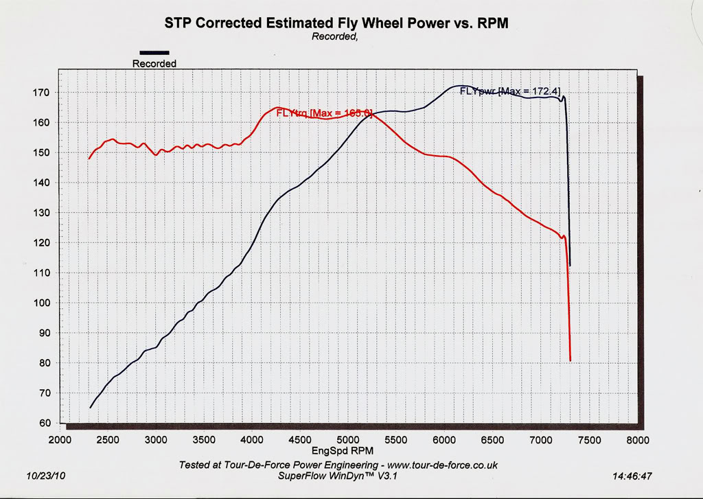

Went down to the Rolling Road day at Tour-De-Force yesterday to finally see what figures the car was producing. It ended up making 172.4bhp and 165.0lb/ft. Really pleased with the torque figure, and how it holds pretty much 170bhp from 6000rpm all the way to the limiter without trailing off.

cracking results that. isn't almost the same as what whiteley run last year at rs tuning.
did adam run?

Mine was 172.0bhp and 162lbft last year at RS Tuning, and from what I've seen, both TDF and RST's rollers are near identical. So yeah, pretty much the same. Wonder what mine would do with GroupN map.

Yeah - 167.5bhp 150.2lb/ft
shame you no longer have rstuner, could log the coolant temp and see if it's the gauge or not
Its been fine for a while (touches wood). Ever since I had all the coolant system drained again last week and replaced the gearbox-to-chassis earth..
Probably a b00st in torque and a change to the shape of the graph..
thats good, cos wasn't he worried about the health of the engine
i really should get mine done and see how it performs
also what causes the torque to tail off so much?
Re: Mk1 F4R/172'd Track Car Project
Not entirely sure, but I'd probably guess its down to the design of the engine/exhaust manifold/inlet.
Adams was OK, but it was thought he was down on a fair bit of torque - probably down to the bottom end/piston rings which we thought anyway due to the amount of oil it uses. 2min30 onwards in this video gives a good demonstration lol.
