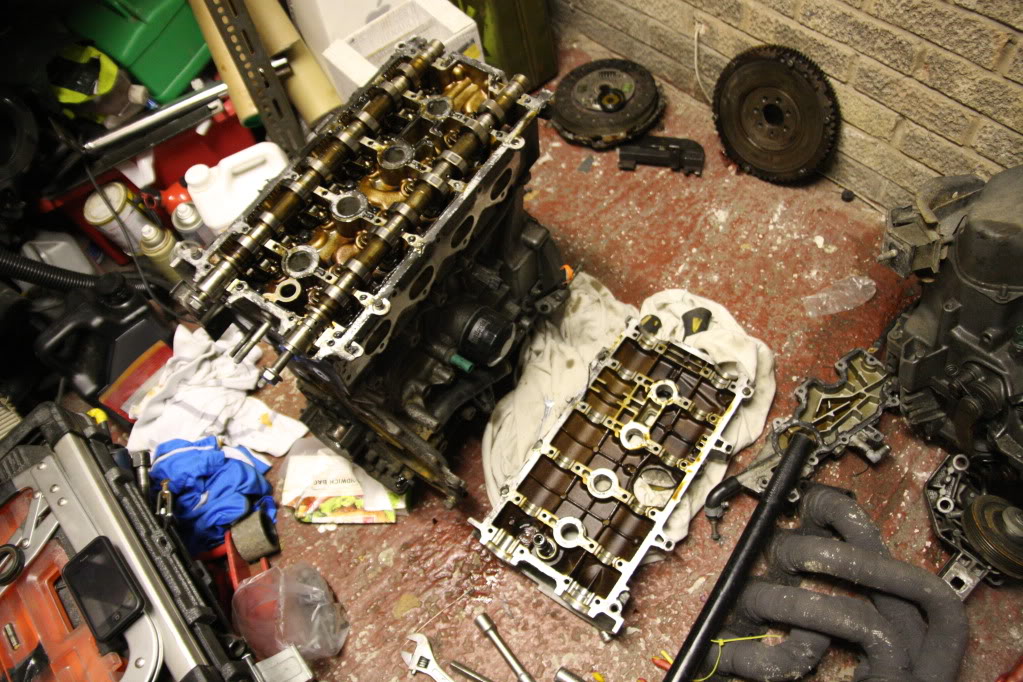

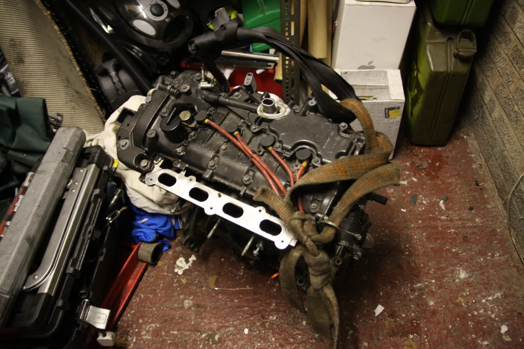

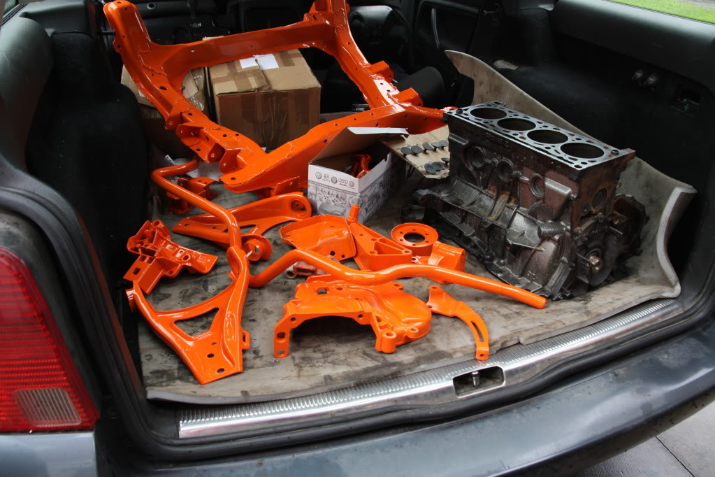

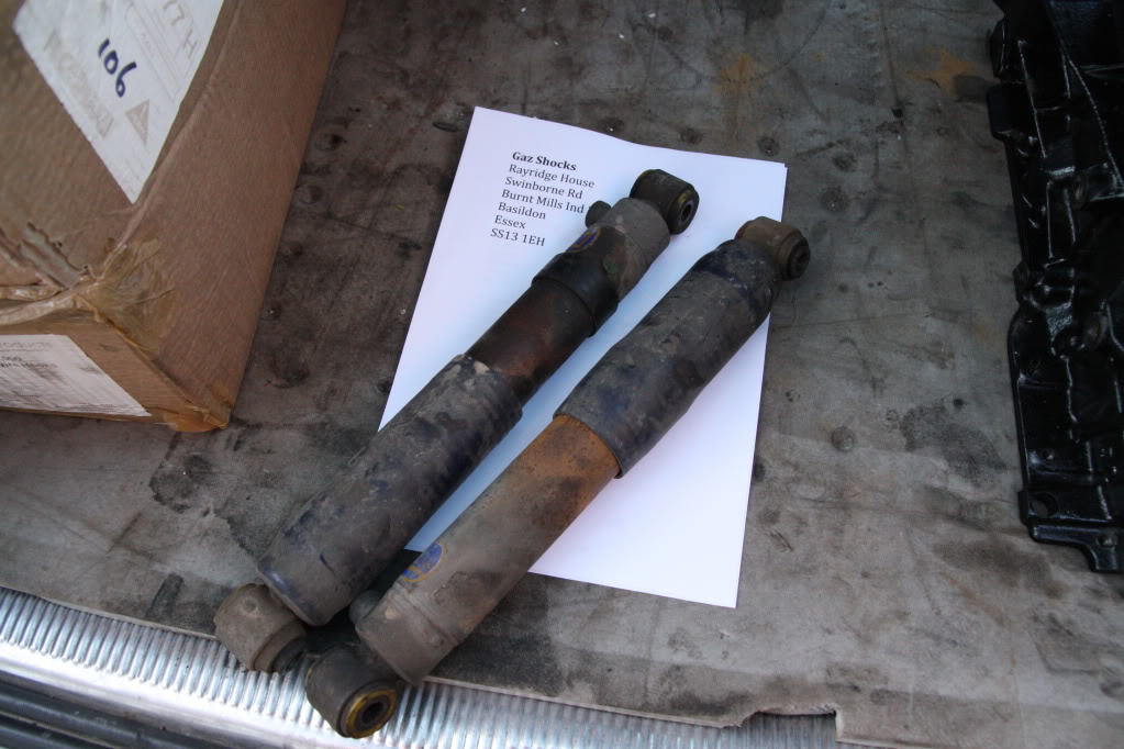

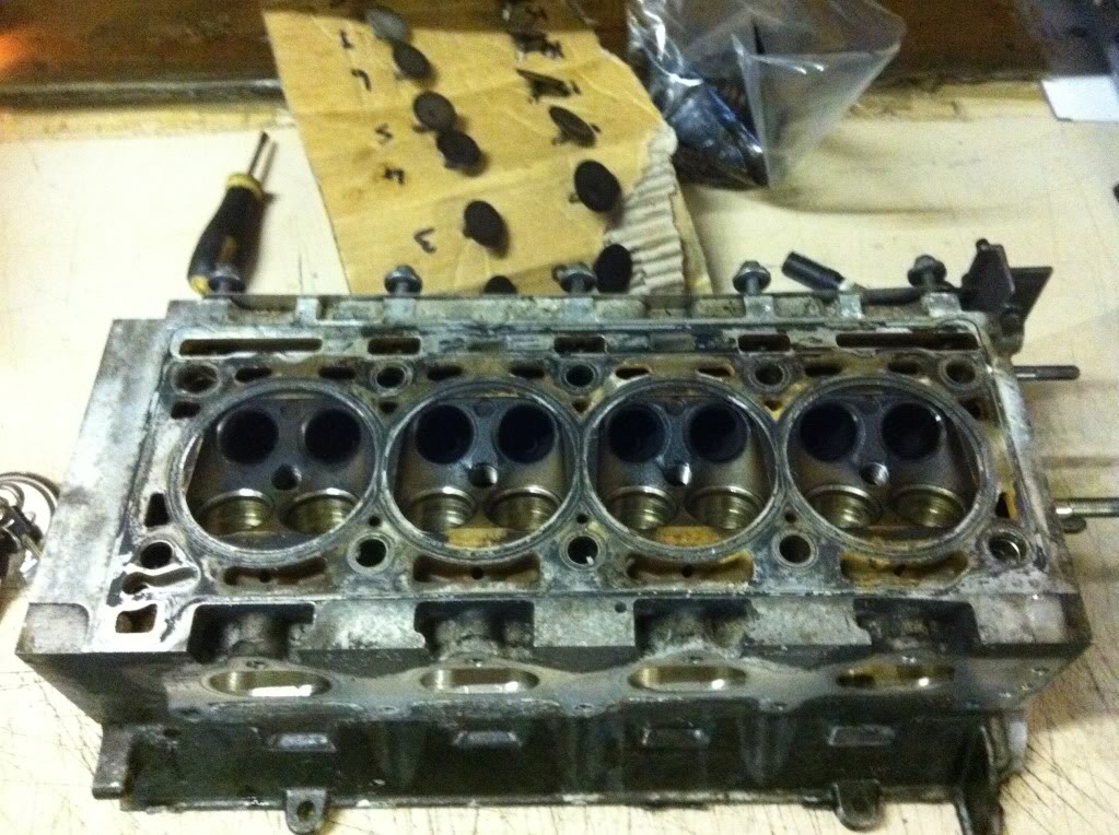

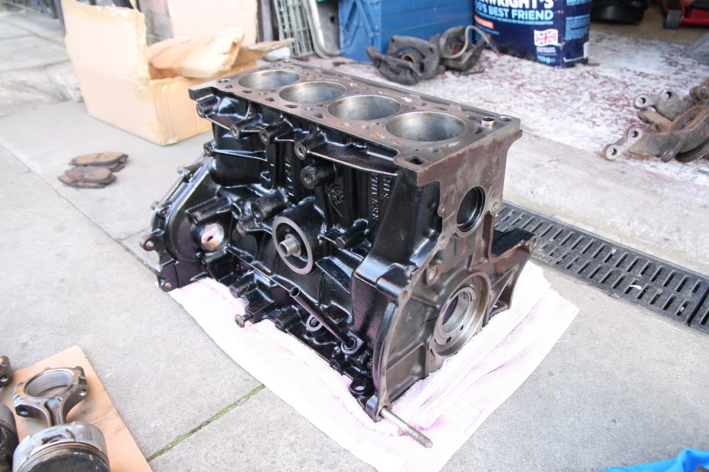

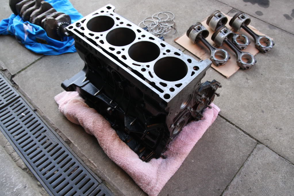

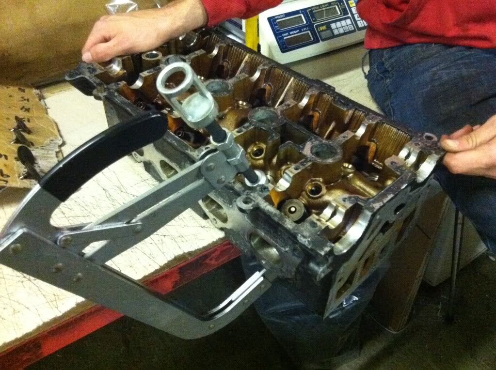

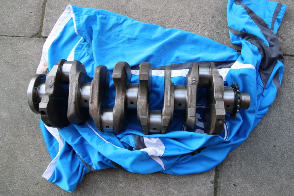

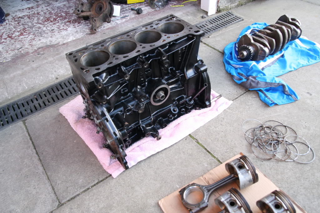

Engine block and head were dropped off a few days ago to have the machine work done, so I should have those back early next week. I also had a phone call from Gaz yesterday saying my shocks are ready, which was a pretty quick turnaround!

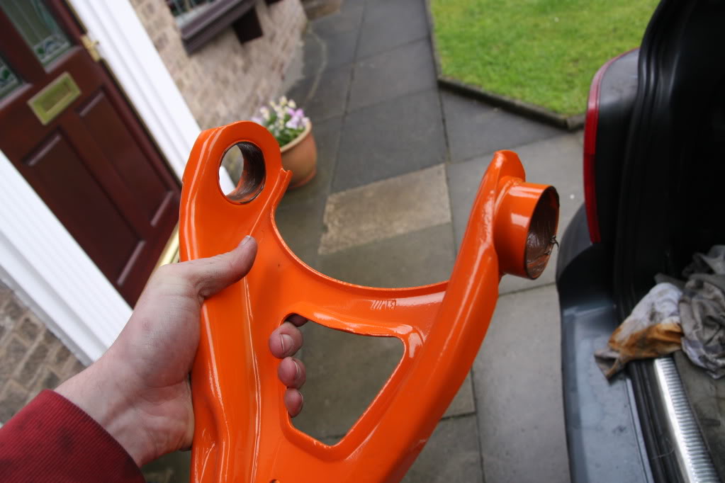

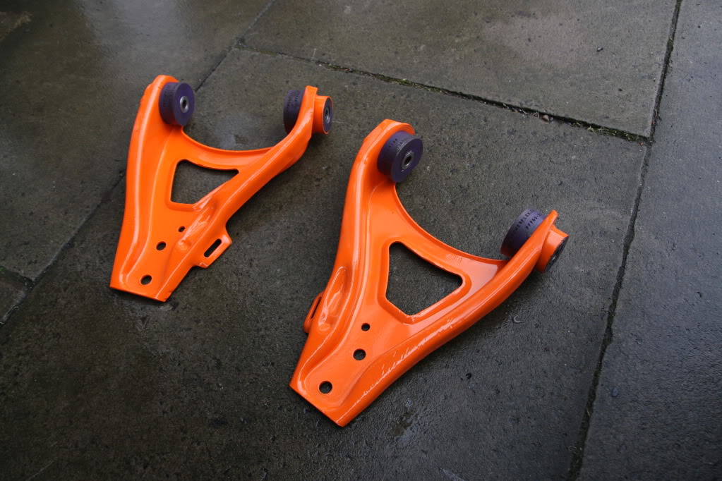

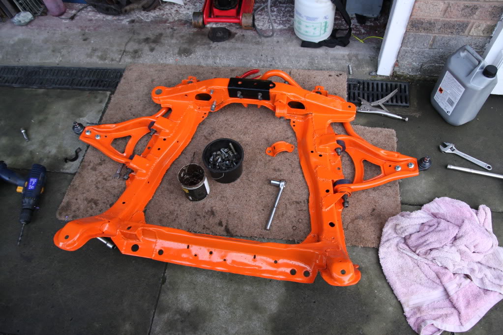

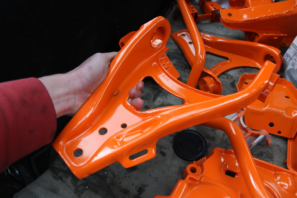

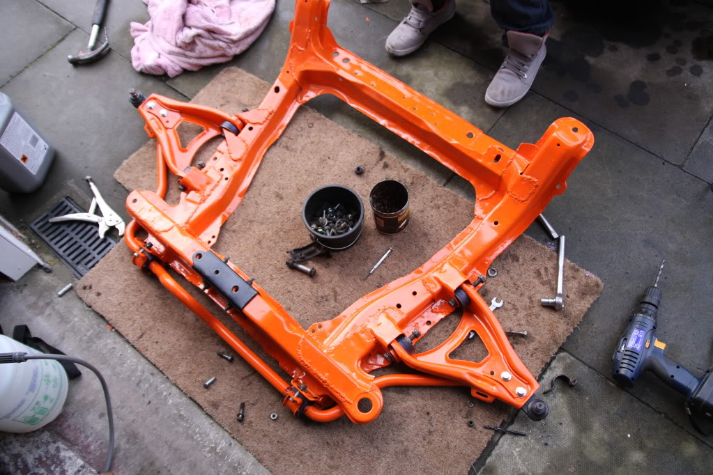

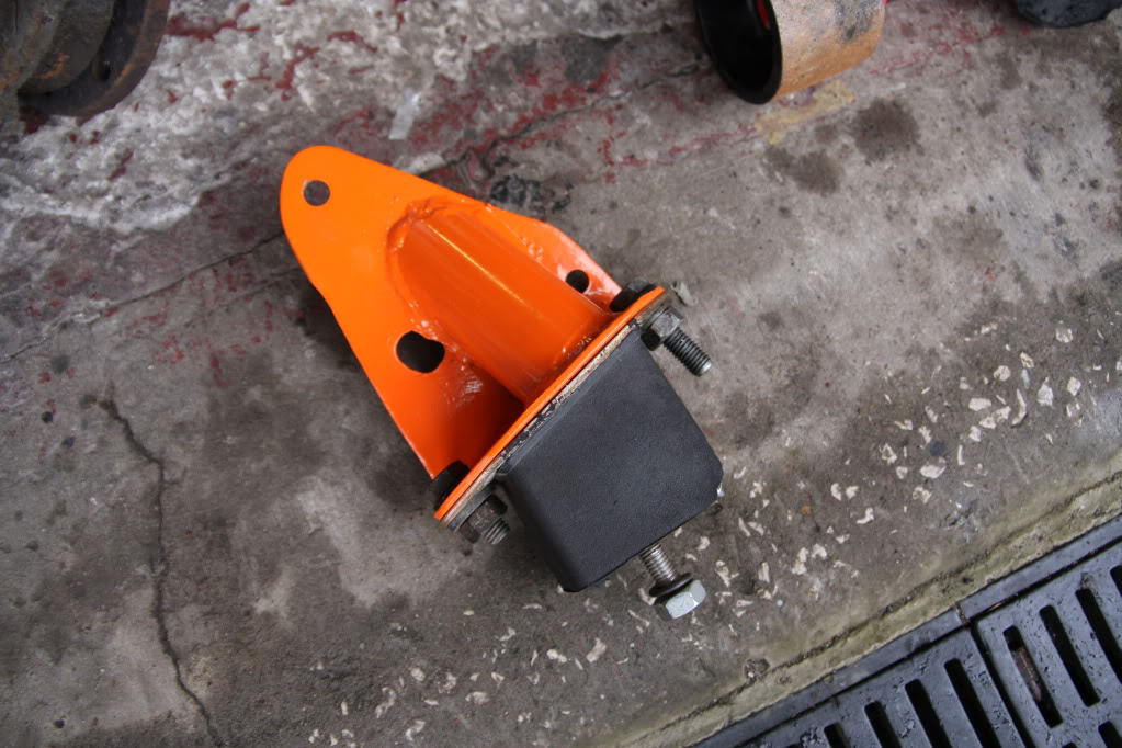

Picked up the subfame/brackets/everything that had been powder coated yesterday also. Originally everything was going to be done black again, but ended up getting it done the color you see for half the cost

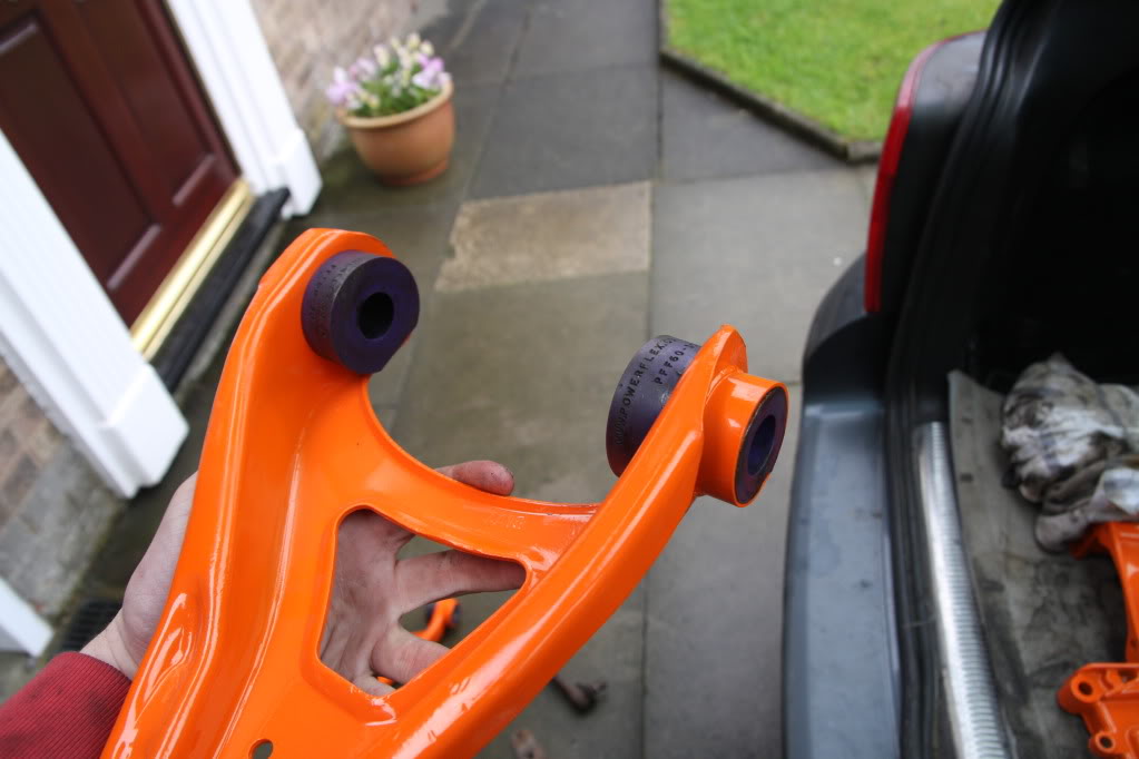

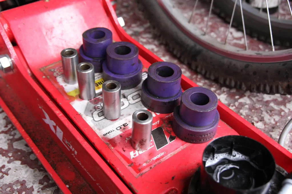

Started by cleaning up the old bushes as they were pretty manky, wonder wheels did the trick..
Copper greased the inside of the sleeves...
Pressed them into place..
Then fitted the center sleeves...
Next was to fit a new R5GTX rubber to my 5th mount, as the other one had been on for over a year...

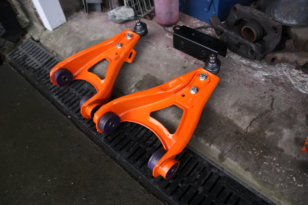

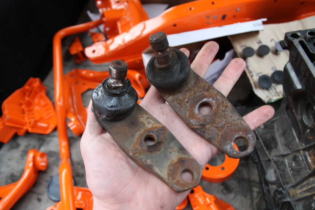

I also thought that these would probably need replacing..
So picked up a new pair earlier last week for a couple of quid each, who says 1*2 ball joints aren't available separately? They are the same as many other Renault models. Fitted them to the wishbones with the Williams strengthening/bracing plates..

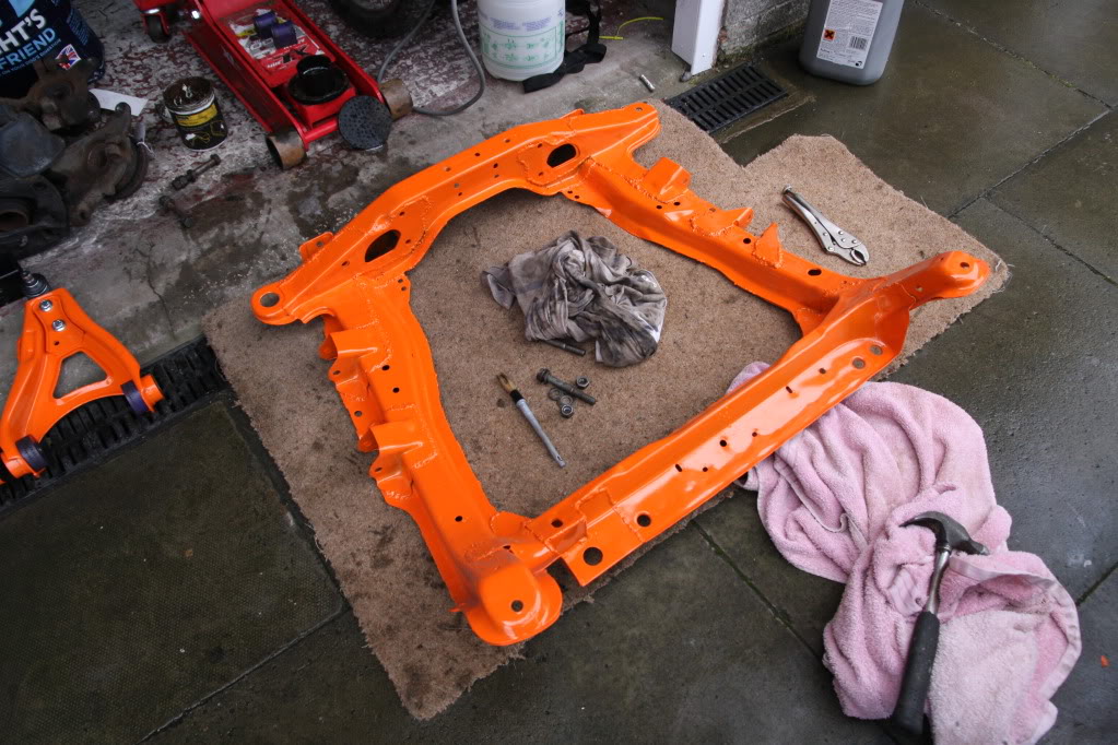

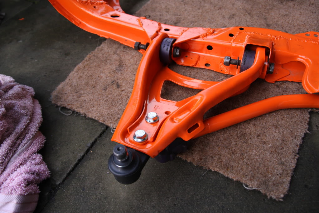

Then got the subframe out so I could fit the wishbones to it..
Then hit a problem as I realised the ARB I got from Bongy is actually a Trophy ARB so its slightly too wide for the Mk1 Subframe..
Although nothing I cant sort with a bit of modification today
I left it at that with the subframe, will probably carry on with it later today.

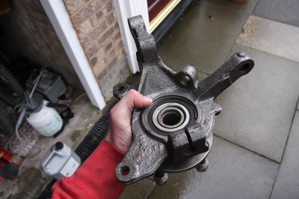

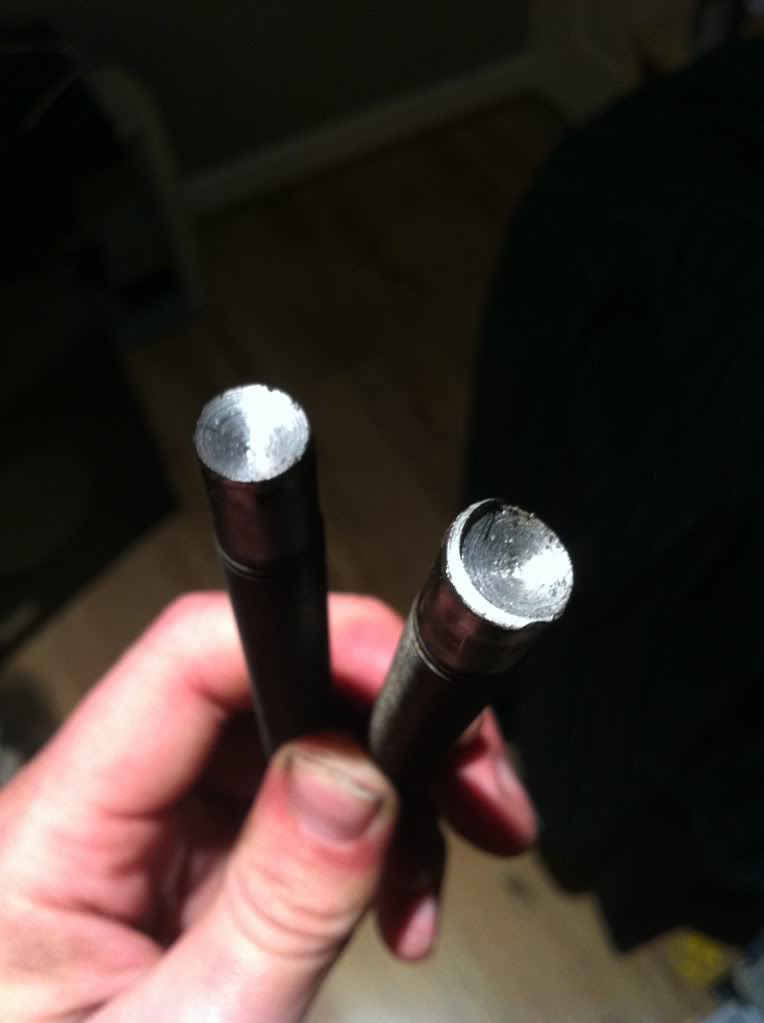

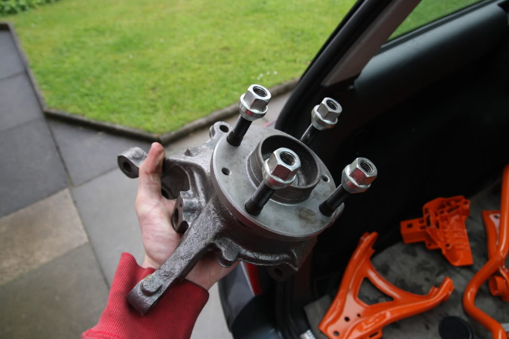

Early last week I finally got my other hub sorted (after 7 months), after this:
http://www.cliosport.net/forum/show...ssis-Rebuild&p=7000994&viewfull=1#post7000994 - Basically had another stub machined up, then got four more studs. Pressed it all together with a new bearing so I am now left with two studded hubs ready to use

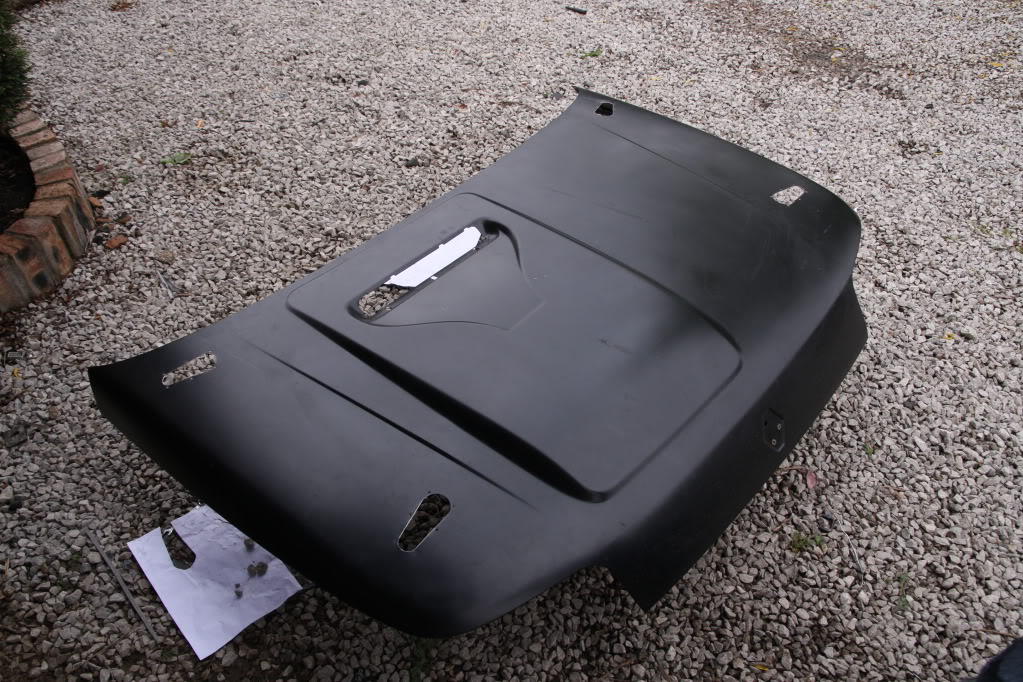

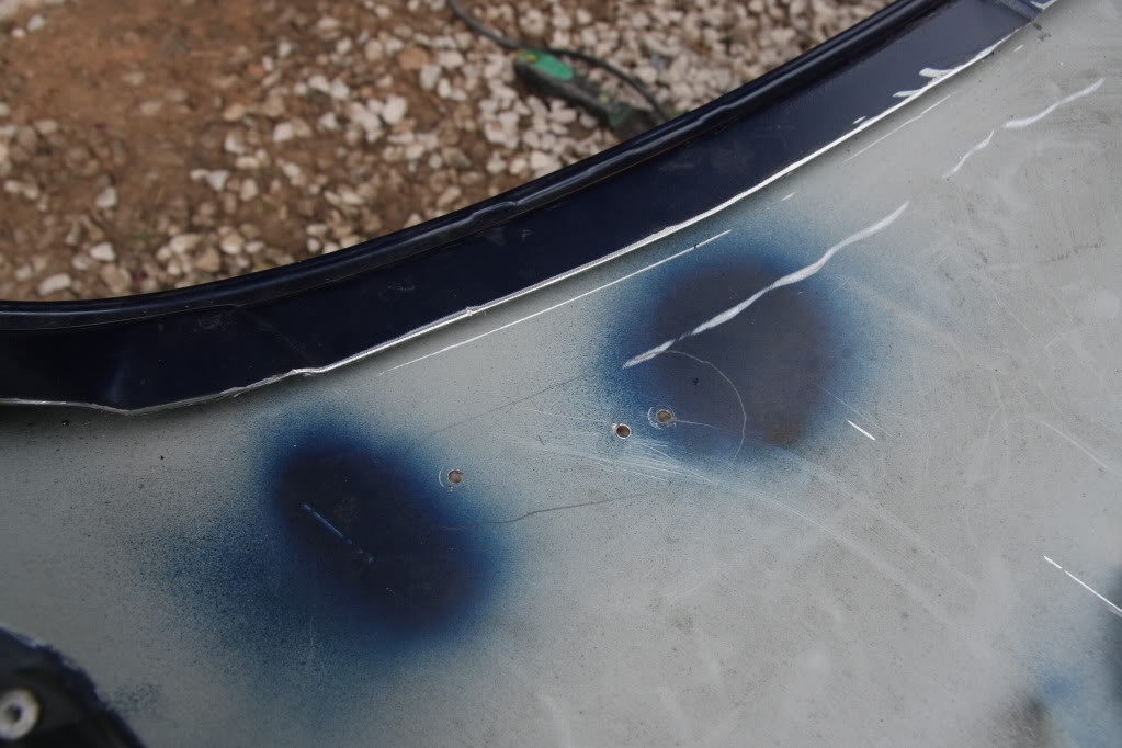

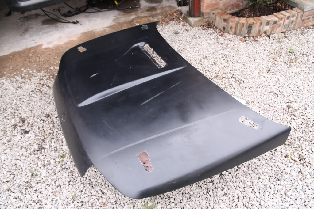

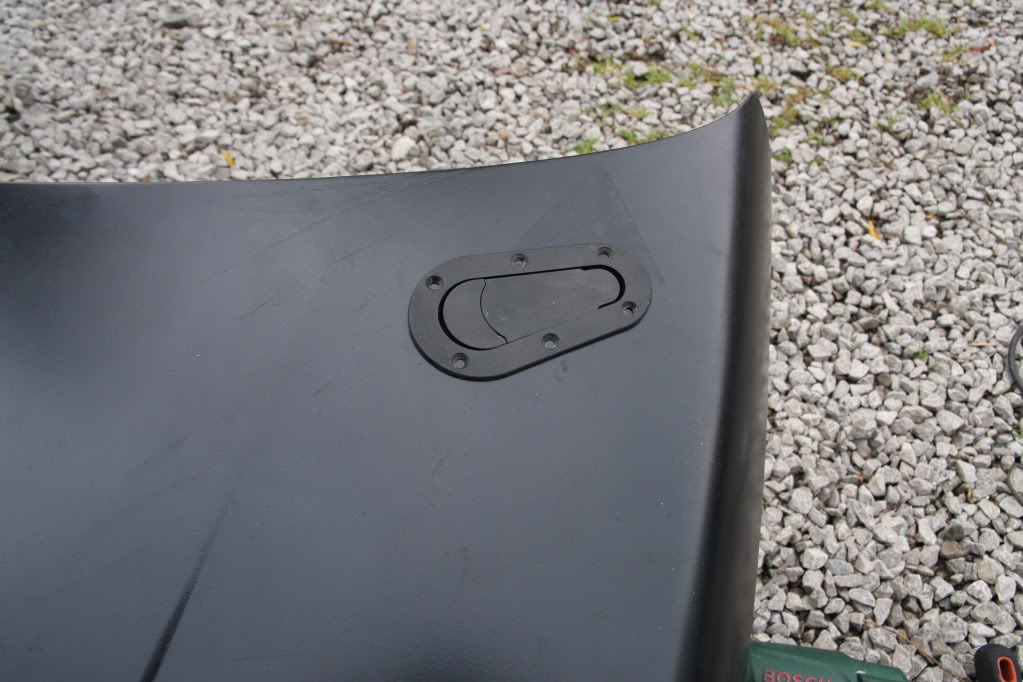

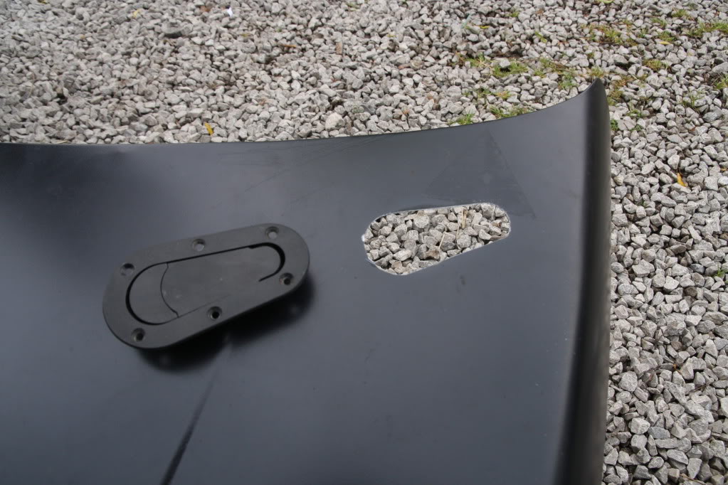

Oh, and these arrived for the back of the bonnet too...
Just waiting for it to be back from being painted now. More later!
