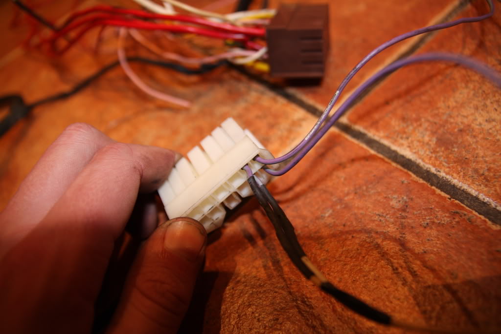

Day 136

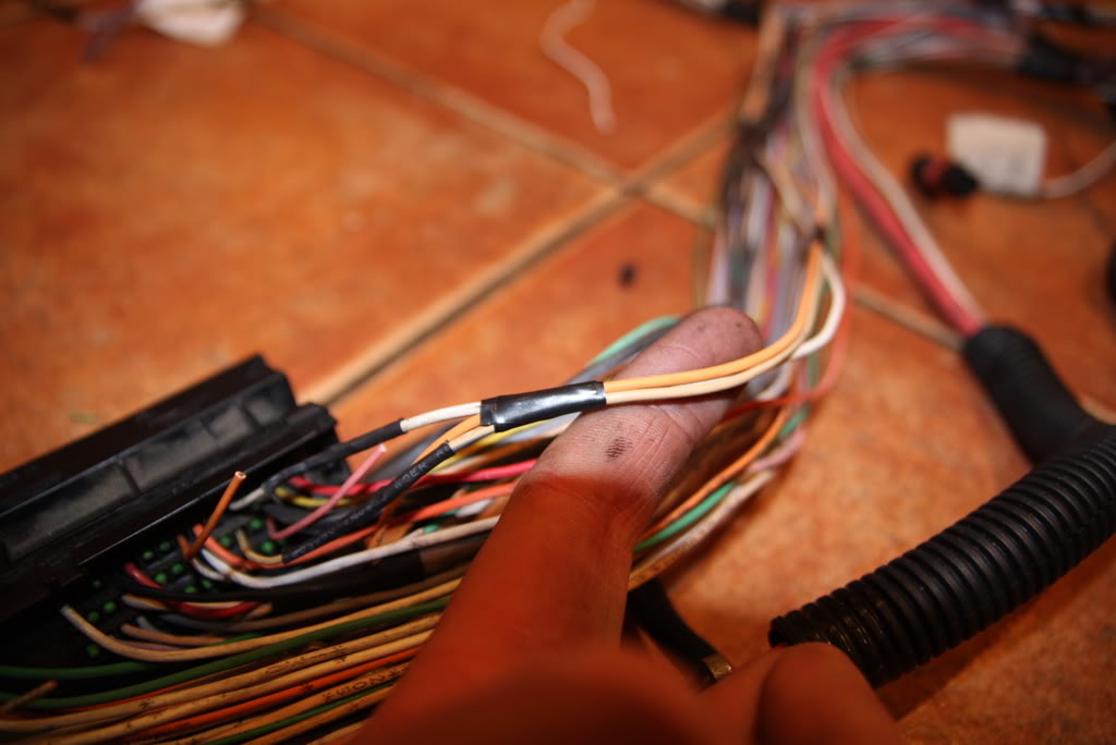

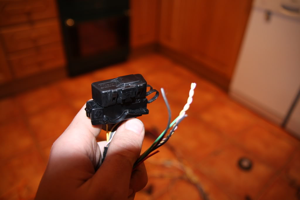

Had a few more wires to run to complete the loom tonight, these included the two diagnostic pins on the ECU connector, so I can wire up the OBD connector inside the car. Instead of running bare wires through the engine bay from the ECU to the inside, I decided to wire the pins into the spare unused connections on the connector blocks...alot tidier.
Also speaking to Matteh after noticing the 'Shift Light Output' on the ECU pinout, asked him had he got it working, although he has yet to, I decided to run the wire from the pin through another spare slot on the connector block incase I can ever get it working, hopefully I will.
This resulted in 3 wires coming from the ECU connector...
Into the spare slots on one of the connector blocks...
Also wired in a second oil pressure wire, as the 172 only has an oil pressure sensor to show the light on the dash, not to show the operating pressure. I am going to run the Mk1 Oil pressure sender on the F4R, to allow the oil pressure guage to work, this is why the second wire is required...
Took a bit of time to trace and remove the OBD connector from the 172 interior loom also, eventually worked it out and removed it, this will be wired onto the other side of the connector blocks on the inside of the car, matching the slots that the ECU has been wired to (as above)...
More soon!

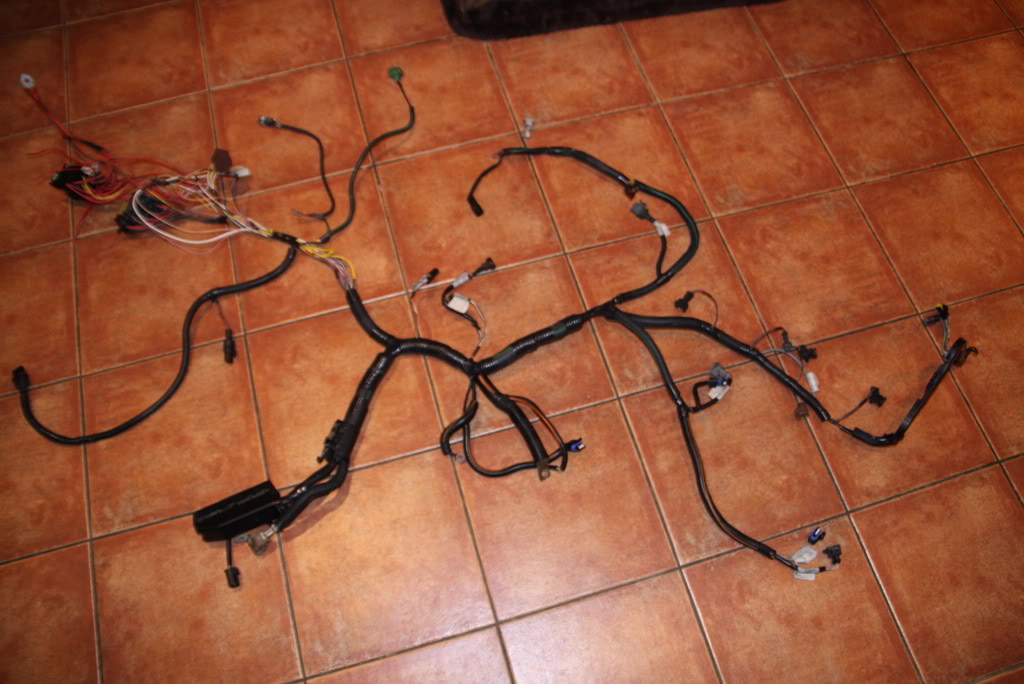

Day 138
Firstly, little bit of fun...
Quite a while til those go on yet though, lol...anyway...
Finished (ish) the engine loom before, everything is wired in that needs to be, onto the valver connector blocks, ready to plug and play, ive just gotta sort the constant lives (top left).
All in all, Removed from the loom was: Air Con Wiring x 2, Speedo Sensor Wiring, 172 Oil Level Wiring, 172 Alternator Wiring, Carbon Canister Wiring, Power Steering Sensor Wiring, and quite a few wires that lead back to the ECU from the 172 connector block.
Added to the loom was: Mk1 Oil Level/Temp Wiring, Mk1 Oil Pressure Sender Wiring (To allow the Mk1 Oil Pressure Guage to work), Mk1 Alternator Wiring, Mk1 Coolant Temprature Sensor to run alongside the 172 Coolant Temprature Sensor (Mk1 Sensor Drives the Dash, 172 Drives the ECU)....Plus a few other bits added for the future, the two OBD-II diagnostic lines to the ECU (Ran back to the Mk1 Connector blocks to keep it tidy), and the signal wire for the Shift Indicator Light from the ECU in the same fashion.

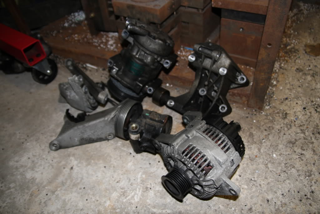

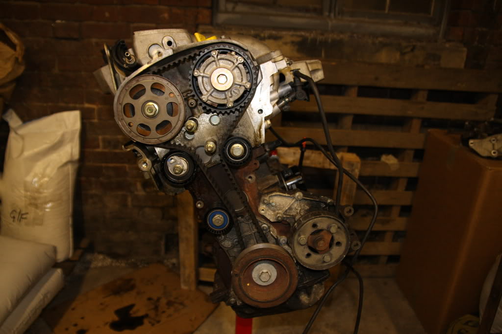

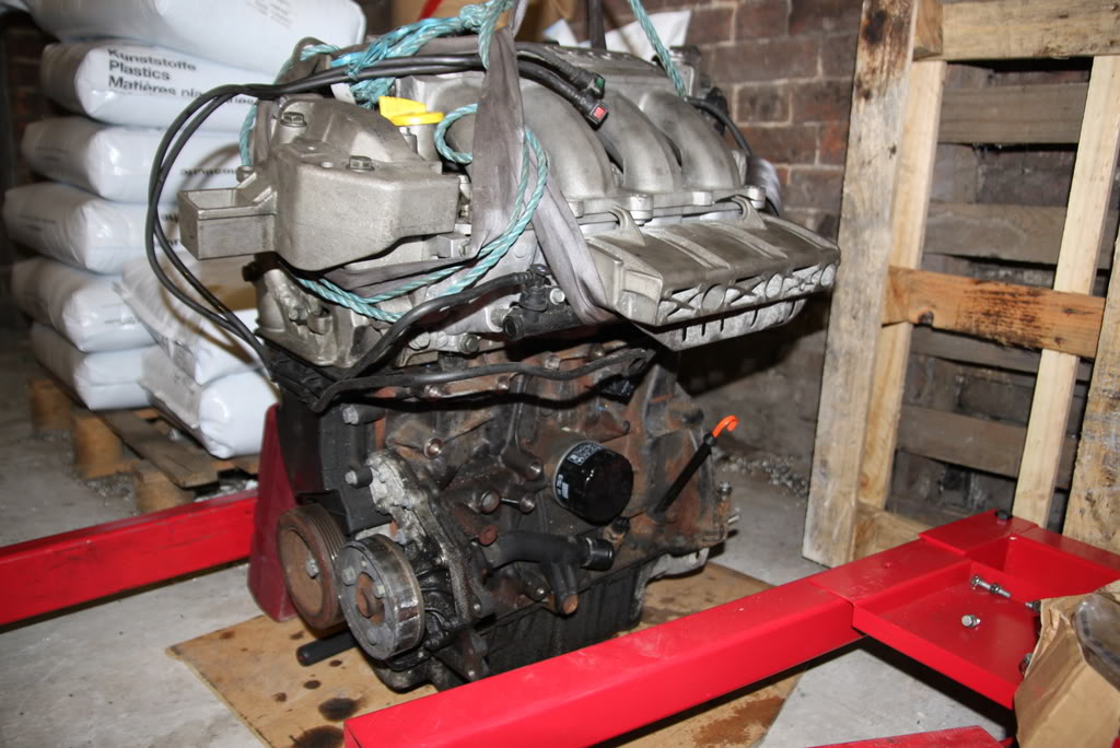

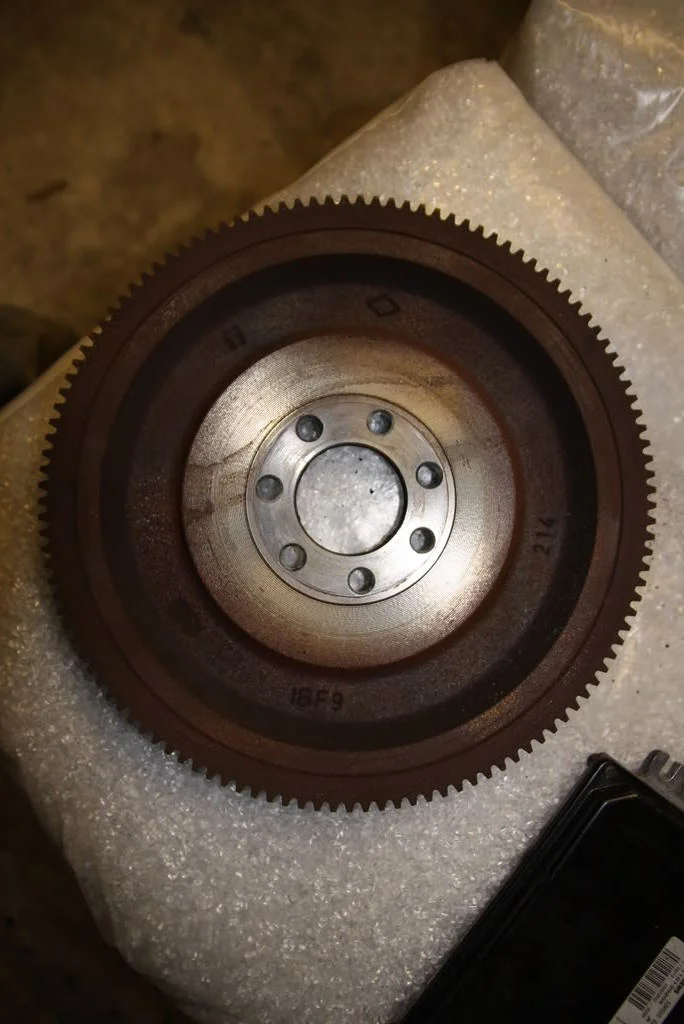

Bit of an update on the 172 engine also, stripped the Air Con, PAS, Alternator and all the brackets off, then made some space in the factory to put the engine onto the stand so I can paint it up, do my stuff to it, fit the manual alternator brackets to loose the PAS, etc...

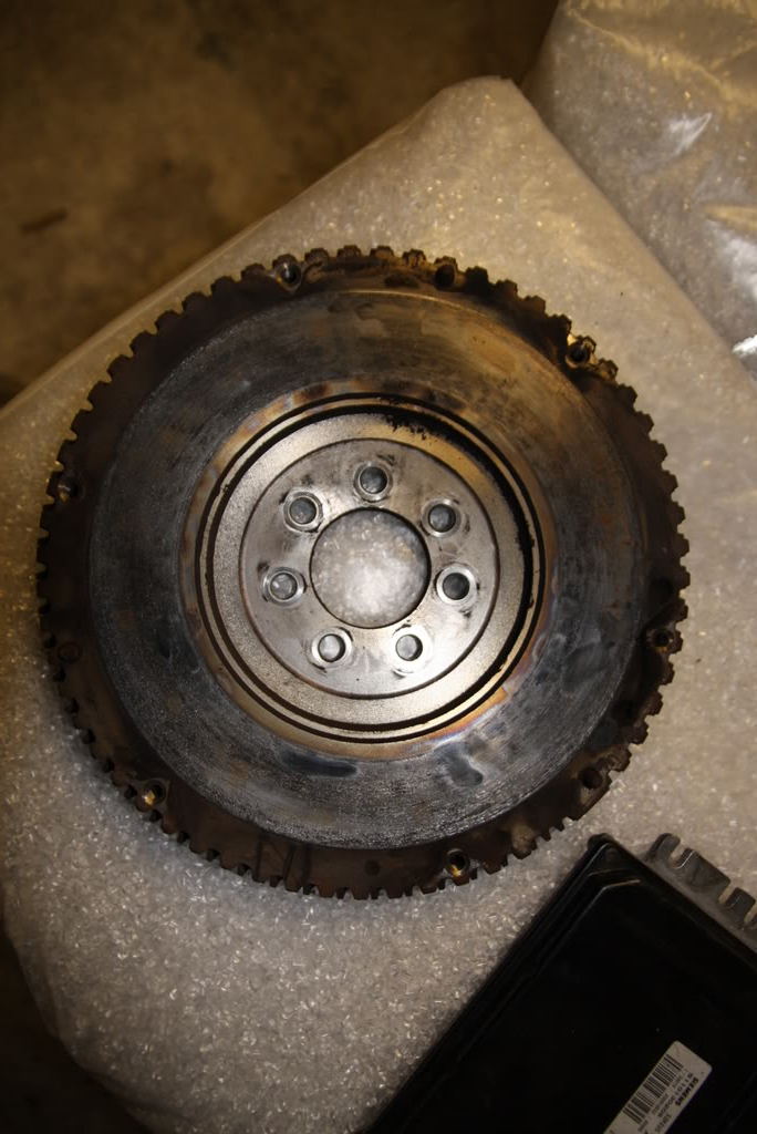

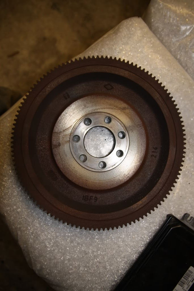

While I was at it, I removed the flywheel, might get it lightened and balanced, not sure yet....dont know how to tell if its in good condition or not? Looks like a few sort of 'burn' marks on the clutch face...
Anyone care to advise?

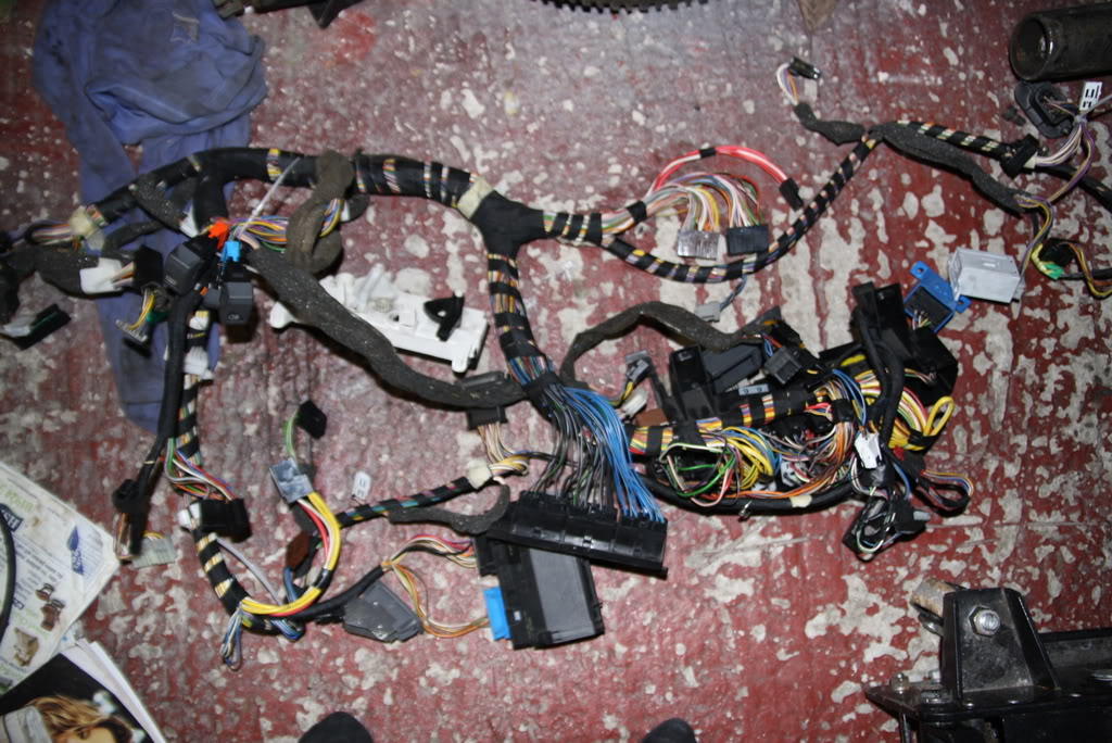

Anyway, this is the next thing to approach fully, the Valver interior loom...lol

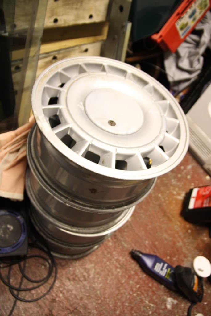

And ive set about refurbing these as a spare set of wheels, got them with the blue valver :)

Re: Mk1 Hybrid Project
Good luck with that Valver loom!
I'd just explode if that task was mine lol
Jord, I did mine in the car but the interior loom is a peice of piss.
Mint work so far lad! That clutch just looks like there's been a slight oil leak once apon a time, new clutch and plates, check crank seal and the inside of the box for signs of oil then refit.
I havent got the box, nearly new valver box is going on ;)
Going to get a new clutch, going to check it over properly now its up on a stand, should be easy...
Interior is easy aye, thing is, I didnt label anything as I took it out lol, and the rear part of the loom is still in, need to sort the lot out really

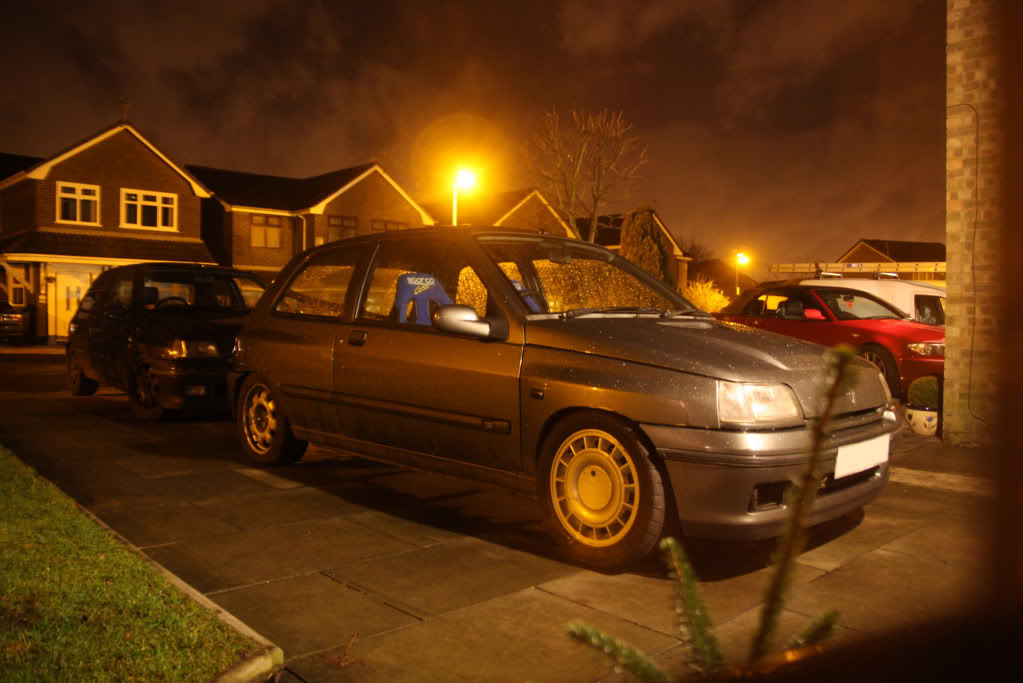

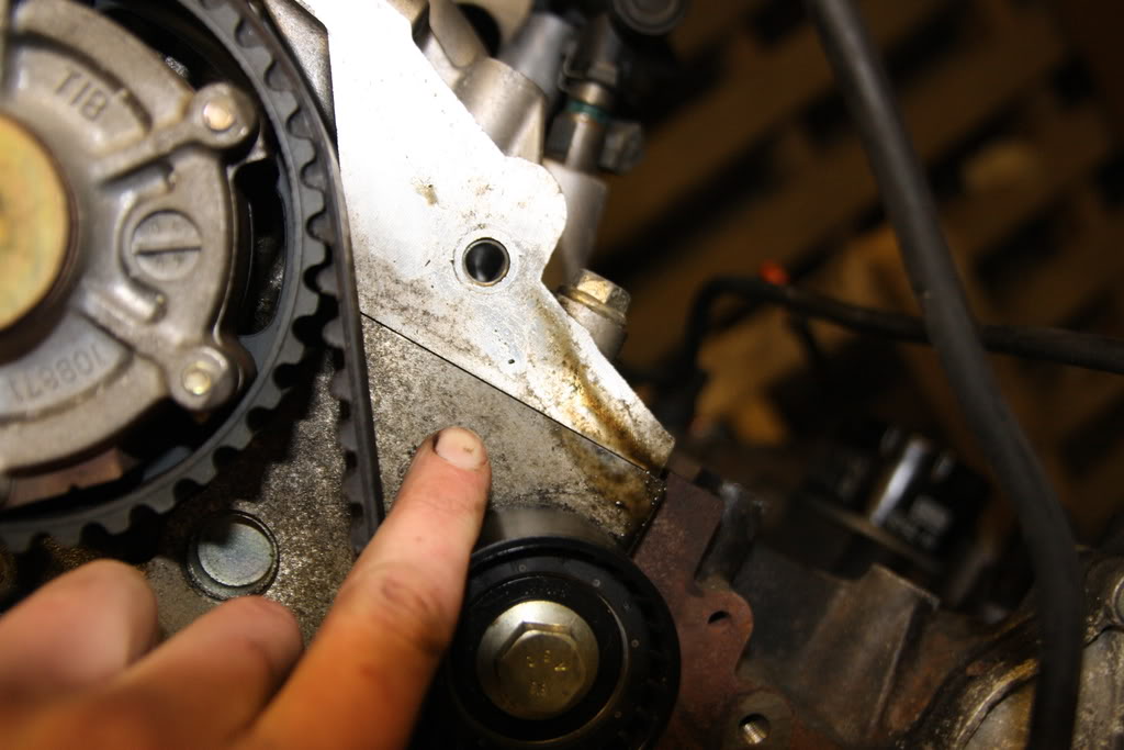

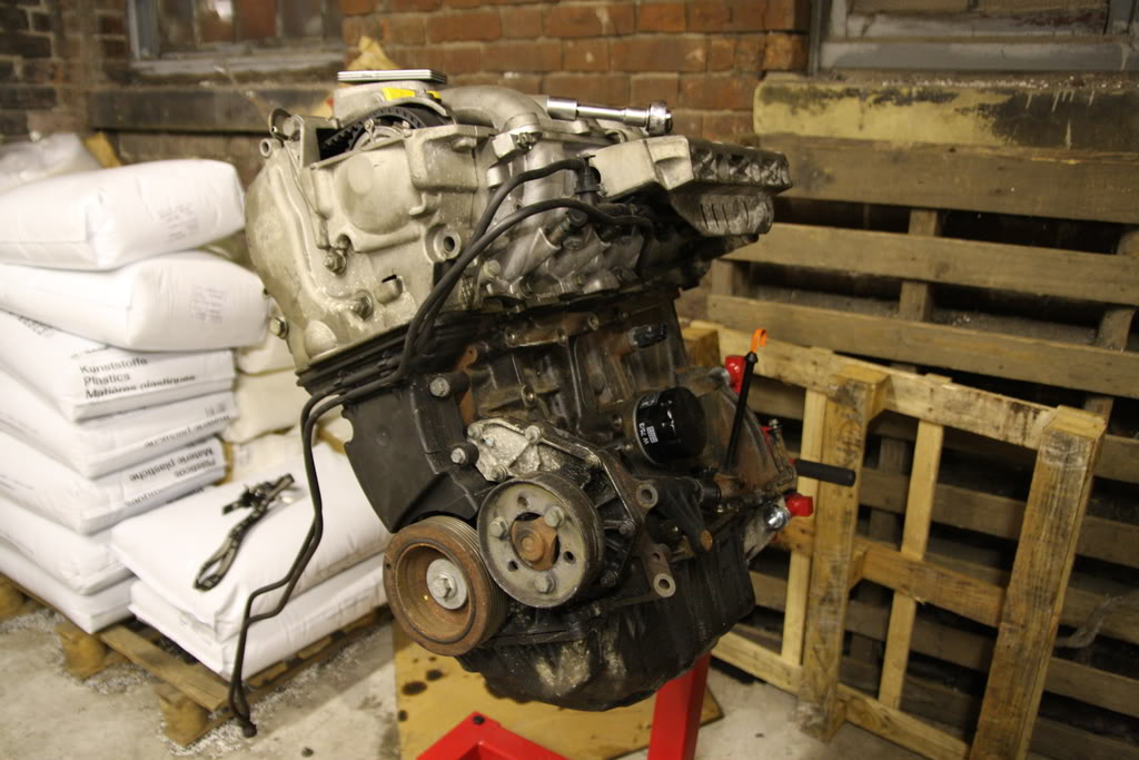

Day 139
Put two tyres on the turbines so I could drop the hybrid back on its wheels (so I can tow it when I find somewhere, and to keep my mum happy, lol)...Looks so high with no engine in :(

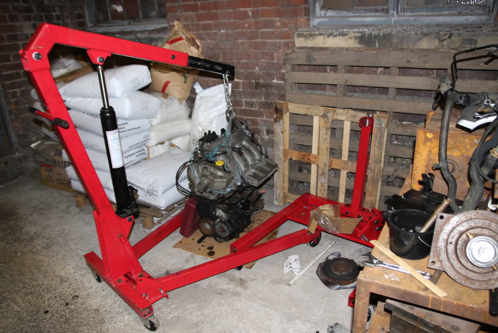

Engine went onto the stand yesterday, so much easier to work on...

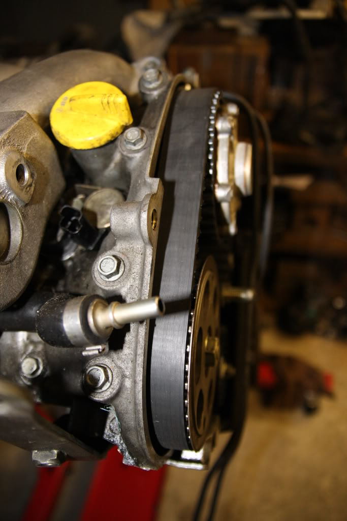

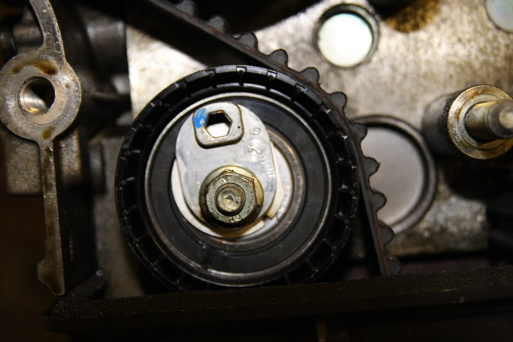

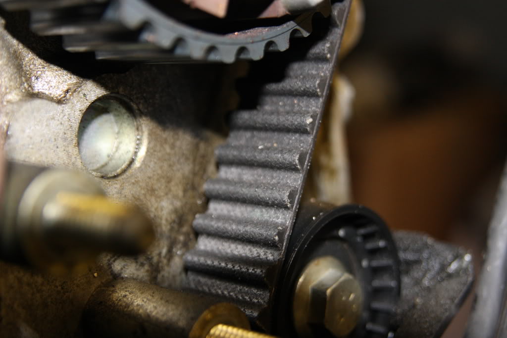

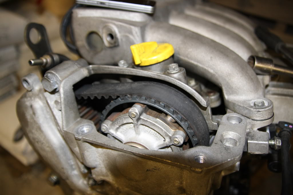

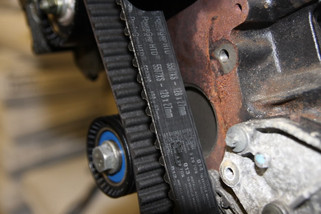

Cambelt covers off, all looks pretty newish...Ive been informed its an aftermarket tensioner (Matteh :)), so it must have been replaced at least once...

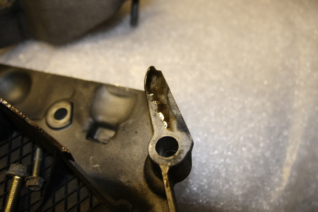

Few drips of oil out of this hole....dont know where from?
Going to check the timing tommorow and check its all good, and will probably leave this belt on for now, until everythings sorted and running nice :)
