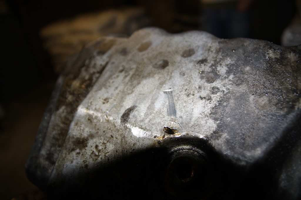

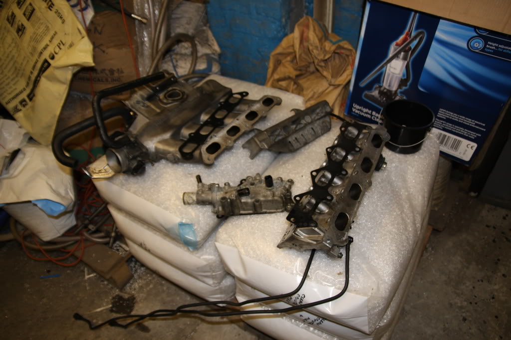

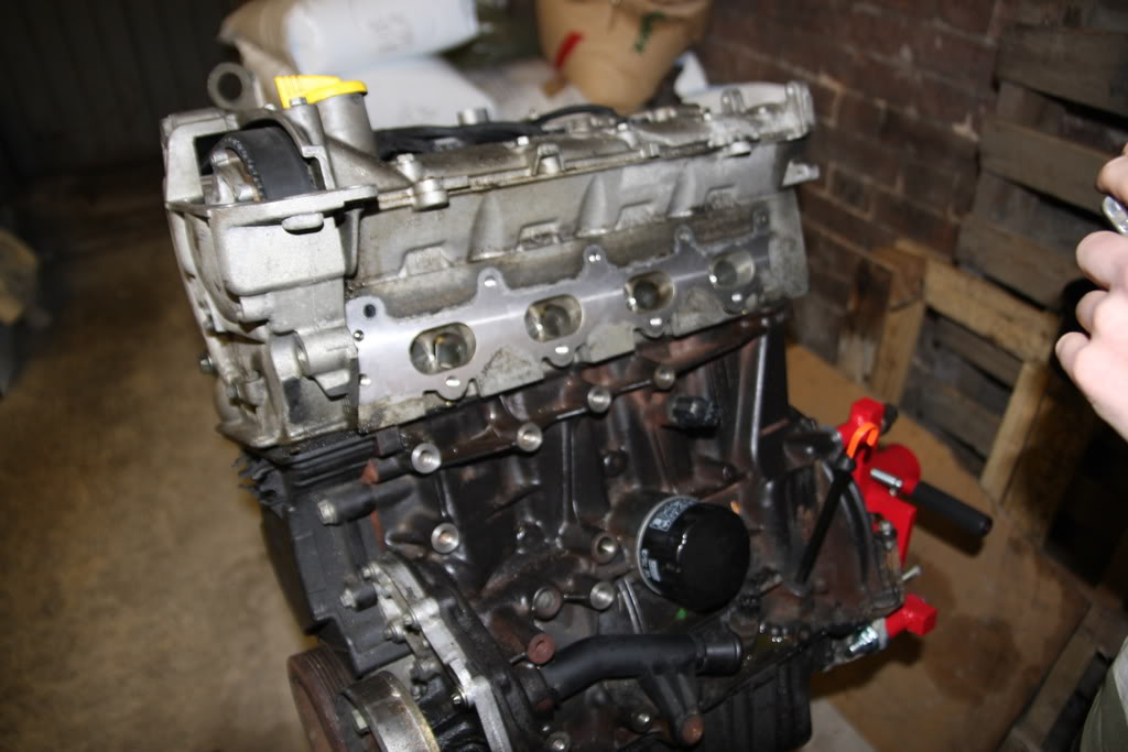

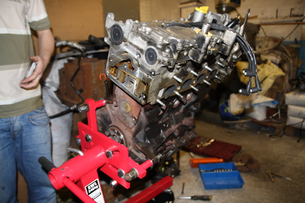

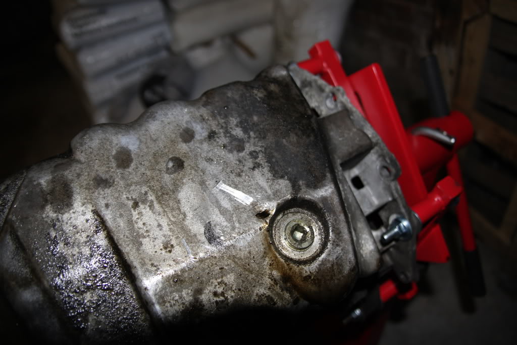

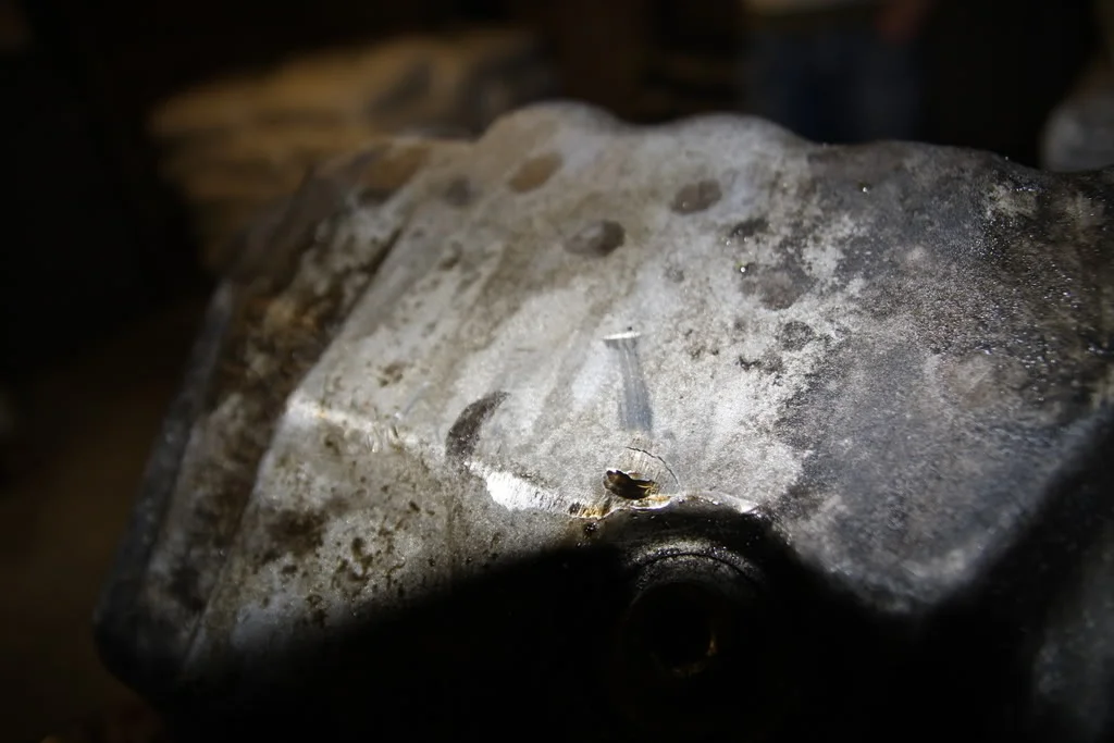

Was going to take the sump off today and have a nosey, plus its being replaced anyway...
Bought it like that, getting a replacement shortly. As I went to remove it I realised the engine stand bolts onto part of the sump, so It cant be removed on the stand, fail :(

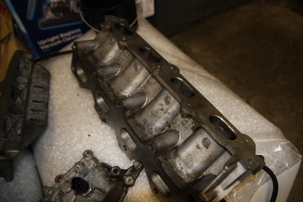

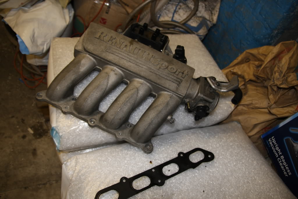

Also took the inlets off...

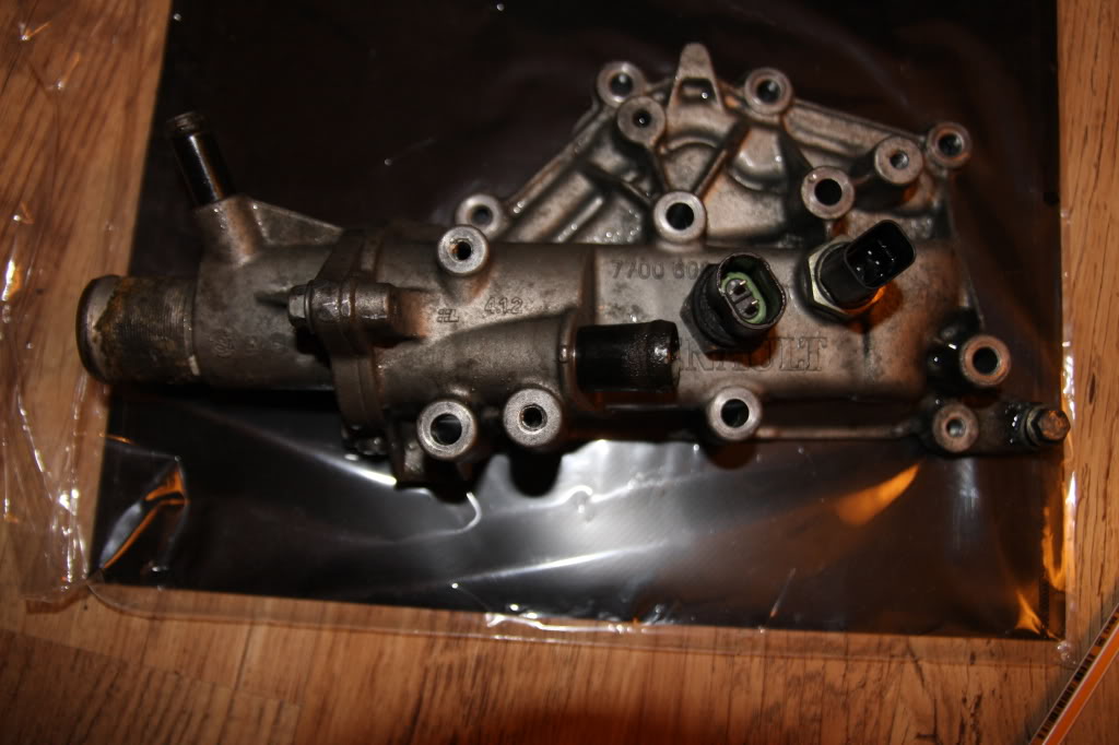

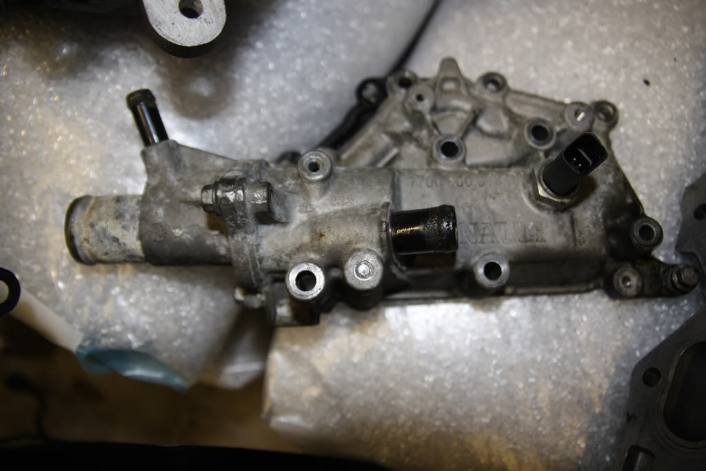

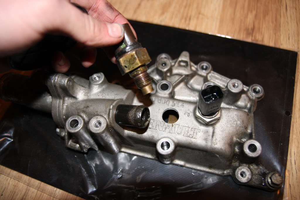

And the thermostat housing...
To something the previous owner left me (Bottom hole)
Few random pics, lower inlet...
Thank god im doing this in the factory and not at home in the cold on the driveway, alot of warmth ftw!
Also, cheers to Chris for the Kill/Cut Off switch to go on my 172 engine loom...
Going to do some modification to the thermostat housing tommorow, along with checking the timing, and probably start painting the block...More soon...

Not a hole, just a crack, it seems its on the lowest lowest point, bought it like that, wanted to get the sump off to check everything over

Did it leak? Not been run with no oil I hope
The guy who I bought it off did it lifting the engine out of his car into his garage I was told...hence why I want to strip it down to double check

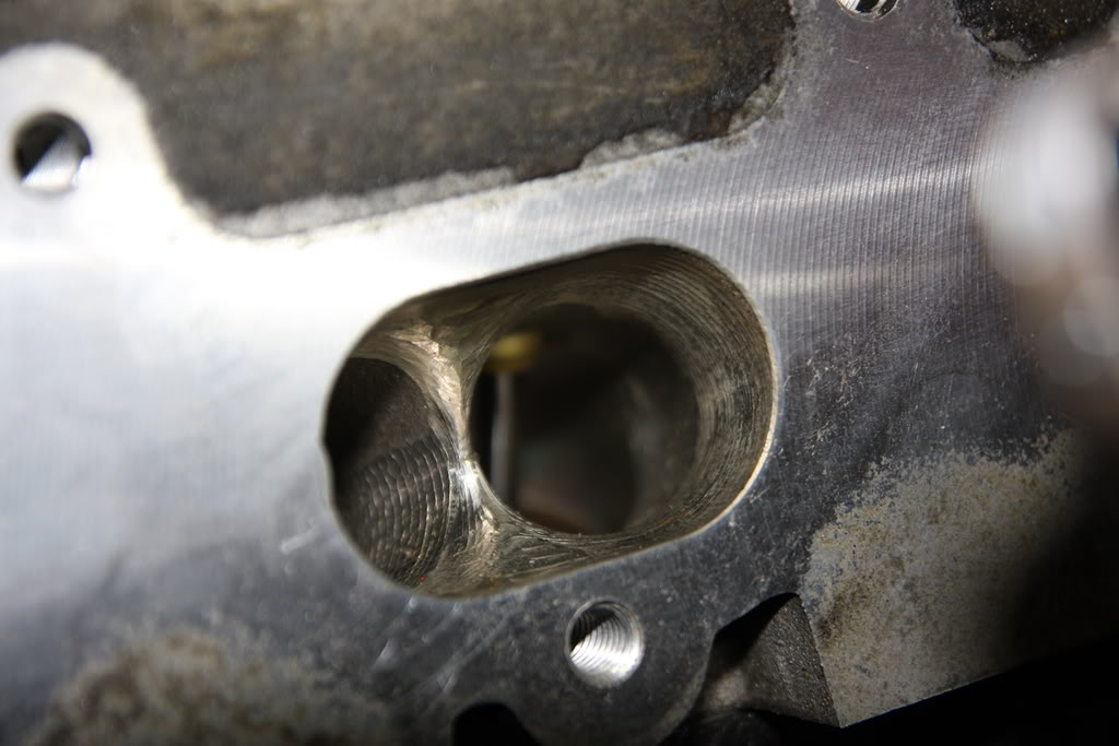

that inlet looks like its been done with a dremel !.......who did that ?

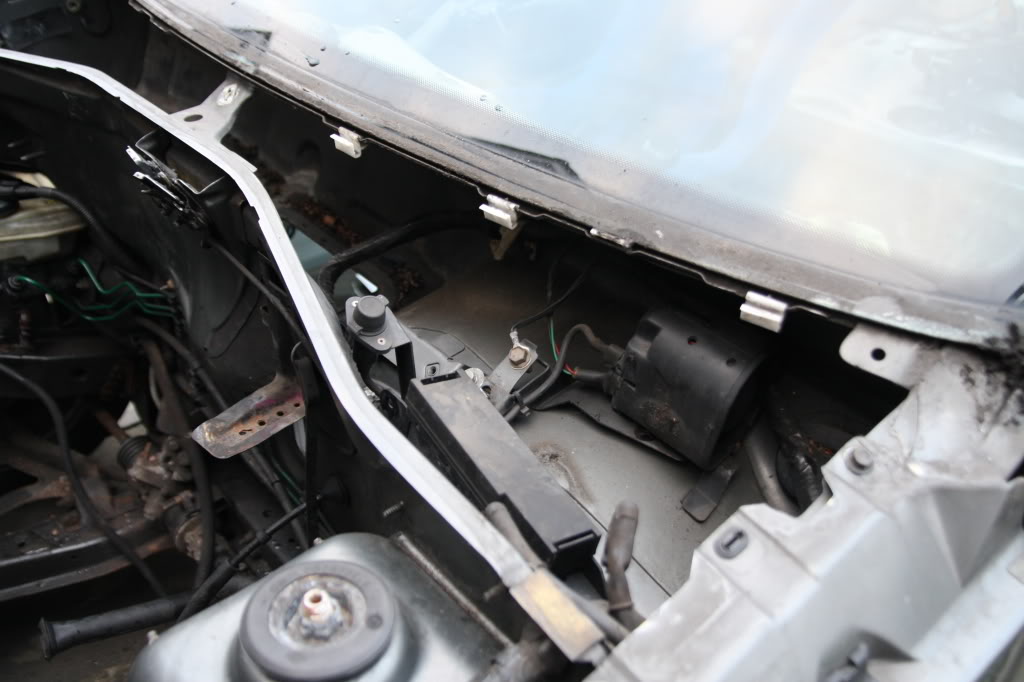

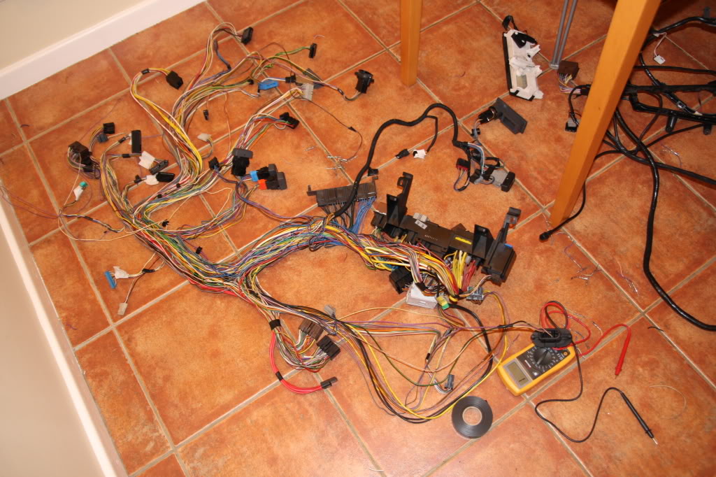

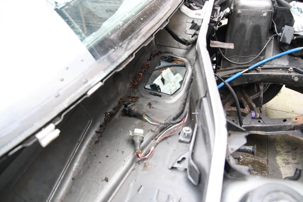

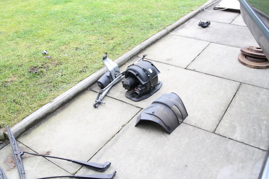

Got quite a bit done on the car itself today, already had the interior loom out, but wanted to remove the rest of the loom...I also wanted to remove some other bits like the blower unit under the scuttle and the rooflining...
Blower unit out, also removed the wiper linkage and washer bottle to get access to more wiring, and found some more sound deadning/tar...

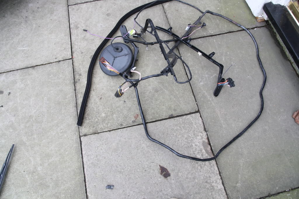

Next removed the rear part of the loom...

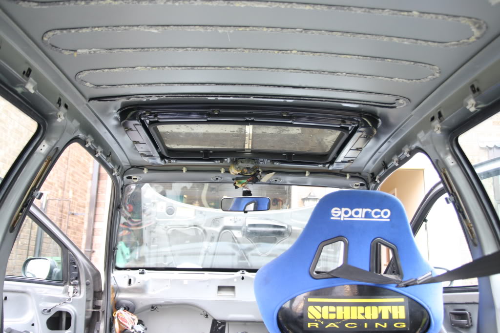

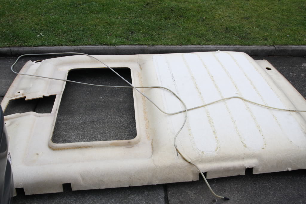

Then the rooflining...
That then allowed me to remove the wiring that goes up to the top under the lining, for the interior light, etc...Also removed both door looms...

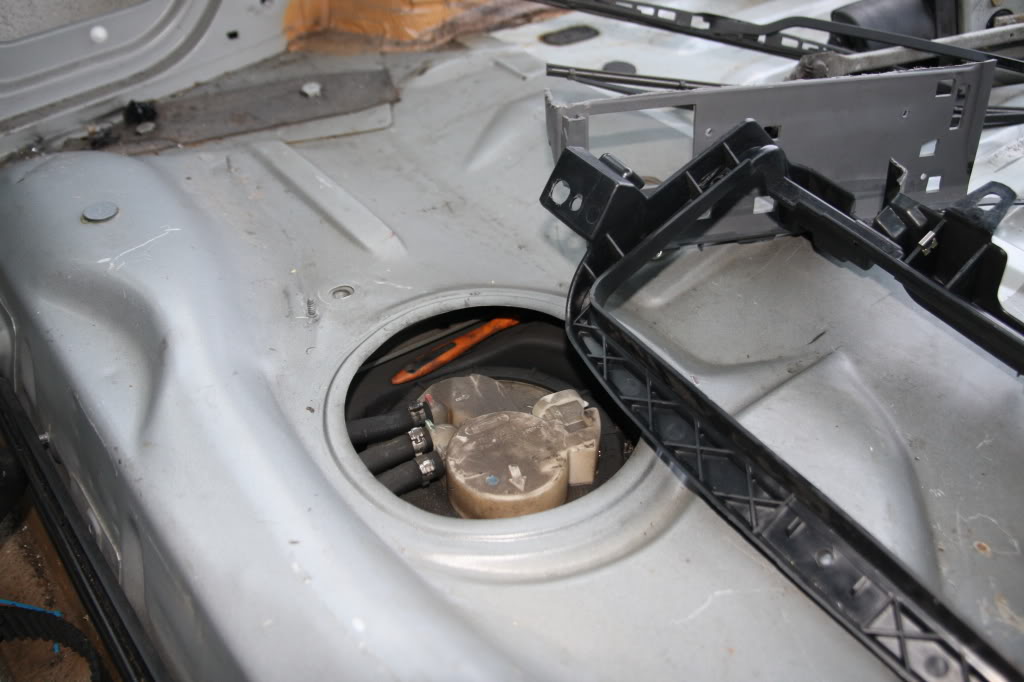

Oddly I found a paintbrush on top of the fuel tank, ive never had the cover off before...god knows how it got there!

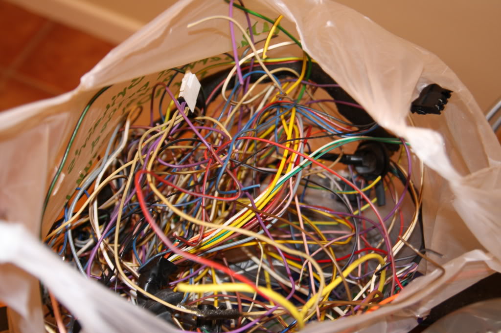

The car is now stripped bare of wiring, apart from the small amount linking the engine bay connections to the interior, which will be removed shortly.
Im removing all the wiring, as its being mostly chopped up, and im routing it in a completely different way to hide it all...
I took my 172 thermostat housing to a local engineering place also, as I know the person that owns it. I got him to drill me a perfectly sized hole to accept the Valver/Mk1 coolant temprature sensor...
I probably could have done it, but its far easier with proper drill bits. Picking up some sealing washers/o-rings and a thin nut tommorow...
He also managed to get the snapped bolts thread out of the hole it was in, took a bit longer than expected as the drill he was using went a bit too far and snapped inside the hole, then had to drill the drillbit out :boring: got there in the end though...

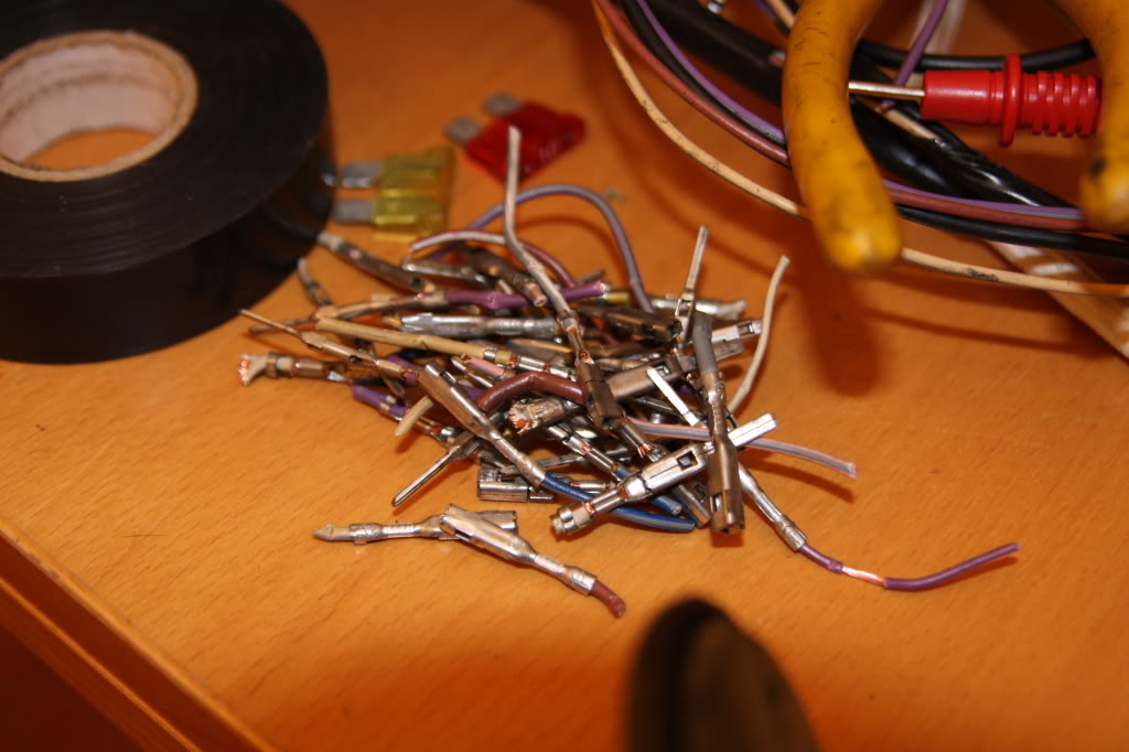

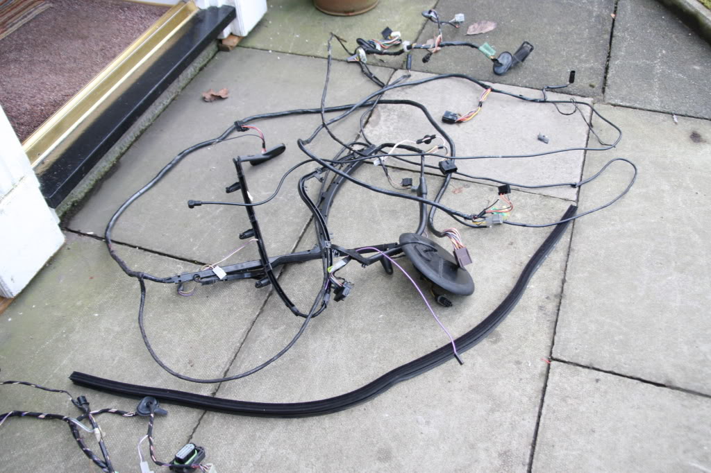

Got on with chopping a bit of the main interior and door looms up also. Removed all the audio/headunit wiring, the heater matrix wiring, electric window wiring, electric mirror wiring, and a few other bits, still LOADS more to come out...

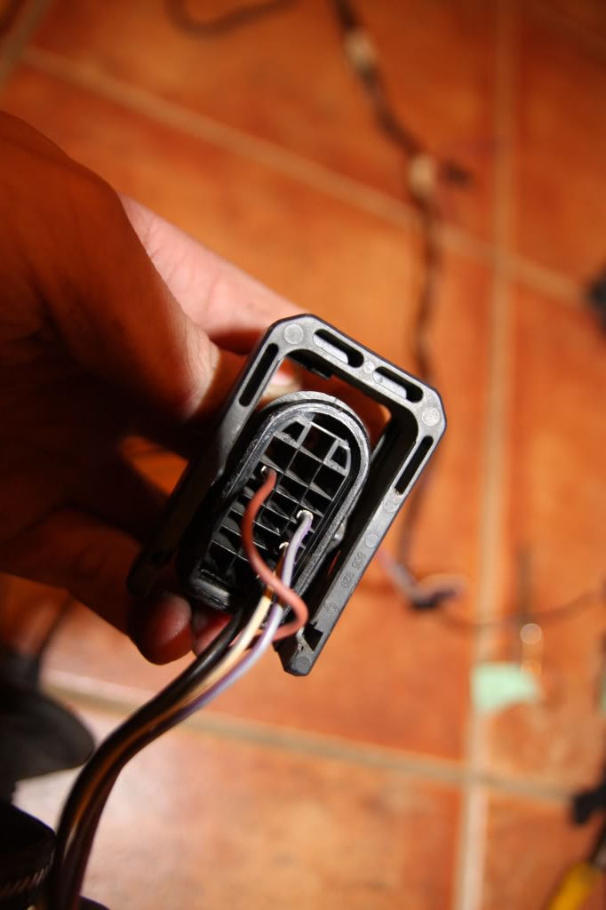

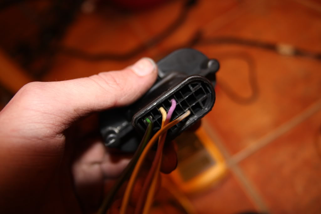

All thats left in the door connector, the central locking wires...
Removed the pins for all the other un-required wires from the connectors too, to keep it tidy...
The interior loom...
Fuse/relay box will be gone shortly, along with all the rest of the crap. Going to be re-locating the fuses/relays, into new holders out of the way...

not sure...had a bit of a change today, pissed off with how messy the mk1 loom acctually is, and I want to relocate alot of the wires etc...
Spent the past few hours making drawings of whats needed, and whats not...going to start one from scratch...

Yeah well its empty at the moment, just spent ages looking through the RS components catalouge, finding connector blocks with enough 'amp' rating to take some of the fatter wires (ignition, etc) as most of them are max 15a!
Just in the middle of sorting a fusebox/relay holder into unit, then going to start from there I rekon. Il keep the front part of the loom (headlights etc), and the rear for the boot, but apart from that, going to start it from scratch I rekon...
