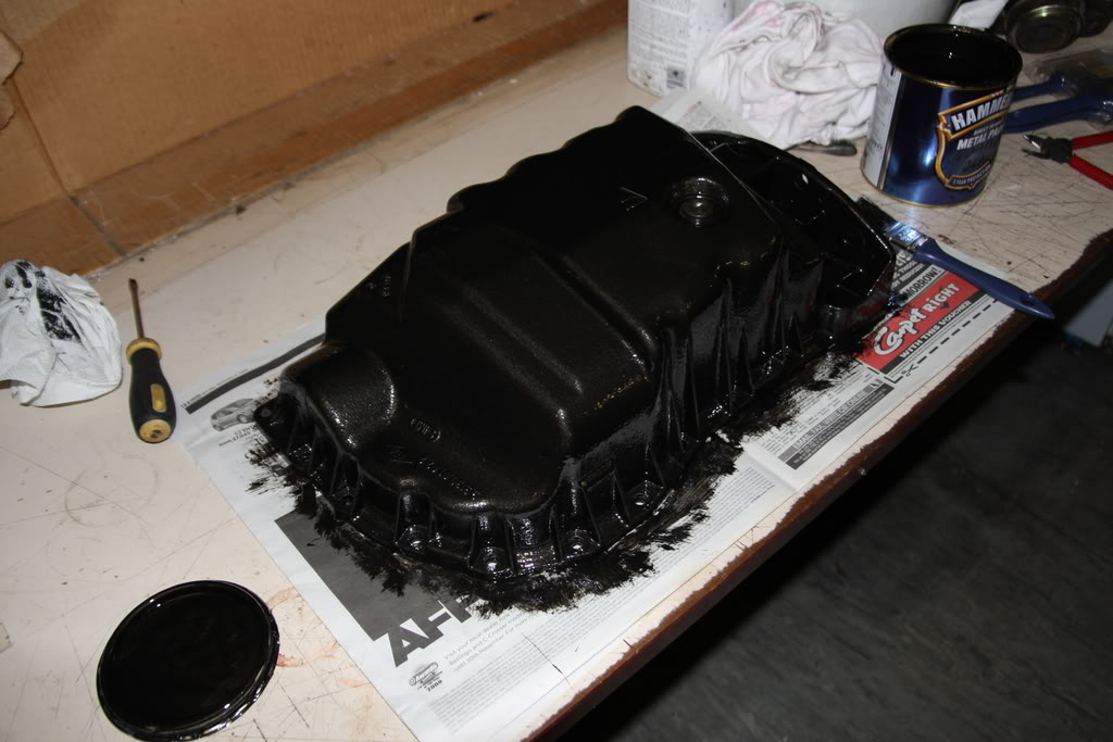

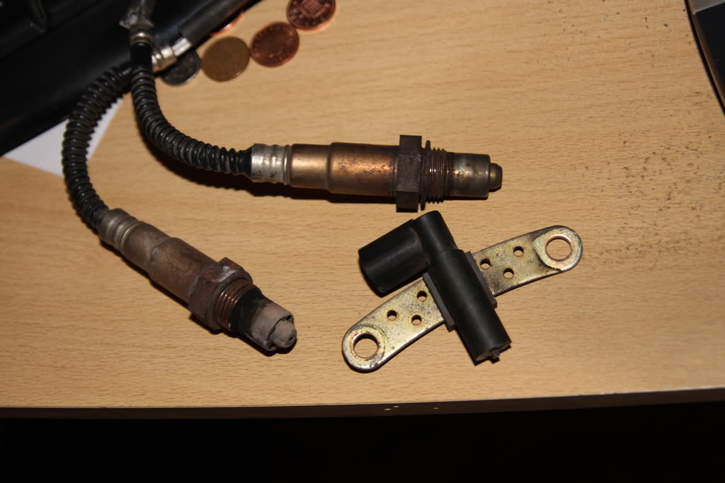

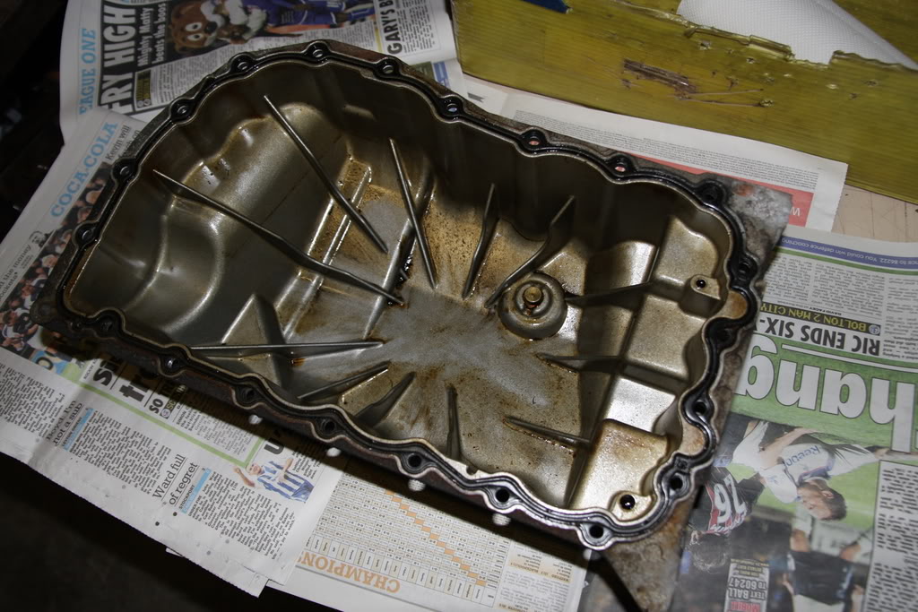

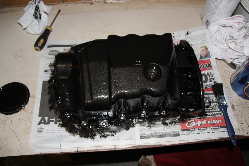

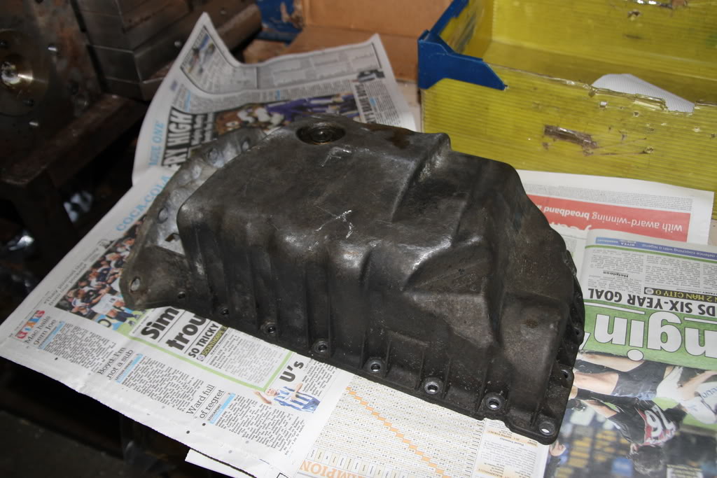

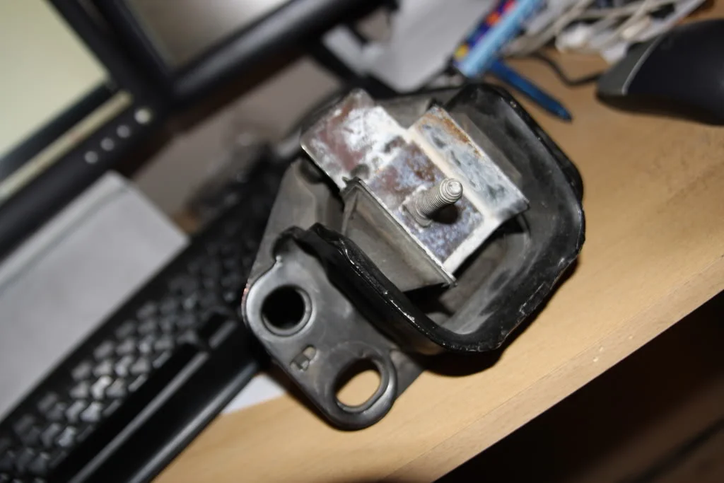

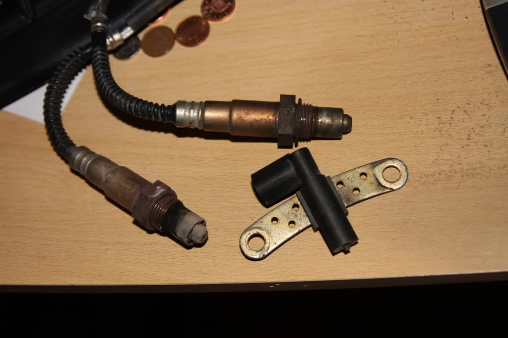

Picked up some new parts today... A 172 sump, 172 Crank Sensor, 172 Drivers Engine Mount, and two Lambda Sensors, even though I only need one...spare is always good I guess...
Decided to start painting some stuff, so I cleaned up the sump and painted it...

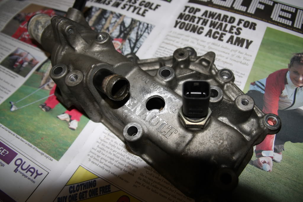

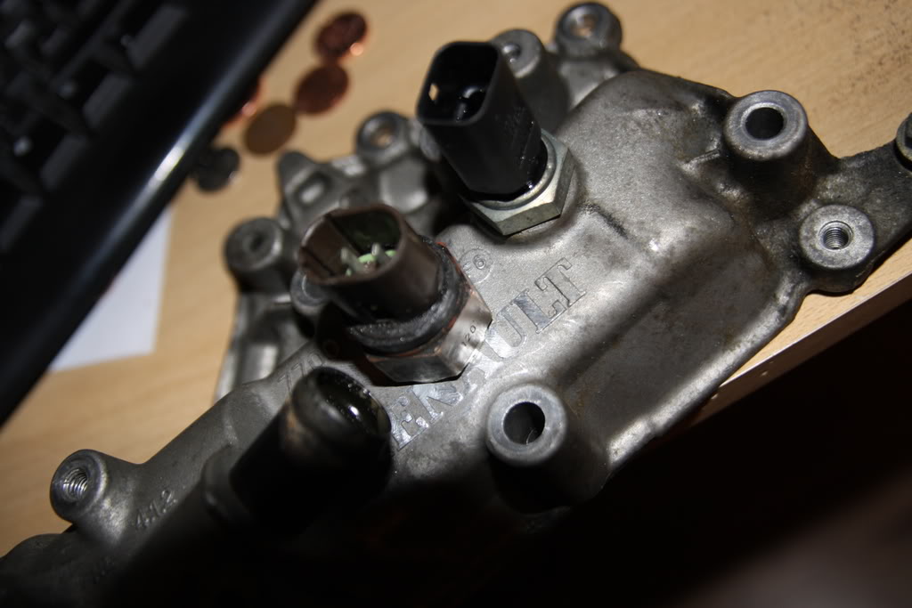

I also filed down the lettering on the thermostat housing where I had it drilled, so the coolant sensor would seal properly with the washers.

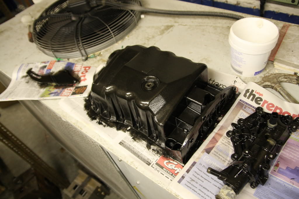

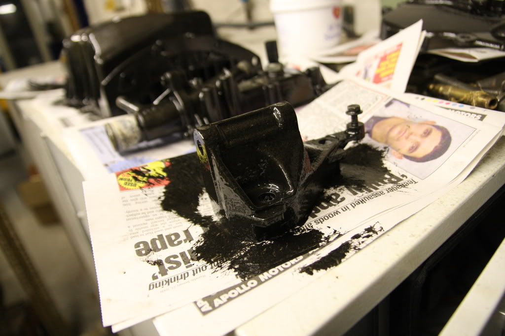

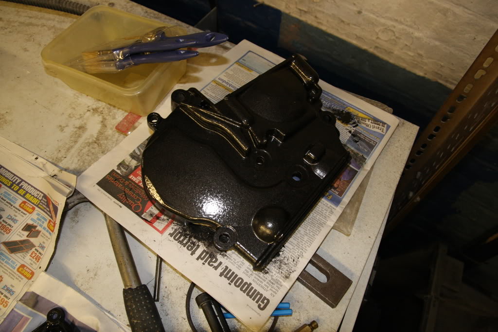

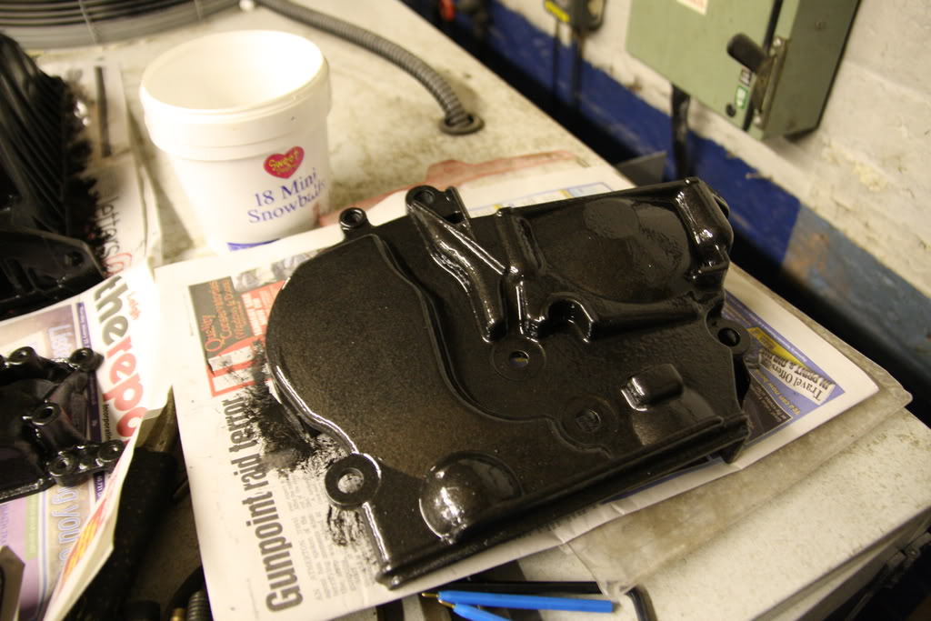

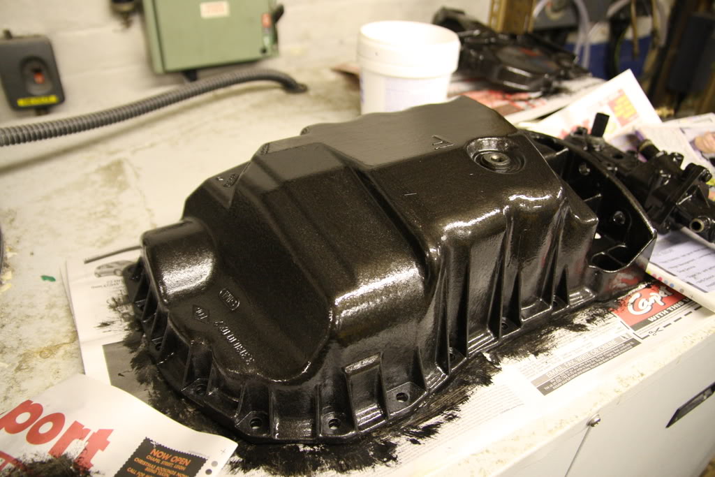

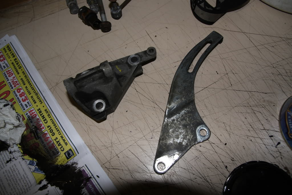

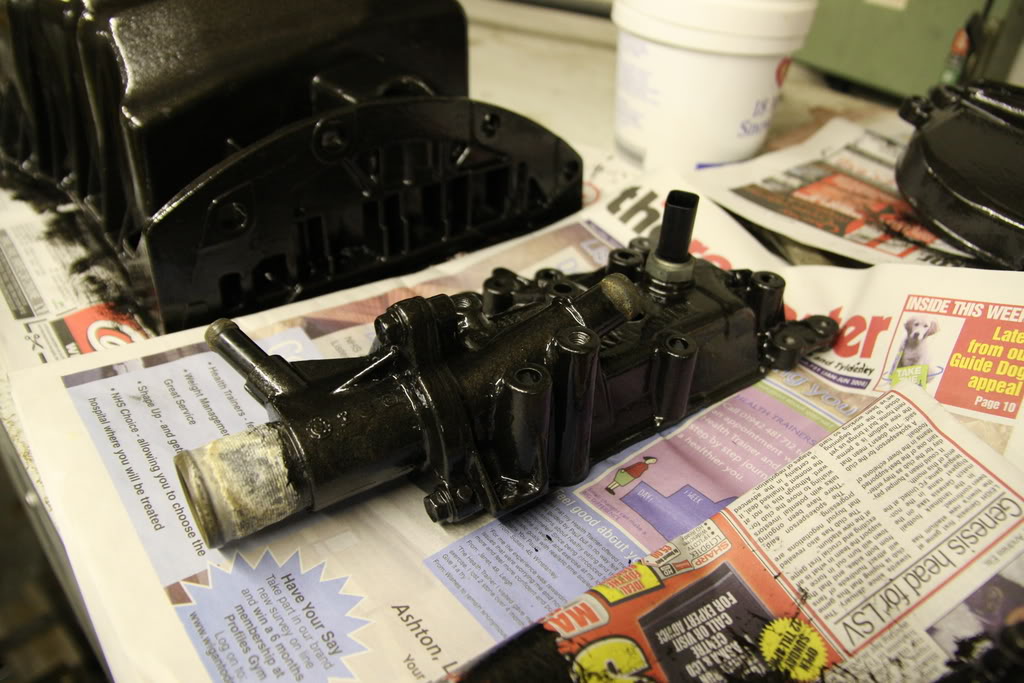

After painting the sump yesterday, I decided to paint all the other stuff I wanted to, or at least start...

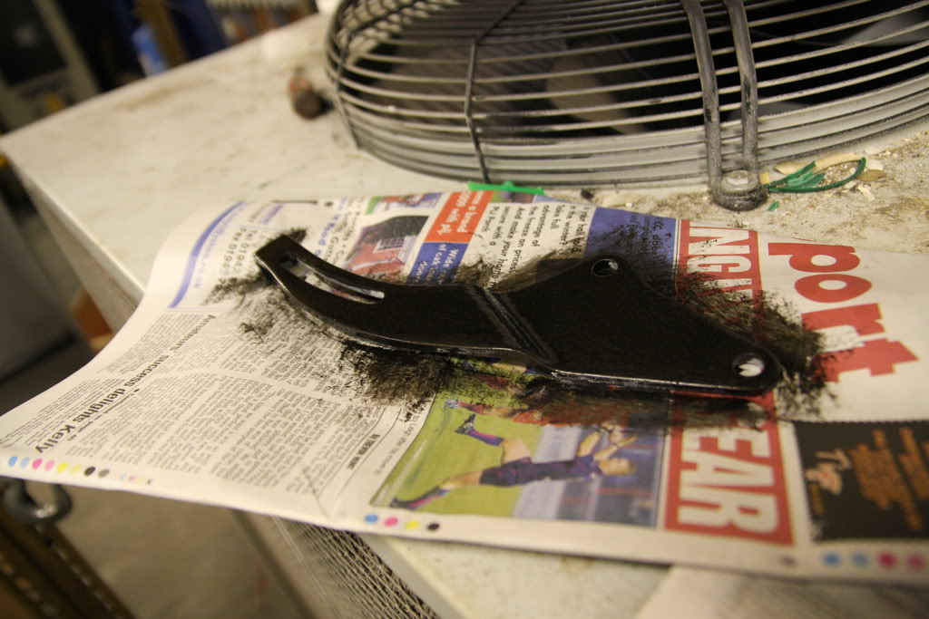

First up was the alternator brackets Im using...
Then the thermostat housing...
And the side cam cover from the 172 engine...

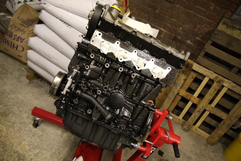

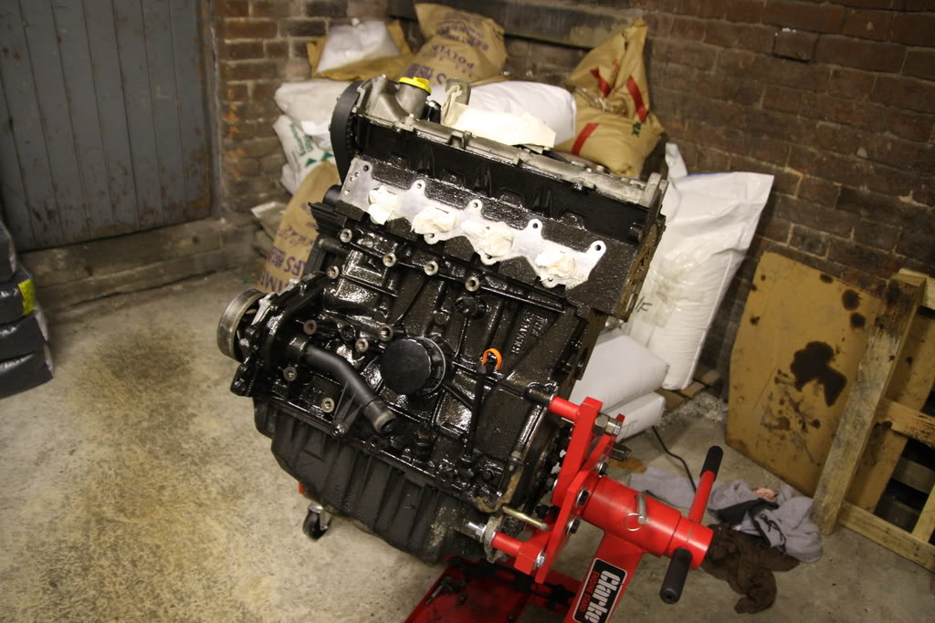

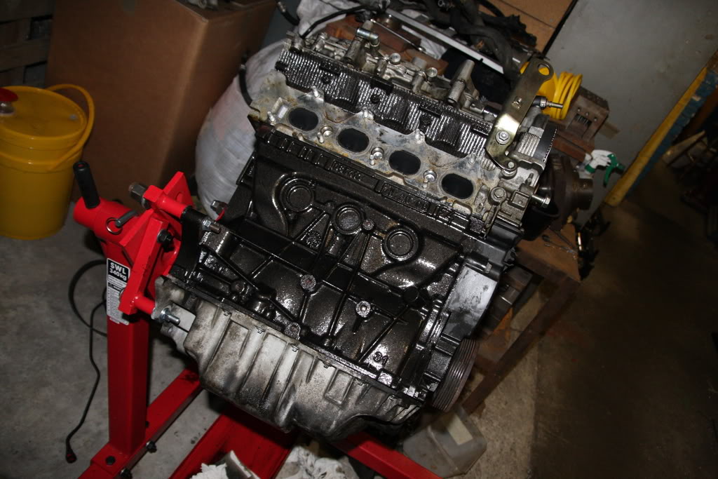

Then started on the front of the engine itself, the block/head/gearbox and stuff bolted to it is going to be black, inlets will be different, undecided what yet though...

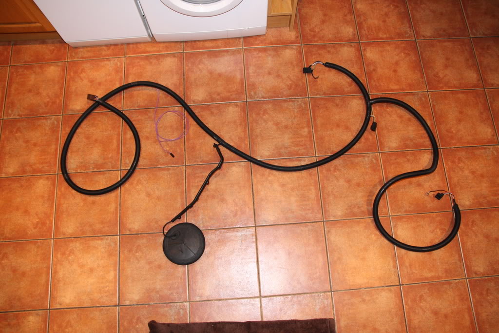

I also finished the rear loom today, which will be hidden down the length of the car, it will explain itself in the next few days when the rest of the loom is finished...
I removed the speaker wiring, rear wiper/washer wiring, and a few other unused bits...Also, the wiring for the passenger rear light usually runs across in front of the rear seats, then down to the back of the car. I made it follow all the way down the drivers side instead, then along the back, to make it easier to hide!

what colour is that you have painted your bits? looks like a pearly black? looks mint!
Re: Mk1 Hybrid Project
Hammerite 'hammered' black, its like black with a grey sort of sparkle when you see it under light lol

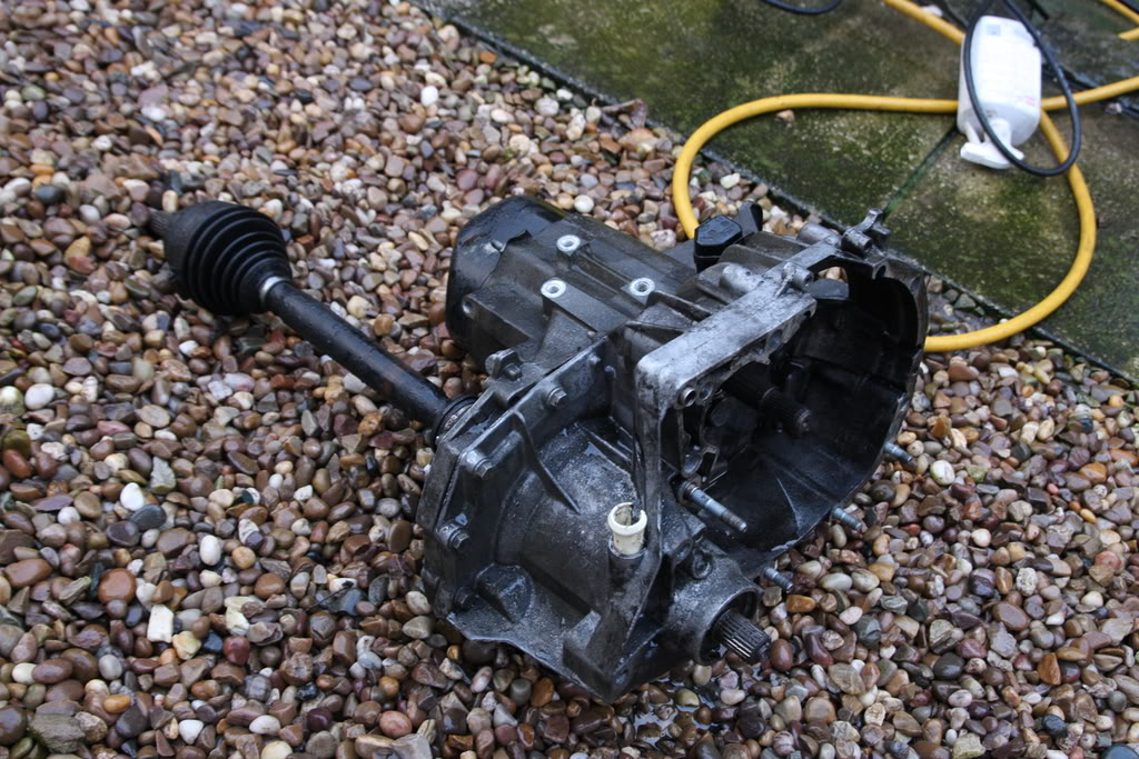

Day 150
Been working on the interior loom mostly over the past few days, taking time but its a pretty big job. More updates on that in the next few days...

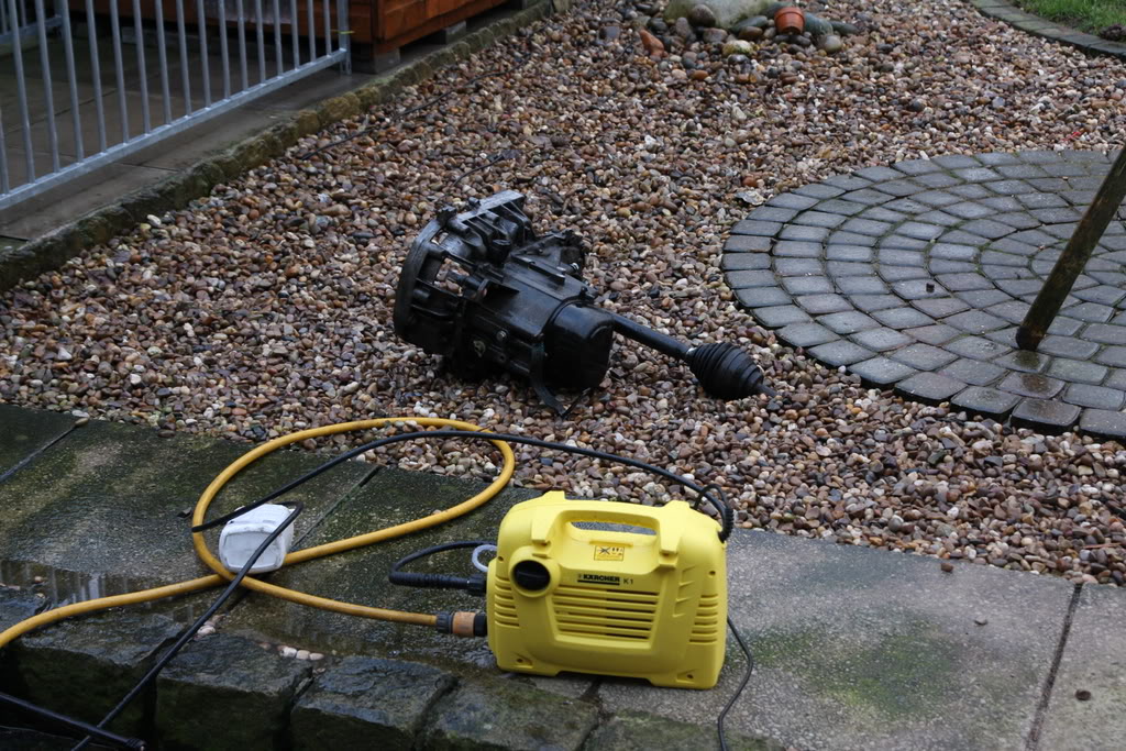

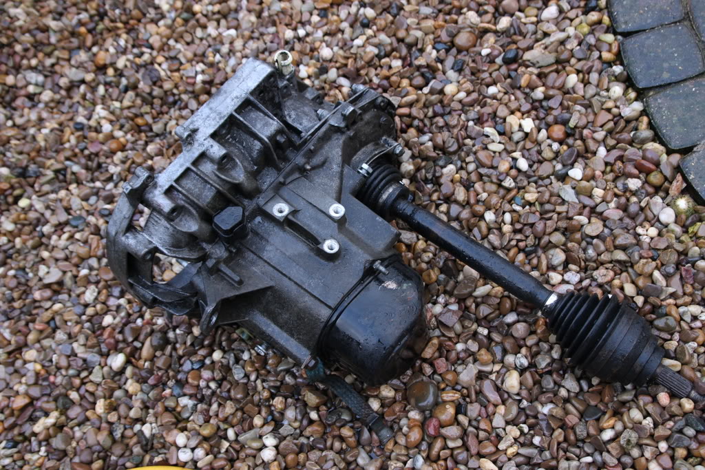

Spent some time jetwashing the gearbox today, came up OK, but its 12 years old I guess so cant expect miracles, just got to paint it now...

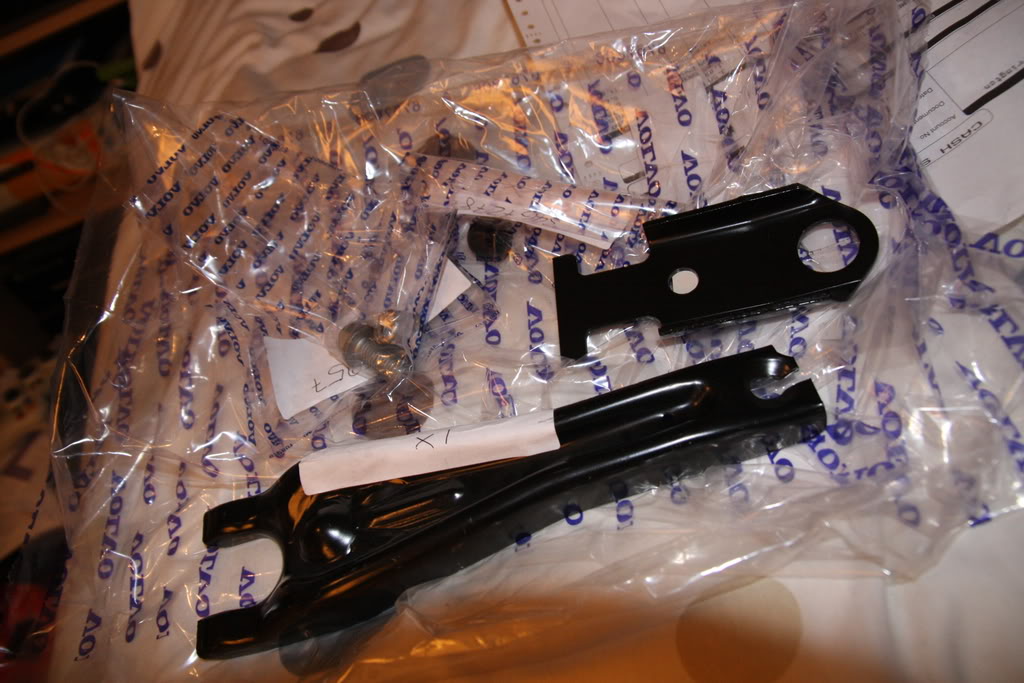

Day 151
Picked up my clutch cable brackets, and clutch fork from Volvo today. This is the equivalent of a 'soft pedal' conversion, if I didnt use this, the 172 clutch would be stupidly heavy with the valver box...

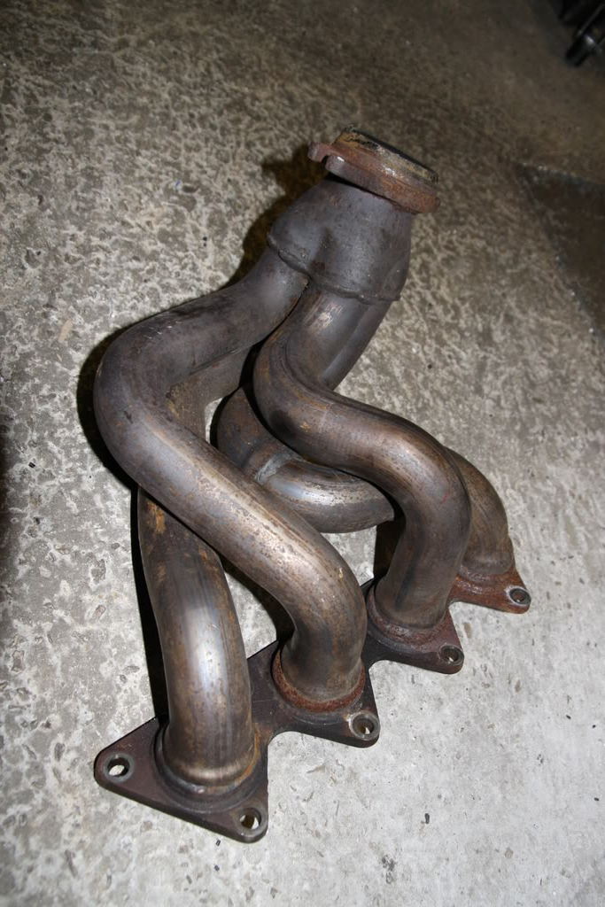

Also had a few other bits arrive, 172 upper manifold...
Decided im going to have the flange chopped off, and a flat faced flange welded on, which will meet the downpipe completely square, instead of the round gasket/rotating joint... To counteract this I am going to put a flexi-joint on the downpipe further down to still allow movement...

Painted the back of the engine too, just the top to do now...
And one last pic to give an idea of the sort of color the hammerite 'hammered' dries as...
So the 172 manifold is going to directly meet the valver downpipe then? Nice idea as opposed to the custom downpipe option
im going to get a 172 decat, get the flange cut off on the manifold end also, so they meet 100% square and flush, no twisting gaskets and crap....
then il 'adapt' the 172 decat to fit the tunnel properly, looking at geesus69's it dosent seem far out, just needs a bit of messing on the exhaust end....
good idea getting rid of the round gasket, nightmare to get it to seal! still dont think mine is 100%
not sure i get what you mean with the decat fitting the tunnel? do you mean height wise? that is one advantage of having the twisting gasket though, you can move it if need be to get the exhaust sitting exactly where it should be
best of luck with it though, god knows i spent alot of time under the car trying to get mine right!
and i now need to drop it all down again so i can adjust the handbrake, love it! :mad:
Im not sure until i see it and get it offered up....might hack the decat up and tack weld it to the right shape, then get someone to properly fabricate it to that shape for me...
