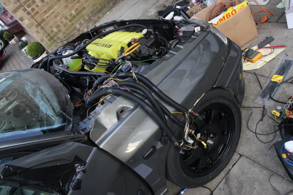

Wiring is there now, everything working, all tidy inside, can only see two runs of conduit (clocks and stalks)....OBD port is located above the pedals, too...

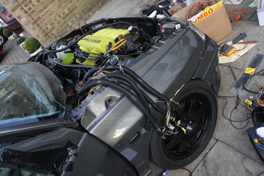

Engine bay tidied up, ECU mounted, cables all tidy. Front bumper re-fitted, bonnet pins setup, etc.

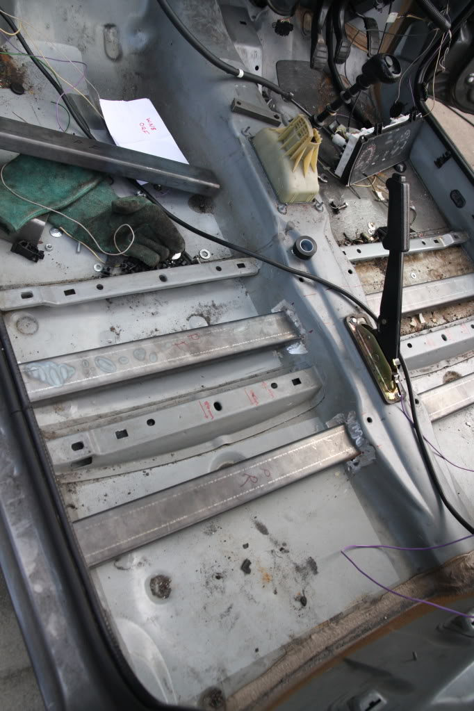

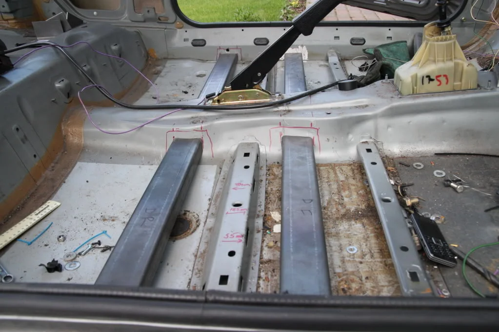

Spent a while profiling the seat bars I had made (70x30x3mm channeling) to fit the floorpan, welder is coming down tommorow to have a go, and see how far we get....cage footplates too maybe, as they came with the cage, just need welding in.

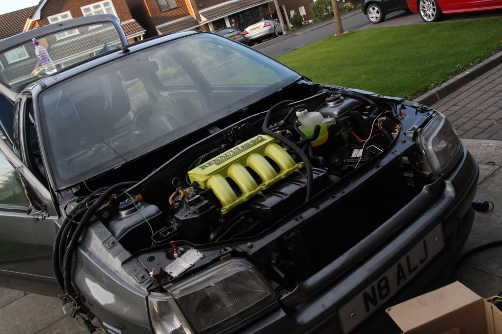

Engine bay sorted nearly (Bar elbow for induction)...

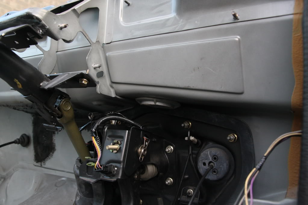

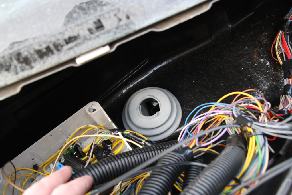

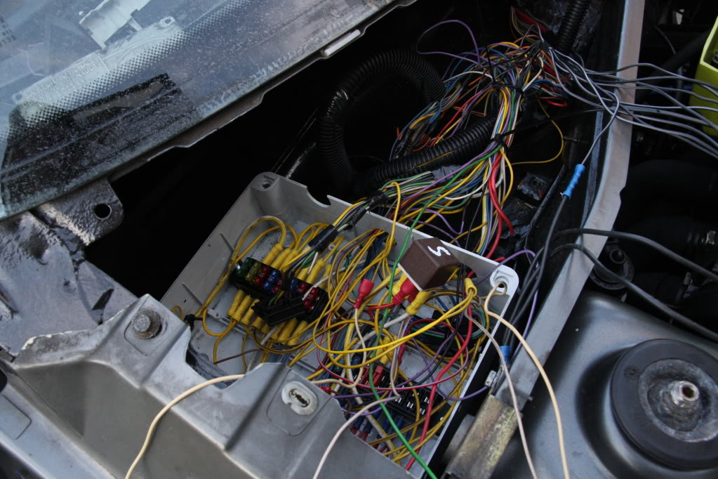

As there is no wiring inside (mostly) now, the bits that are needed some through this grommet...

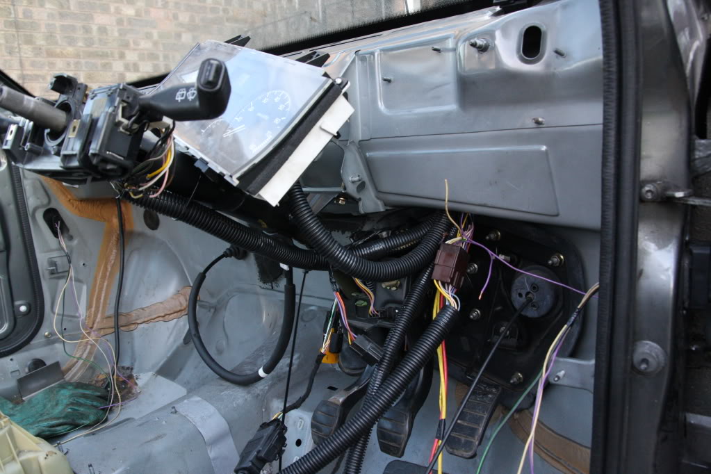

The extent of my 'custom' loom, about 4 runs of sets of cables...
Which come through (Clocks/Stalks/Ignition/Rear Loom), yet to be properly tidied...

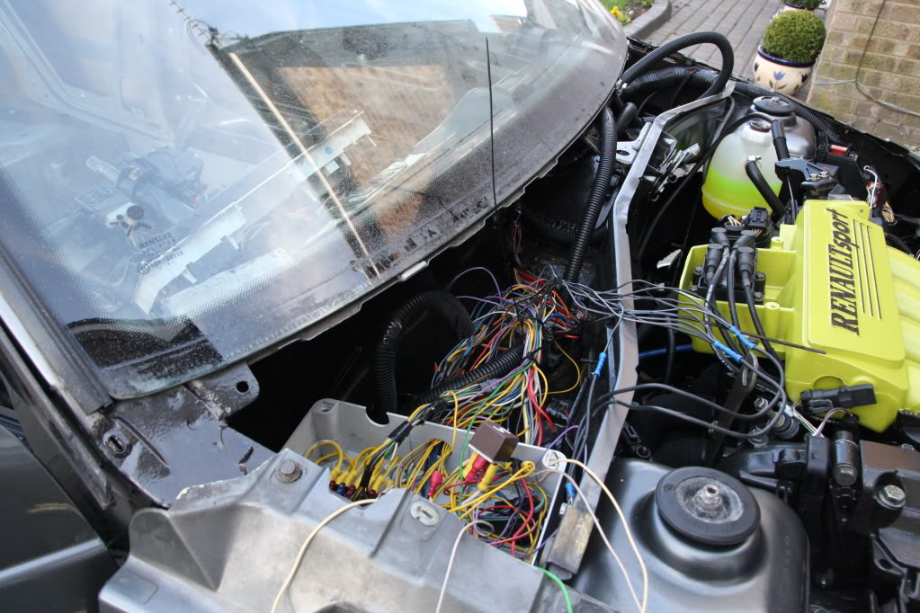

And one of my own riggy fusebox, containing the bare essentials....
Just needs a good tidy up/wrap up now...and itl be done...

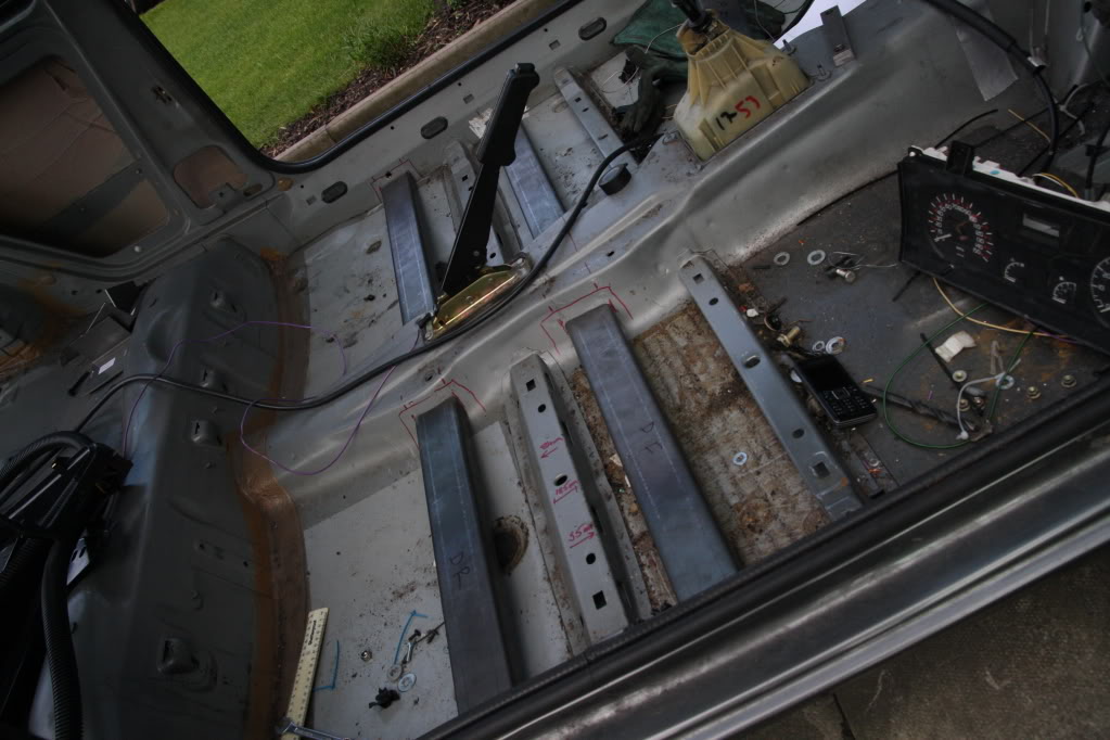

more done today....seat bars finally got level and to the right profile after a bit of playing around, just need welding now...
They are 3mm sheet steel bent to the shape of a channel, then shaped to fit...

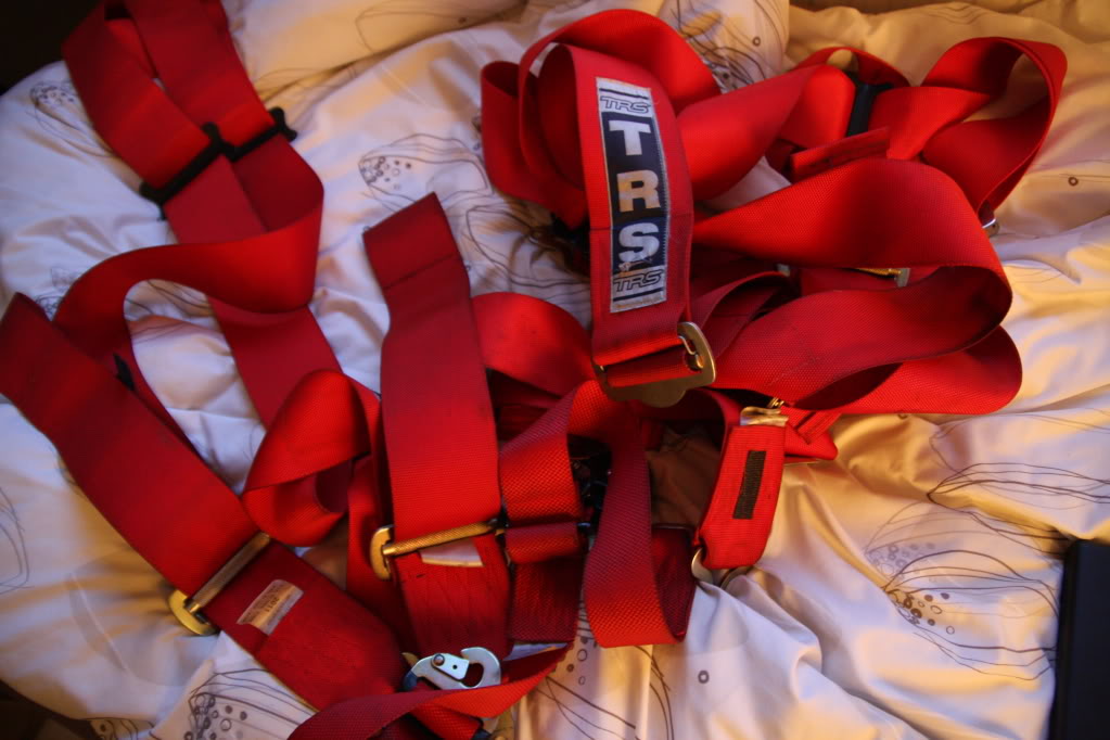

And picked up some 6 point harnesses...I know they are red, not what color I wanted, but they will do for now to get me on the road....They retail at 200+VAT each in tweeks, I paid half that for the pair, still in date for FIA purposes until 2011 too :)

some more good work there, bargain harnesses too!

seat bars all welded in, few other bits tidied up. drivers seat fitted, standard seatbelt (gotta drive to get some eyelets for the harnesses, lol)...also swapped the alternator from the blue one to the hybrid, no more squeeking now :)
