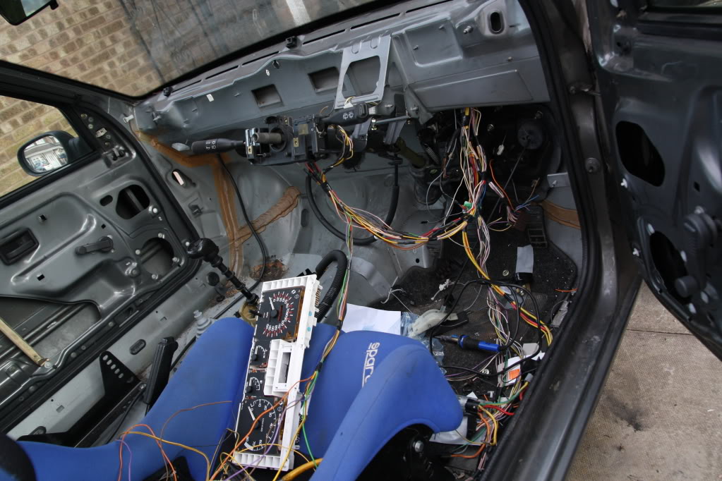

Re: Mk1 172 Hybrid Track Car Project
Thanks for the comments everyone.
I now only have one switch inside, hazards.
Rear fogs are turned on in via the rear wiper position on the stalk, as i no longer have a rear wiper. Rear wiper on = means rear fogs are on, rear wiper off...fogs off :)
Few other touches to the wiring, but more on that in the next few days....
yeah, position 2, and 'start' position are now redundant...
basically, key in, position 1, press the button...
had to move the wires round on the key barrel, but basically position 2 is now position 1 :)

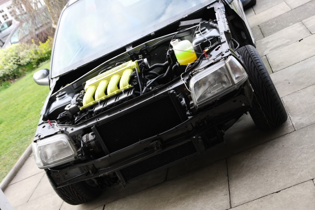

another 6 hours on the wiring today....slowly getting there, all the front lights now working...
Inside a bit tidier too...

Looking good man... The wiring is quite tedious, but therapeutic?! I spent 30hrs chopping, taping and cutting out all the unnecessary crap !
