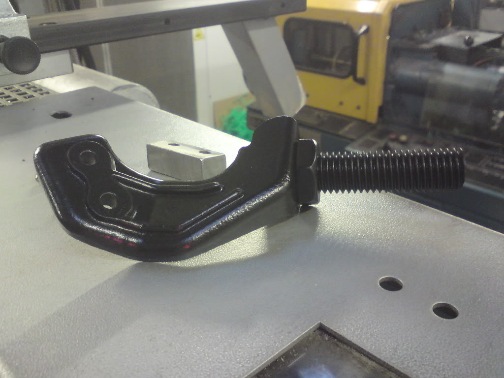

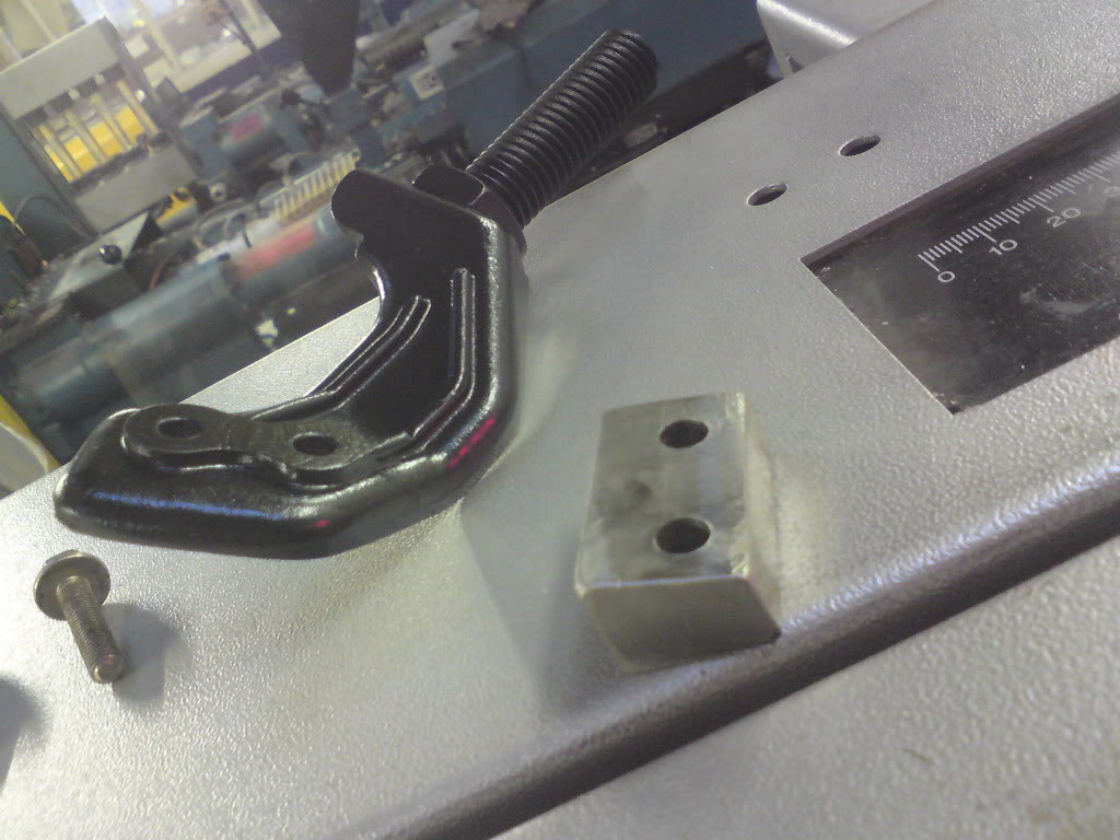

not much of an update....but here goes...
Throttle cable mount finished, after making the extension (read back) to make the throttle cable nice and tight, instead of slack, the bonnet would not close. The bolt was too long....time for some thinking.
First, the finished throttle cable bracket, painted black, now with a 'thin' nut (old one milled in half)...
Spent a few hours on a few bits of metal on the milling machine, and ended up with this...a small angled shim. Points the bracket downwards perfectly to allow the bonnet to close :)

nice jordan, so your using the piece of metal as a spacer?... is the drill milling machine still broke? i will come round for the stickers pal to night you can see the pins and matt black bonnet.
