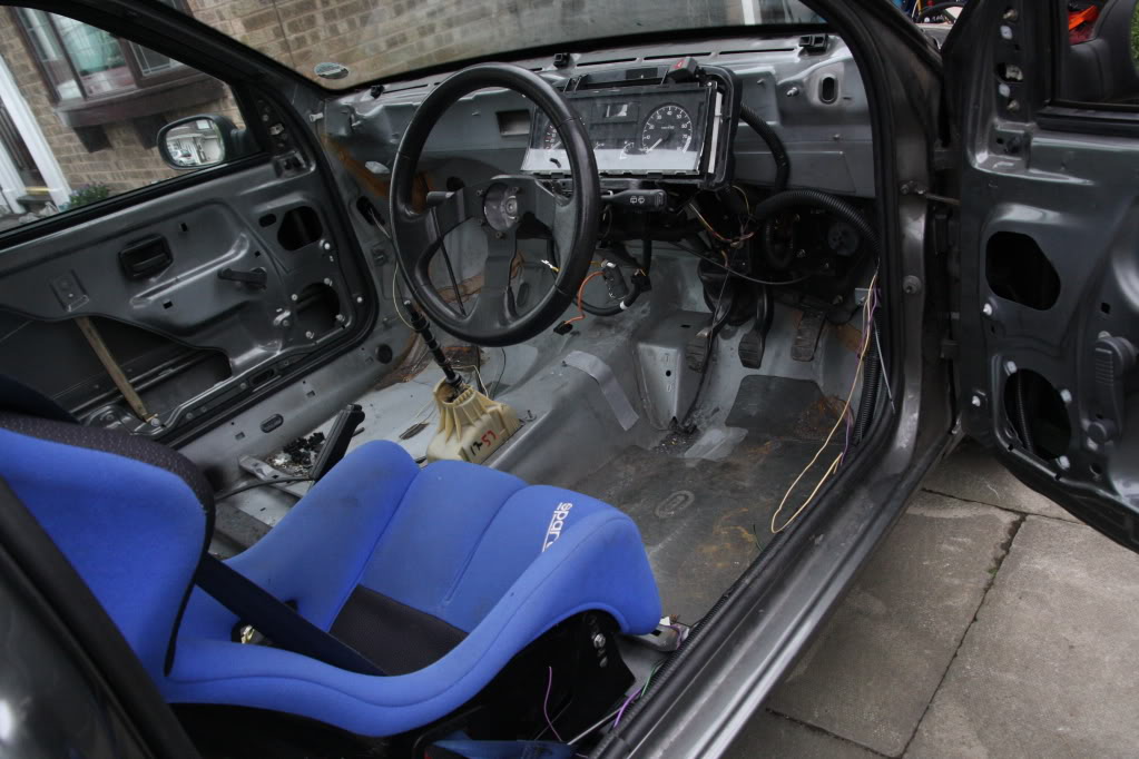

Few pics from today...

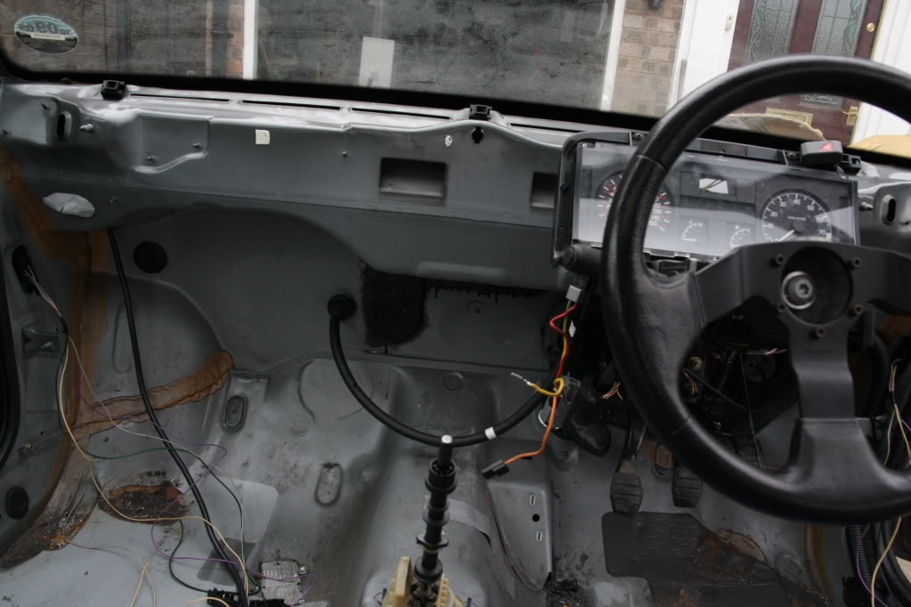

Nice dash? looks so much better with no loom inside!

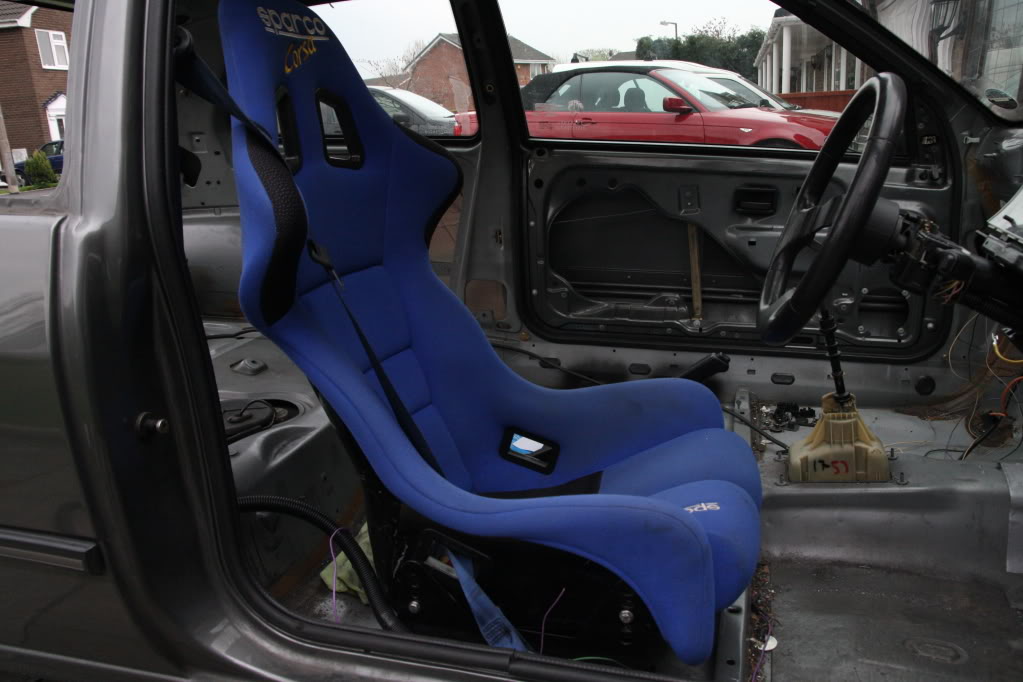

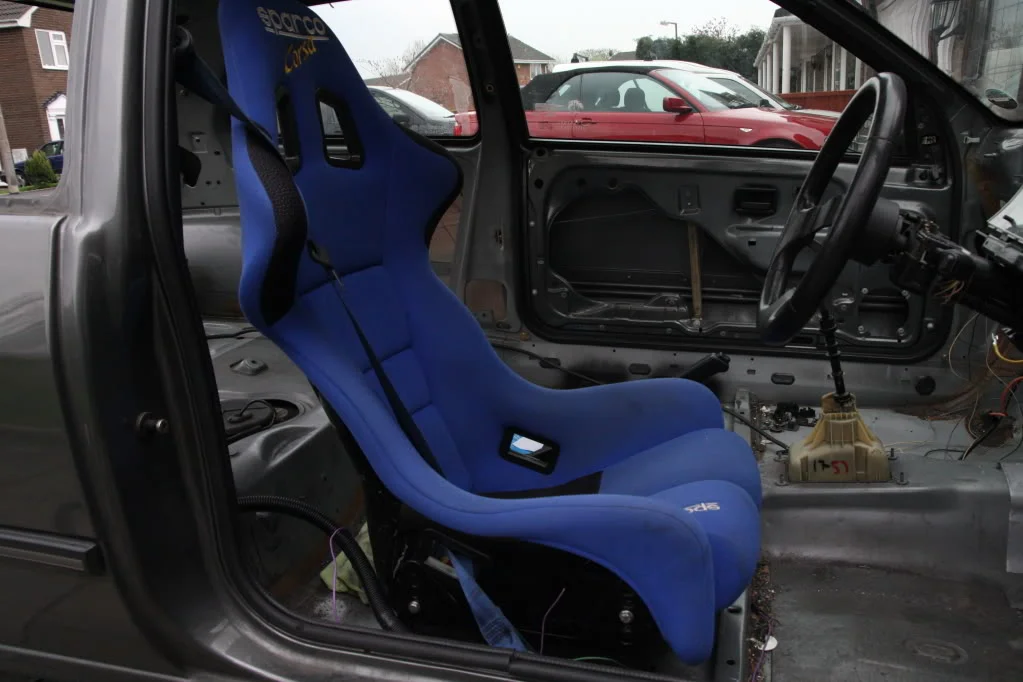

Seat mounted low on the new seat bars which were welded yesterday...

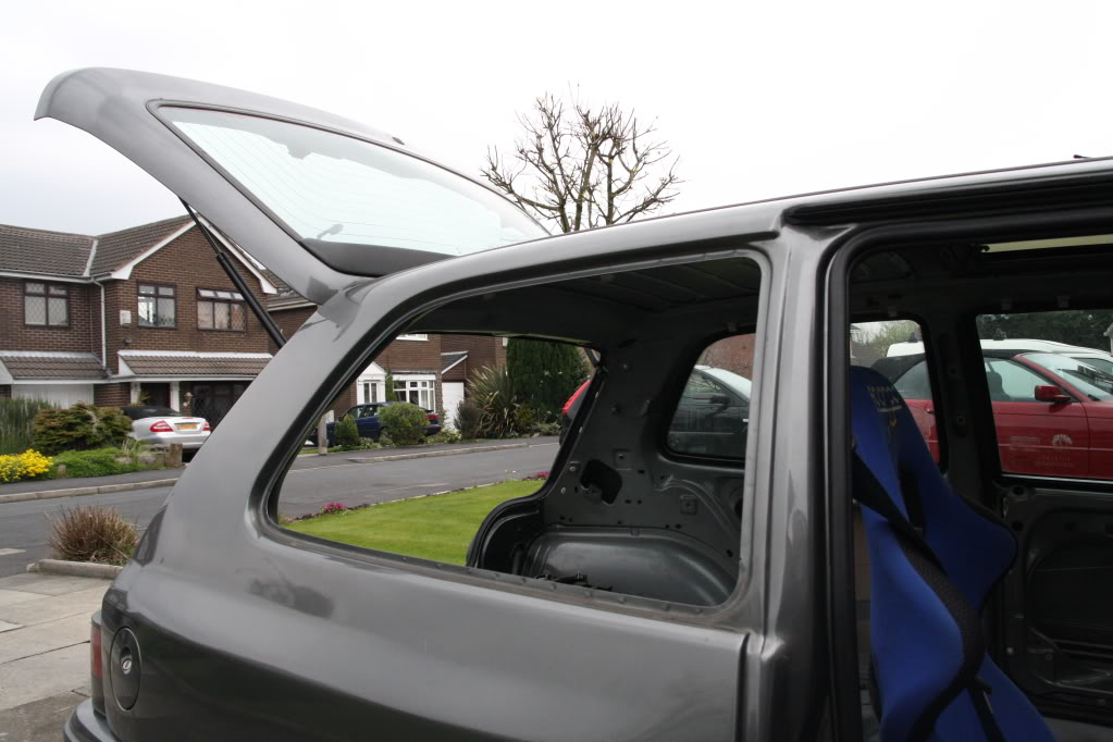

Then rear windows out...
And fitted todays arrival....full set of polycarbs :) not all fitted yet though!

That seat is looooooooooooooow!
