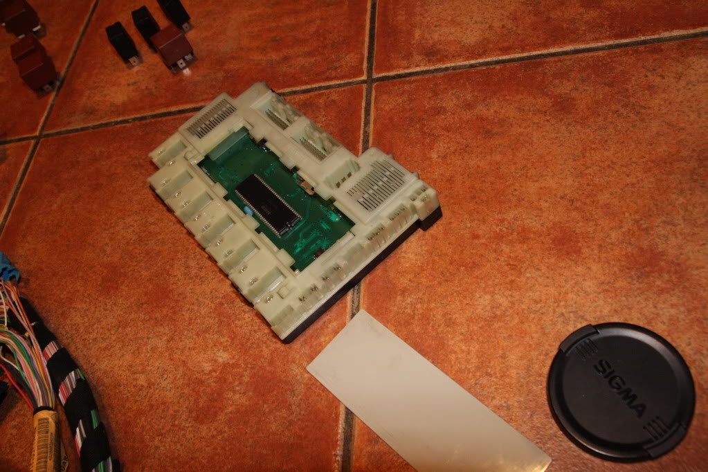

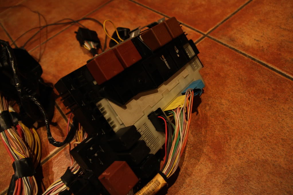

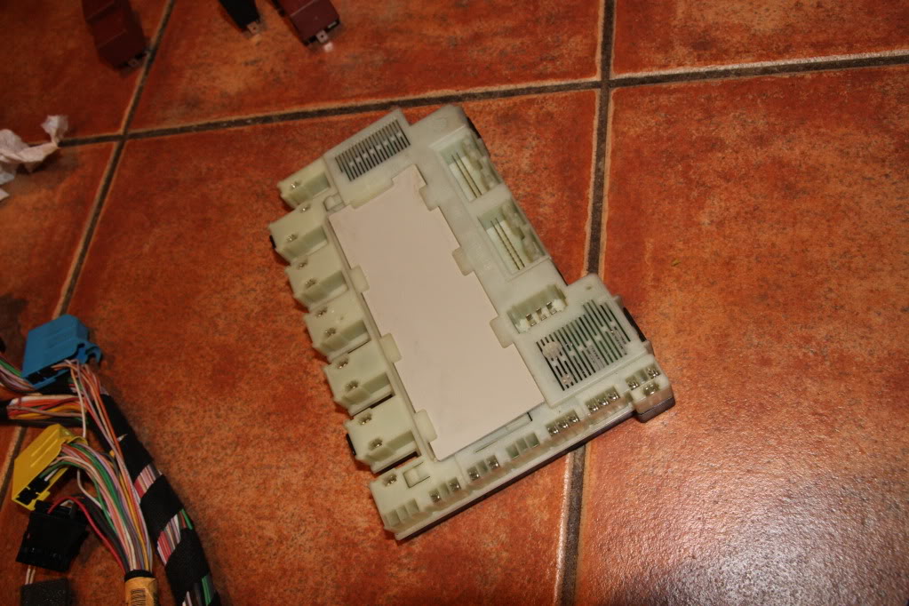

Ok, thanks to matteh for finding the PDF with all the immobiliser info in, and working out various things to try and get past my immobiliser just to get the car running again...
Dismantled a few things from the 172 interior loom before, split the UCH up slightly, and trimmed everything that connects to it off (bar 4 wires lol)...
As it would be in the car...
Relays Removed, im only interested in the circuit for the immobiliser...

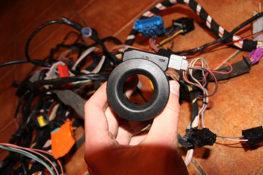

Just need to put the key that came with the loom in the middle of this...
Then basically got 1 wire from the decoder ring to the UCH, one wire from the UCH to the ECU (Immobiliser pin input), and a couple of lives/earths to connect, and I *should* be good to go.... :)
My ECU is currently 'virginised', as it was flashed with an RSTuner full ECU write, so is ready to accept the immob signal....hopefully it will all play nice in the morning!

UCH/Decoder etc all wired up, wire ran to the ECU....
Just need a battery for the key fob now (Going to have a search to see what I need on here)...
I tried starting it without a battery in the fob and it dosent, so Im hoping that is the last piece of the puzzle....
Re: Mk1 172 Hybrid Track Car Project
It doesn't need the battery to read the immobilser code off the key i'm afriad :(, its only for the central locking.
As i just found out doh! Put a battery from the valver key in (Same code/model)....still dosent fire up...
A bit of investigating with the multi meter showed.....
Signal wire from Decoder Ring > UCH =
No Key: ~12.00v
Key Present: ~8.00v
LED From the UCH =
No Key: ~8.00v
Key Present: ~7.00v
Im correct in saying if the Immob wasnt going off, the LED would flash...So I should see the voltage from the LED wire going up and down? It just stays at a fixed voltage...
The signal wire changes by a definitave amount as said^ so im guessing its sending some sort of signal to the UCH....
Still, fuel pump primes etc, just dosent fire up....guessing the immobiliser disables the injectors...
