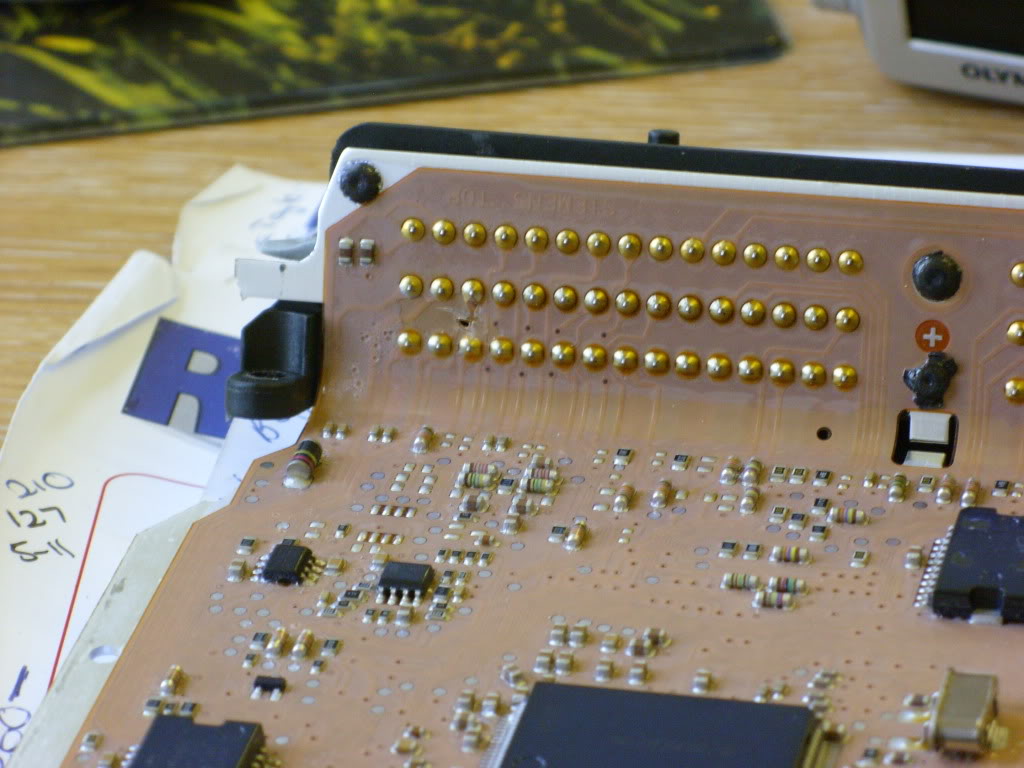

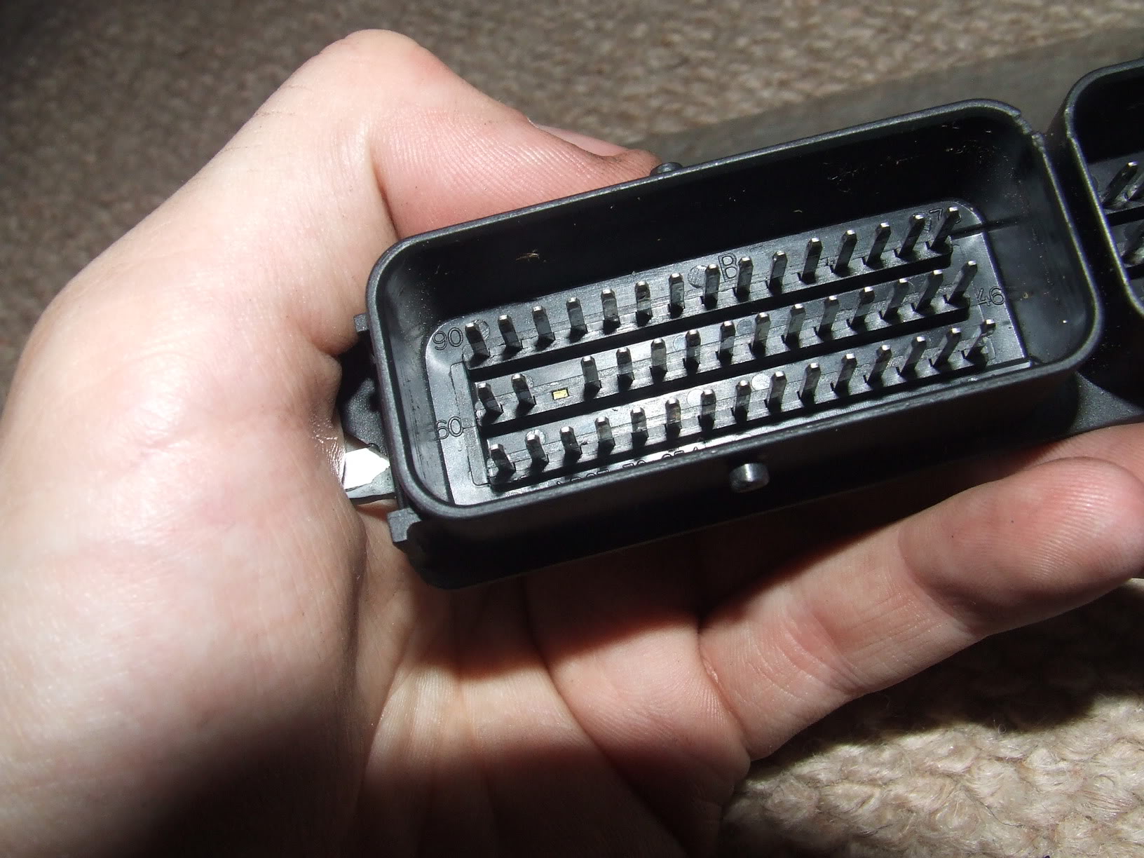

Andrew Cooke, or Matteh, could you possibly take your ECU casing off and check the ribbon/pcb near pin 58 and see if its the same? If so, its proof that its the ECU Clinic thats done it in my eyes....
I'll have a look, but my ECU is a Sirius 34, so it won't be the same, I'll have to work out what pin 58 is on my ECU.
Ahh didnt realise, the immobiliser pin will probably be different then
Thanks anyway if you manage to work it out :) or can see any damaged tracks inside

Want me to photo it tomo for you Jord?
yeah give it a check over see if there are any cut tracks! and pray that its got 172 software on it, not 1.4 like mine had lol!

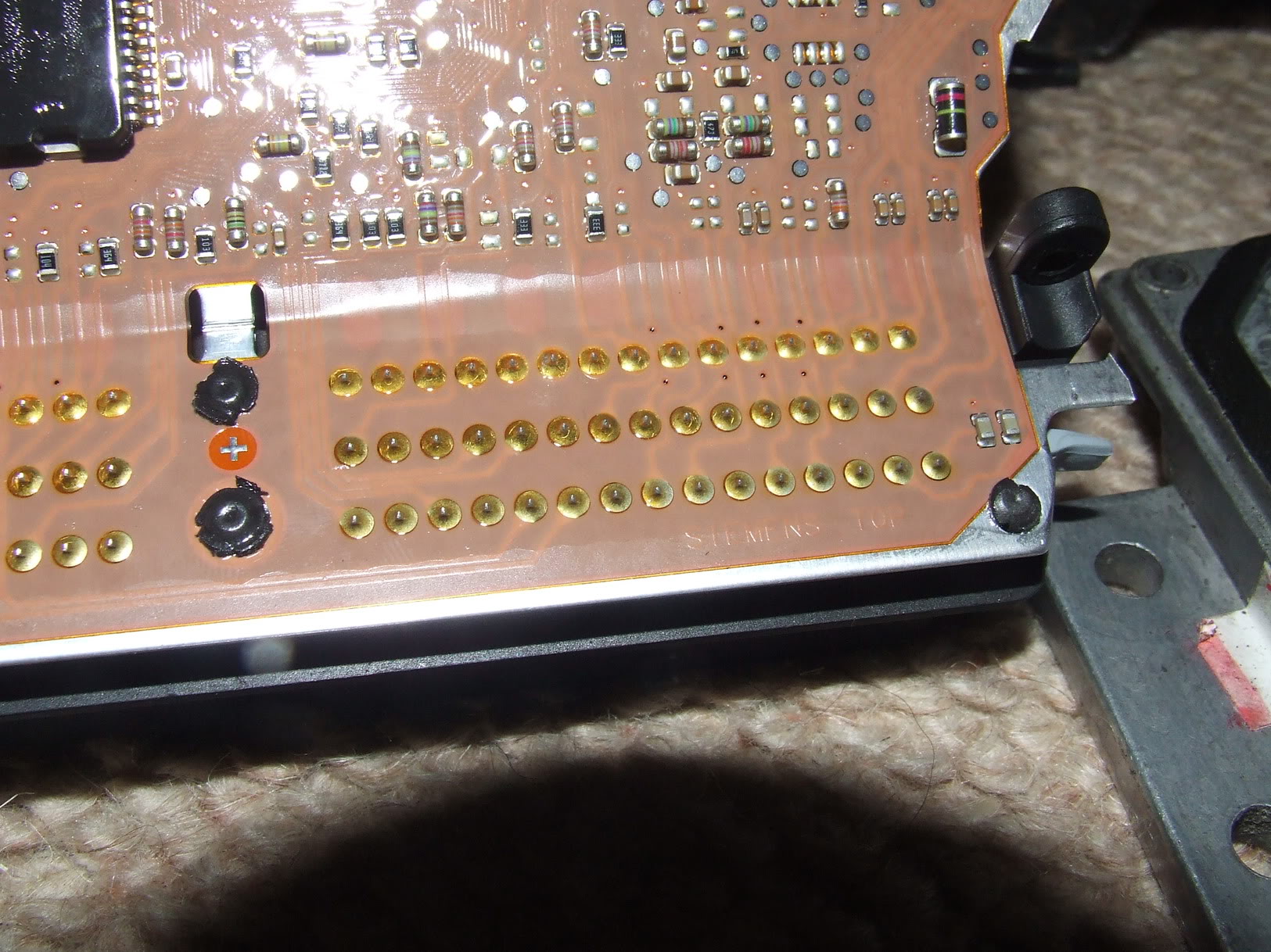

Emulator is now soldered on, power + earth are soldered onto the correct pins, and the emulator wire is now soldered onto the copper track on the ecu side....just put it back together so will see it if works tommorow!

Mine:
he cut the pin on mine
i put up a thread on it when i first got the ecu
http://www.cliosport.net/forum/showthread.php?t=302295
wish they would have just cut the pin on mine and not fucked up the board inside FFS :(
Its soldered now, but ive no idea if itl stay on the track or not!
ok its come off the track already....lol.
Think im going to have to try and find someone local who is good with little fiddly circuit boards to get it soldered properly.
The track gets smaller and splits into two further down, so cant exactly join it somewhere else....damn.
i may have done, but cant do now its come off the track....i think its took the bit of track it was soldered to with it :S
Not sure what to do with it
  Bumder With A Buffer

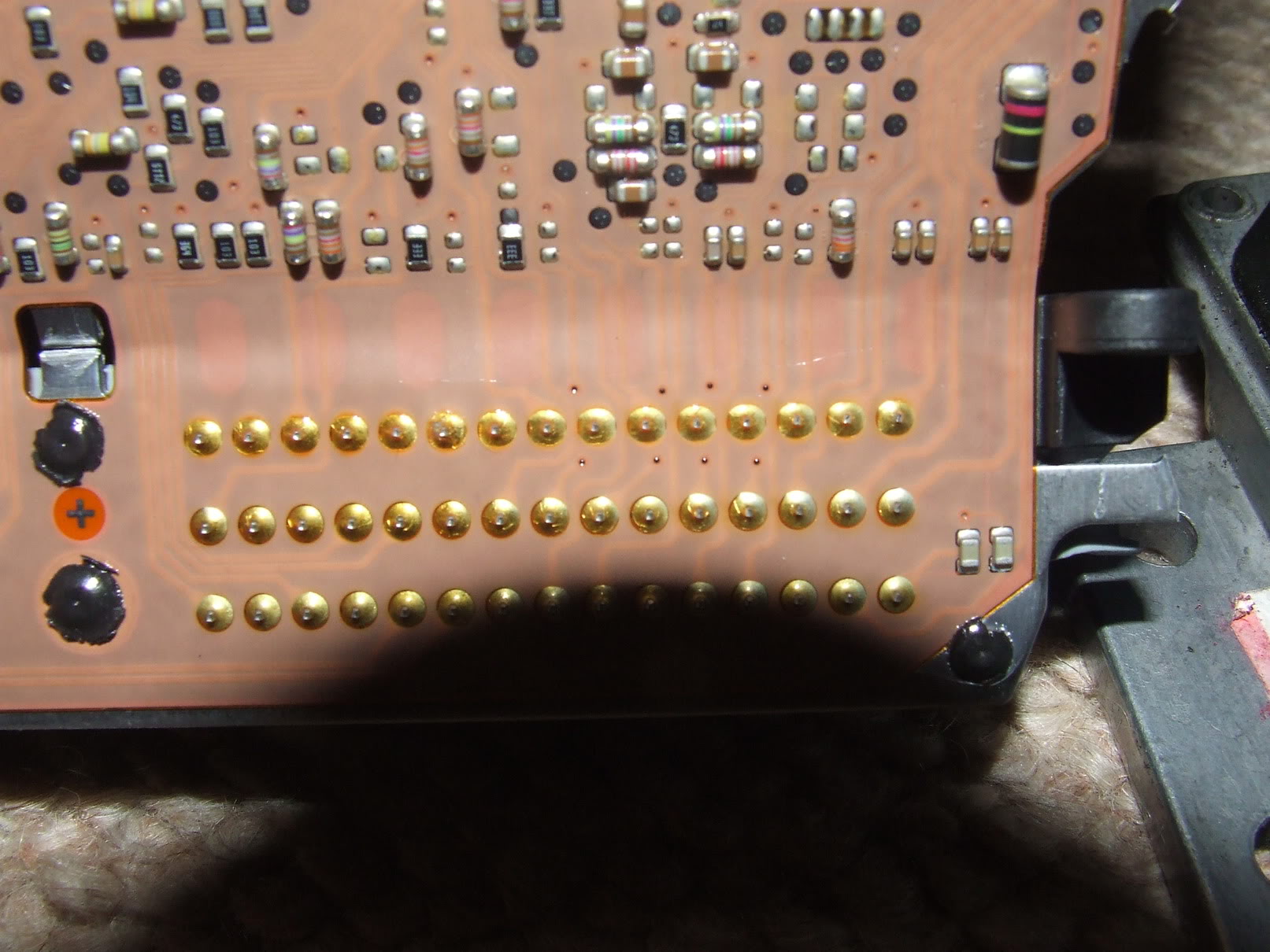

Where does the track go then jord?? Are you able to get any better photos of where it goes??
I can trace it as far as the bottom left of this picture then I lose it! If not do as you say and find someone local who is s**t hot at soldering. I also looked at mattehs one and can see it there but cant see where it goes too as he hasnt got all the ecu in shot.
My main thinking is that if you trace that track down to a pin on one of the ICs just solder to that. It doesnt matter that its going to that it splits off somewhere as it will still follow the other track. Its hard to explain on here what I mean!
goes into the resistor at the red line first...then comes out the other side as two thinner lines......travels down to those two silver dot things....through them and down to the final red dot, one goes into one side of that resistor......and the other cant make it out its going into the other side of the resistor or one of the three tiny chips

about the damaged track. as others have been saying: to make the pin58 "work" again you just have to use a wire to do a bridge and "skip" the damaged part.
if the track goes to the resistor first, then that's where you have to solder it! forget about where it goes next because the signal has to go through the resistor first!

ah rite just connect the wire to the top of the resistor then. The side closest to the broken track.
I didnt want to risk soldering to the resistor incase the resistor came off....ive managed to get it to stay on the track this time, hopefully that is good enough...
