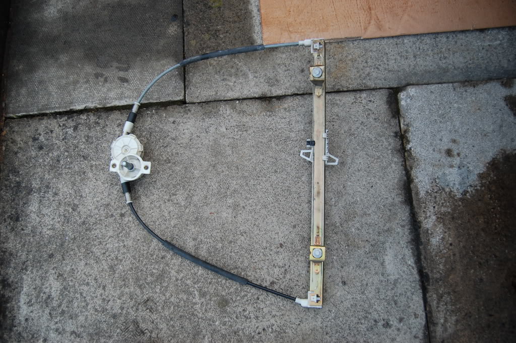

Day 64
Only a small update as ive been busy, and not had time to sort any of the little problems on the car. After the problem I had with the battery going flat all the time, it turned out to be the alternator wasnt properly connected, so the battery wasnt being charged.

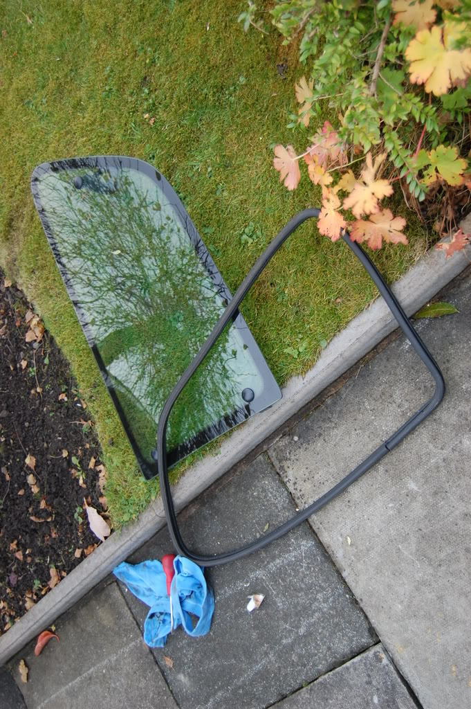

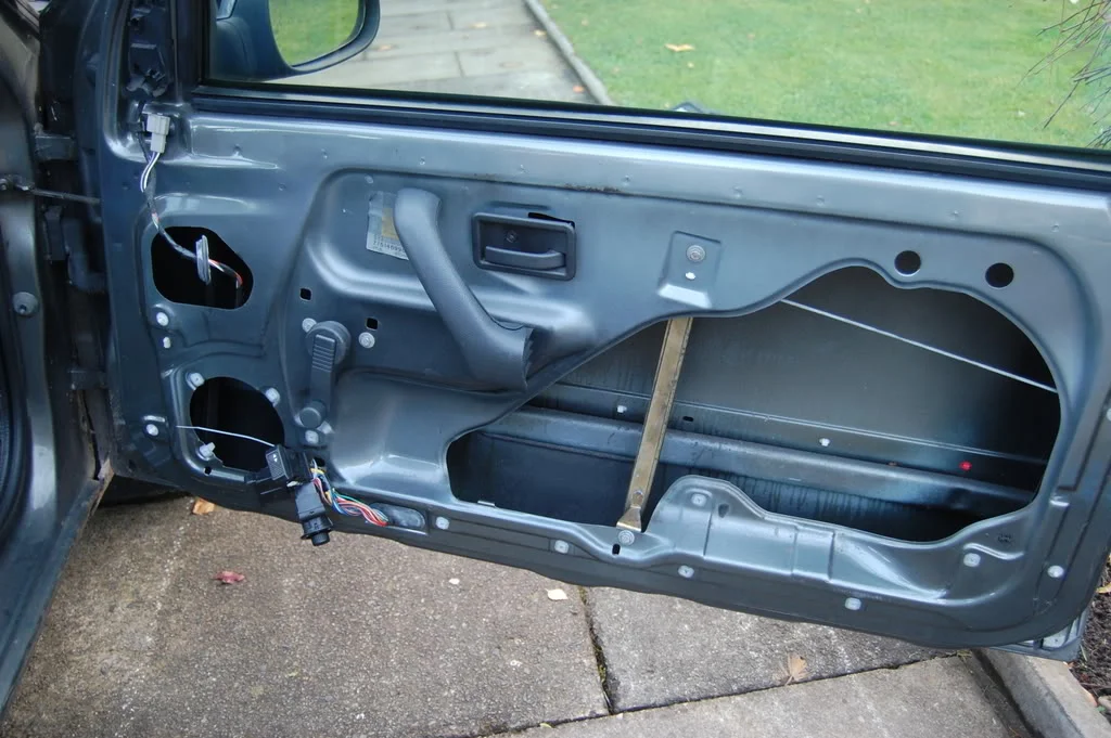

Ive also been getting a intermittent clunking under braking, and when pulling way, which I had a good look around for a cause today, but couldnt see anything wrong. I got some manual front window mechanisms and fixed glass rear quarter windows from Winston not so long ago, so decided to fit those. I wanted to replace the front windows with manual, so I can remove the door looms eventually.

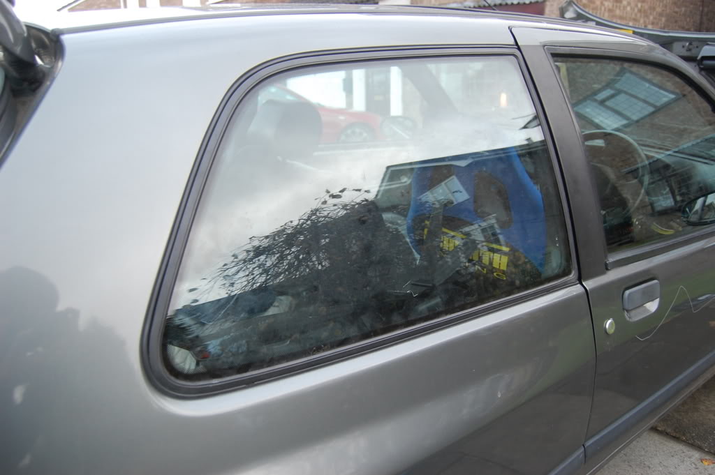

I also fitted fixed rear quater windows, as I think they look better than the pop out ones, and can also easily replaced with plastic ones to reduce weight further if I wanted, as the type of seal allows for it.

looking good, not too keen on the non opening rear windows though, they look.... weird. what model clio they usually off??
keep up the good work :)
Re: Mk1 Hybrid Project
they are off a 1.2 beebop, or the likes
I only got them so i can eventually run polycarbs when I have the money :)
