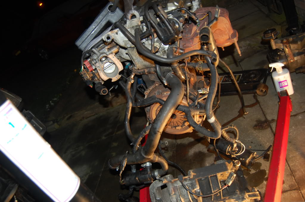

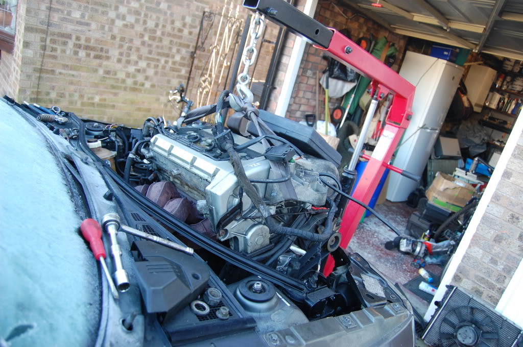

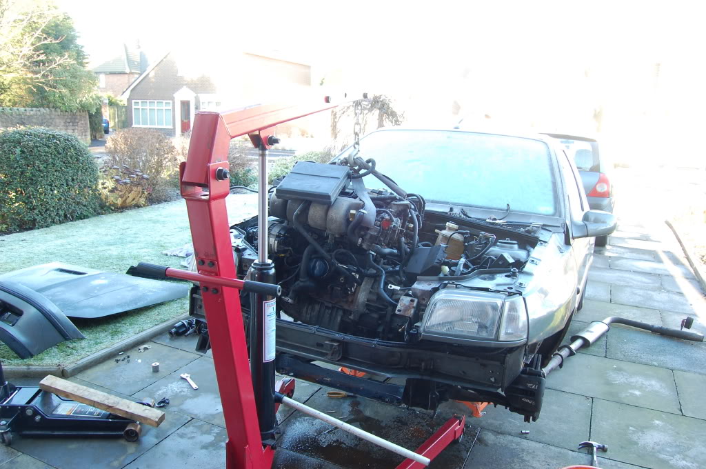

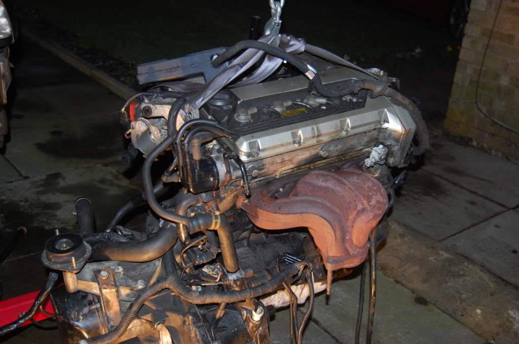

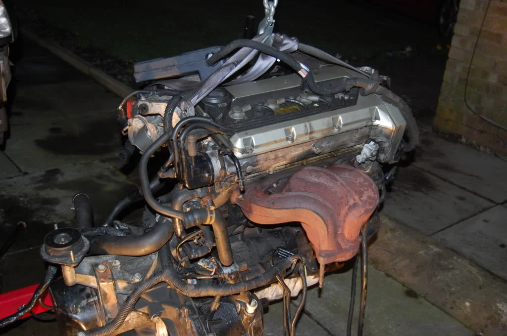

Got up early today, my day off uni (10am, lol)...set about getting the engine out of the car again....stupidly cold day again, but an hour or so later...

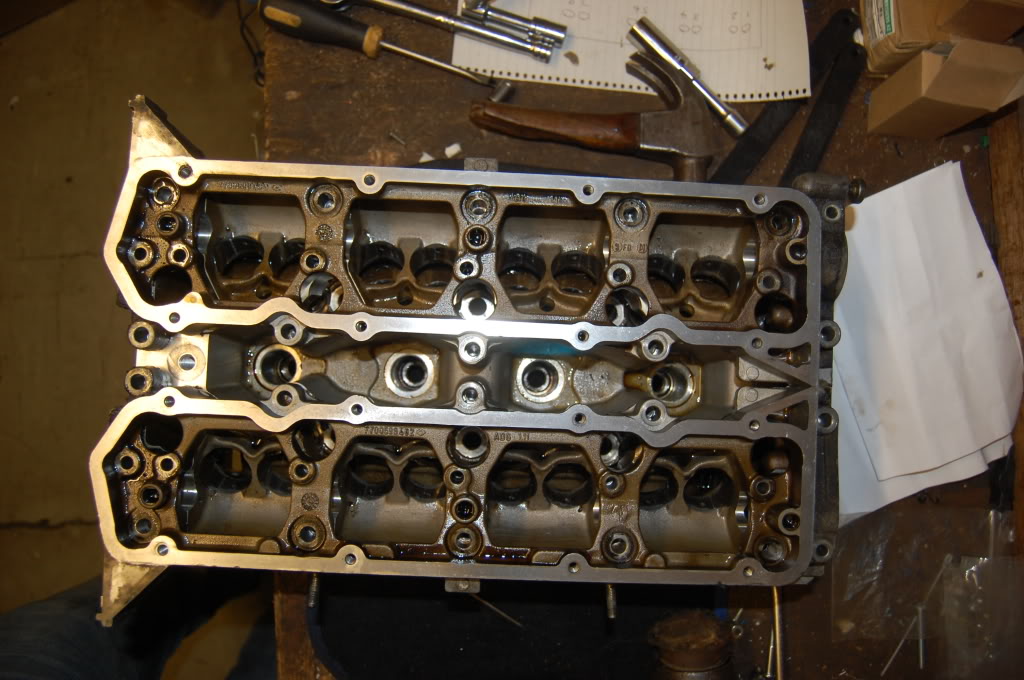

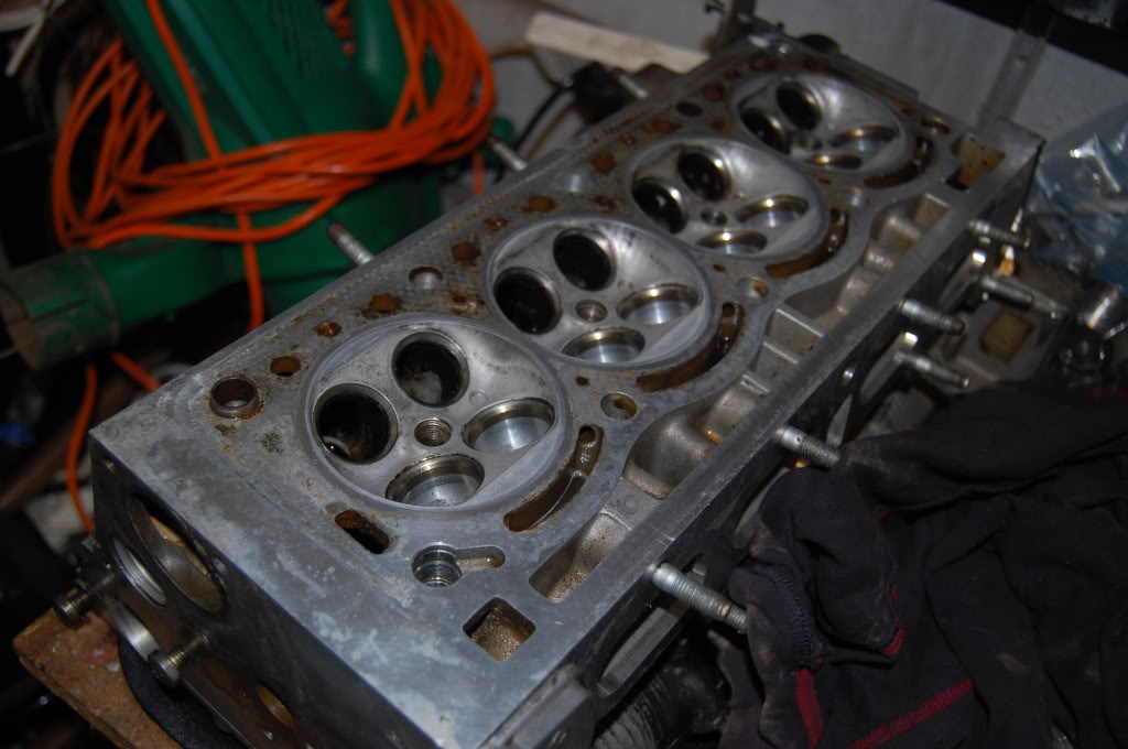

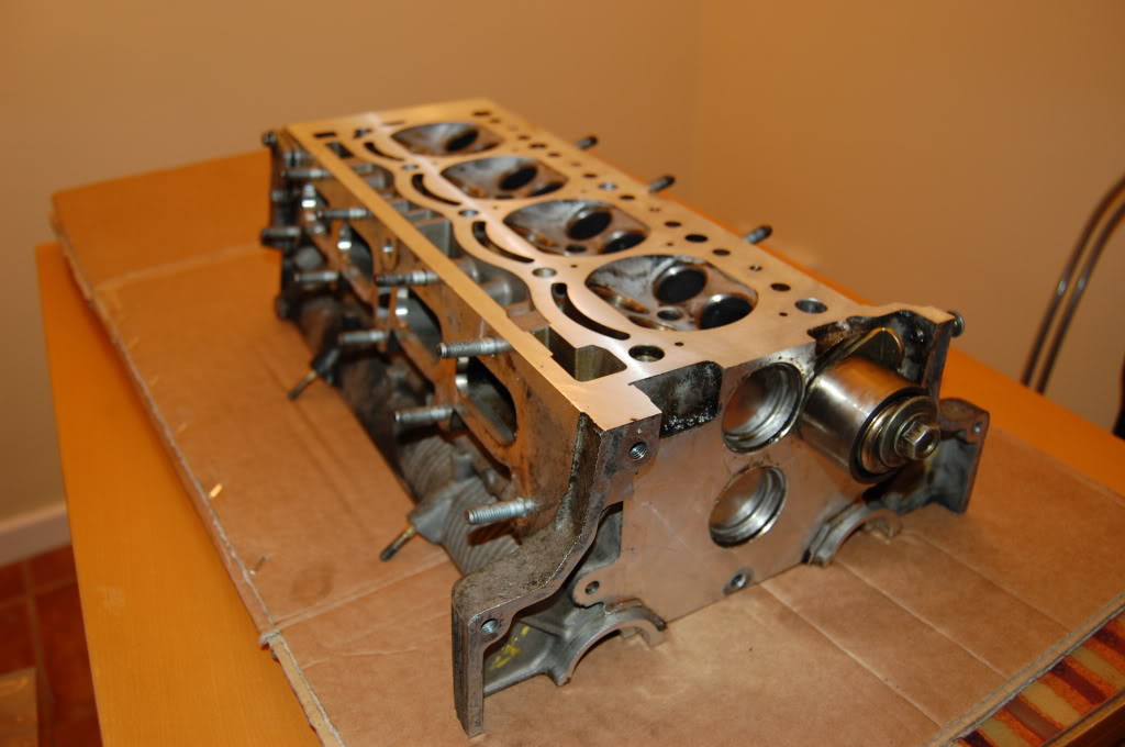

Once it was out, I waited around for the taxi to pick me up (drunknmunky/Nick, lol)...who took me up to the engineering place that had skimmed the Williams head for me...

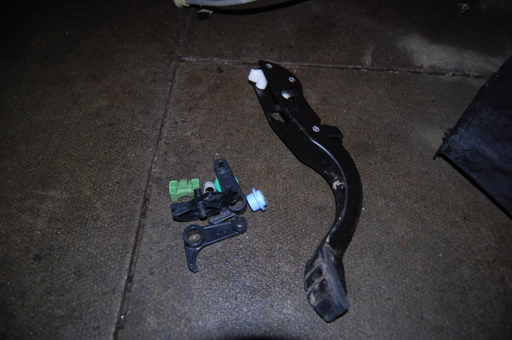

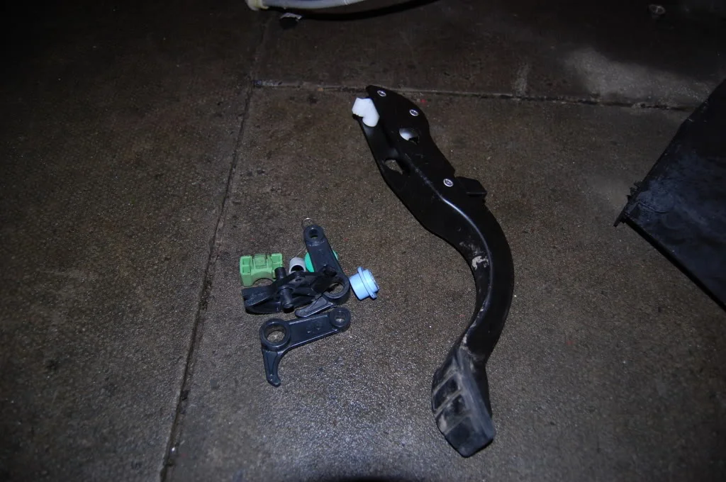

From there, we headed to Winstons, to get a clutch cable and pedal from his valver shell...lifesaver once again

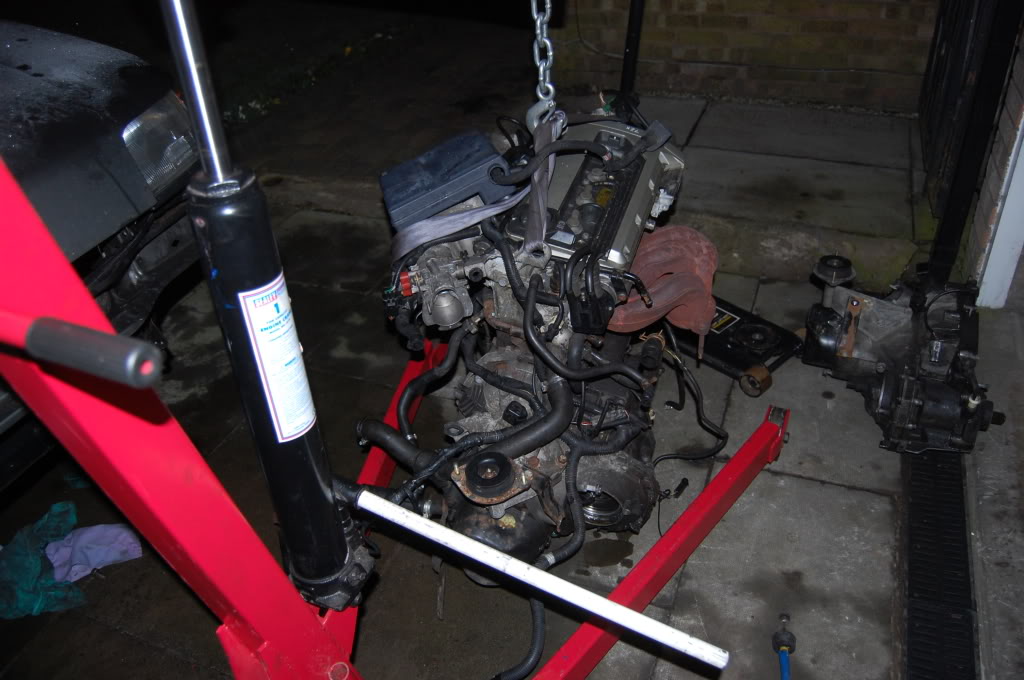

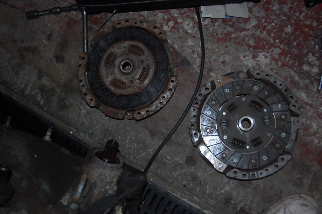

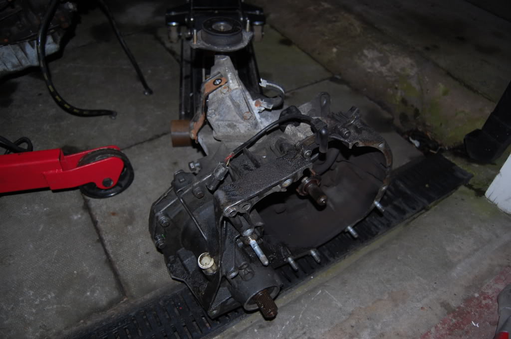

Last thing to do was to go and remove the gearbox and clutch from the valver engine, and get them back to my house. Eventually got the box off, along with the clutch, and put them in the car. The clutch that was on the valver engine is only 6 months old, and the box was a re-con around the same time, so these will be better to use in the long run anyway...

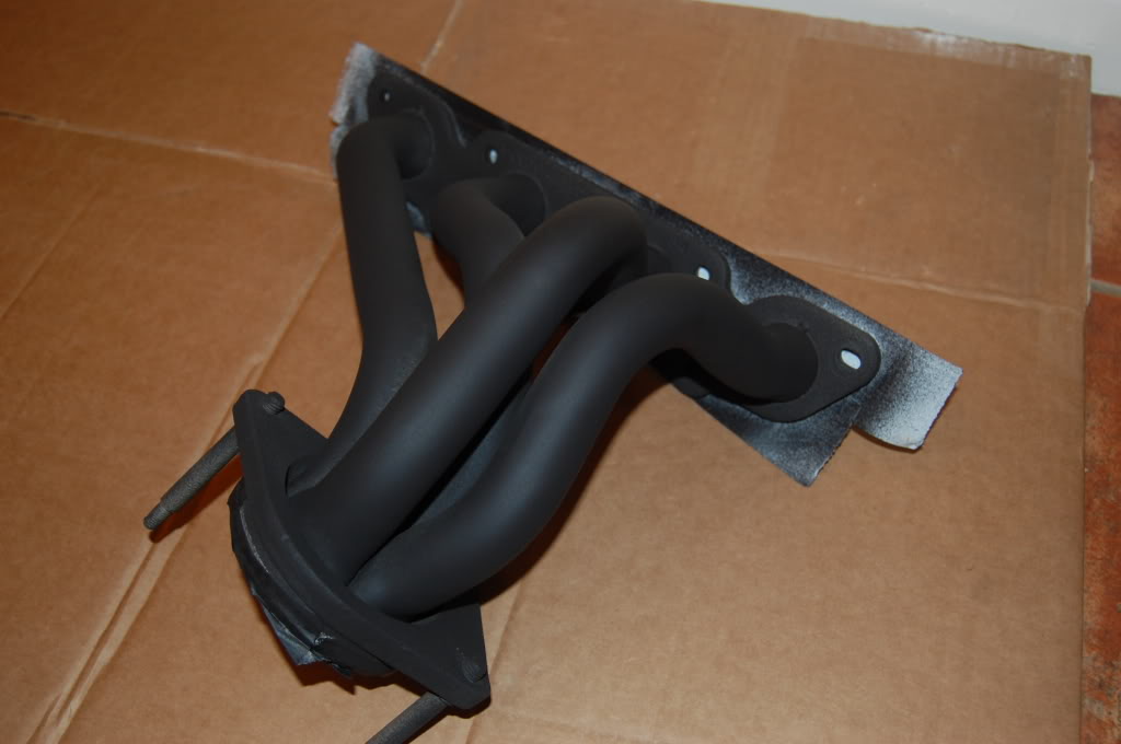

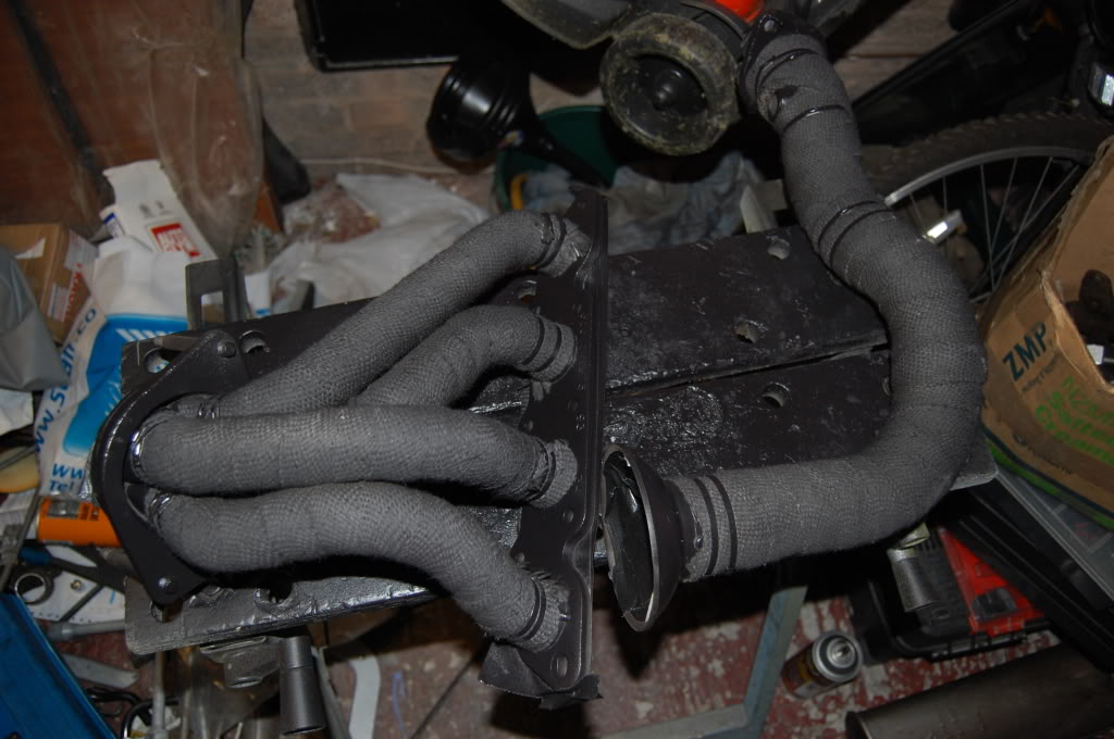

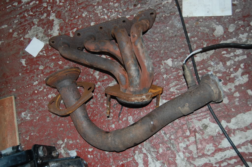

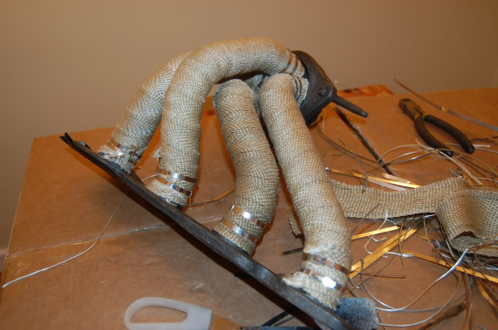

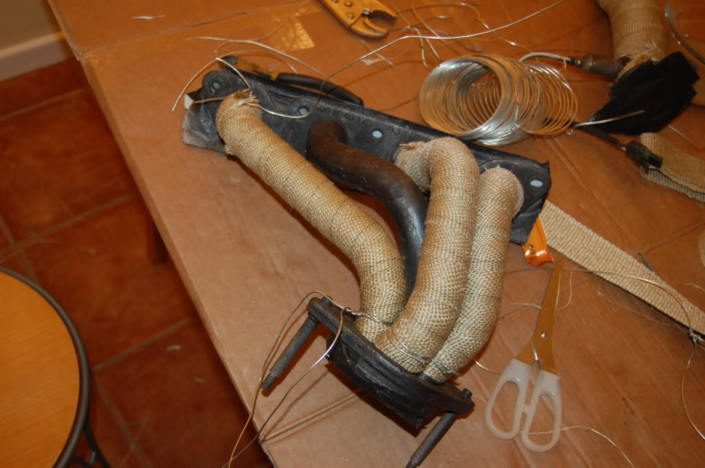

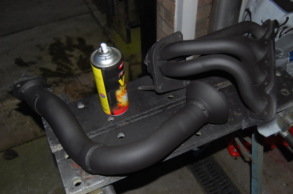

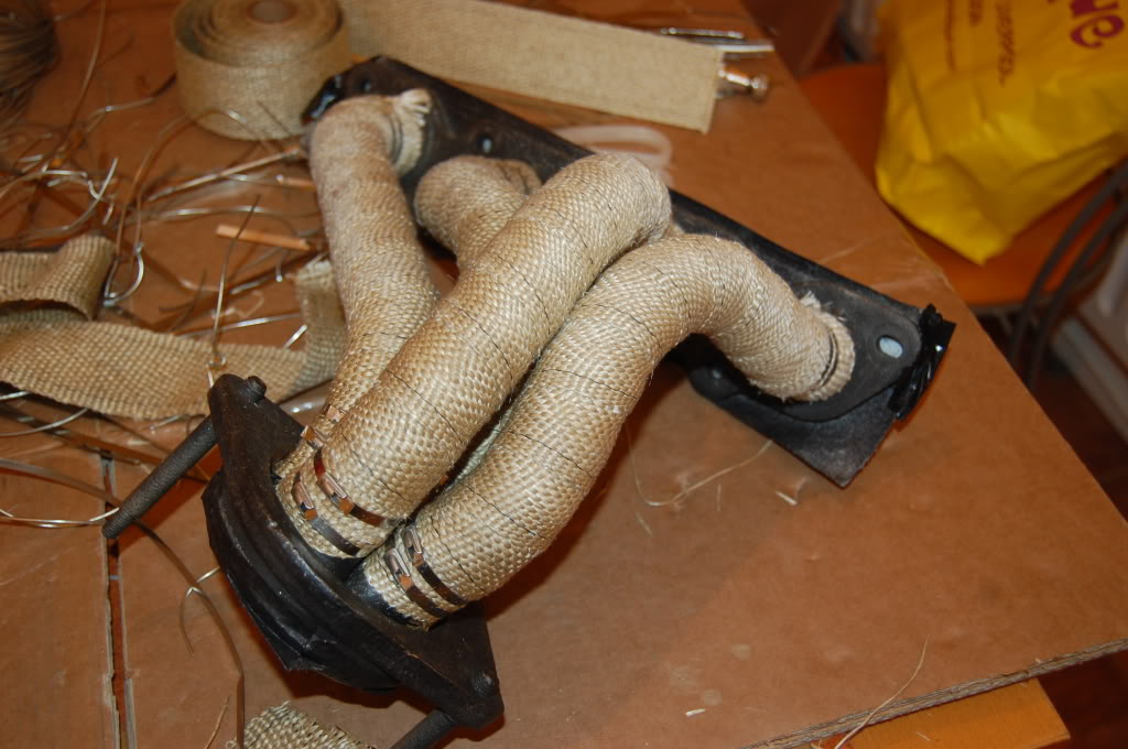

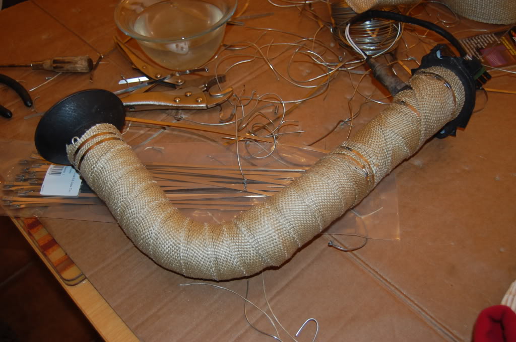

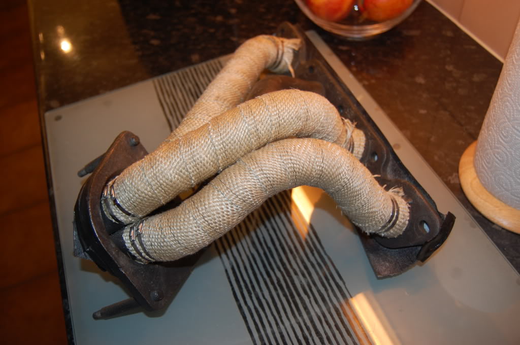

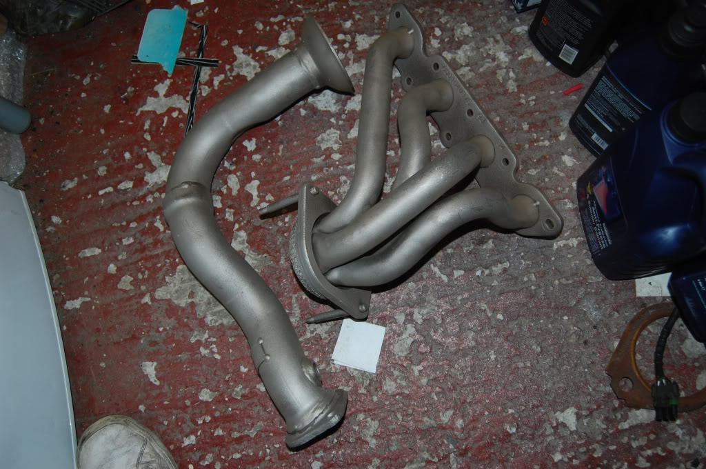

While I had been out for most of the day, the wrapped manifold and downpipe were drying after I sealed them earlier in the day. In person they look black, no idea why the look grey in the picture!

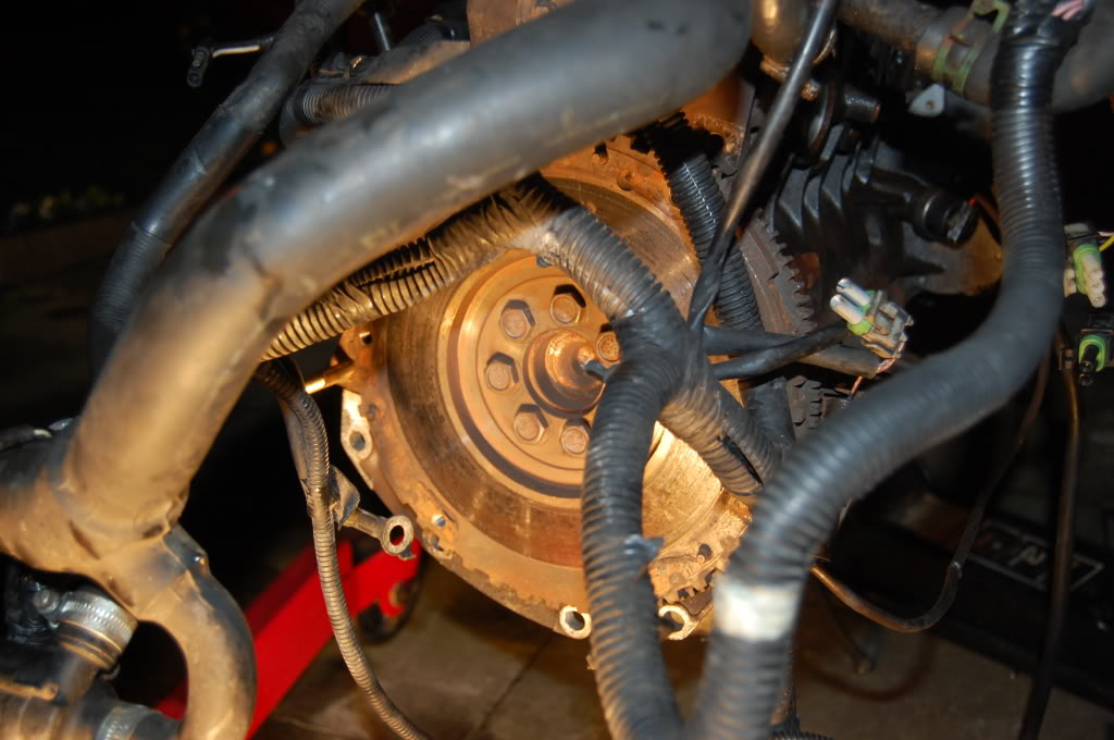

I needed to remove the box and clutch from the engine before I could fit the others obviously...

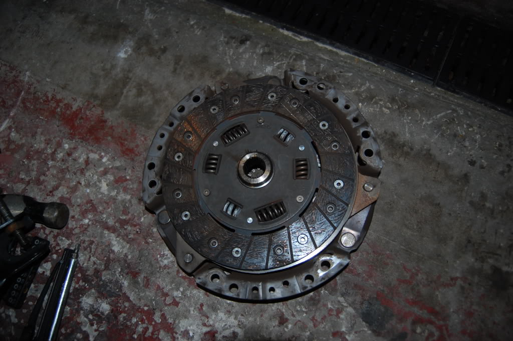

6 month old clutch vs other

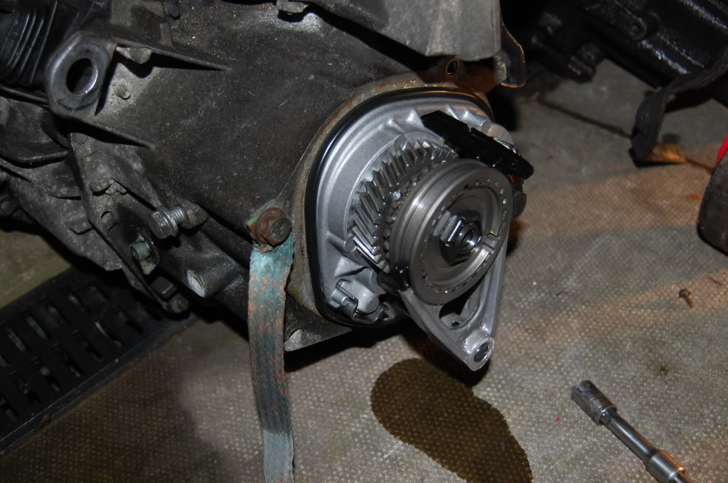

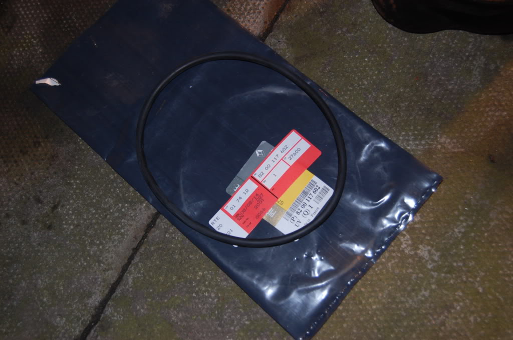

Before I put the newer gearbox onto the engine, I wanted to replace the end cap seal, to ensure it would definately not leak, picked the seal up from Renault a while back...

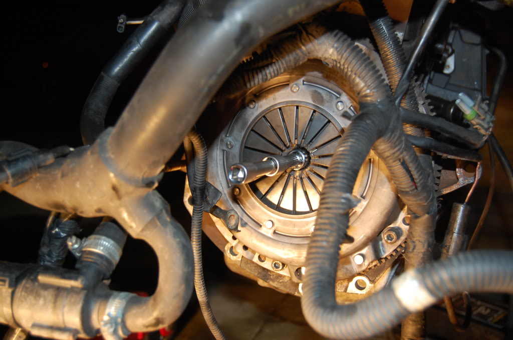

Once I had done that, I fitted the newer clutch to the engine, using a trusted rig-up method....lined up first time
Once the clutch was on, I attempted to put the gearbox on. This ended up being an absolute pain, I have no idea why, but after 5 or 6 attempts I got it on and bolted on tight....

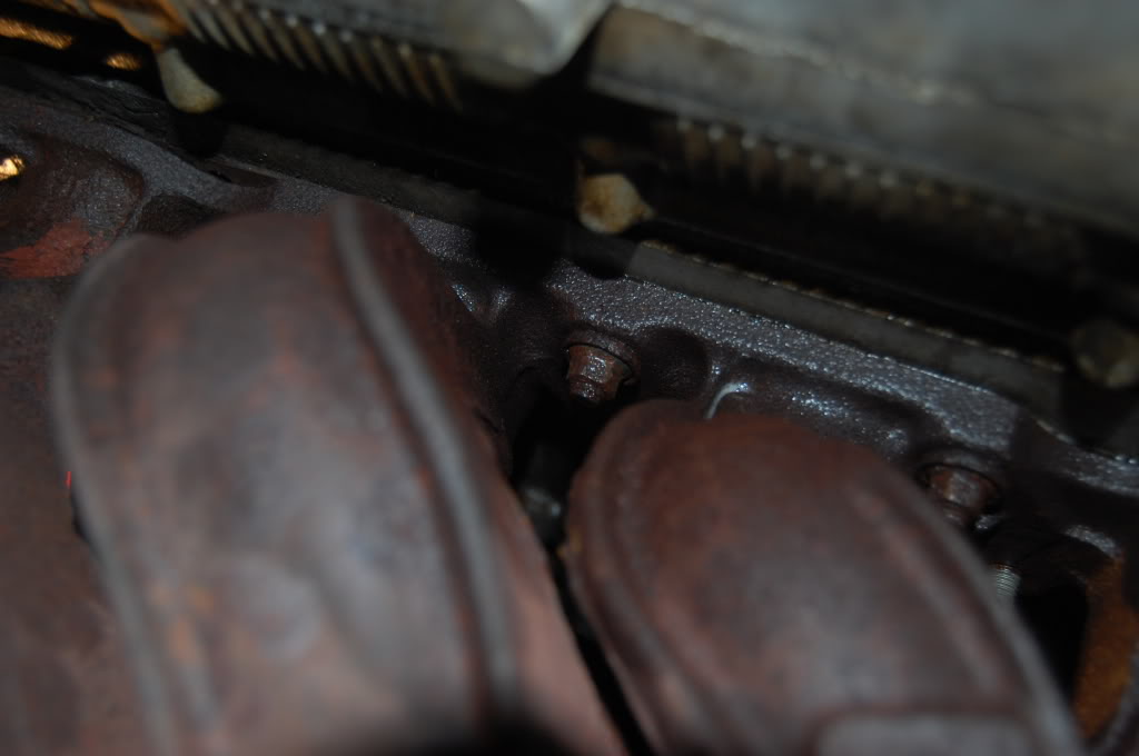

Was getting late now, and I wanted to finish off for the night, but I had one last thing to do. I wanted to remove the valver exhaust manifold so I could put the Williams one on before friday, so the exhaust that I have made is correct for what I want....But as usual, I hit another problem when two of the 8 bolts rounded off, and I couldnt get them off

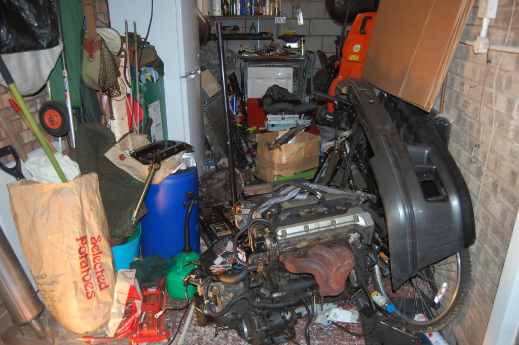

Will have to have a think about that for tommorow, as I ideally want the williams manifold on. I put everything in the garage for the night, as you can see its nice and tidy....
Anyway, all I need to do now is put the engine back in, and sort the manifold, before friday. Only got after 4pm tommorow to do it, as im in uni all day, so im pushing it lol!

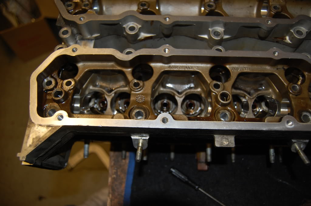

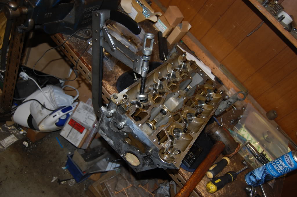

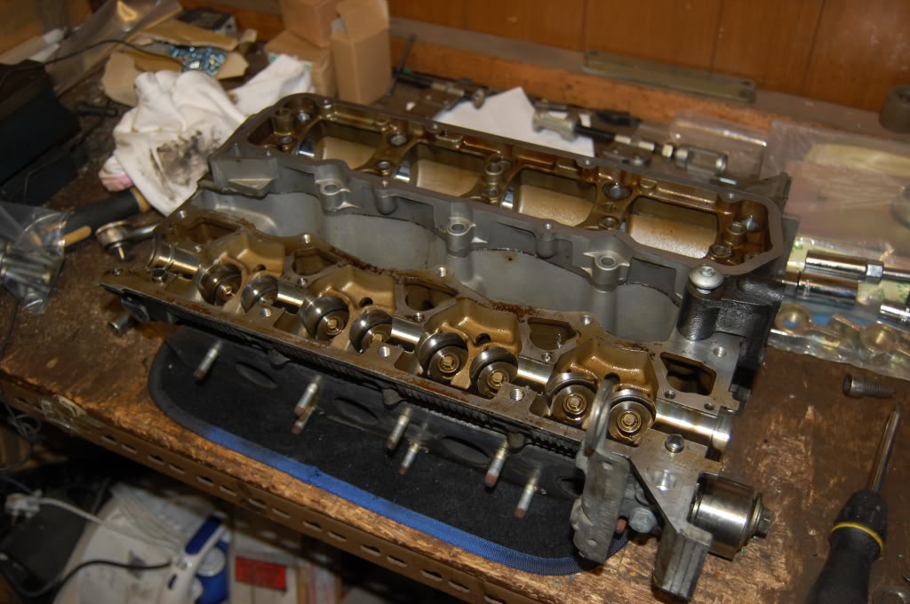

Hopefully all will go well and il make it to JP exhausts on friday, and get the exhaust made. By then I will have the williams head built up with the new seals and valves, ready to go onto the block at the weekend
