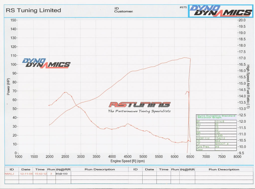

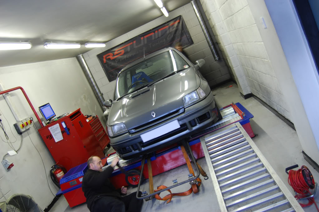

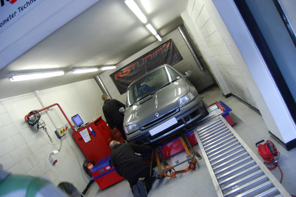

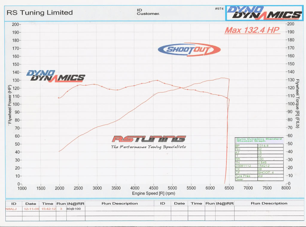

Had a very poor result from the Hybrid today on the dyno today, but glad I did it as I now know there is a serious problem with it. Took the drive upto Paul @ RS Tuning in Leeds, to see what power the hybrid was running. Current engine spec is: Megane F7R 2.0 Bottom End, Standard Valver Head…Running Williams ECU. I was told the Williams ECU was chipped to allow the spec of the engine to run, but its seems not to be the case.
For people that know dyno graphs, you can probably see whats going wrong. Paul explained to me it was massively overfuelling, and could be due to the valver head having smaller valves than a williams head, and the williams ECU was making the engine run rich, possibly meaning that the ECU has never been set up properly for the engine.
Massive overfuelling resulted in poor power output, Hybrids of the same specification were running around 160bhp at the rolling road day there just two days ago, so its safe to say im 30bhp down at least. Needless to say I’m pretty dissapointed with the outcome, but at least its uncovered a problem which is fixable, and hopefully give me the correct power output for the setup.

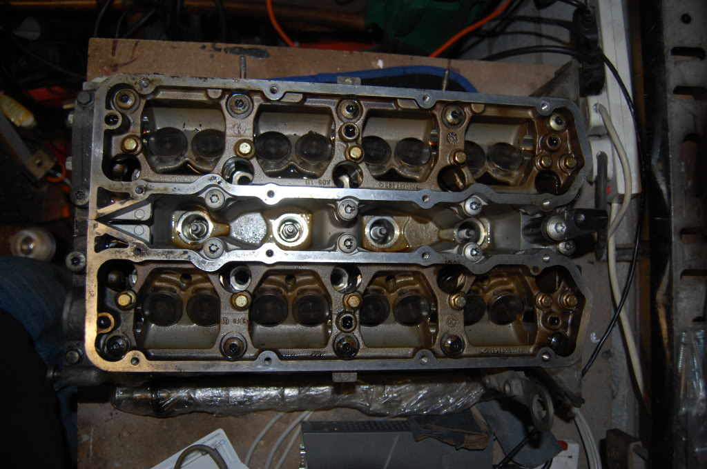

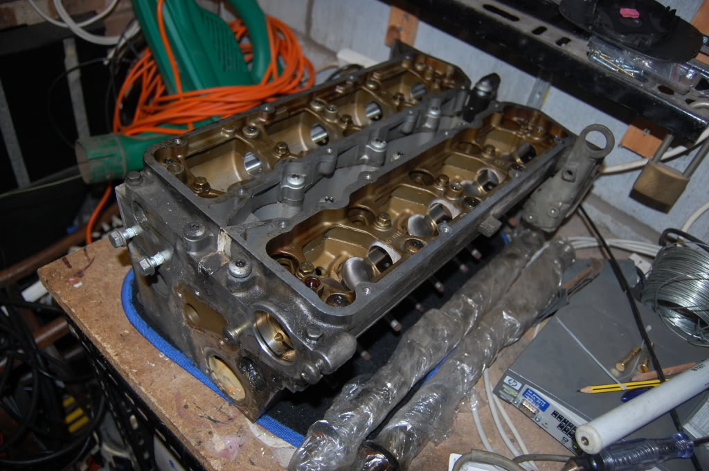

I decided to find Williams head for my F7R engine, to hopefully get it running better. I found one for sale a few days ago, and went to collect it today. The head has had the camshafts removed, but the valves are still in place. The head rebuild is going to be a small side project, replacing seals and then the camshafts themselves. It will then be fitted to the bottom end that I am currently running, to hopefully get it performing better.
This is going to be a bit of a side project for the next few weeks, as I need allsorts of bits to get it ready to go on the car :approve:

edit: just noticed those cheeky set of cams sat next to your head......are they standard;)?
Re: Mk1 Hybrid Project
yeah they are standard williams cams unfortunately LOL

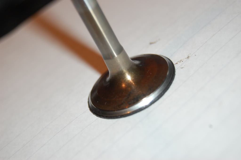

started removing the valves out of the williams head yesterday.....and ran into a problem, once again....
They are slightly worn, only looked at the exhaust valves, not checked inlets yet.
going to try some cutting paste as said when I posted up for a solution, if that does not work....new valves time...
on the shopping list at the moment is headgasket kit, head bolts, oil, coolant, gearbox oil, swap clutch and gear box to this engine from the other, fit the williams cams into the williams head and time it up....the list goes on.......then exhaust and a map!

Be aware though dude, even if you buy new valves, they'll need cutting in.....
