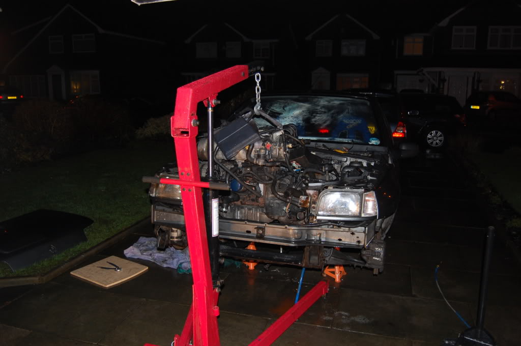

Day 89

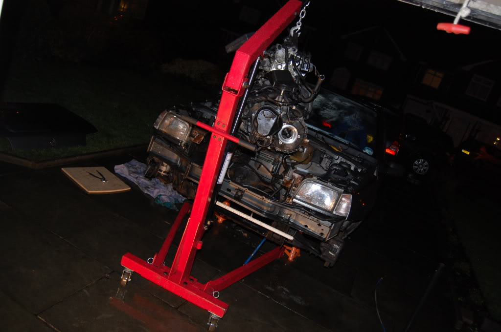

Needed to get the engine back in today as I had JP Exhausts booked for tommorow, so the rush was on....It was raining non stop from when I got home, just had to get on with it...

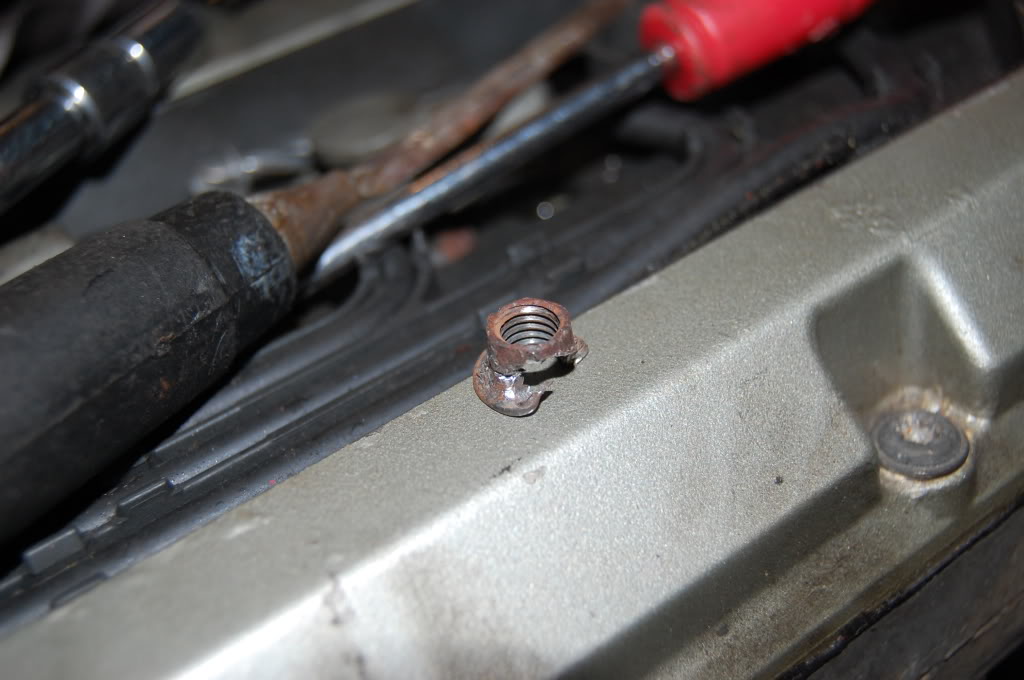

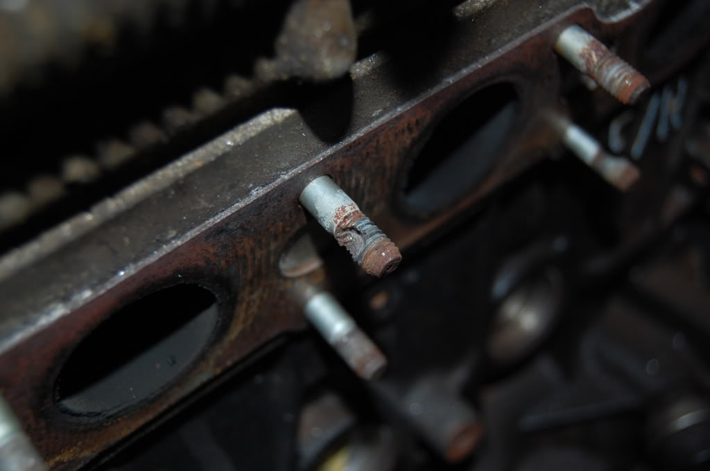

First I needed to get the rounded bolts off the manifold, one of them came off with a better spanner, and the other would not budge. I got the drill on it and drilled the bolt off, wasnt too bothered about the stud as the head is coming off in the next few days, just wanted to get the Williams manifold on so the exhaust could be made correctly.

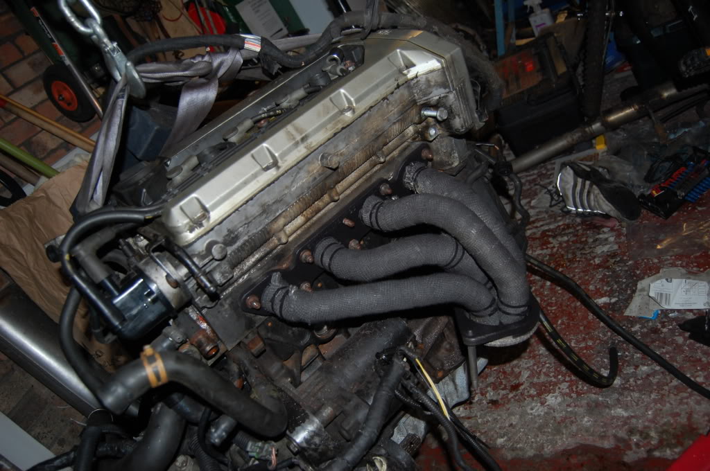

Then I fitted the williams maifold....

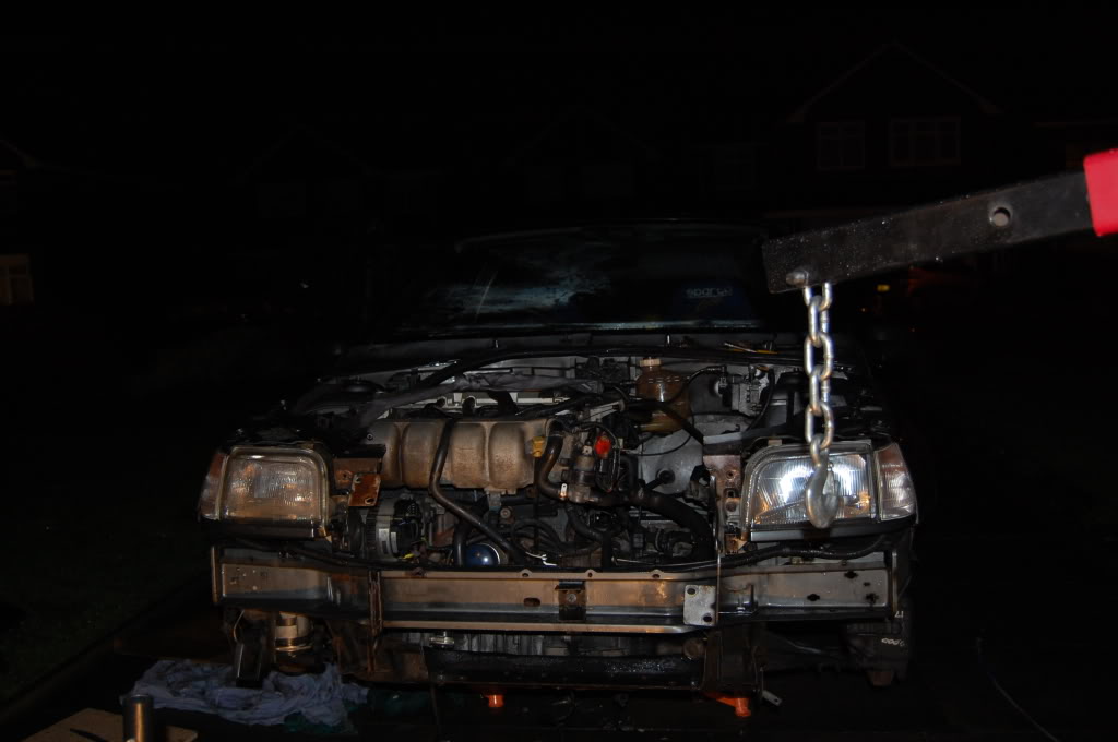

And set about lifting it back in....
Got there in the end, although there was still a million things left to connect up, downpipe, driveshafts, radiator etc etc, and it was 11pm now. I decided to leave it as it was still raining, and there was no possible chance I was going to get it done in time for tommorow morning to go to JP Exhausts.

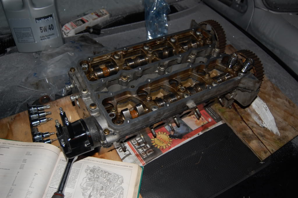

Day 90
Spent a good couple of hours this morning connecting the last bits up to the engine as said, took a bit longer than expected....started it and took it down the road, clutch is good, no whine from the box like the other one had, back how it should be :)
Obviously didnt make it to JP Exhausts, so rebooked it for the 19th December. Winston is lending me an exhaust he has for Oulton next friday, as the DIY side exit is falling to bits...

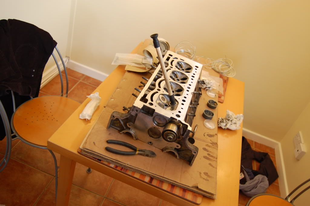

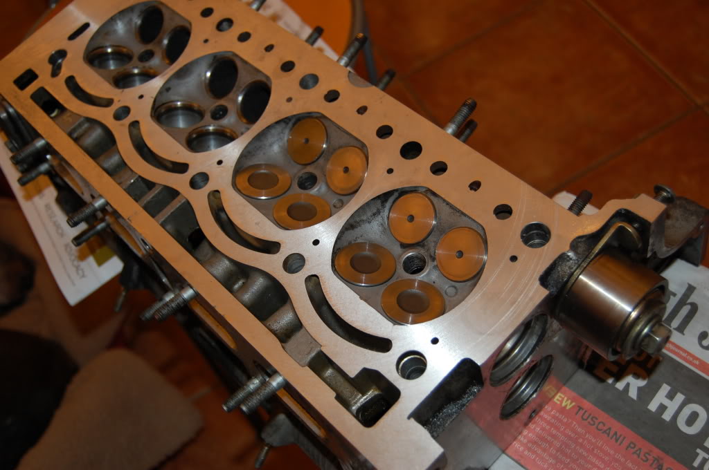

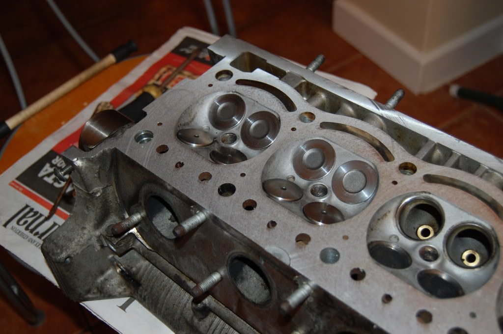

Next thing to sort is the head, so got on with lapping the first four valves...

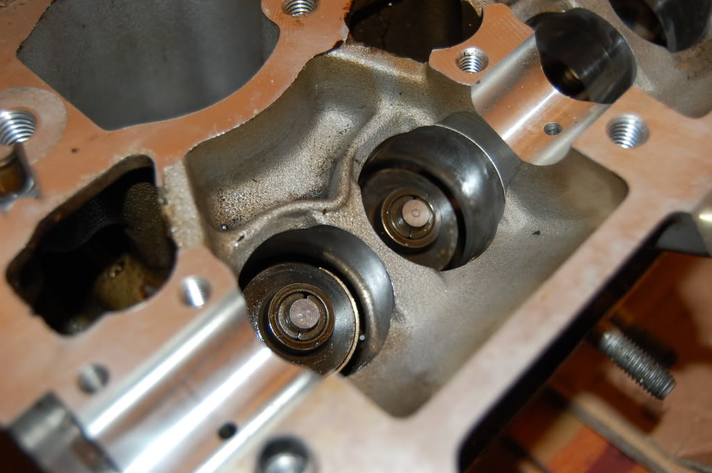

I labelled the valves, so they matched with the valves/springs/collets that I previously took out, so the bits went back into the right place...

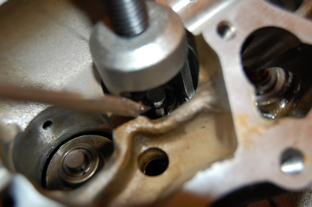

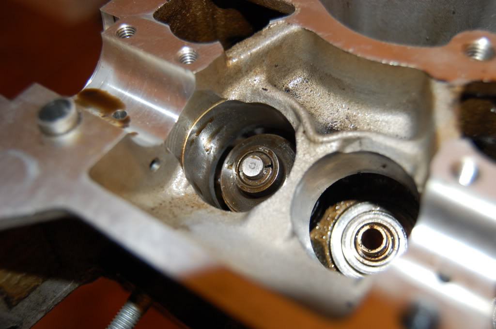

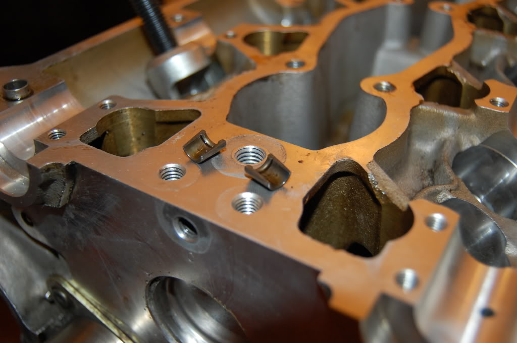

To fit the valve, first put a new stem seal onto the head, then put the valve into place. Then use a valve spring compressor to compress the spring, and put the collets into place, which is the most fiddly job EVER...
The collets have to go down the gap, round the valves stem...nightmare!
Once the collets were in place, slackened off the valve spring compressor...
Continued to do the next valve...

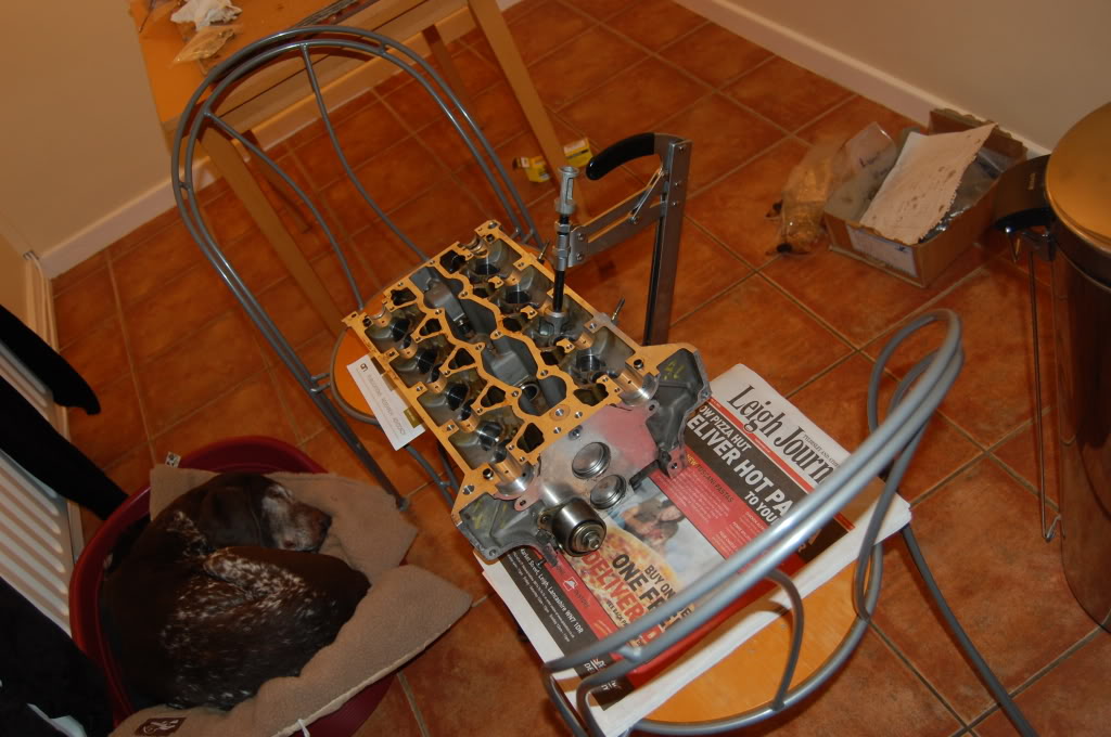

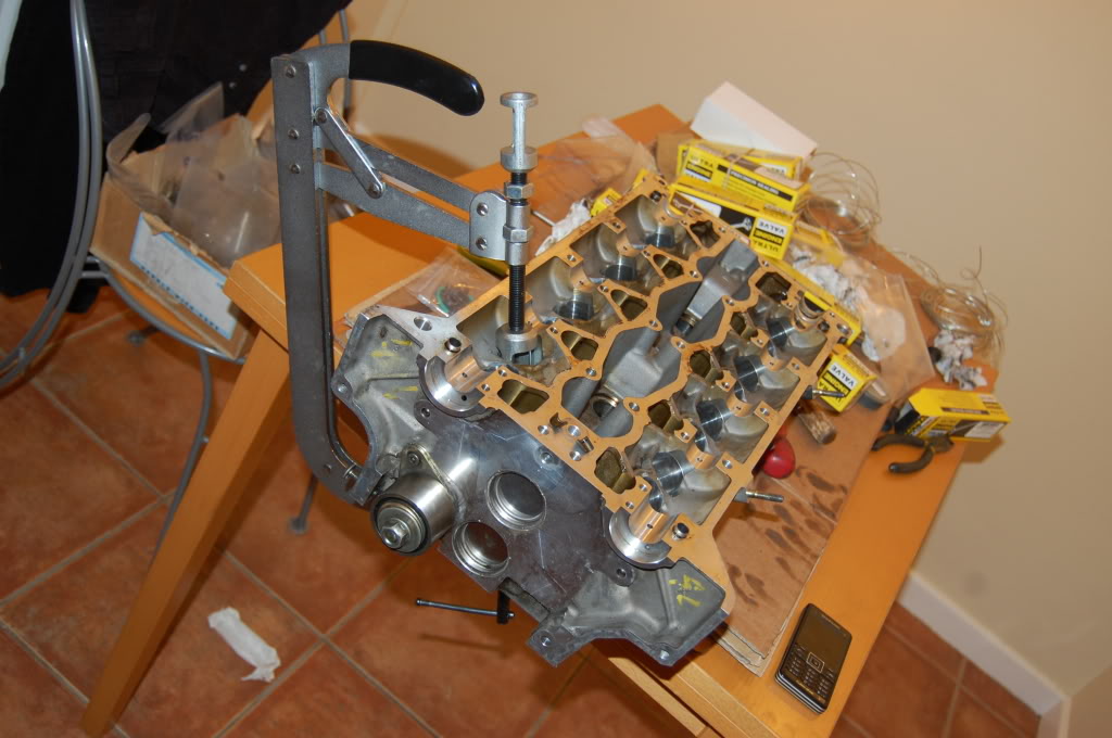

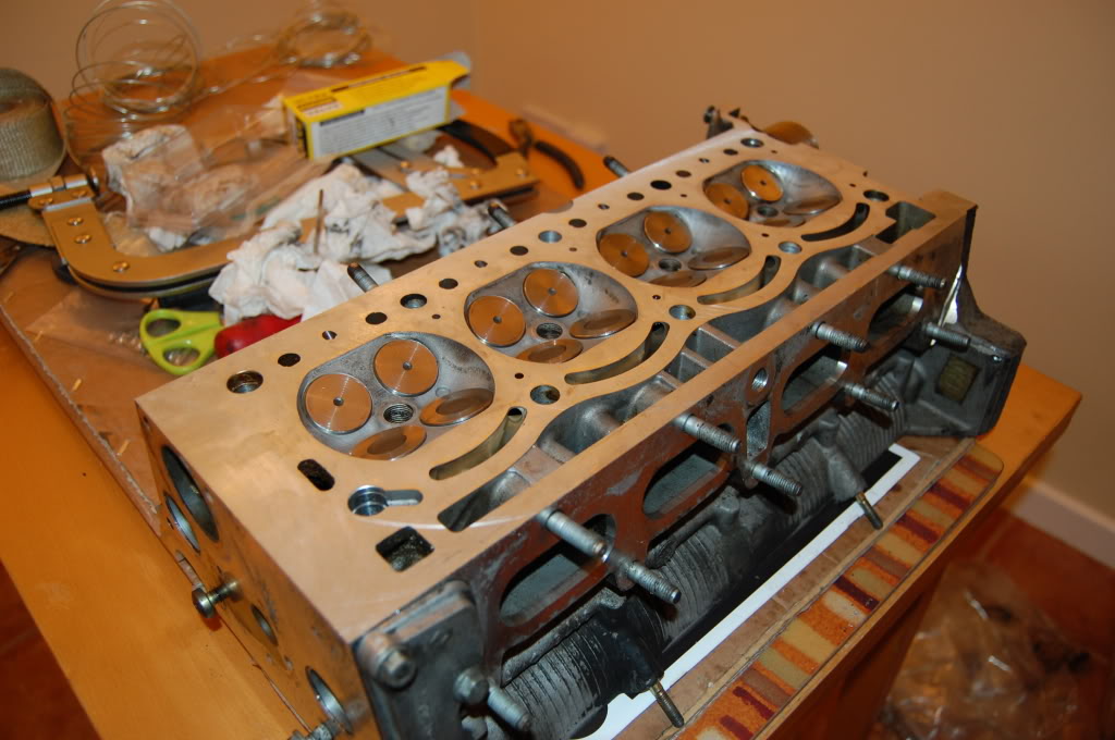

Then made a rig-up workbench in the kitchen as the head was nearly falling off the table when doing the next four valves...
Got 8 valves done, and decided to leave the rest as it was 2am, lol
Will get the other 8 valves done tommorow, fit the cams, thermostat housing and inlet manifold...should be near enough ready to put on the engine by then :)
More soon...

2 chairs for a workbench jord, very rig up. Bet you wish it was an 8 valve engine eh? would make the job easier.

The dog looks interested in what you are doing LOL!!
2am.... rebuilding a head.......... in the kitchen.... FTFW!

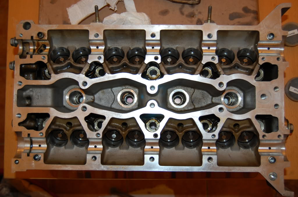

I still had 8 more valves to do, so I did those after doing the exhaust. Went a bit quicker this time, got them all done pretty easily...

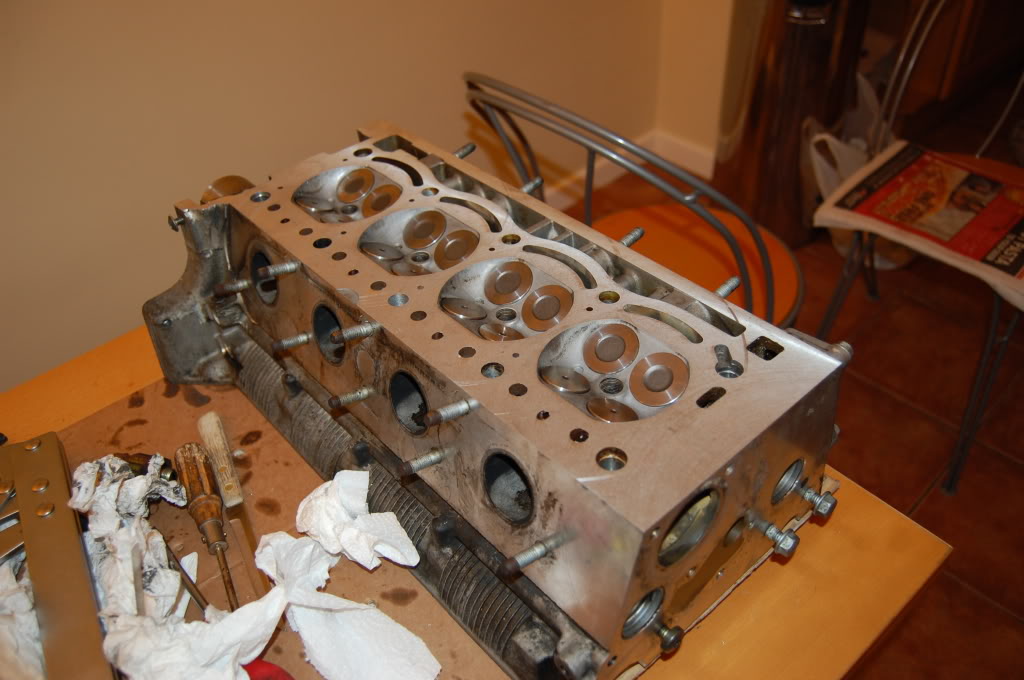

Cleaned up both sides of the head, then cleaned the camshaft carriers too...
Started to fit the cams after that, then had to leave it as I was heading out, so will finish the cams tommorow. Then it just needs the thermostat housing fitting, distributor cap/rotor arm and the pulleys fitting. Hopefully that wont take too long and il get the head onto the engine tommorow afternoon all being well :)

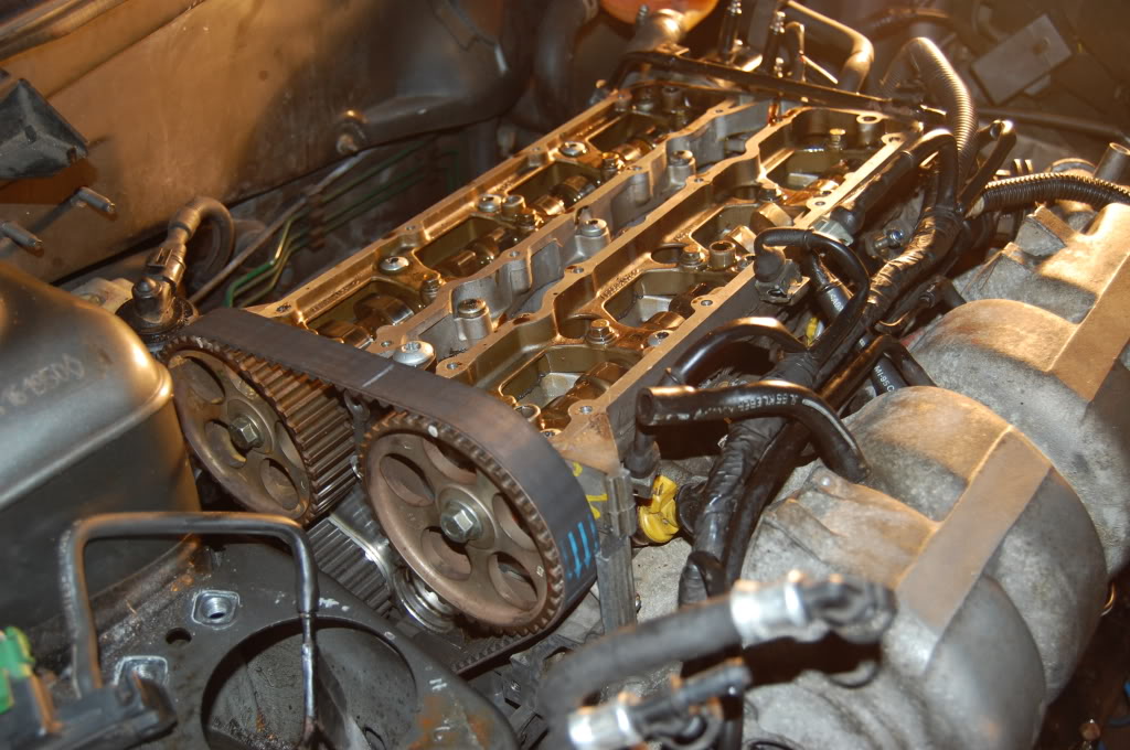

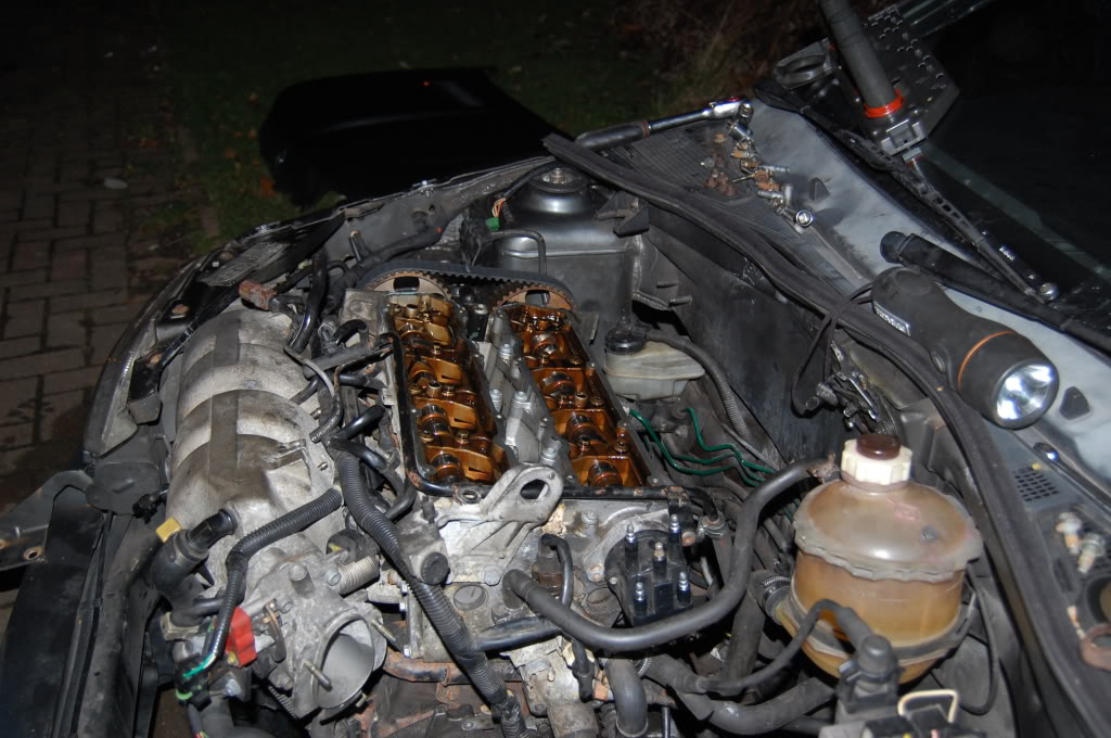

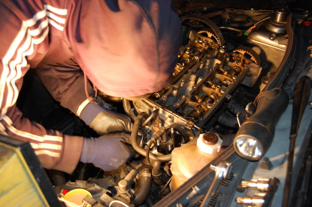

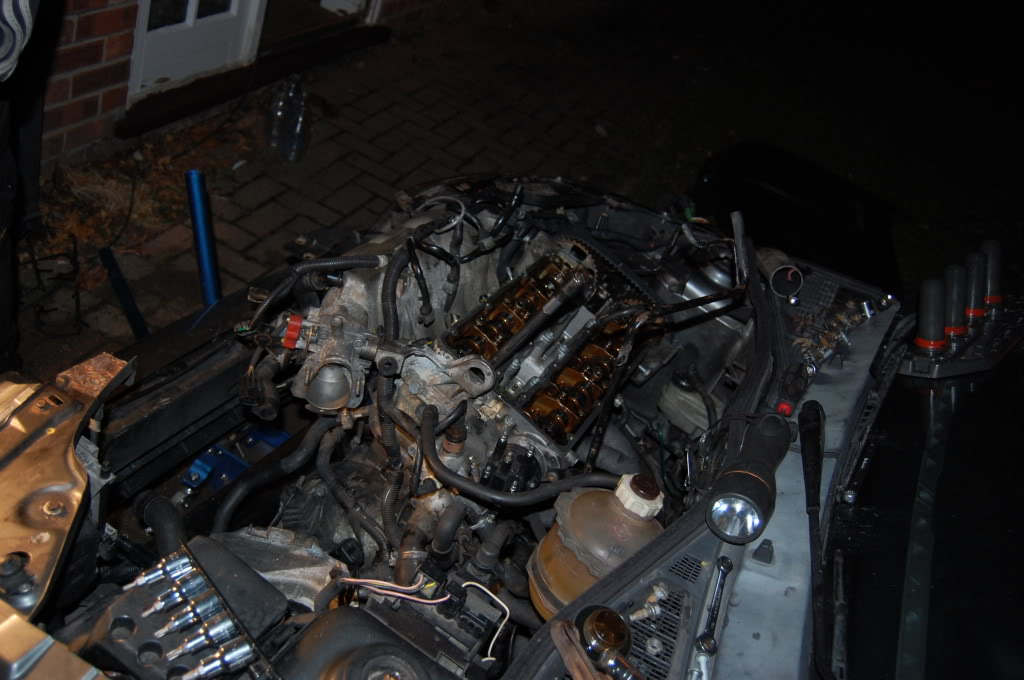

Built up the cylinder head, and went down to Ryans to fit it, 3 people on hand to get the job done quicktime...

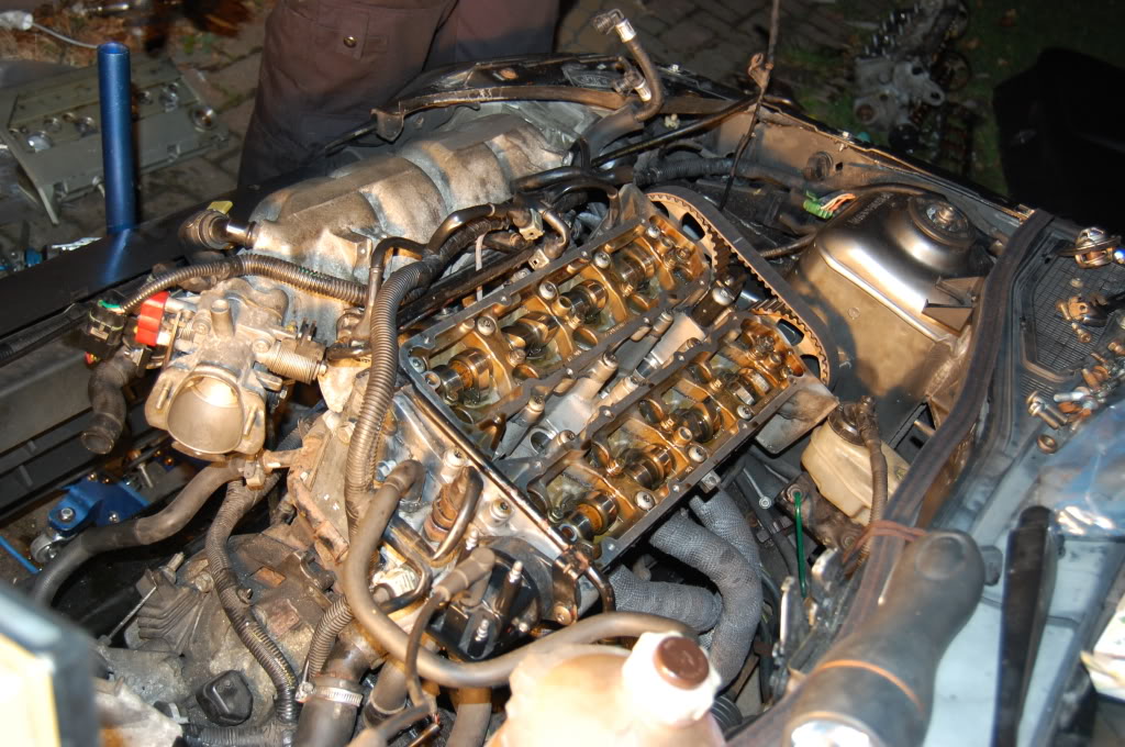

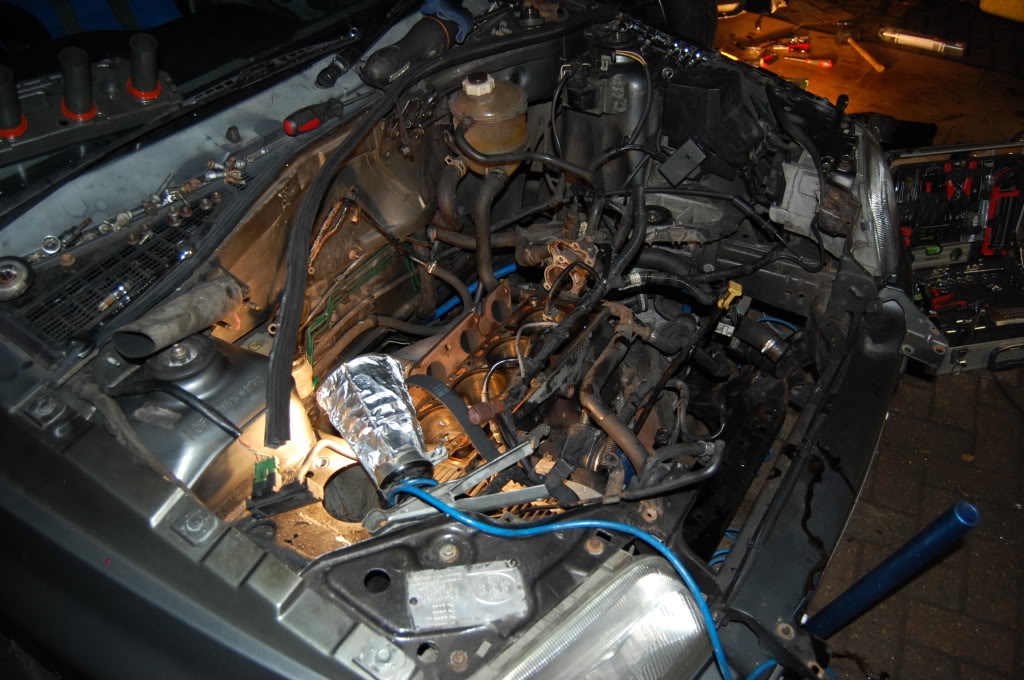

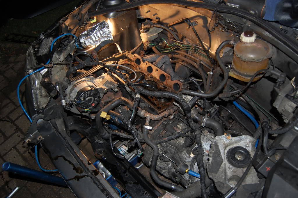

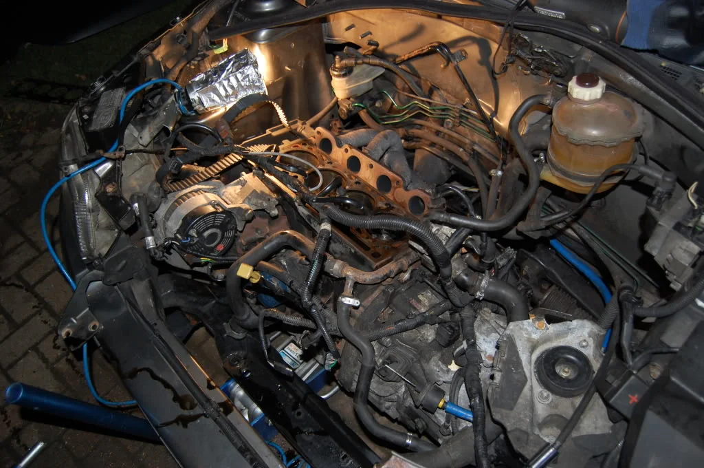

After building up the head, removed the head from the engine in the car....
Next, swapped the inlet manifold from the other head to the fresh williams one, and put it into the car with a new headgasket...
Also fitted a new low temp thermostat, to aid with keeping the engine heat down...Then locked the crank at TDC, and timed the cams in, fitting the cambelt...
Then refitted all the covers, etc. Got everything connected up.....went to start it....nothing! Just did not want to fire...checked for fuel, that was good, spark was ok.....just didnt fire up....
Tried changing the ignition/coilpack order, made no difference, got a bit of spluttering but then nothing....by this time it was 2am, and I had no way of getting home. A call to the RAC got them to show around an hour later, to some guy who seemed to have no idea what he was talking about, and wouldnt tow me home.... Ended up having to stay at Ryans mates...cheers mat!
