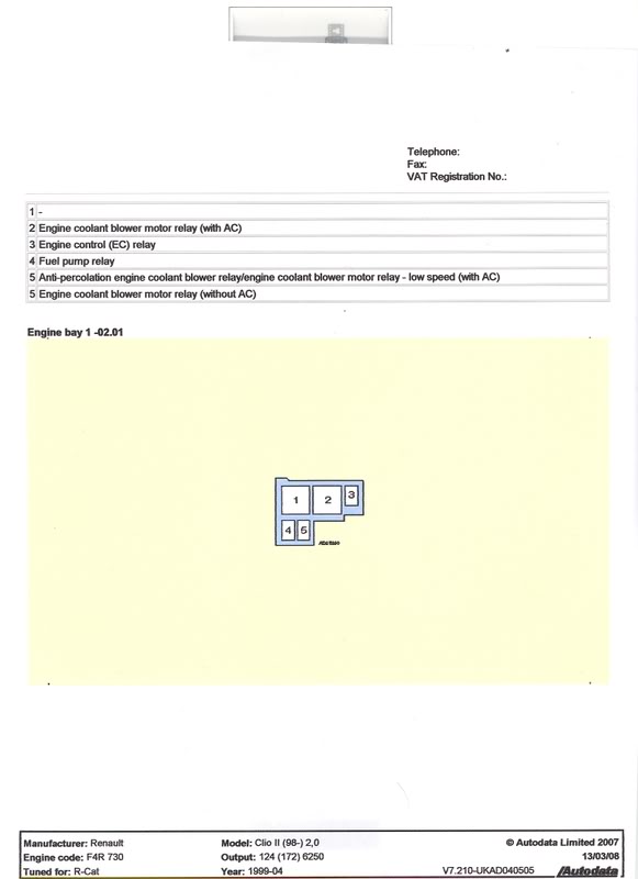

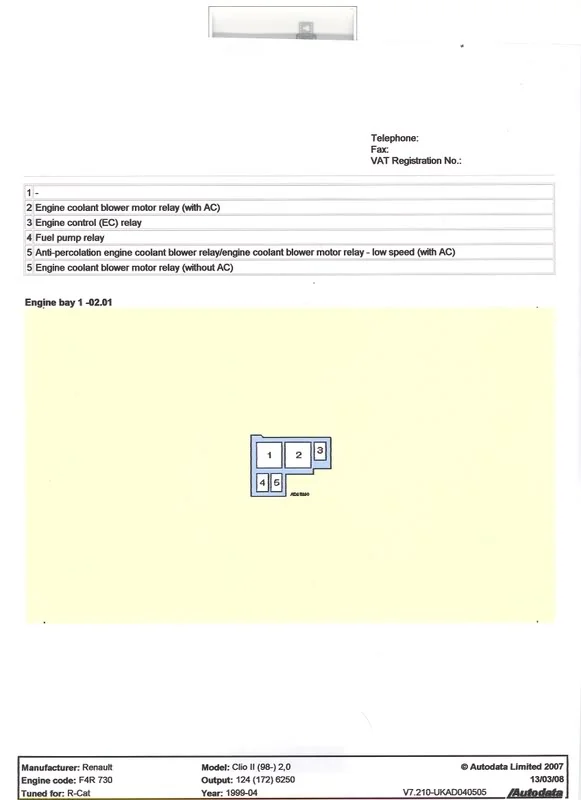

I was just trying to find the diagram of the 172 engine bay relays, as in which is which. I only have 4 present, one yellow one and 3 small black ones...Was going to swap the injector one for a fresh, but cant remember which it is!

ta da :D
althugh there is no injector relay, just ecu control (power)
