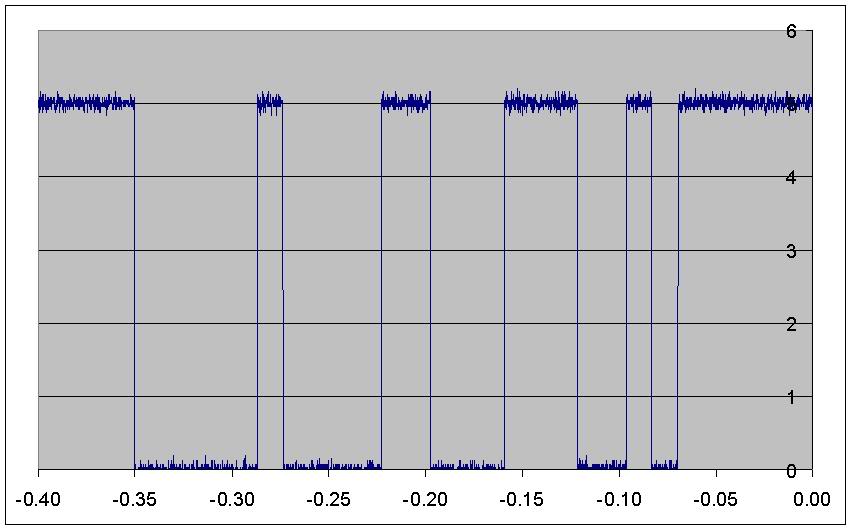

Sort of, has a couple of PIC chips and some other gubbins (im guessing some type of circuit protection). The board isnt even an inch x an inch, its tiny. It just outputs an 'OK' code to the ECU, but the ECU has to be decoded/virginised for it to recognize the 'OK' code that the emulator is outputting...once it does, it will allow the car to start![]()

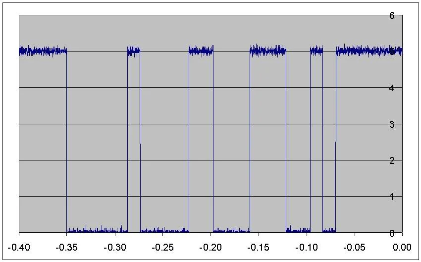

single PIC, 5V supply, and clock. Simple hardware, squirts out a serial data stream. I powered mine up today and captured the data on a scope.
So is it just outputting data or a signal in hz?
hmm, pretty simple then! iirc isnt it the PIC16F84A?
