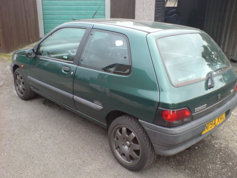

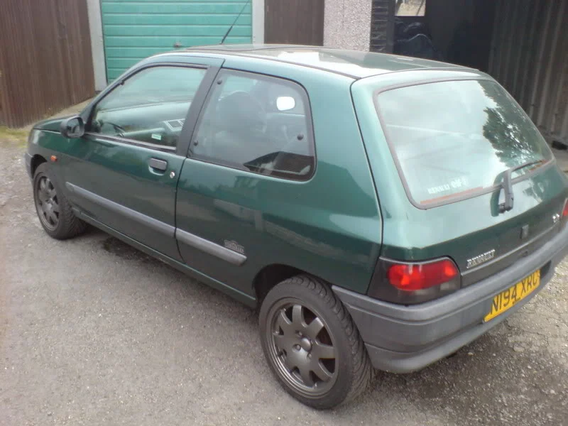

Last year I picked up a 1995 MK1 Clio RT to run me about for 3 months....
52k
FSH
5 months tax
3 months MOT
2 lady owners
not a hint of rust, the car was totally sound mechanically wise aswell (literally like the car was in a time warp!)
I paid £220
She even washed it before I picked it up haha!
anyway, I spent £35 servicing it (oil, filters, coolant and cleaned up all the brakes)
It easily did 300 miles to £30 of fuel
and of course, a natural with the ladies! ;)
Sold it on for £600 CHIIIIING!

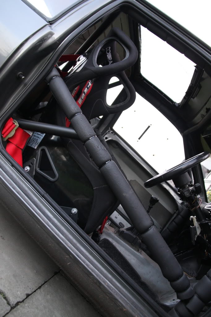

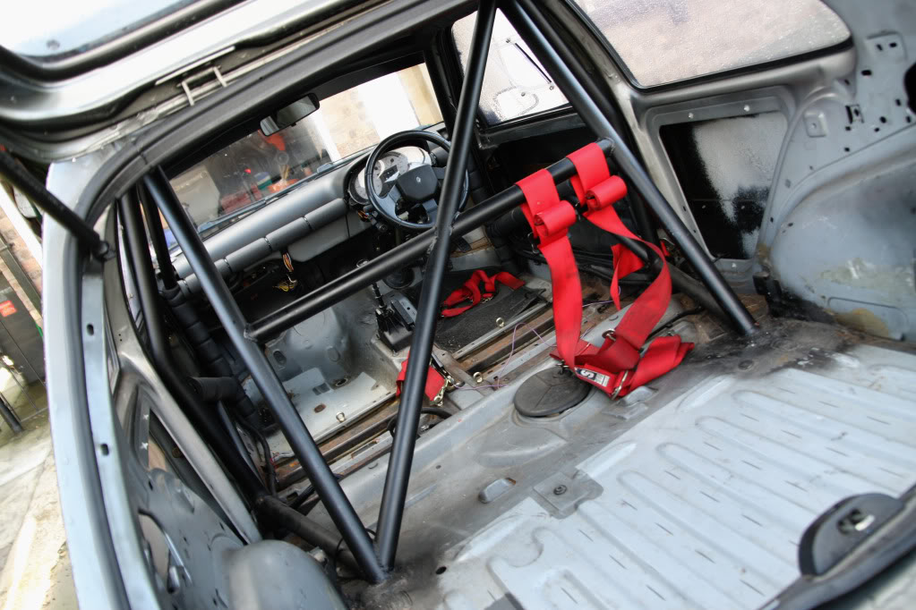

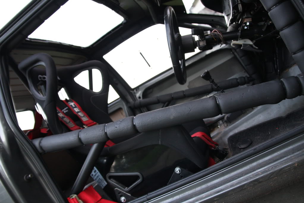

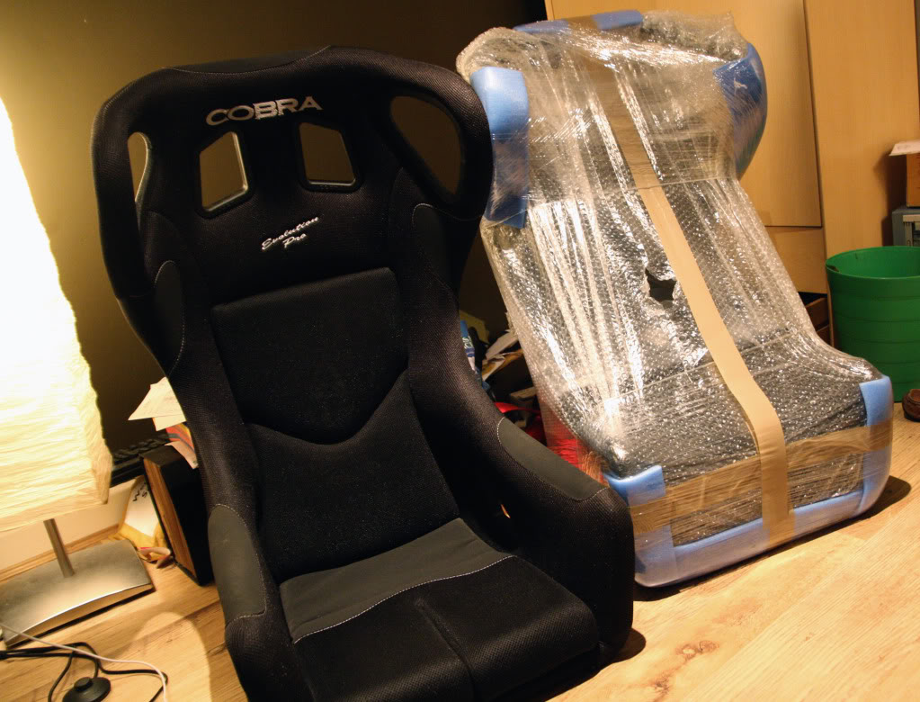

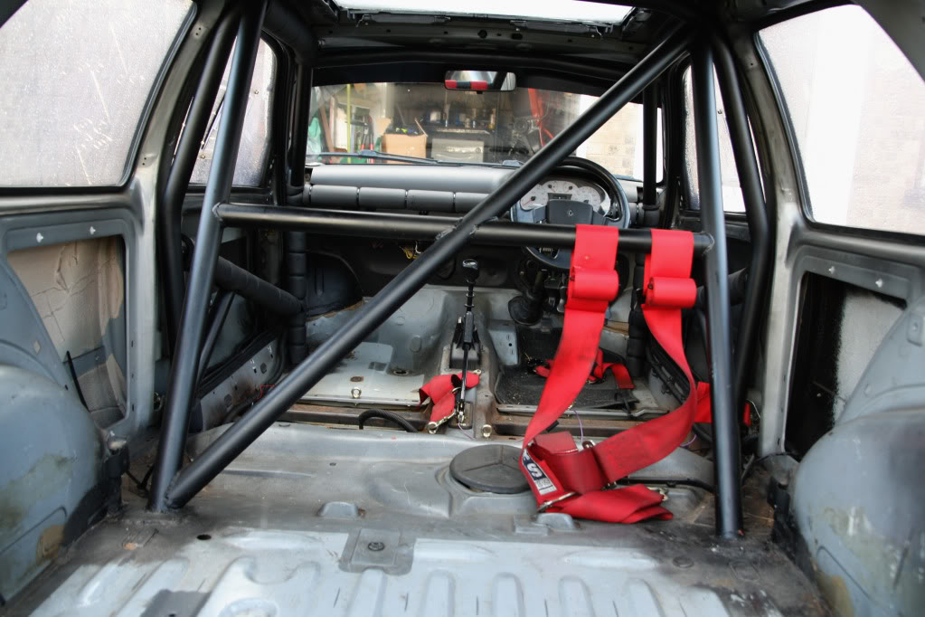

My Sparco Corsa's went to their new home this morning...hope you get some good use out of them Jams!
Anyway, this afternoon headed over to Chris's (480bhp) and picked up the replacements. One of them is still in the wrapping as it came from Tweeks back in May :)

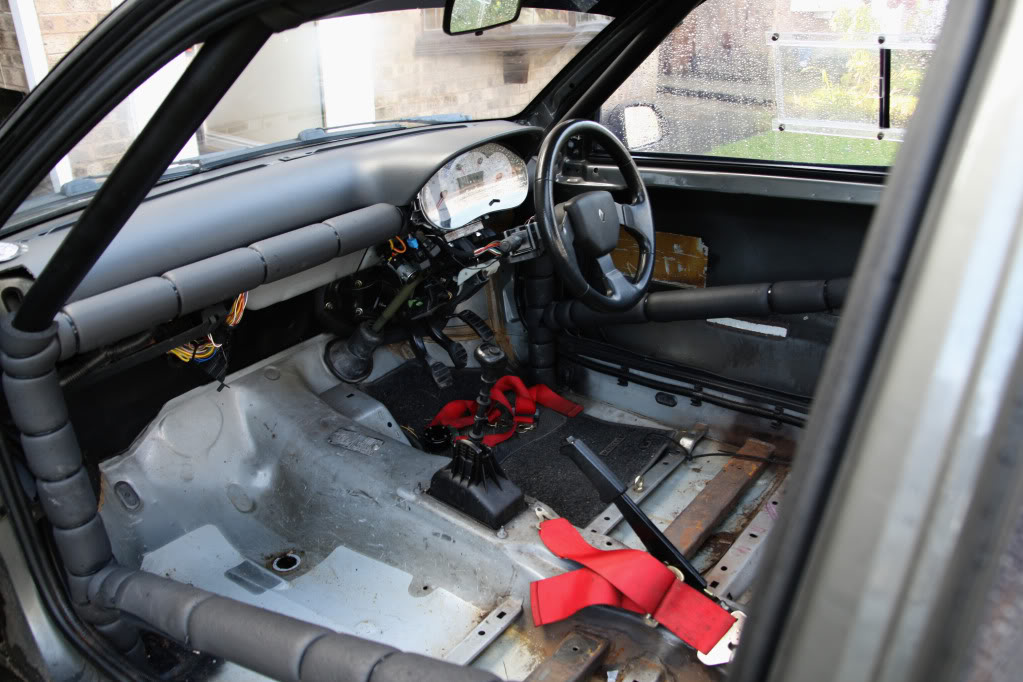

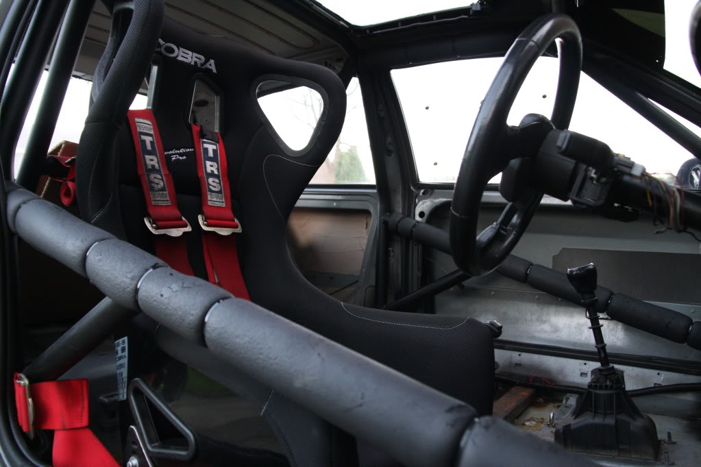

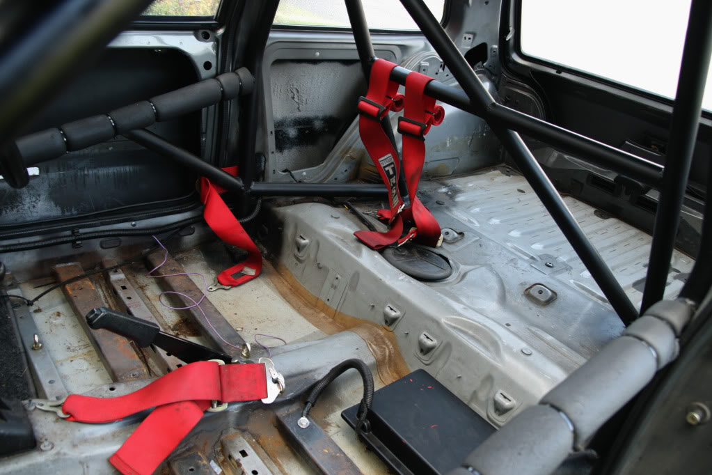

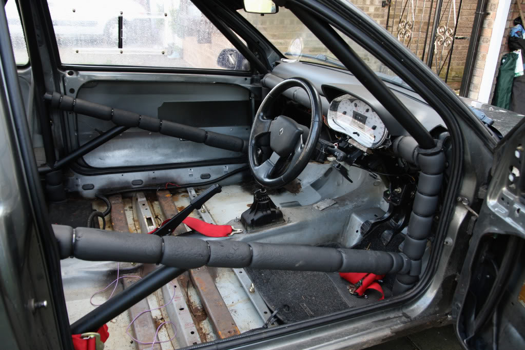

Also just thought id throw up a few pictures of the car as it is, interior wise. Quite a state after this years usage...
Basically as soon as its off the road, the first job is going to be quite a bit of welding. Just going to get the engine out, all the panels off along with the doors and tailgate.
Then will pop the windscreen out, and get screen gussets welded in. The car has developed an annoying creak (rollcage and chassis) at certain times, hopefully this will improve it.
Going to cut the seat mounting/bars out of the floor, and re-do all four again. Want them slightly further forward, and want spend some more time getting them properly level. The passenger seat leaning slightly one way has p*ssed me off this year!
Also going to remove the lower door bars (short ones), and make the door bars into a proper full 'X' with some new tube. Will probably put gussets on those too in the middle to make it look a bit cleaner. The door bars will come upto the same 'joint' as the bulkhead bar hopefully.
The last job with regards to the rollcage will possibly be running it through to the front struts. Im going to have a proper look at it but going through onto the strut and then triangulating down to the floor of the cage should not be hard really.
Last bits of welding will be patching up some of the holes on the floor where there are usually grommets (particually the front footwells) and any other bits I can find that need doing. Hopefully after this the car will not need to be touched with a welder for a while, and should be how I want it!
With the car then being a bare shell, il be properly painting the interior. More on that when I get to it.
More soon!

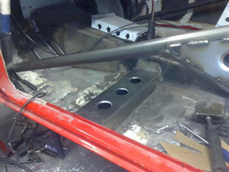

I made up some new seat crossmembers for my escort one evening this week......
And you can see the cage 'gusset' for my lower door bar...,i was going to have 'X' door bars but after cutting the tubes and tacking them, my 6'6 22 stone frame didnt fit through the hole that was left, so re-designed them lol.
And note to self.....,dont weld in your door bars before you have finished all the welding to the floor pan etc, makes it a right git!!

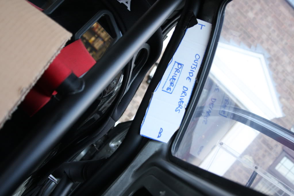

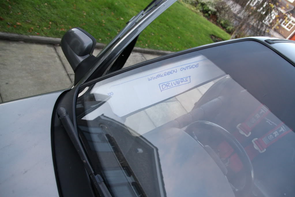

Re: Mk1 172 Hybrid Track Car Project

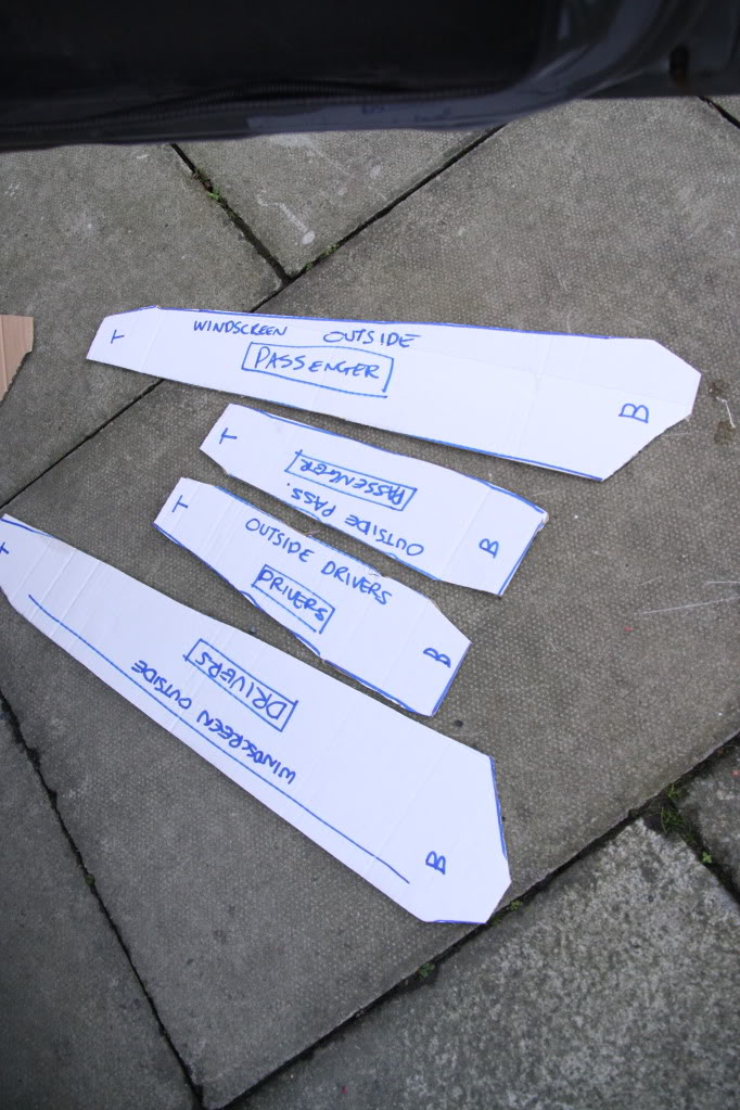

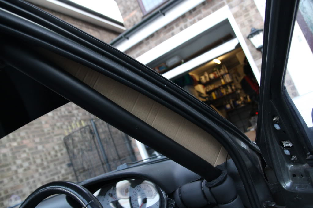

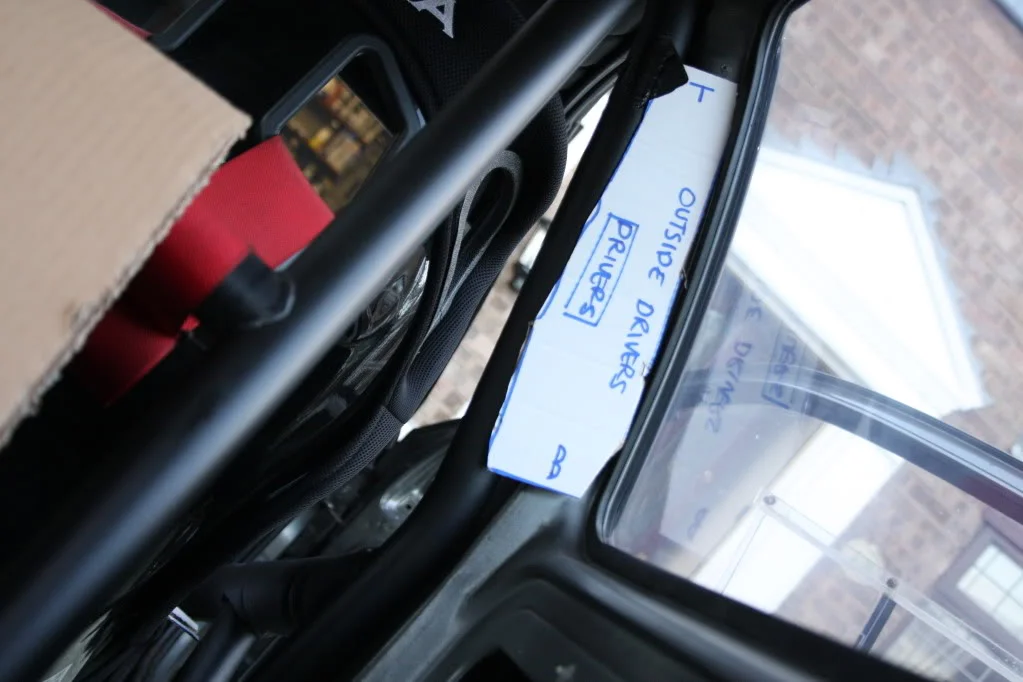

Ah cool. A member of another forum that I'm on has offered to make me up the gussets for the doors/screen/main hoop for a lot less than Custom Cages charge (£25+VAT Per Pair!), so ive been making templates for him today...saves me messing round and having to buy the swaging tools I guess too!
Will be putting triangular ones on the door bars too as mentioned, but these come as a set size from him and just need cutting to shape :)
