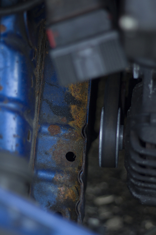

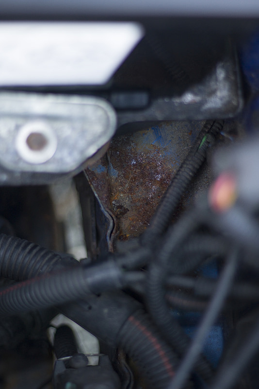

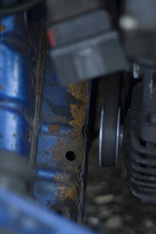

Here's a couple of pictures of the rust, which I now realise, you cannot Photograph without it looking tremendously bad. Honestly it's nothing major, just surface rust, however it needs tackling. If anyone has any tips on steps to take, please fire away. For the time being I'll be sanding/wire brushing back the area more than likely, and I believe there is a 'Karust' treatment to use? I'm probably jumping steps, or stating the product wrong, but it won't be attempted before finding a working method, not simply sanding and respraying.
Top Photo is near the ECU, and the lower Photo is just right of the Battery tray. These are the only two main infected parts on a 20 year old VTS, remarkable!

Yeah wire wheel and sand then like you said treat it with krust from Halfords (is available at other stores)
Then mask up and paint again, should see it good for a while
