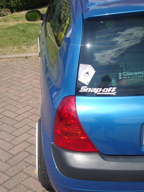

Putting PH1 rears on a PH2 is as easy as unplugging one and plugging the other ones in.
Look at @dann2707 thread, he's recently fitted PH1 rear lights to his PH2.

No it's not. You need to rearrange some wires in the connector. There's a guide somewhere.

Thanks, leeds2592, I definitely dig the look (from @dann2707 thread): http://i53.photobucket.com/albums/g62/dann2707/20160114_081344_HDR_zpspevjhwfw.jpg

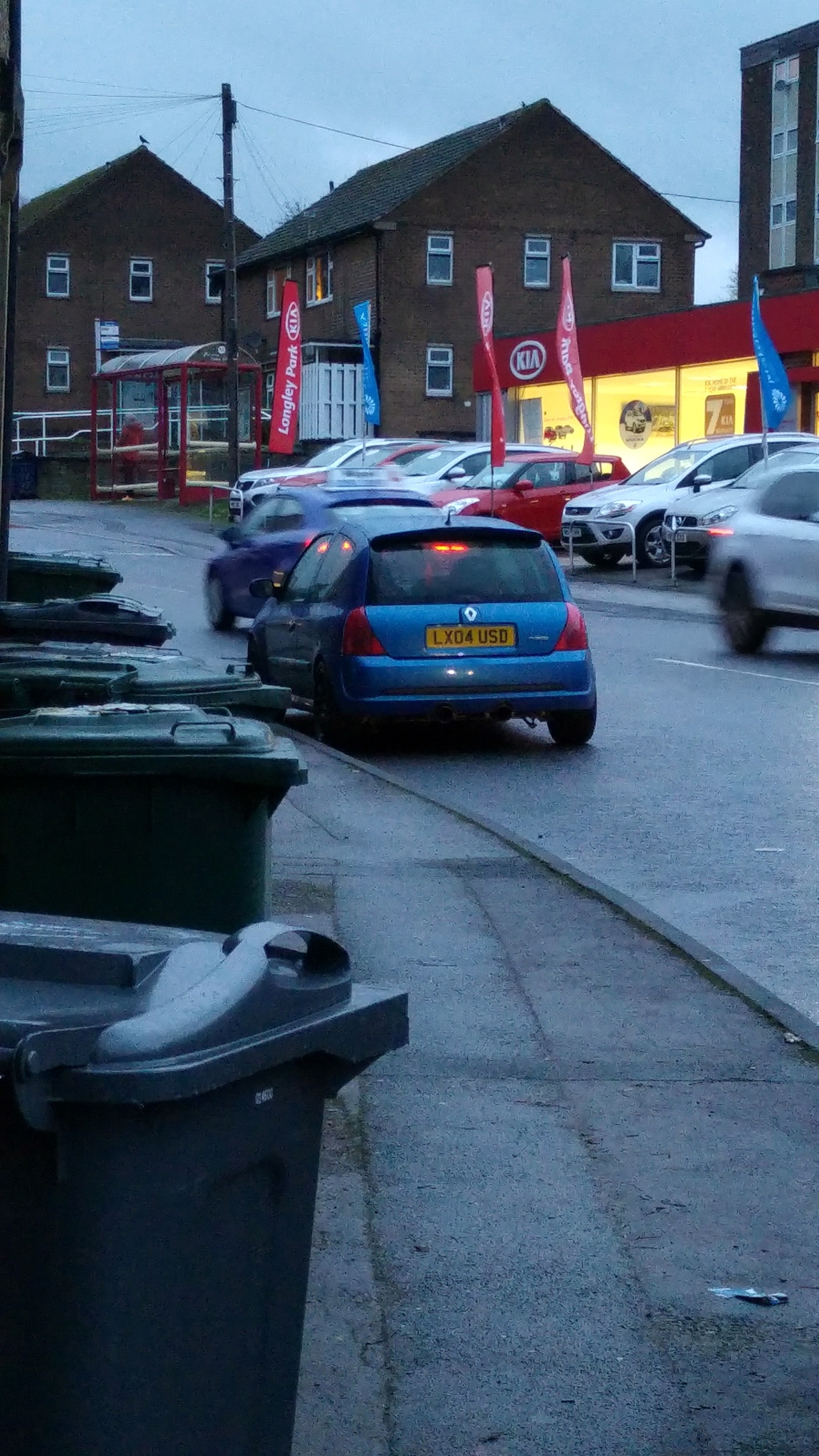

I can no longer edit my previous post, but I like this as well. So I might try spraying them red or applying a red film. If it doesn't work I'll get some ph1 ones. Looks just as good as ph1 ones if not better, I just love all-red tail lights, they look so clean.

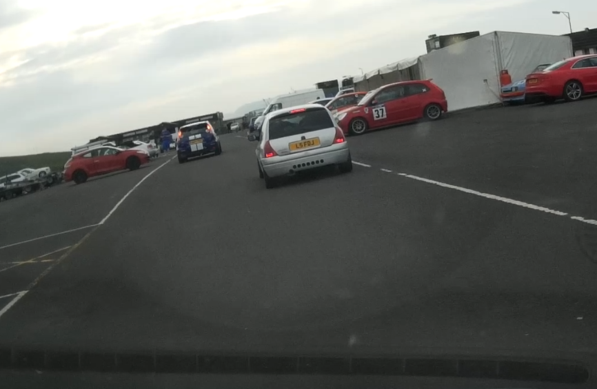

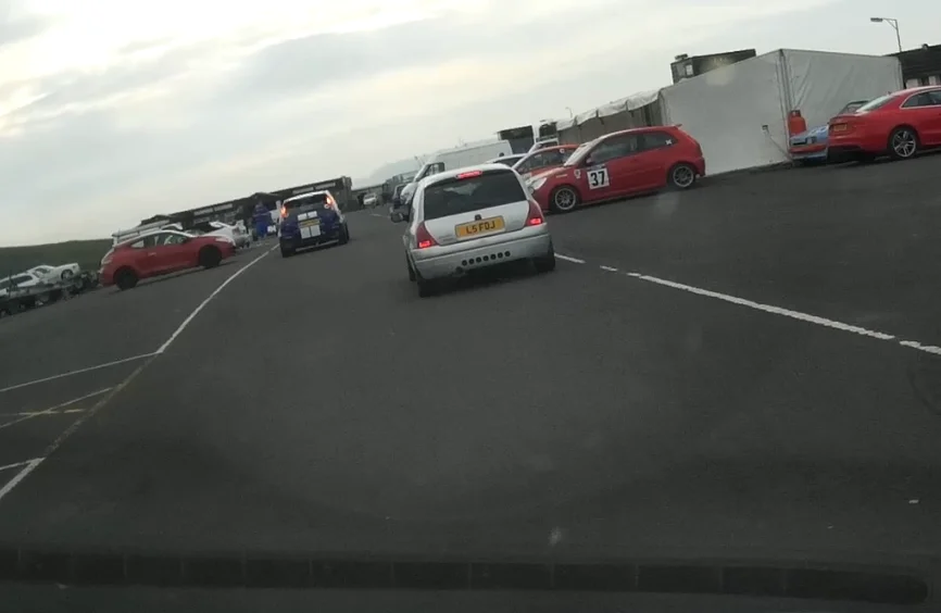

They don't fit do they? Why does it look different out of interest?
Nah, you need to cut away a couple of the clips on the back to get them to fit lol.
Ph1 lights have the sidelights at the top and fog light at the bottom of the cluster, but ph2 are the other way about. I think it looks much better when the lights are on with the sidelights at the bottom!

That's great to know, thanks a lot for that mate! In the middle of swapping mine over you see, don't suppose you have a pic of them illuminated?
