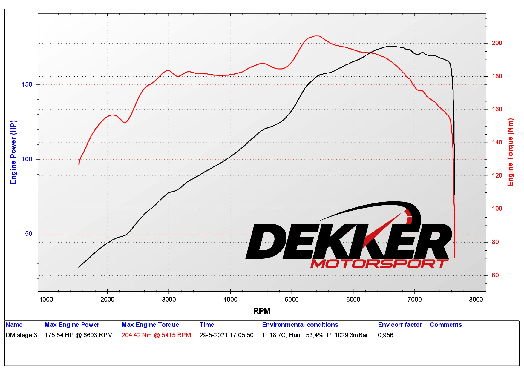

Hi,
I got my 182 all "tunned" up with 197cams+injectors, milltek resonated catback, ported inlets and green filter.
Cam swap and tunning has been done by Dekker Motorsport.
It made 175.5 Whp and 204.4Nm(150.7ftlbs)
Can someone with more knowledge tell if this result is to be expected( I was hoping for bigger numbers :))
Or some with the same kind of mods to compare dynographs?!

Sounds pretty honest to me. Most 1*2s are in and around the 160 to 180bhp mark depending on engine health. So if yours was 165bhp then the mods ending up at 175bhp is about right. By the way, that’s 175 bhp at the fly, not at the wheels.

How would i truly determine my engine health? compression is between 185-187psi on the 4 cilinders, which i believe is average.

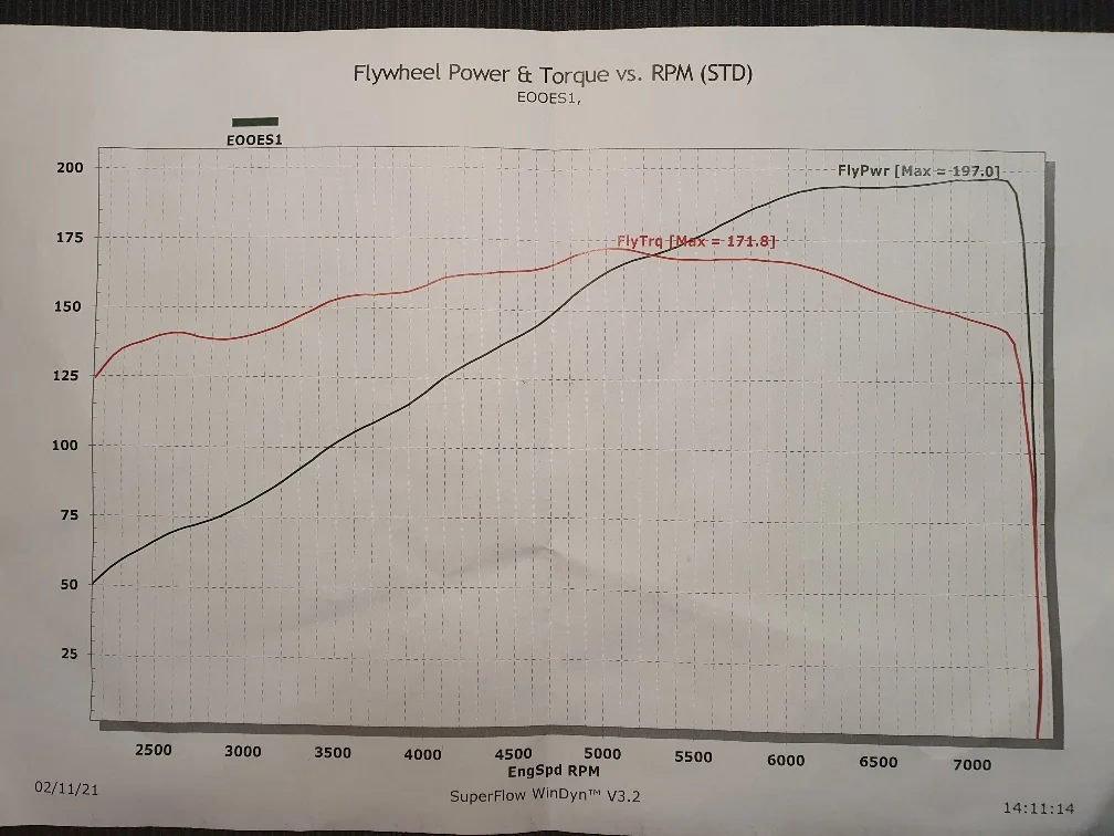

There’s something wrong with the graph, power and torque should cross at 5252

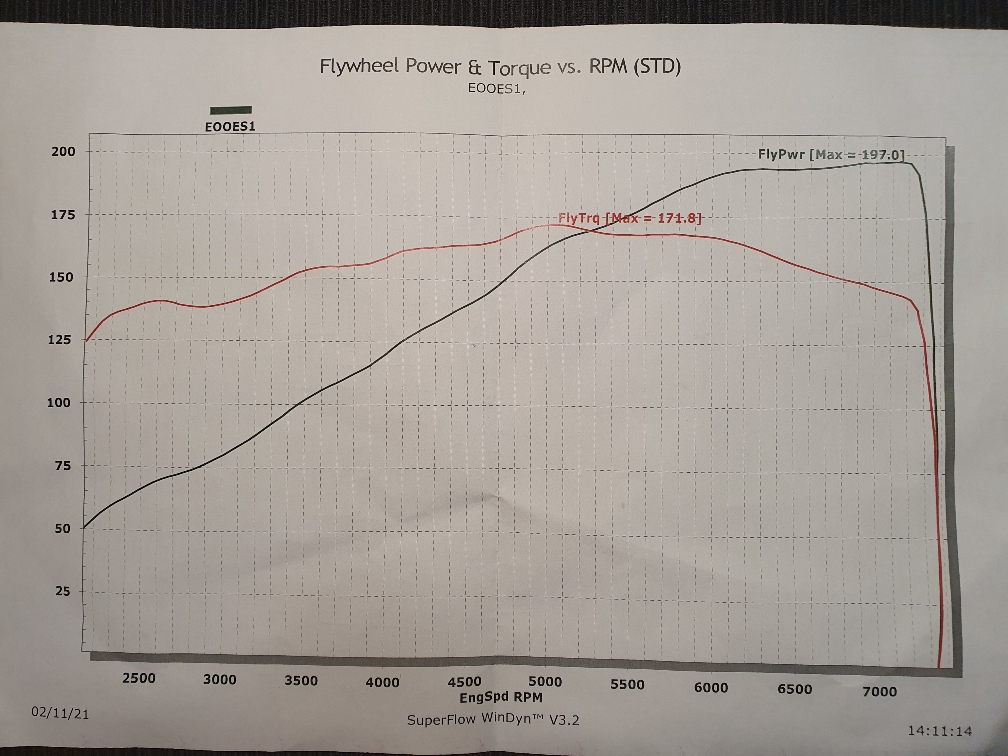

Mine made 197hp and 171.8ftlbs mapped by Efi parts
197 cams
Decat
Matched inlets
Ktec induction
197 injectors
Epas

Ahhh missed the different scales -
On the same scale it’s because of the formula to work bhp from torque
Indeed,
(Torque*RPM)/5252 it's mostly Dyno dynamics which default to the same scale. Other dynos calculate bhp a bit differently (from watts) which makes more sense on some dynos.
