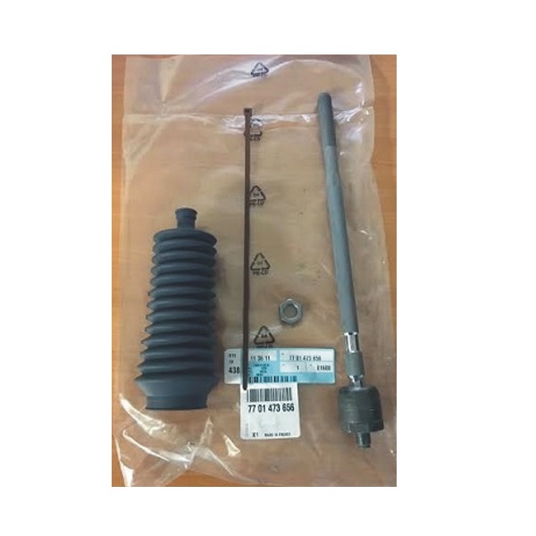

If you are going to order a pair of rear shocks ( always fit as a pair ) from Wolverhampton, you may as well order the inner tie rod & track rod end at the same time.

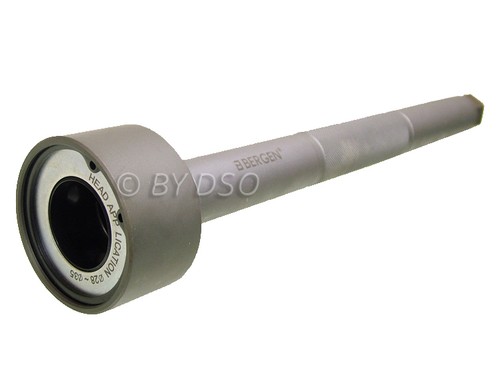

You will need a tool to change the inner tie rod though.
https://www.ebay.co.uk/itm/Universa...m=172837707274&_trksid=p2045573.c100505.m3226
And the patience of a saint to get the new rubber boot back on the rack, especially on the driver's side.

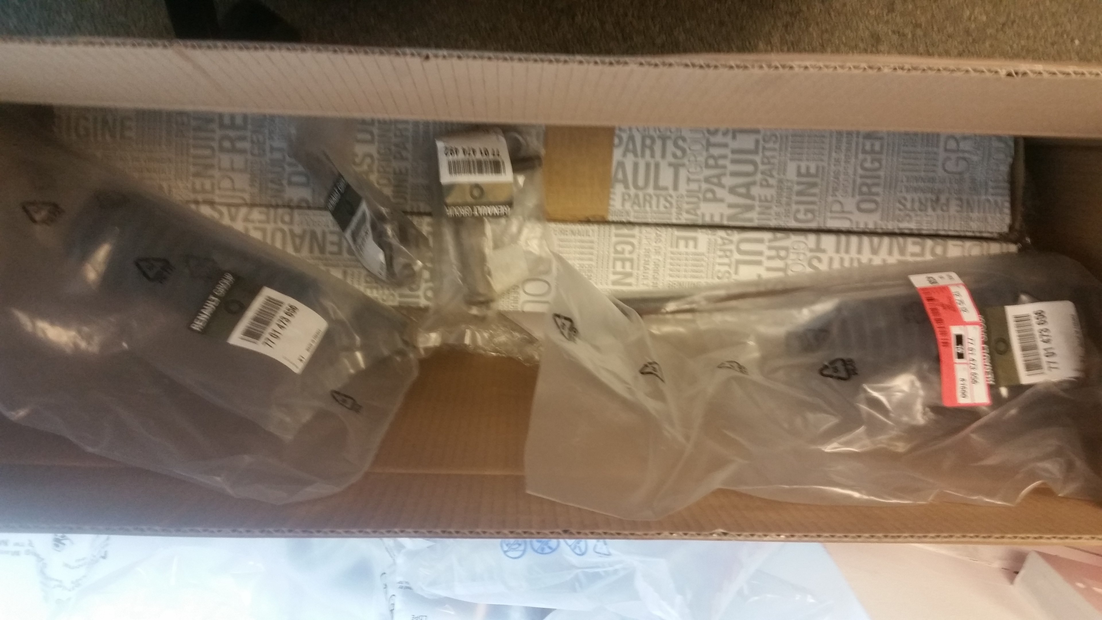

Got to love the guys @renaultpartsdirect - delivered in under 24 hours (22 to be precise) and at a great price too :up:. May put up some pics of fitting up on Saturday but will probs be to cold to faff about with the camera

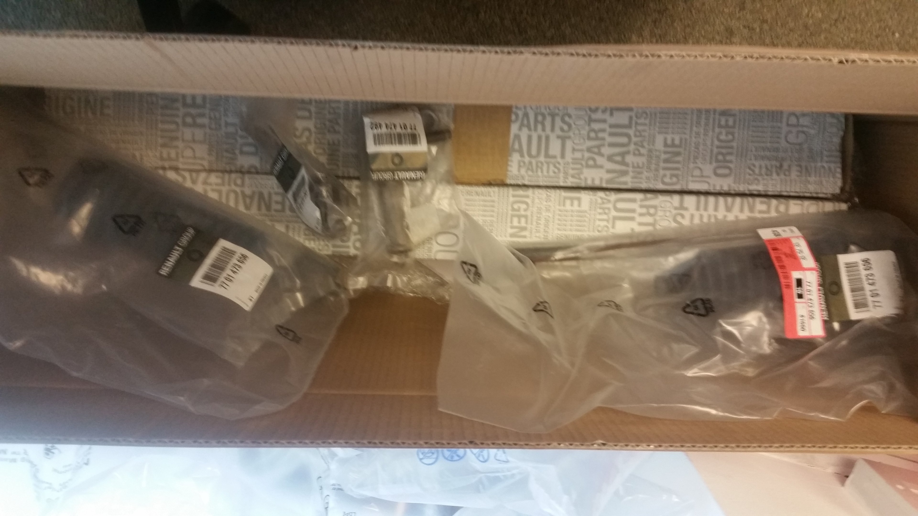

The tie rod tool was bloody useless, think it may have been slightly to big, ended up using a pip wench on the passenger side. Drivers side there was no room so just aborted as that was only an advisory. Still car feels tons better, with new shocks and just the one side with the refreshed tie rod and TRE. Cheers again for the help :up:
The tie rod tool was bloody useless, think it may have been slightly to big, ended up using a pip wench on the passenger side. Drivers side there was no room so just aborted/QUOTE]
??? Did you use a long extension, so that the ratchet was clear of the subframe etc in the wheel arch?
