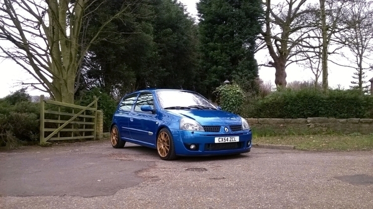

I made the trip up to Clioturbo today to collect my car after the engine build and box fitted.
Its had a lot of work done so it needs running in for 500 miles then im taking it for an oil change and health check to Clioturbo and then through to efi parts for final mapping.
Its nice to have the car back but obviously because it hasn't been mapped its not running 100% and the rev limit is at 4.5k with low boost only to prevent damage, although I wouldn't even take it anywhere near that until its had its final mapping session.
Hopefully I have more luck this time and im looking forward to giving the car a clean, just to get it looking something like.
