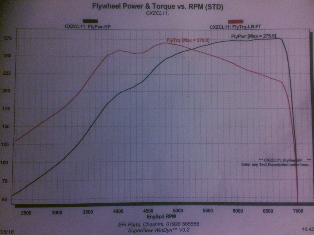

So today i fitted a new ramair cone filter along with an oil/filter change, then i headed over to EFI parts for a health check.
Im glad i did because scoff noticed that the car was running a little lean(although not too bad) at the top end, so he lowered the boost a little to make it much more safe.
The car now makes 275hp and 270ftlb, so i have lost 10hp and gained 14ftlb from the last map, but safety first.
He told me that the engine and turbo wanted more, but the fuel pump might need upgrading to make it safe.
I dont think theres any point tho as the meg injectors wont do much more than 280hp safely and the meg pistons too, basically its injectors, fuel pump and pistons/rods away from 320+hp.
The car is still up for sale on here only, im not bothered if it sells or it doesnt, the car is still my daily and it will be maintained 100%
Graph to follow.
