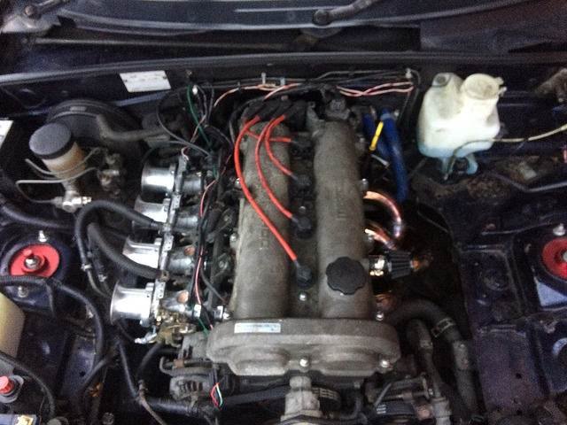

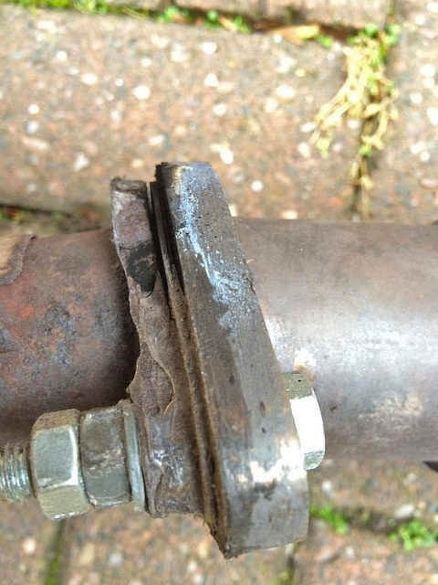

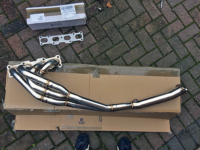

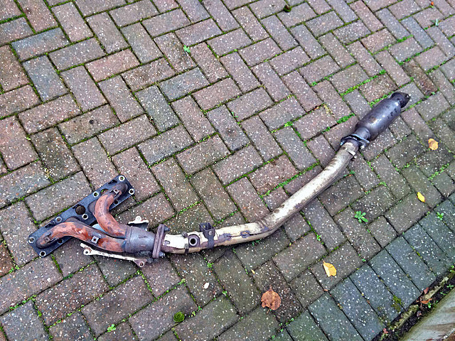

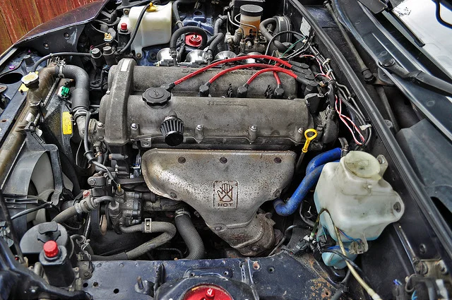

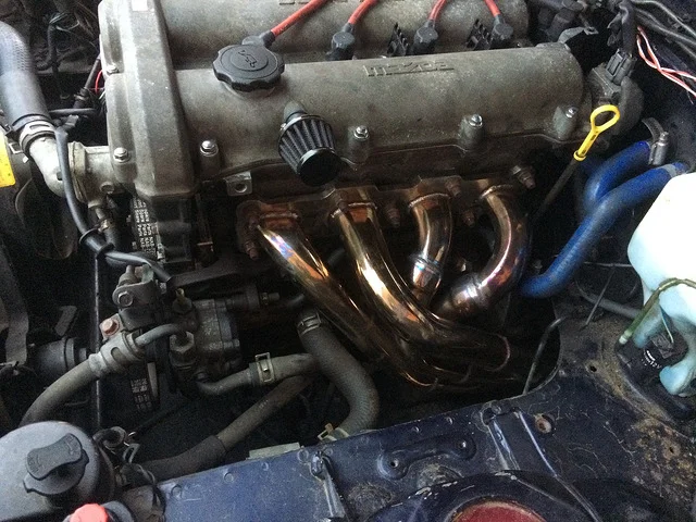

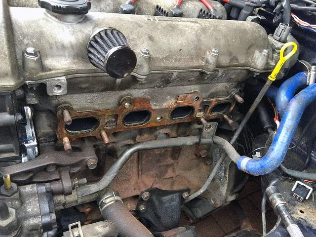

I got a bit desperate and went to MX5 parts for a manifold. Not the best made thing in the world, but it meant that I could get it all sorted and then just forget about it. It also means I have a full I.L. Motorsports exhaust from the head back. Nice. I think...
I bet you can imagine how that sounded! Lame.

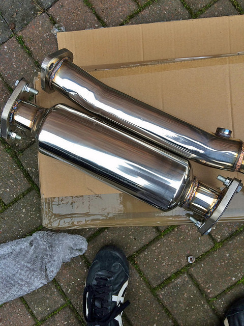

So onto the new one, it's meant for a UK car, which meant I had the wrong size cat, fortunately MX5Parts stock both lengths, so I've got a 440mm decat instead of my old 370mm.
Excuse the phone pics. No videos yet, I've had no real chance to drive it!

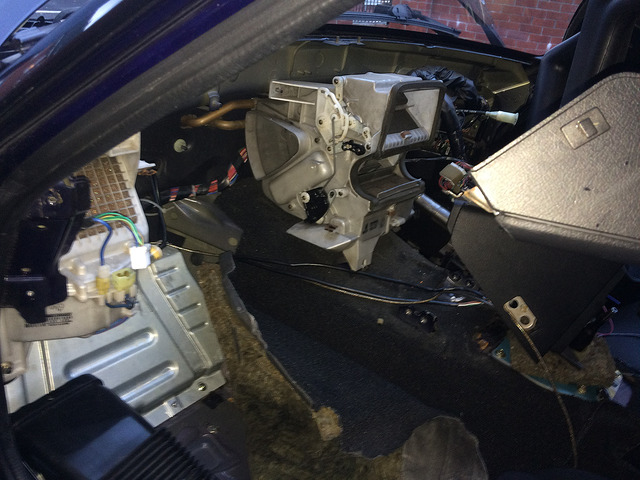

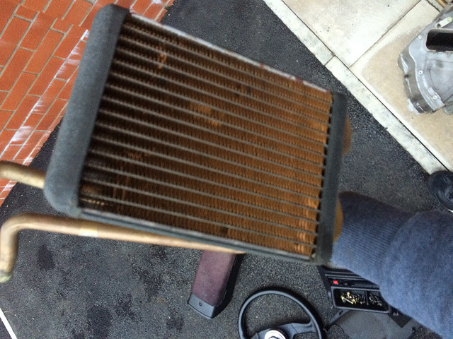

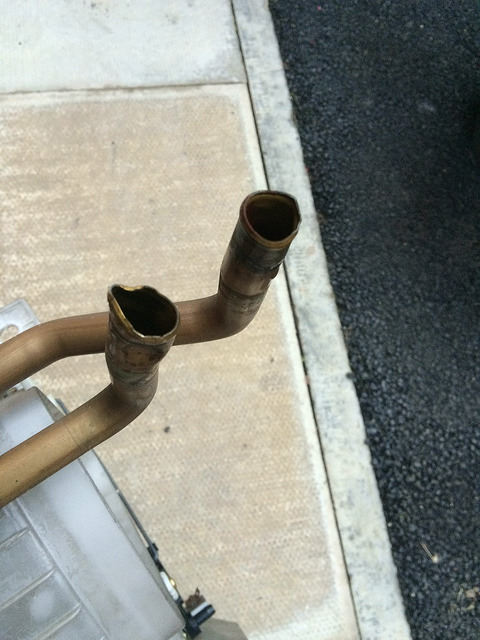

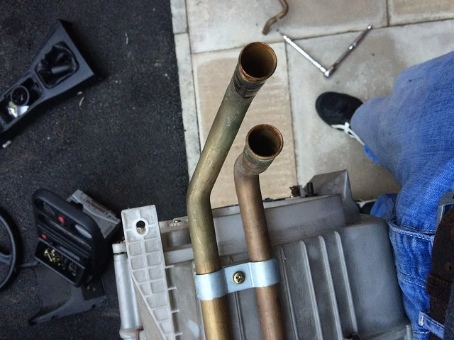

And onto the next issue. Ever since swapping the engine, I've had a mysterious coolant leak. Mysterious because coolant was escaping, but I had no idea where from - no puddles, nothing.

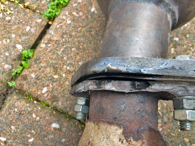

Some light was shed on the situation when changing the exhaust; the passenger side carpet was piss wet through. Fortunately, the ECU is still okay, but it was very wet!

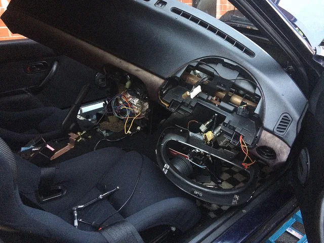

I traced the water back to the heater pipes, horrible things. So today I set about replacing them - what a pain!
Dash out.
There's your problem! Fucked.
Checked the heater core and popped the new pipes on.
Put it all back together and forgot to plug the HVAC lighting in! Doh!
All seems fine anyway, I'll have to take it for a drive and keep my eye on it, fingers crossed that'll be the end of that!

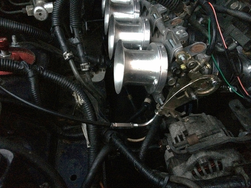

Another small little update, managed to sort the throttle cable out. I think I need a spring on the other side of the throttle pulley, that way I can have the cable properly taught. It does feel much better now though.

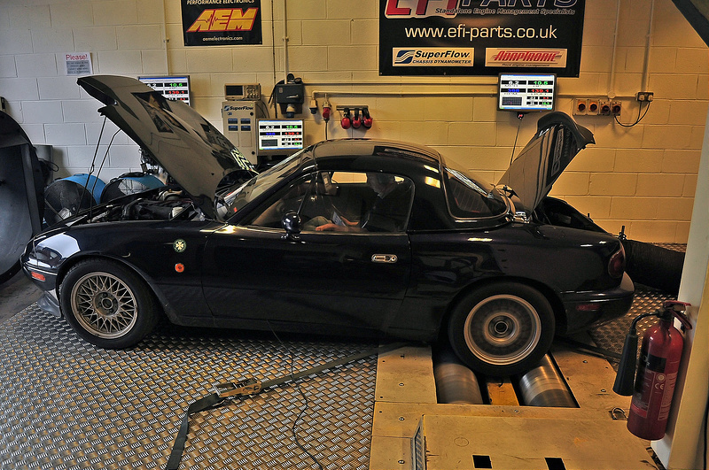

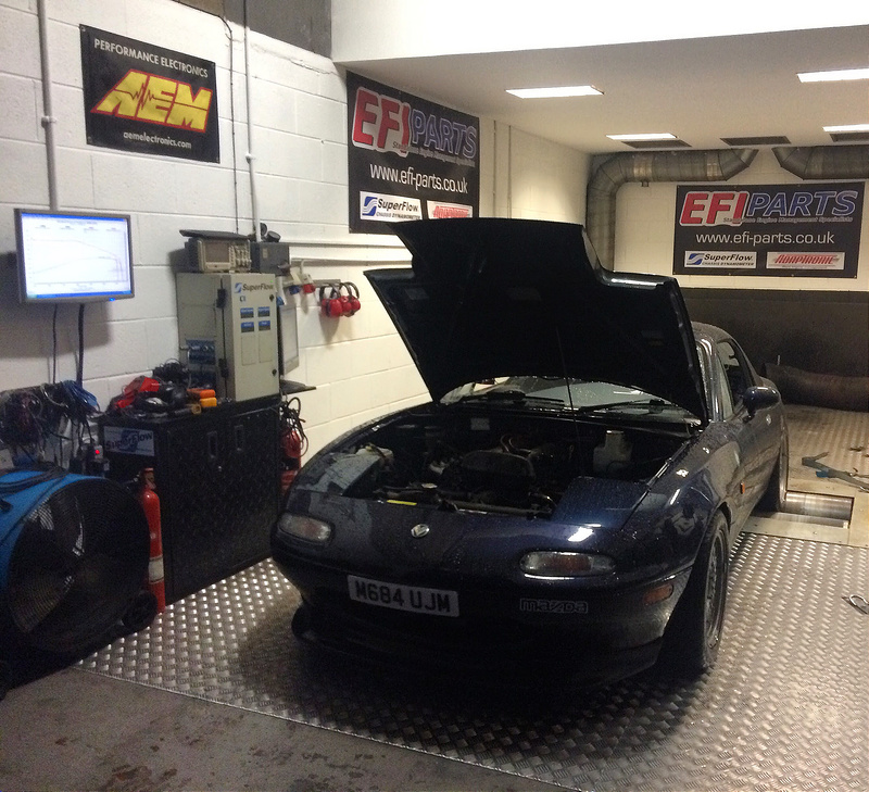

What a day!
Traffic on the way to EFi was horrendous thanks to countless roadworks (actually it was a lane closure due to gardening. Mental.) So I was a little bit late, but nevertheless Chris did an absolutely fantastic job; my map was not the best, ignition timing was frankly silly, and the fuel table needed a load of smoothing out. Initially, it wanted a load of fuel taking out, but I'll get to that later...

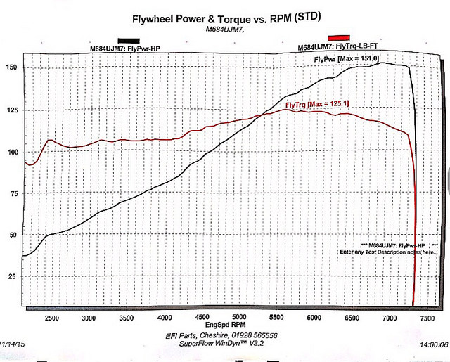

Made 151hp at 6,800rpm and 125lb-ft at 5,600rpm. More than happy with those figures! Looking at the graph it's making power high up the rev range, so I'm fairly confident I did a decent job with the exhintake cam. And it seems to love revs which is what I've been trying to achieve all along!
So that was that... until I was about 20 minutes down the road thinking "this feels a bit flat" - took a glance at the AFR gauge and it was 17.9AFR at pretty much any rev/throttle opening. Not ideal! Span round and back to Chris, we were both a little puzzled until I remembered something similar had happened in the past. An odd error where sometimes if you start the car with the laptop plugged in it reads really rich. Very strange! Anyway, since there was no point in mapping the whole thing again, we just changed the scaling on the fuel table and all was fixed thankfully! Very odd, but thankfully easy to fix.
Massive thanks to Chris who was excellent, would recommend to anyone! Seriously knows his stuff, which is more than can be said for me haha.

What a day!

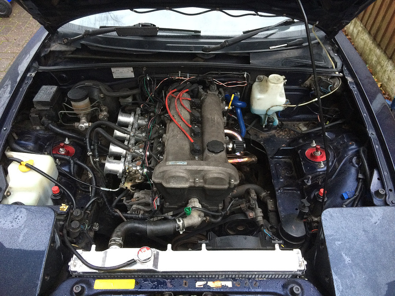

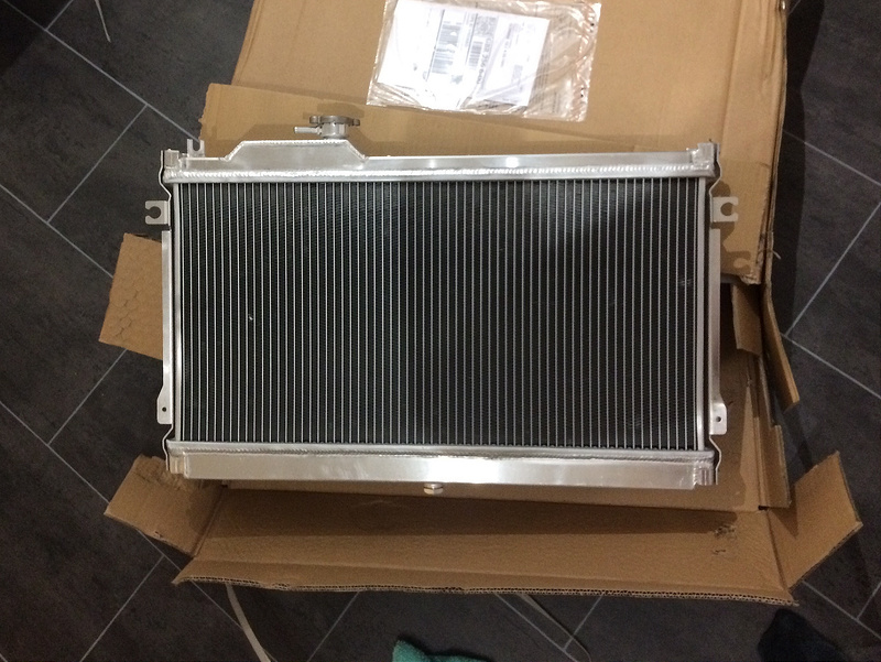

I wanted to put the mic above the exhaust, but as you can see it's absolutely soaking outside! Might get chance tomorrow, we'll see.
Radiator runs much much cooler than the old one which is excellent. Coolant re-route to the back of the block is probably next on the cards.
