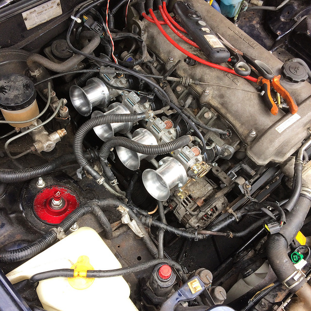

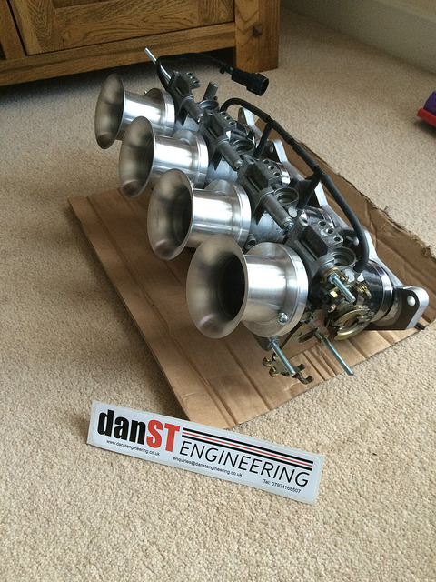

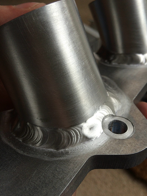

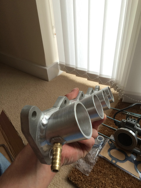

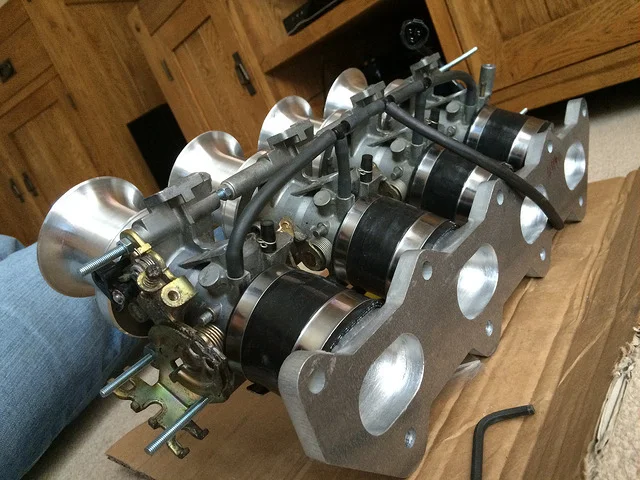

Well, it's all arrived... and Christ was it worth the money!
Just got to get them fitted now!
Excited/terrified. Awesome.

ITB's will be awesome. I was really tempted before I got mine.
Although after being in track with the supercharger I'm not sure I'd go back. So much better than a standard power mx5.

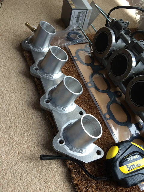

Dan made me a beaut of a manifold a while back when he started on xr2s aha, glad your staying NA with this!

I've ordered a carb balancer, it'll be tuned using "itb mode" which is MAP based below a certain pressure then TPS based for the rest of the map. At the moment it's completely TPS based and it's fine on wide throttle openings, but for stuff like idle and cruise it's absolutely guff!

No reason why you can't chuck a turbo on an itb'd car, but as you say it'd need an airbox and there's literally no room between the brake master cylinder and the fourth trumpet, so you'd have to move things around quite a bit. Also you can get well above what the standard internals can take on the stock intake manifold anyway so it's kinda pointless, even if it is cool!
