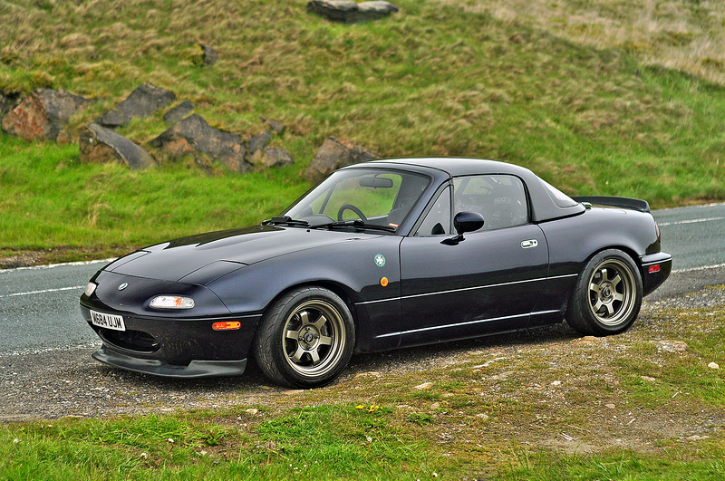

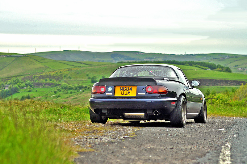

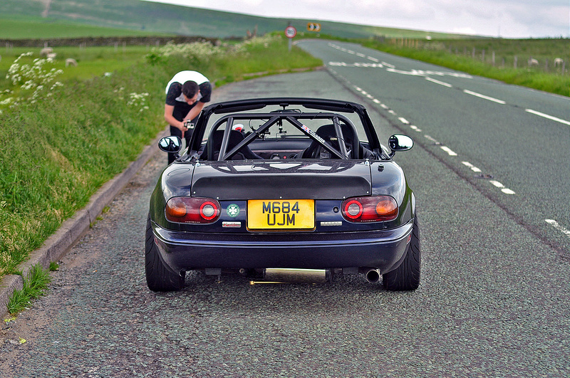

Some more taken earlier on today. So pleased with this thing!

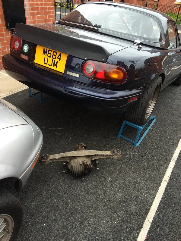

Hit a slight snag this weekend. Was due to remove the engine and gearbox out of my silver car to attach to the 6 speed ready to put into the blue car (it's had a load of maintenance work recently - belts, waterpump, flywheel, clutch etc). Unfortunately I got off to a bad start when the blue car fell off my axle stands while trying to jack it up and fell on my foot. Fortunately not real damage done, exhaust has a bit of a dent in it but you can't see it - even my foot is fine, if a little sore!

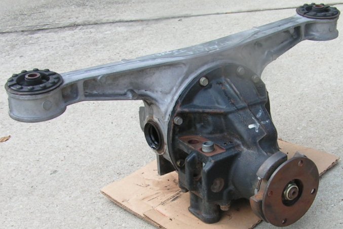

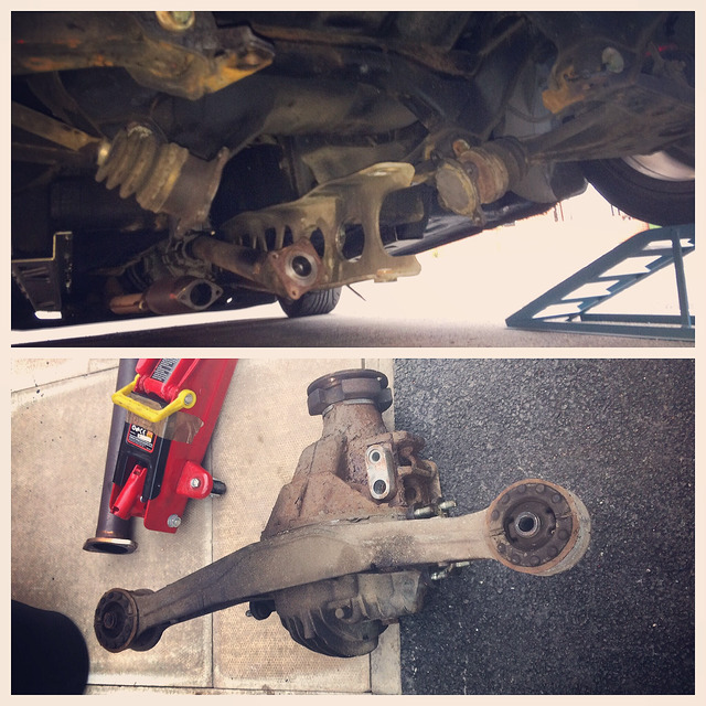

Anyway, the main issue I've run into is that the diff appears to have given up the ghost. Think I first noticed the issue back in Feb/March when I last did Oulton park, but there's quite a loud knocking noise when engaging the clutch/coming on and off the power. Had a wiggle around this afternoon and it appears to have properly gone.
Annoying. This is how it should be (on the silver car):
Could be a simple fix as there's a huge nut between the prop and the diff, could be as simple as tightening that up. If not, I'll just have to switch the diff from the silver car to the blue car and source another one at a later date for the silver car. We'll see. Had enough for today though!

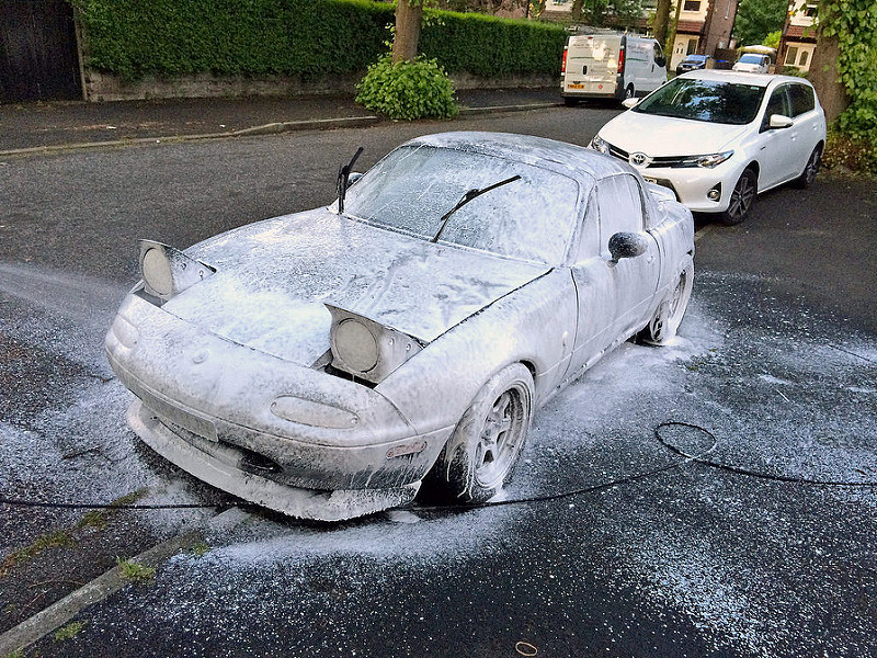

I'll leave you all with a bonus XXX snowfoam pic

That diff isn't fucked.
My old open one was fucked.
And by fucked I mean the casing disappeared in a launch, there's still bits of it in the hedge on naff slack....
Waitaboutery
  Alpina D3, AC Cobra
Lol! What's happened to it then? It's making horrific noises and it's bloody horrible to drive!
Well it's fucked, just not proper fucked.
Just put a Torsen in it and be done.
Although if you try to drift round the mount and hit the curb down from select and save and ram the drive shaft through it, you'll f**k a Torsen too.
Lol that is a torsen! That's why I'm confused...
Going to take the prop off at the weekend and check that big nut. Could fix it apparently.
Well, it wasn't the giant nut. So out came the diff and in went the one from my silver car. All sorted now. Took my weekend up though annoyingly.

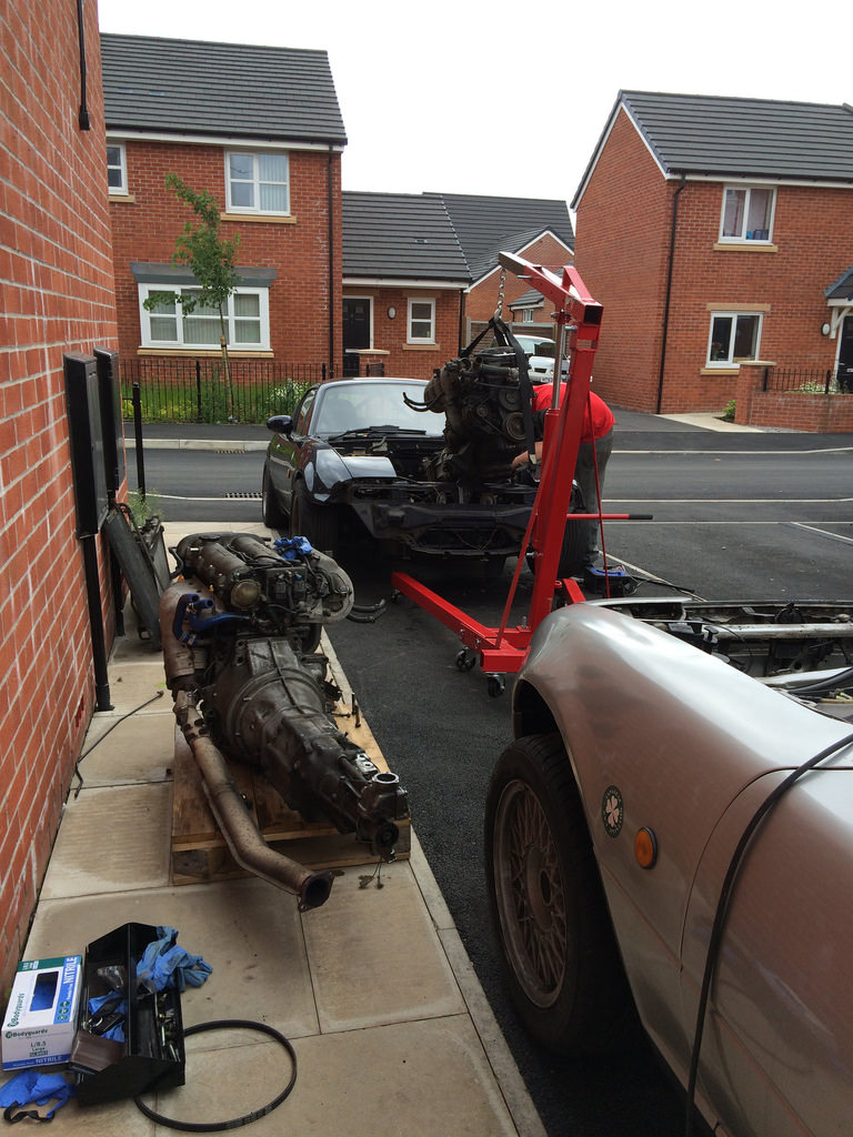

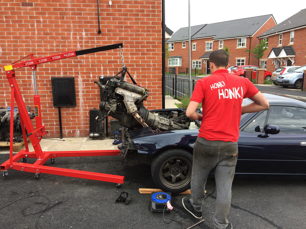

Yesterday was a long one. I've had the silver car sitting on my drive for a while now with a really healthy engine - lightened flywheel, new cambelt, water pump, removed A/C, fresh gaskets etc so decided to swap them over and at the same time get the six speed in the blue car.
Got them mostly in place just needs a bit of wiggling to get the engine mounts in properly and gearbox on the ppf. Not bad for a days work. I'll finish the swap off on Thursday. Kinda can't wait!

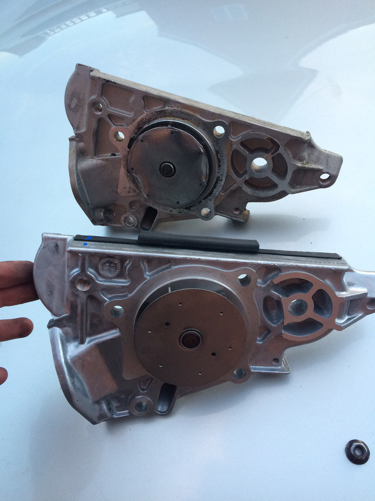

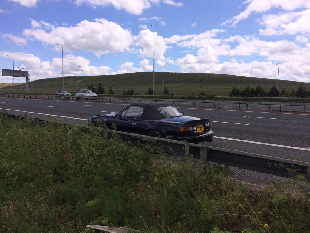

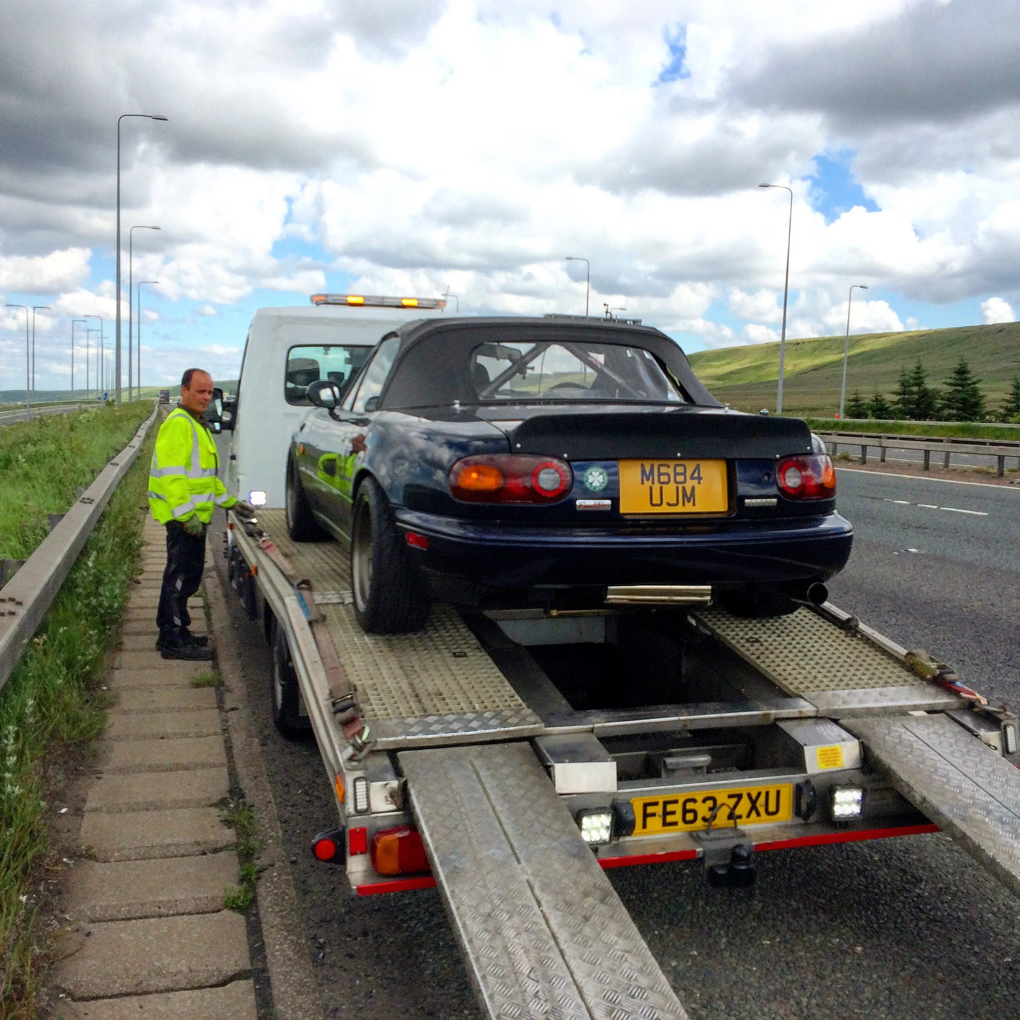

Well, it was all going quite nicely. Got the engine going, full of fluids, 6 speed working fine... Then it started steaming. Turned out a small coolant line coming off the thermostat housing had been cut up by the water pump pulley. Not an issue, I've got a spare, pop that on, cable tie it out the way, slosh some more coolant in, problem solved!

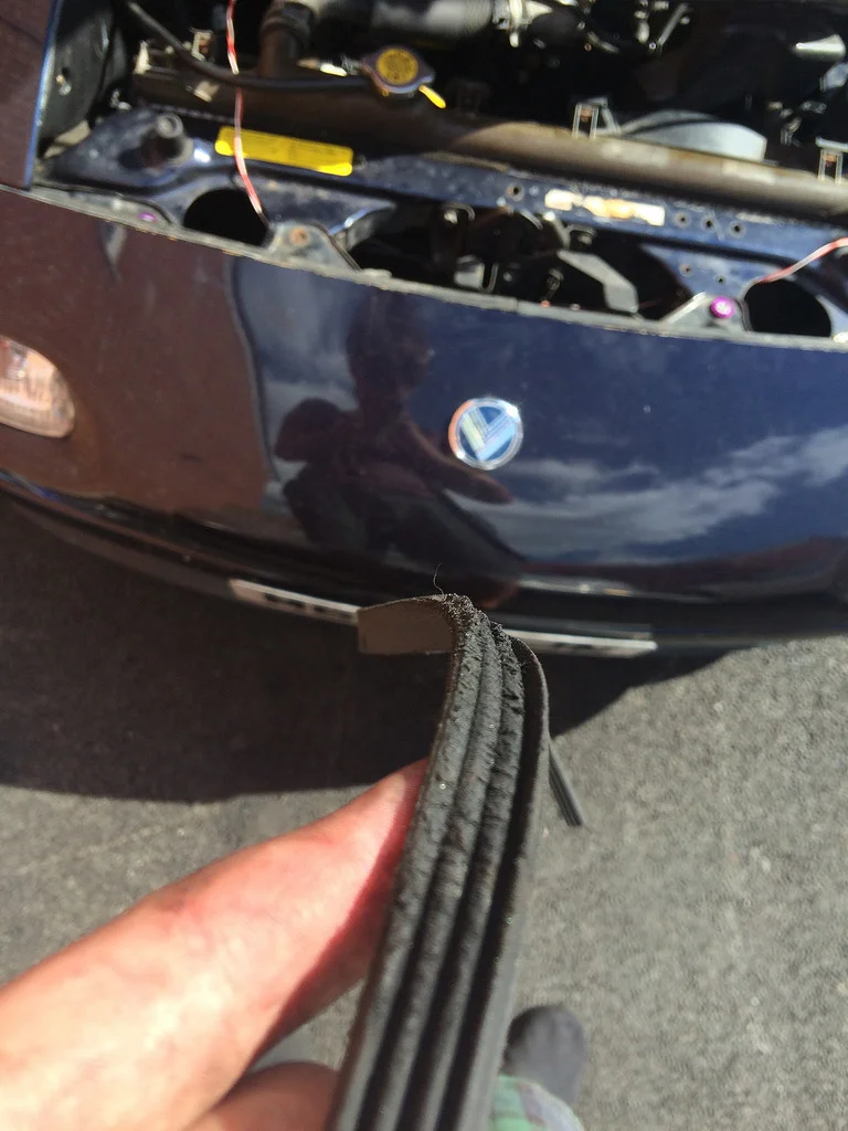

Or so I thought. The new engine had a new cambelt kit, water pump tensioners etc around 6 months ago. Unfortunately it appears the water pump doesn't like water, and because the split hose emptied about 10 litres onto it, I ran into a little issue this afternoon...
Water pump seized, almost took the aux belt out with it. So that was fun.
So it's going to be £55 for a new water pump and £103 for a cambelt kit. And I'm not sure I can be arsed fitting it... Ugh!

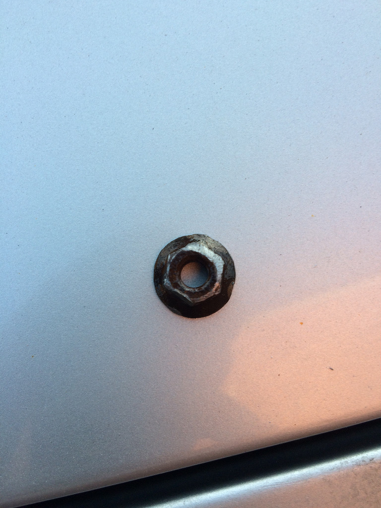

So just to keep this going, I found the cause of my breakdown... A nut in the coolant.
Don't know how it got there, but it completely ruined the water pump!

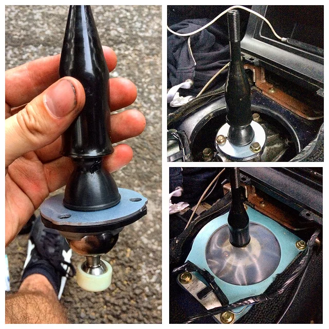

I then rebuilt the gear knob out of the six speed. Different size to the 5 speed so annoyingly I couldn't carry bits across

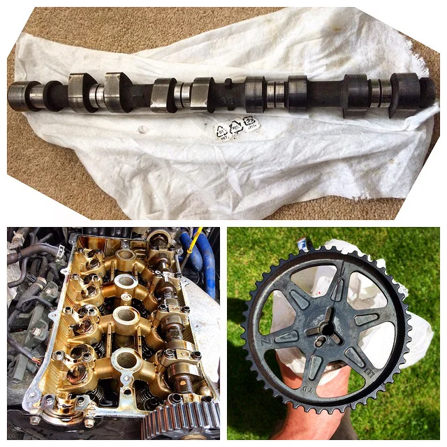

And then at the weekend I fitted an "Exhintake" cam. Which is essentially where you take a 1.8 exhaust cam, chop off the end where the cam angle sensor attaches and pop it in the intake side.
Had to redrill the cam gear, but I eventually want some adjustable cam gears to better tune it.

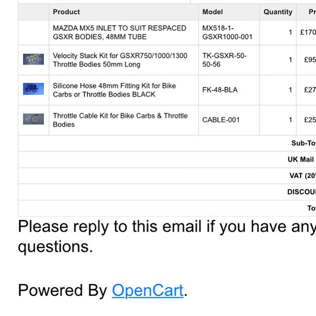

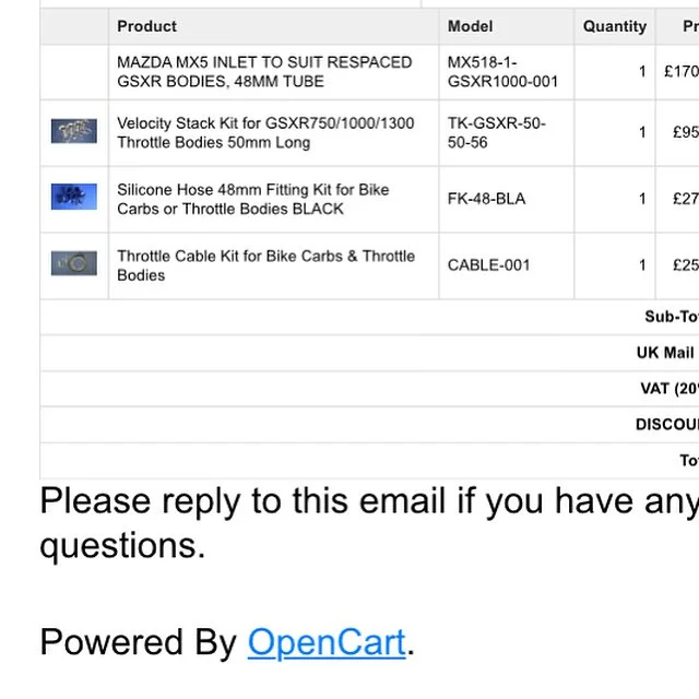

And then finally I put in an order with DanSTengineering for some throttle body bits. I was meant to be buying turbo bits, but the guy still isn't taking orders for exhaust manifolds and I'm getting bored waiting!
£320 for an inlet manifold, trumpets, throttle cable and silicone pipe. Plus about £60 for second hand GSXR throttle bodies. Should make for a fun car!
