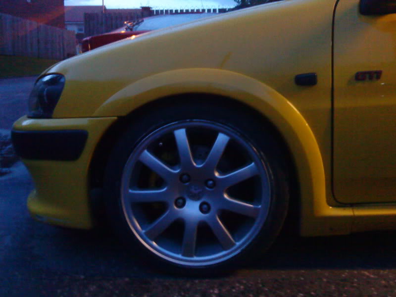

Straight out of the box they are awesome cars, heres my old one

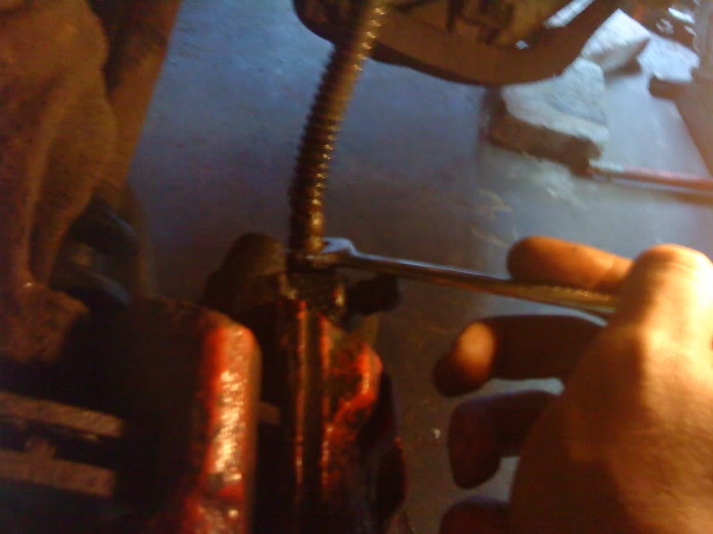

Now crack the brake cable union that goes onto the caliper:

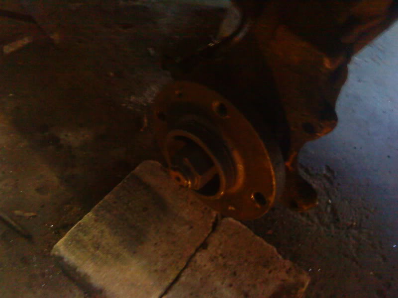

The disc will probably be seized against the hub, use some gentle persuasion with a mallet or hammer and it'll come off.

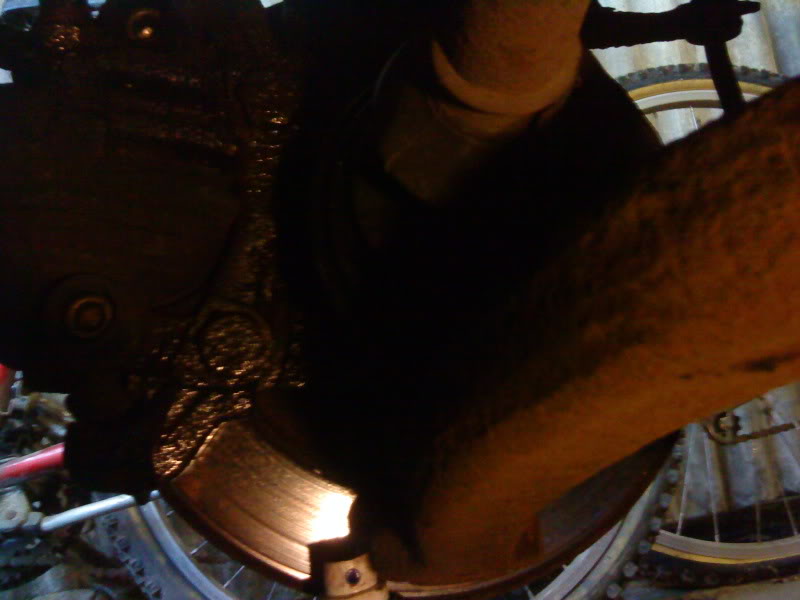

This'll be what you're left with:

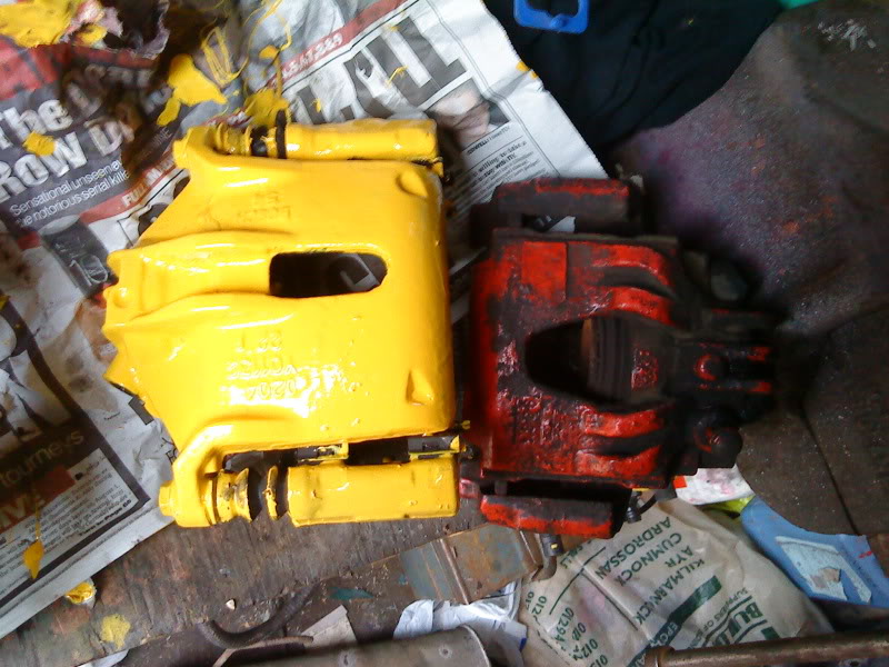

Now we're on to the Bosch calipers, here's how they are compared to the GTi ones:

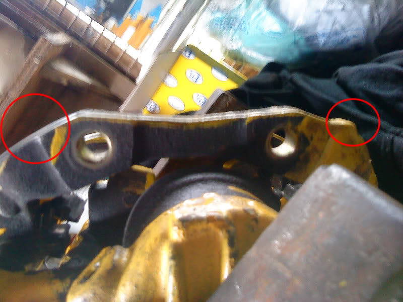

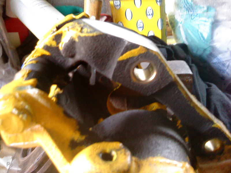

It's not just the 283mm calipers that need grinding but these too. The picture below shows what I removed. You see the bump in the circle to the right? Well that _was_ the same on the left side, it's that you need to grind off. Make sure it's the top of the caliper you grind, the bottom off the caliper lines up with the holes fine.

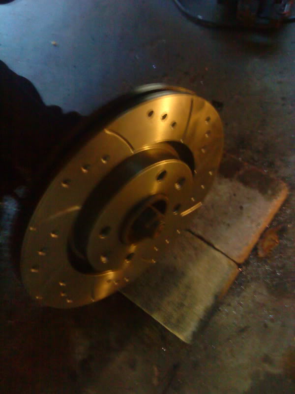

Place your disc on

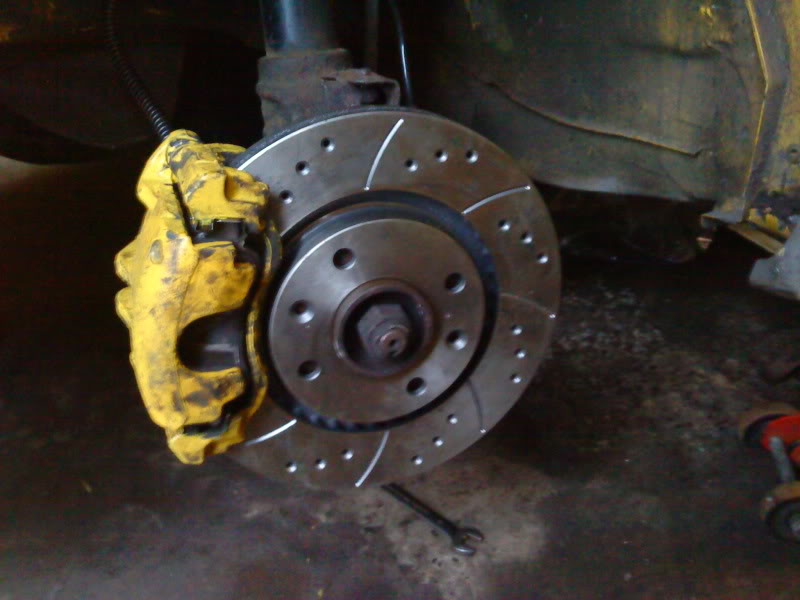

And here's what you should be left with:
