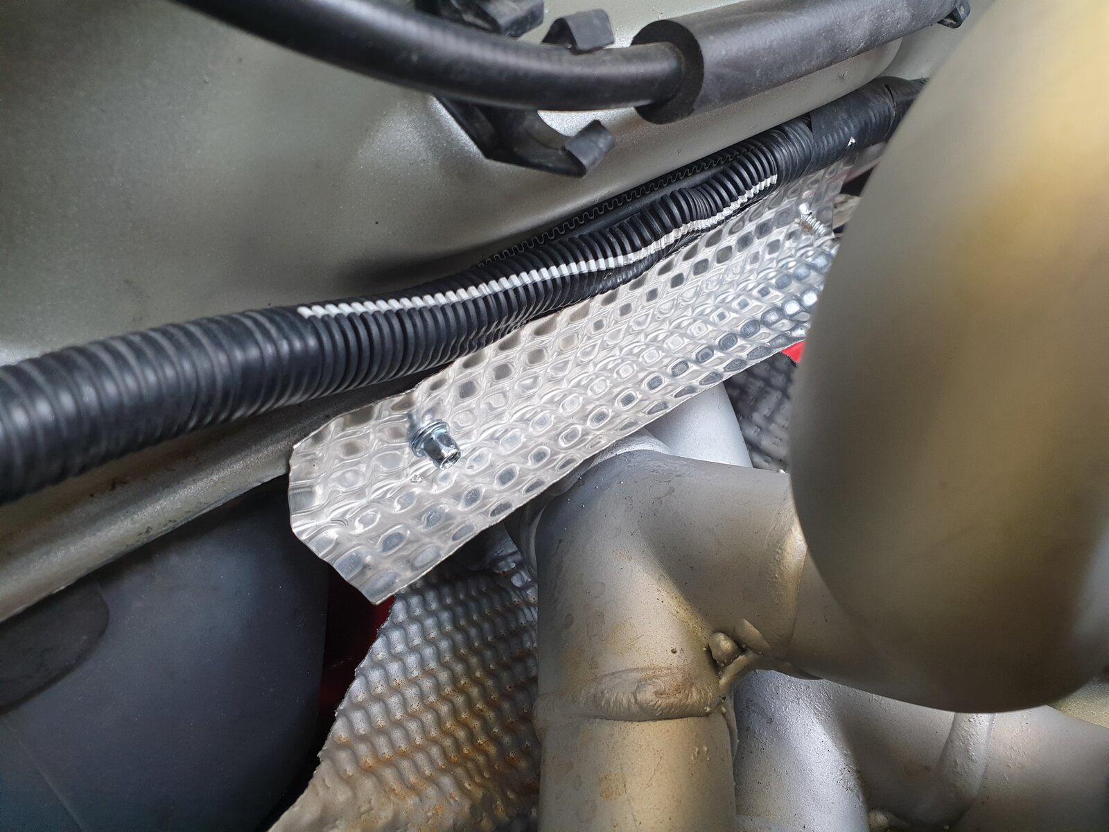

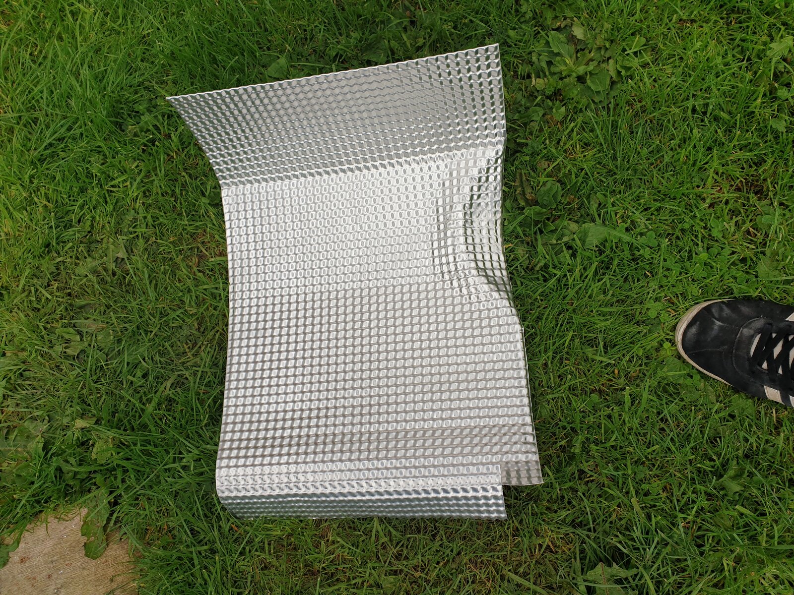

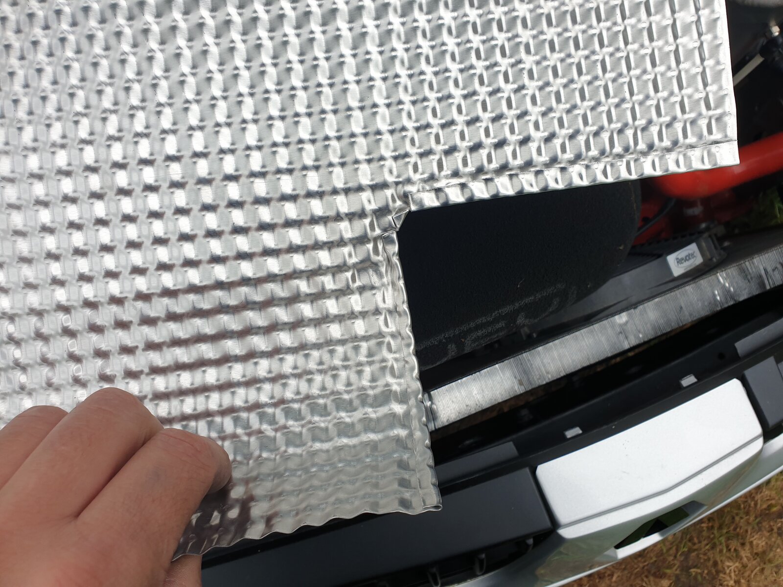

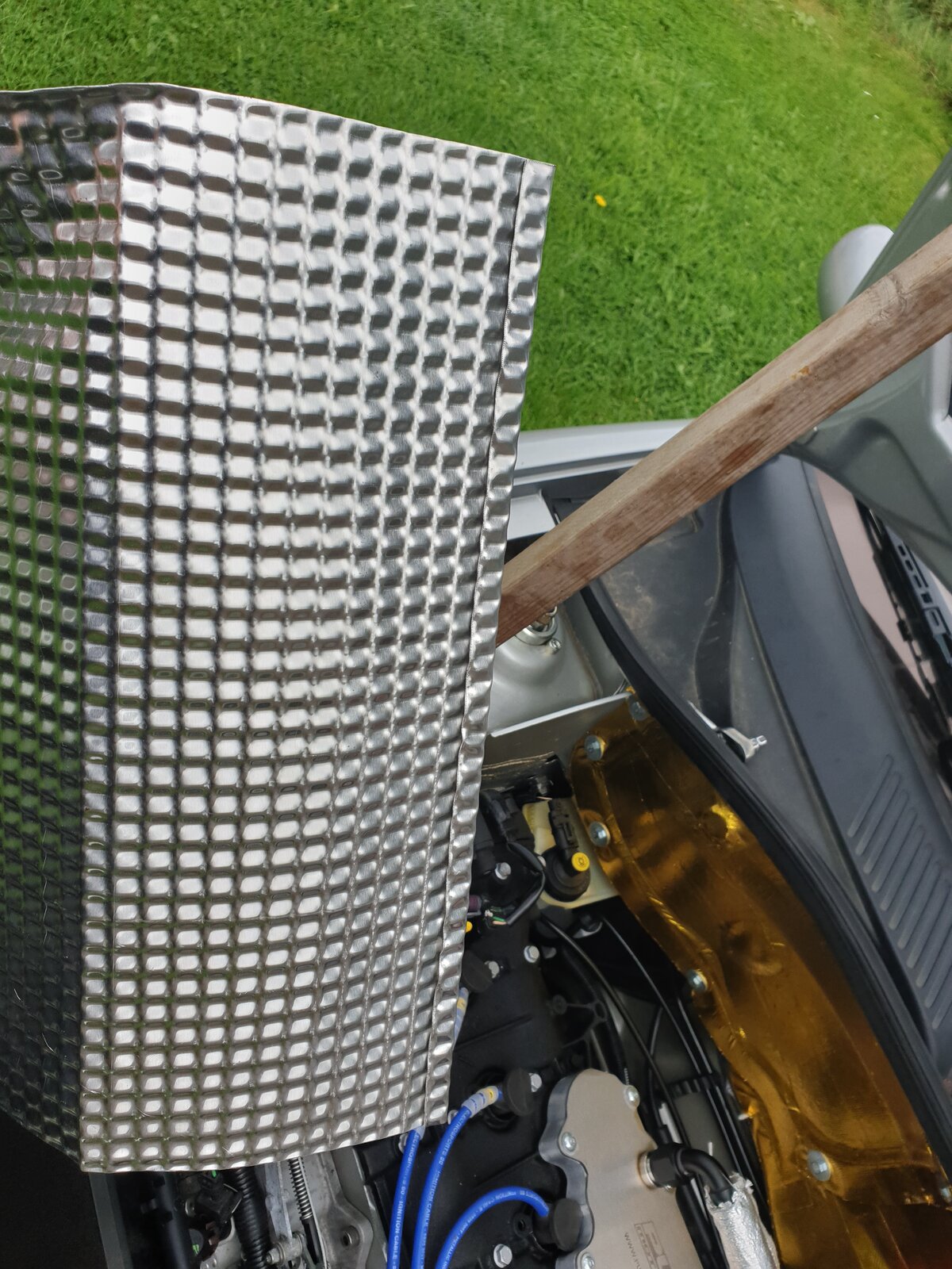

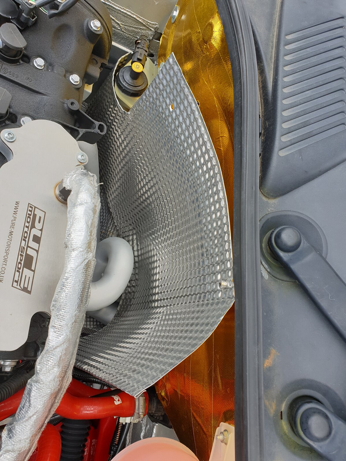

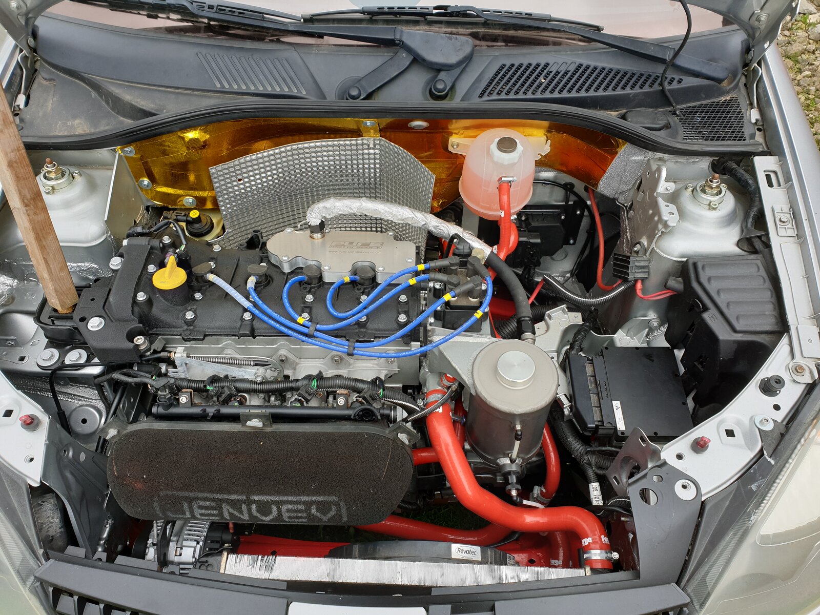

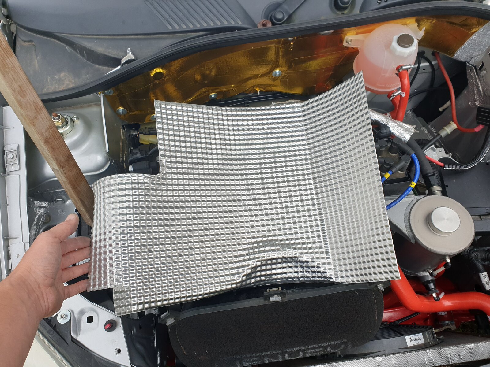

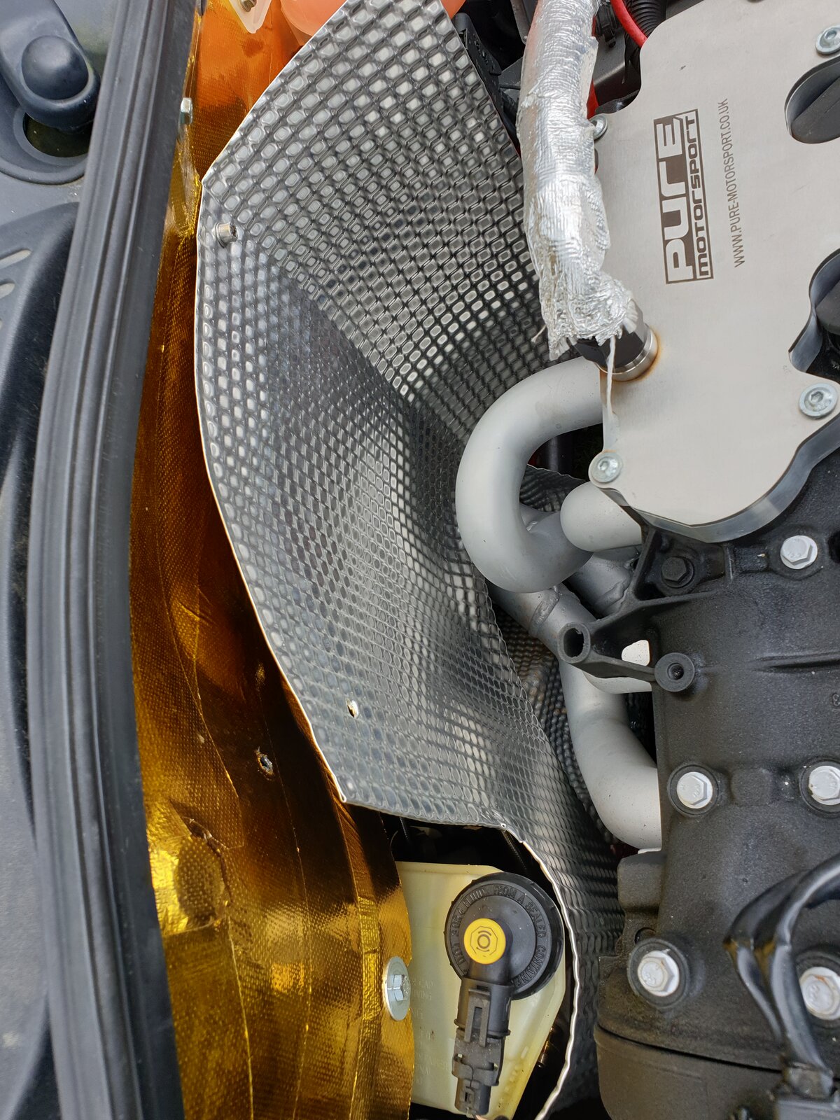

So nimbus heat shield, to protect my brake lines, master cylinder and clutch cable.
Bought it from Tweeks I think.

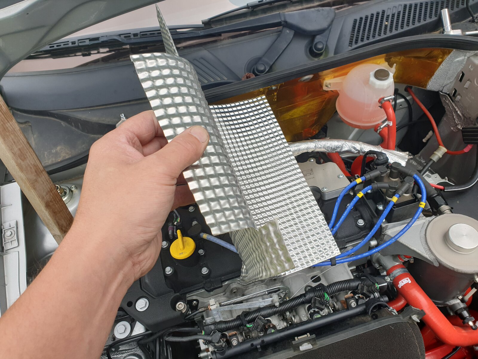

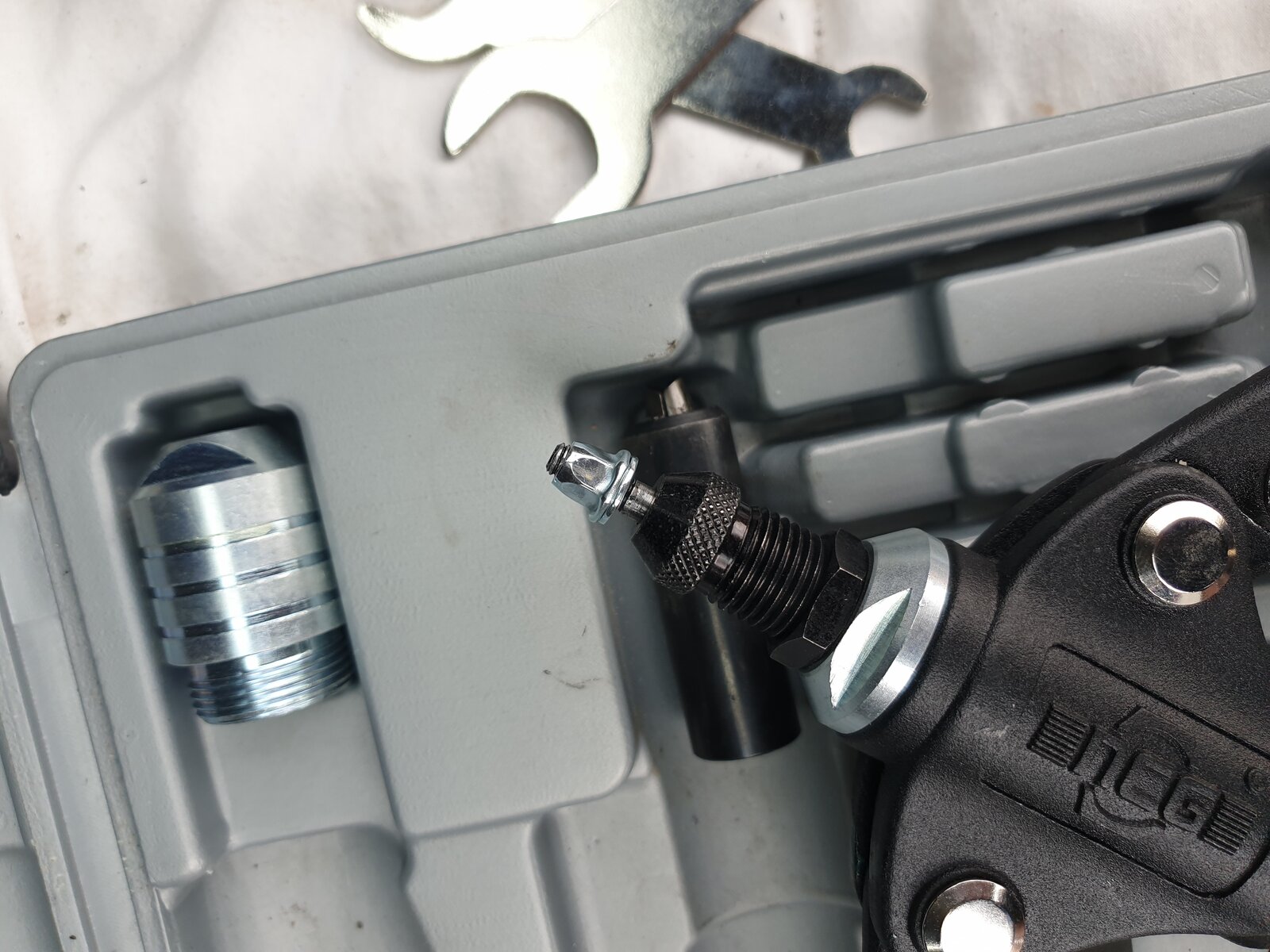

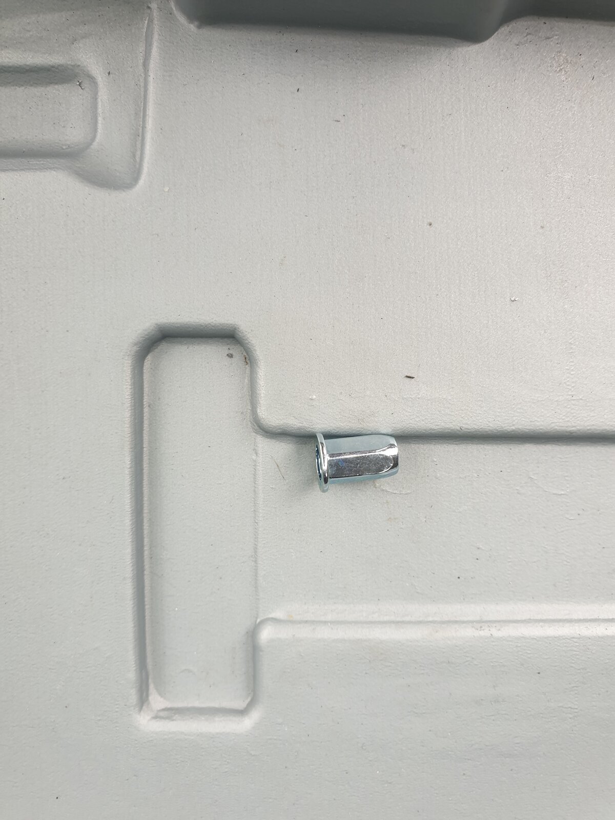

Started by measuring the depth and width i wanted it to cover. Then once i had the correct size i used a rubber mallet and a plant pot to panel beat the curve where it sits over the collector of the manifold.
I tried it down the back of the engine for size. Still wasnt quite right. It was hitting the fuel line so I cut a relief and bet it away from the line which actually ended up working out well as it covered the fuel line from heat.
I wanted the MC to be protected but at the same time be able to remove the cap to fill the fluid up. So I had to cut small sections out a bit at a time until i was happy with the shape. Then whilst test fitting it again I cut myself on the sharp edges so I rolled them over to make them safe.
So now it looked like this.

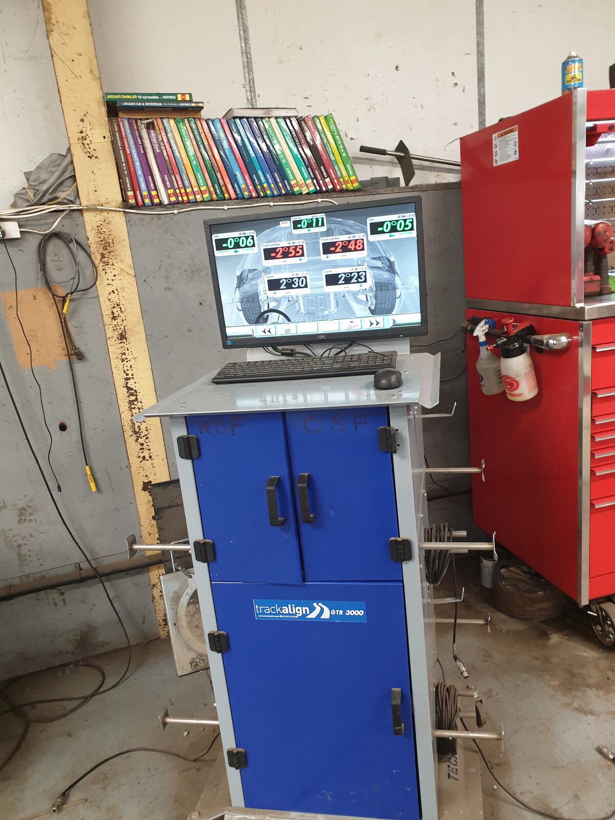

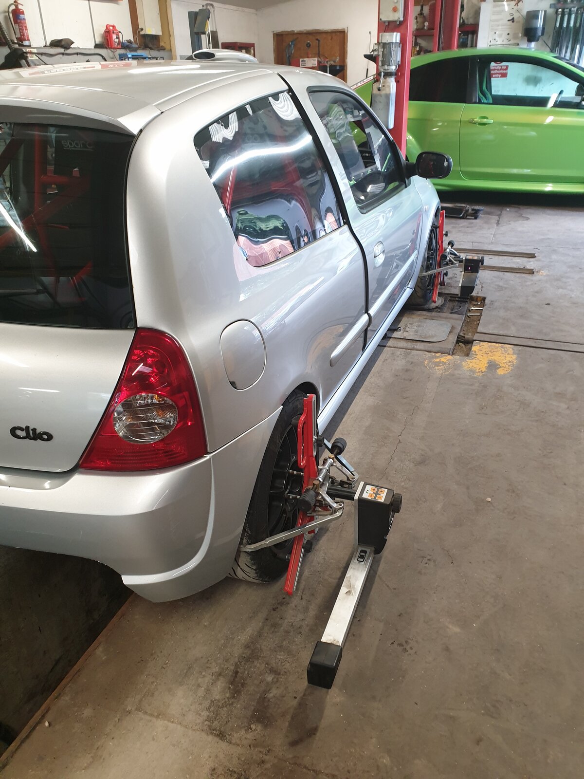

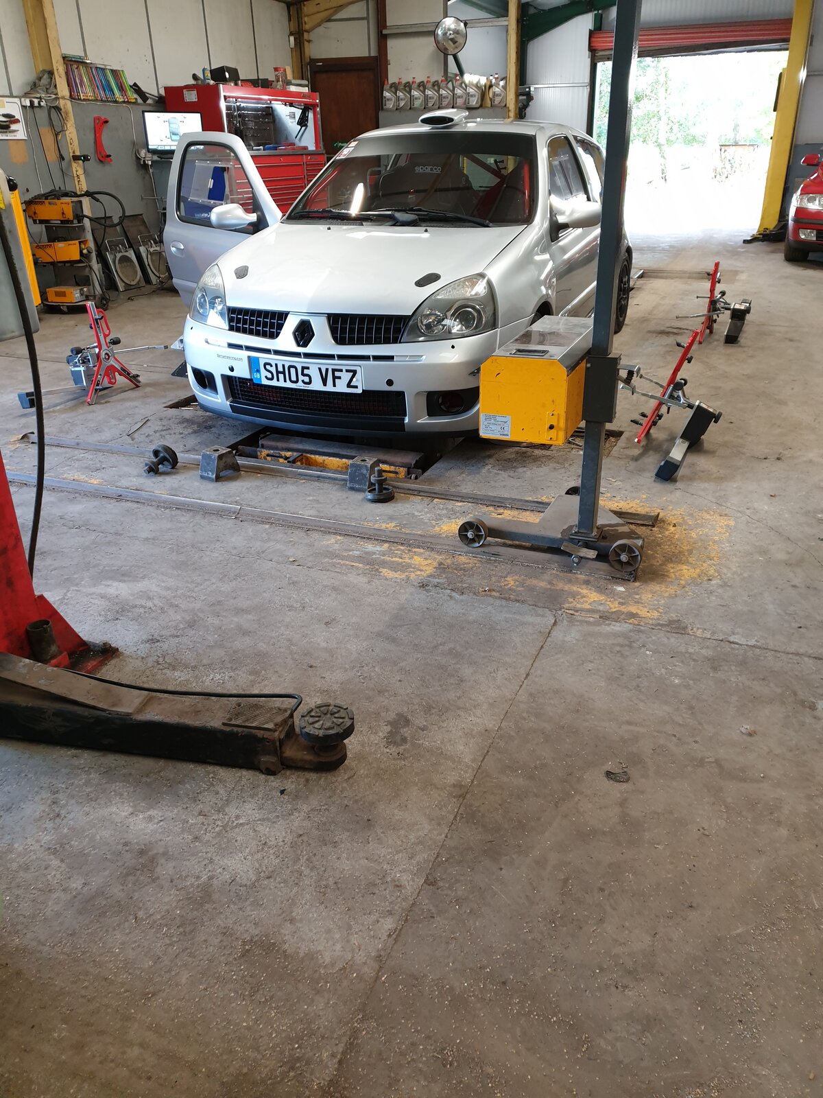

Whilst I was there we quickly setup the tracking so i wouldnt ruin my tyres before i could get onto a proper hunter tracking machine.

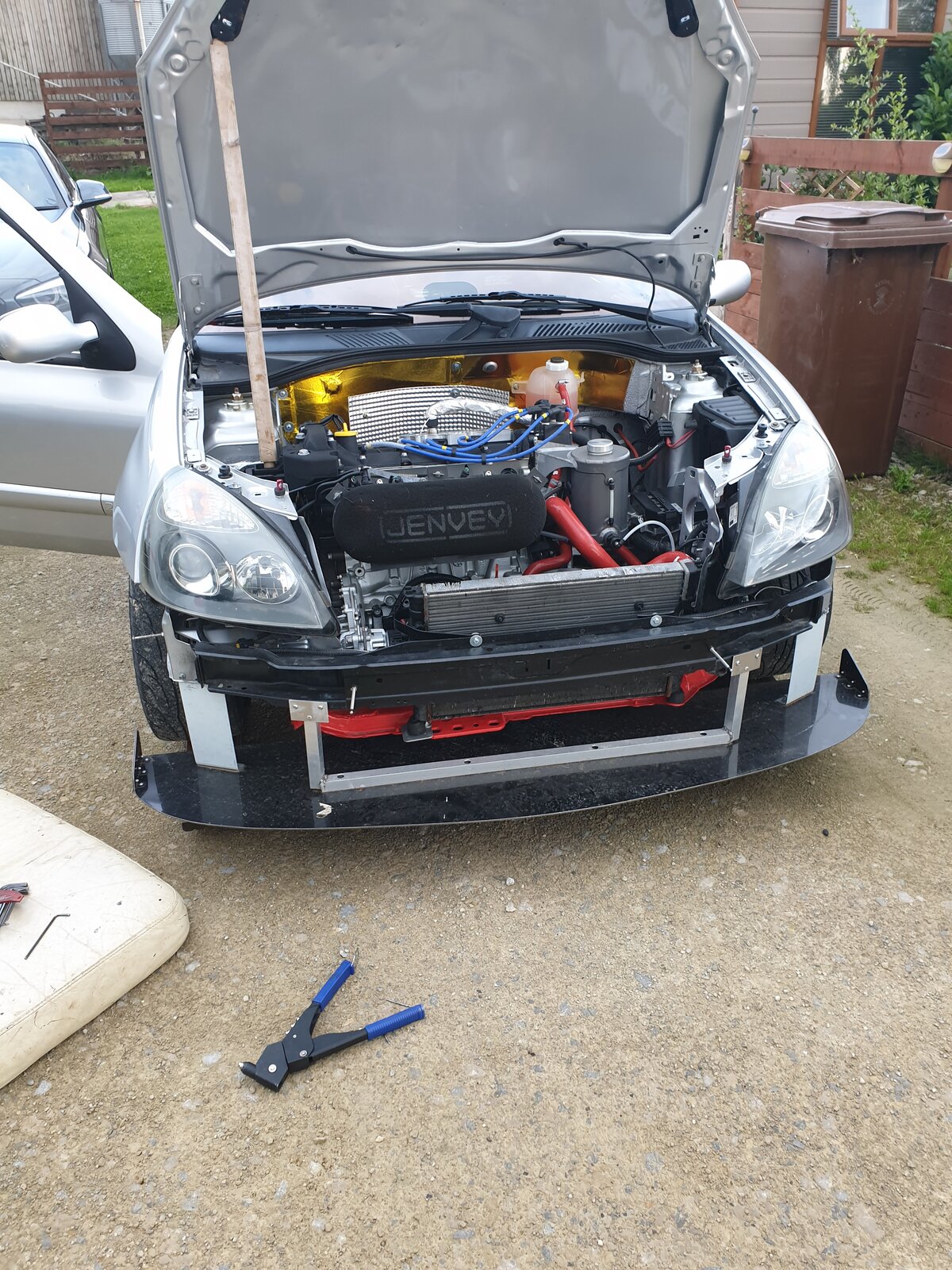

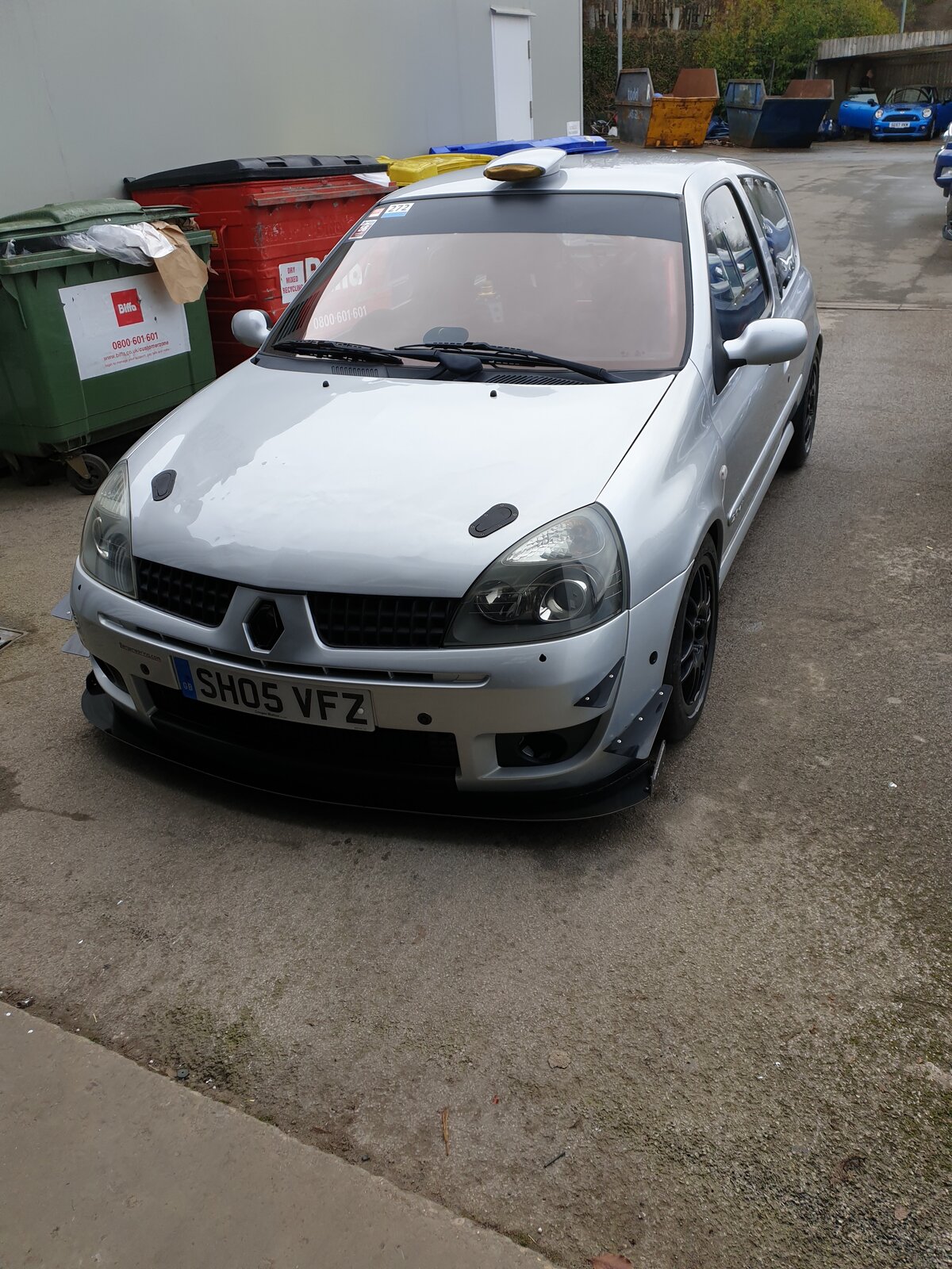

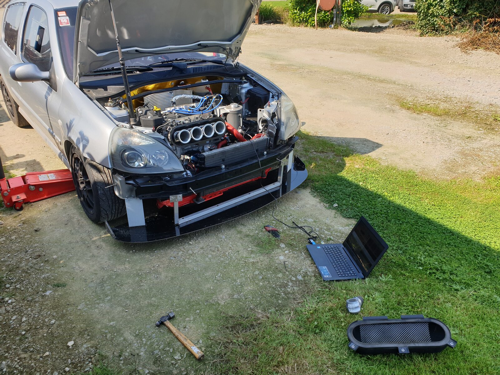

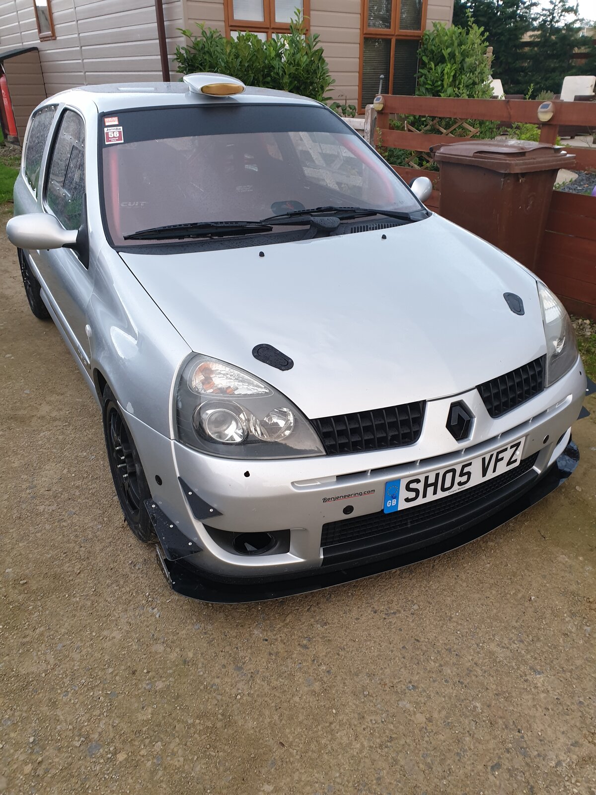

After a 20minute blast down the back roads round me I got it home and fitted the splitter. 8 cap head bolts and 2 ally rivets and it's on, no messing!
Job jobbed. Very happy with it. Next we need to book a track day and get some miles on it so I can do another spanner check and make sure I dont have any issues anywhere.

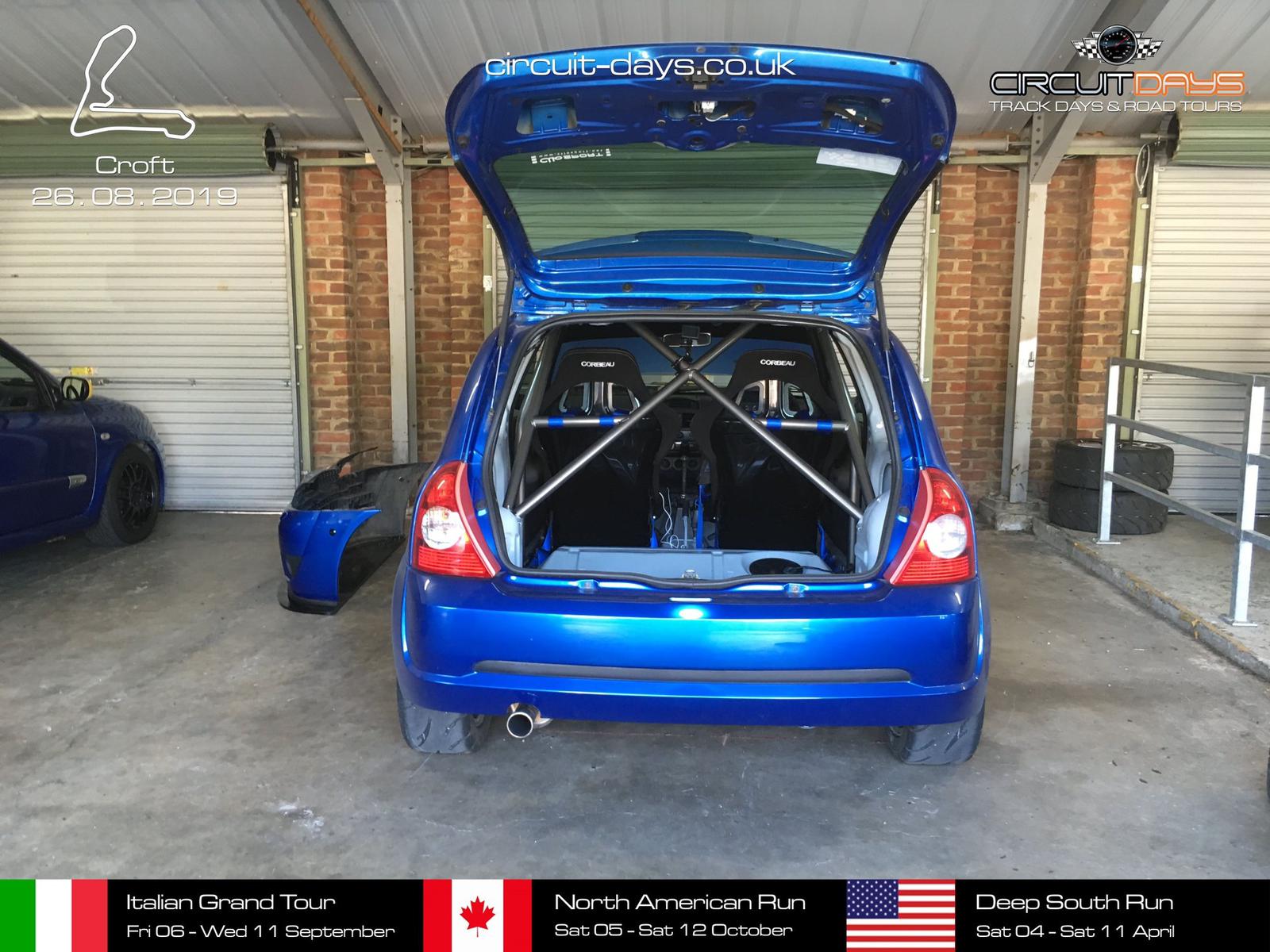

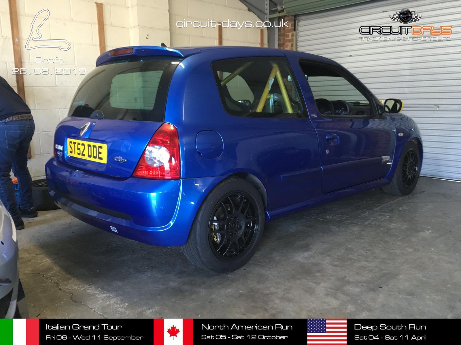

So 26th August 2019 the date was set.
Croft race circuit.
Me 182ff clio
Jeffy 172 cup
Andy 172cup
Lee mk2 golf GTI
Ryan 172

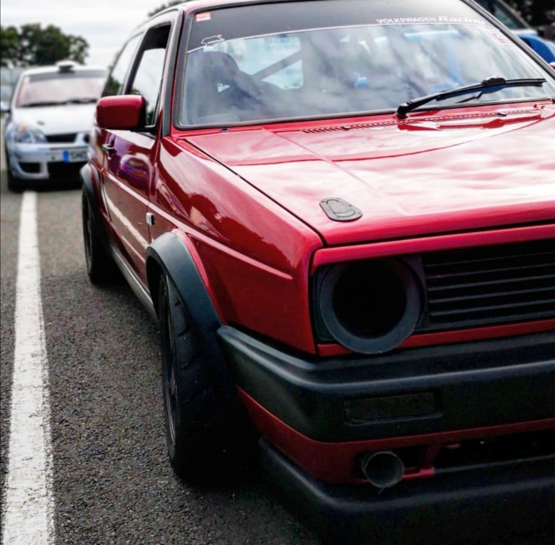

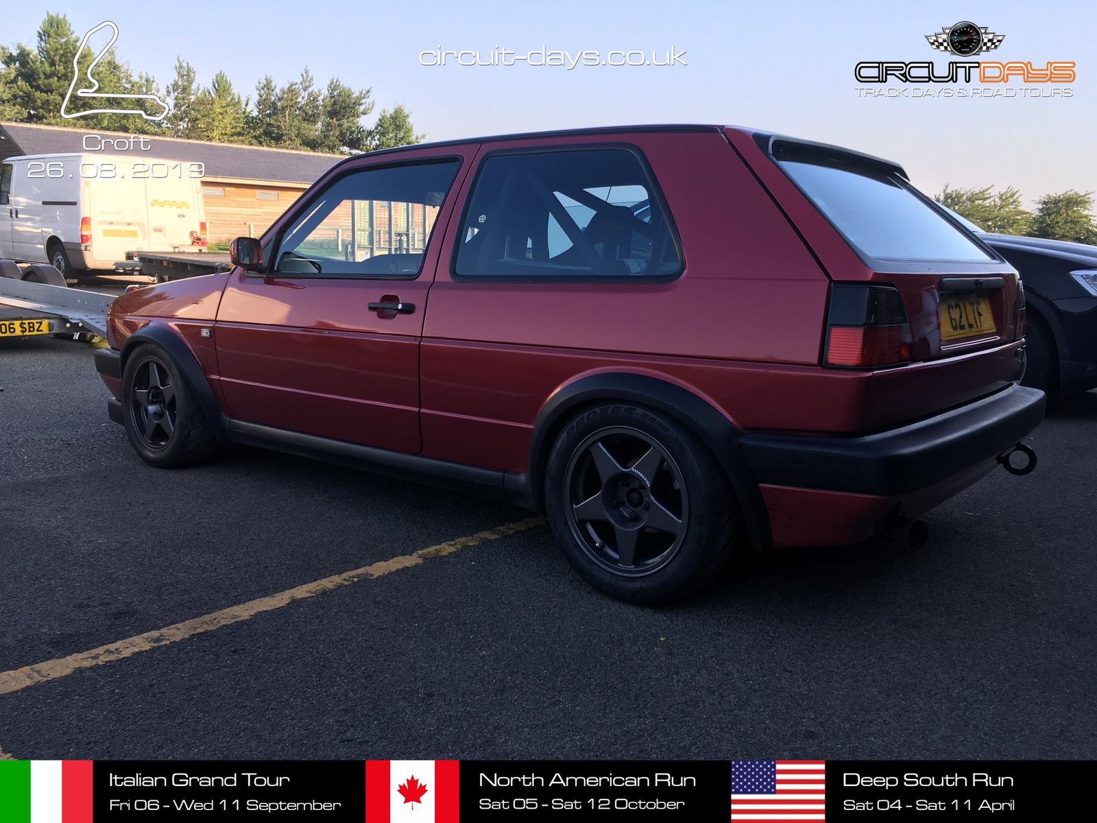

All in varying levels of mods. The golf is the pace setter and I've been chasing the bloody thing ever since I started with my 1st 172!
It was his first car like 15 years ago. Started out as just a 1.4 or something. Now it's a VR6, bc coilovers, caged up, diff'd up animal!
So it was only a week and a half away, I threw the laptop on to the ECU and checked the parameters. Slightly off to what Chris at EFI told me so I set about re balancing the bodies and adjusting the idle so it showed 13.6 on the AFR gauge then reset the TPS so closed and open throttle was corrected. It was quite a way out so it needed doing!

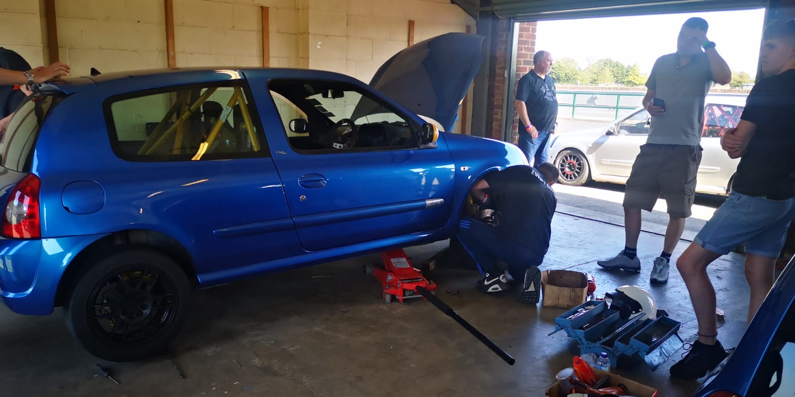

Next I removed the front wheels and spanner checked ALL of the nuts and bolts. Nothing seemed to have come loose and all was well so far.
The day before Croft I removed the front wheels again so I could lube up the rose joints as I had forgotten to do it when I spanner checked and I was greeted with this...

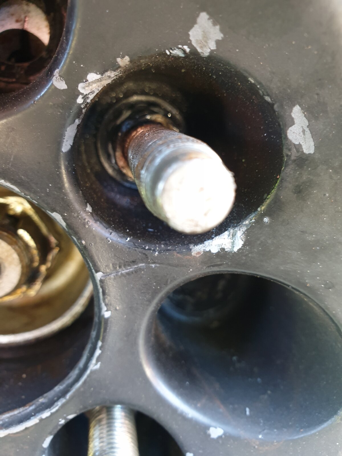

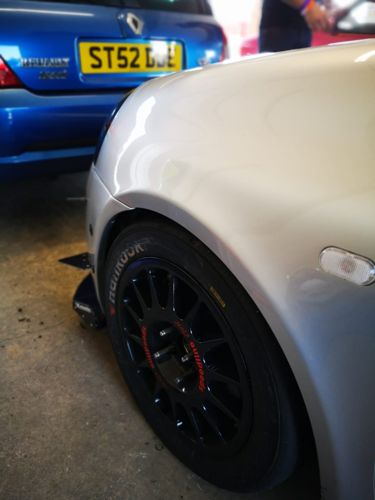

The wheel nut was fcuked!! How I had managed to do it I dont know! Took me best part of an hour to get it off and then I didnt have replacement nut! Great. 4 o'clock in the afternoon with nowhere to get another from.
So I had to remove the stud and use my mates normal wheel bolt just so I could get a go at Croft.
New studs and nuts required after I think. To be fair they are too long so I need shorter ones anyway.

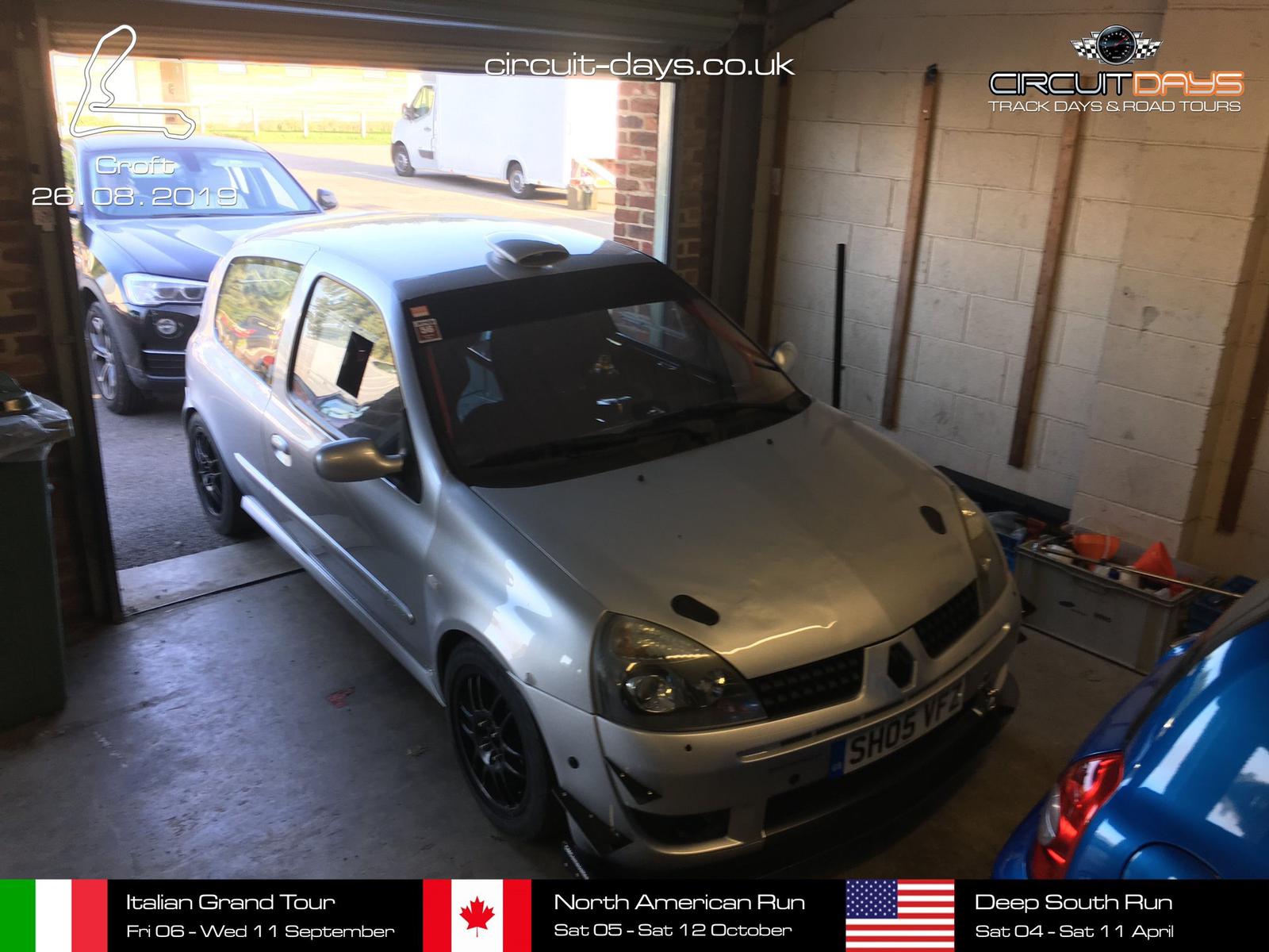

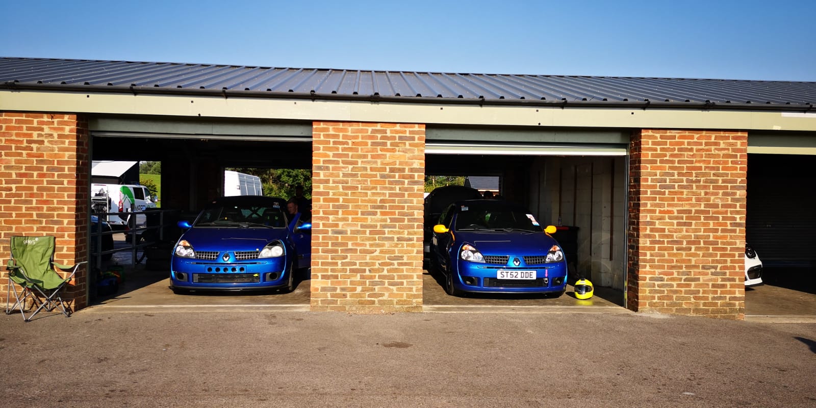

We convoyed up to the track setting off at 6am. We had booked a couple of garages side by side knowing itcwas going to be hot. Glad we did as theres no shade to sit in at Croft its wide open.
Que the photos....
It was pretty rough on the cars in the heat. Andys power steering fluid boiled everytime he went out, Ryan's gearbox was leaking from an unknown area, Lee got a flat tyre in the last hour of the day and Aron ripped Andy's splitter off when he went out for a spin and erm went off track.
Luckily mine never missed a beat, I checked the wheel nuts and tyre pressures a couple of times but wasnt expecting any problems with everything being brand new and rebuilt. Very thankful to have the roof scoop for fresh air into the cabin, was like an oven.

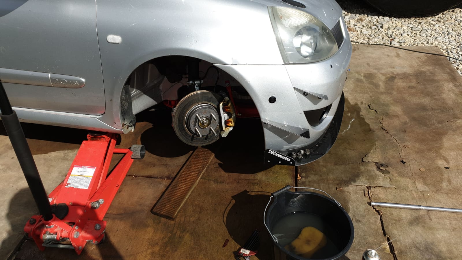

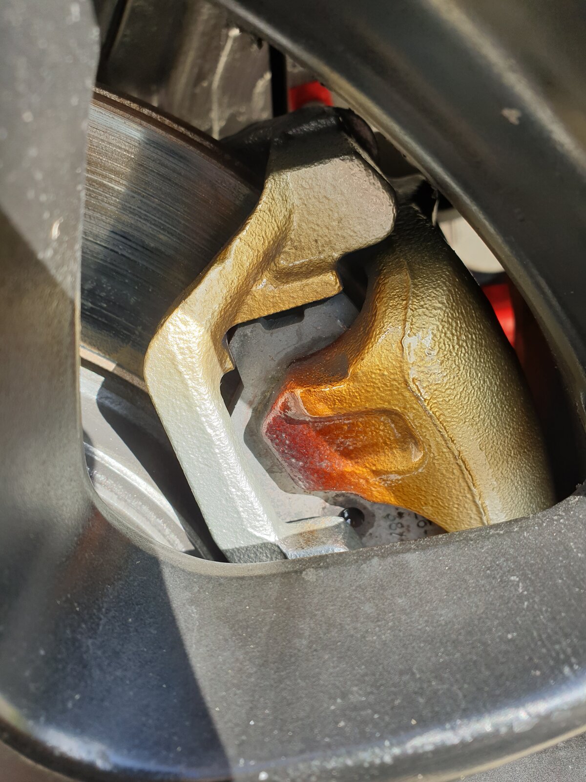

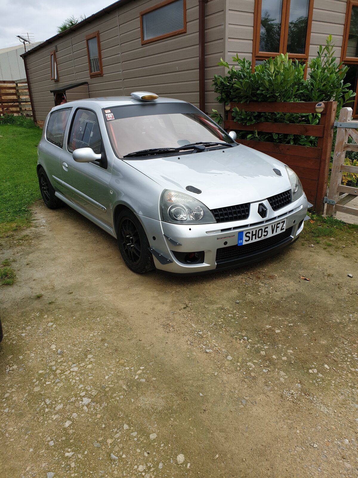

I cleaned the front suspension components and wheel arches. Re lubed the rose joint and check the paint on the fresh front calipers.
So much for 800° stove paint!!
It isnt bubbling off but its definitely burnt! I must have been pushing hard!
It's only really where the caliper touches the pad that's dis coloured. Think I should refresh the brake fluid and introduce brake cooling next.

Might be worth seeing if you can get some titanium shims laser cut for the backs of the pads. We used these on the Porsche to prevent heat transfer to the calipers and fluid.
if you get some done, get a load done and sell some to fund your own. 🙂
To be fair the CL range is on copper backing plates for that very reason I imagine.

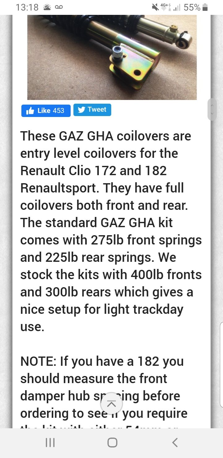

I'm guessing the guy who bought the suspension originally must have got the standard spring rates as seen below
I had excessive role and understeer not skipping, usually if you are skipping across the track you are setup too hard and bouncing on the tyres.
So coming out of a corner and adding some throttle it would just push on rather that exit the corner correctly.
The stiffer front springs at 550bls and the struts revalved to suit the springs reduced the role so the car was more stable allowing me to accelerate out of corners earlier.
Obviously I changed alot of other things which factor in like the diff, role centre kit, slicks. But with less role you keep a larger contact patch of tyre on the tarmac for grip and less weight transfer from one corner to the next.
Yours should be on 4pot ally calipers? They dont normally get as hot?
I’m on the Porsche 4 pots front and rear with bigger 2 piece GiroDiscs.
these take the fronts to 345mm and rears to 335mm. RS29s, titanium shims and GT3 ducts complete the setup. They still get a solid work out on track even with cooling and ally uprights all round.

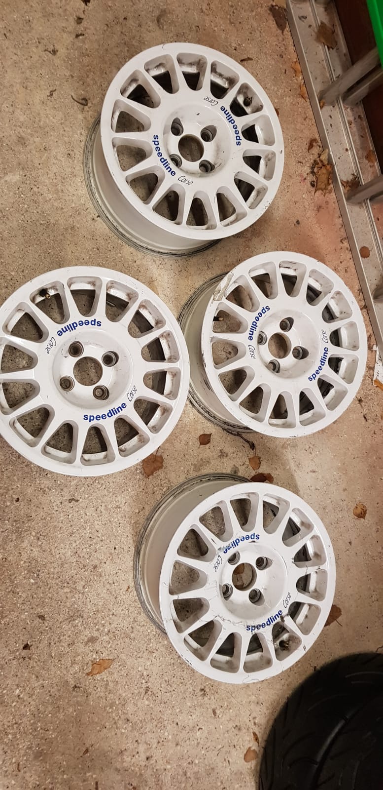

And I just bought some more 2118's that I will do black like the others and fit the red decals again.
I'll fit probably some Toyo R1R tyres to them. Road legal slicks and supposed to be for wets. I've never run them yet but always wanted to try them. I know everyone raves about rainsports, but what happens when the track dries up or if you get a puncture on your dry setup. The R1R is still the same compound as r888 so will still work in the dry.

worth investigating the Ti shims though. The CLs having copper backs will only compound the issue. Cooper has exceptionally high thermal conductivity so yes it pulls heat from the surface of the pad it piles all that heat into your calipers and fluid. Titanium does the exact opposite.
