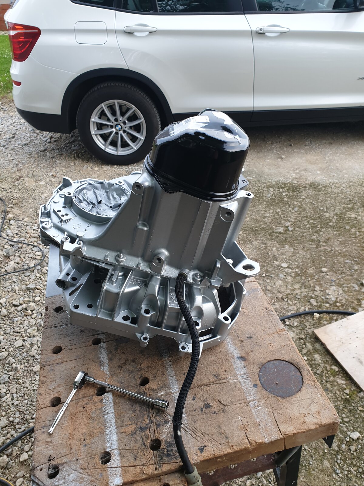

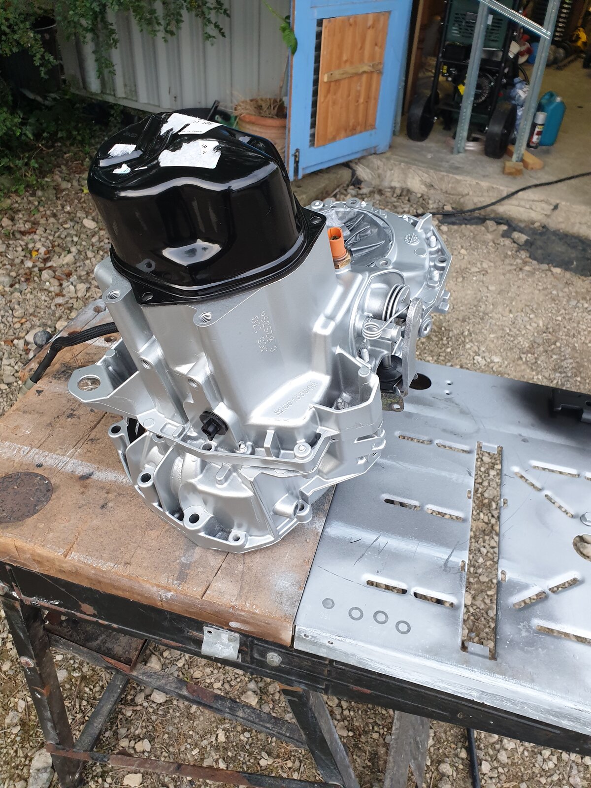

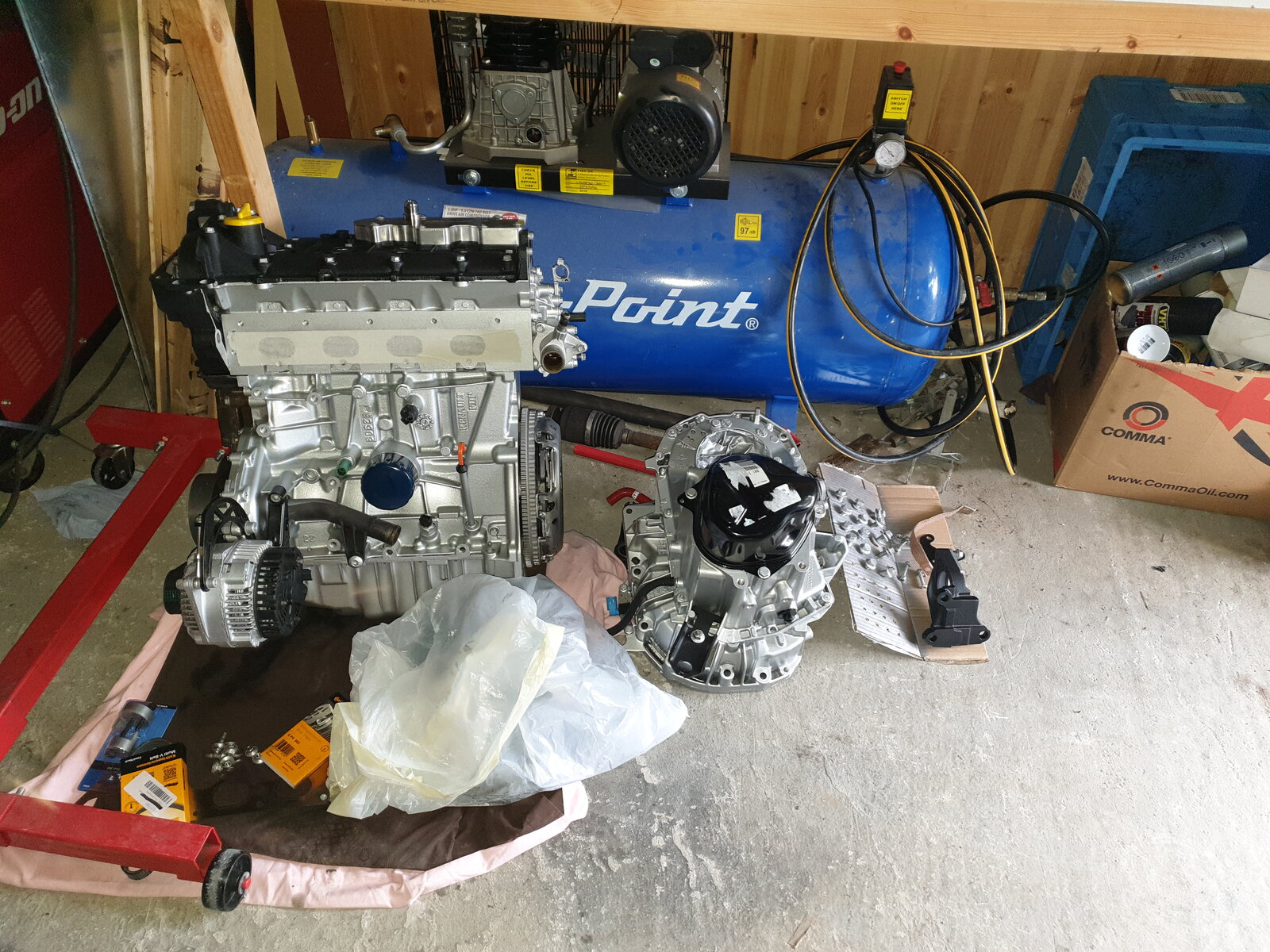

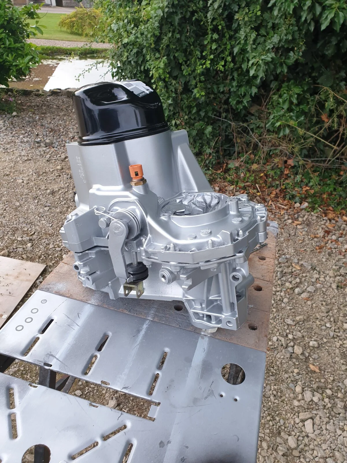

Next I tackled the gearbox. Same idea as the rocker cover. Using wire wheels on my drill I remove the oxidized crud to reveal clean ally. Gave it a good blow off with the air line and the used panel wipe to remove any oils or greases.
Using the same VHT enginal enamel as the block I masked the bits off I didnt want paint on and gave it a good couple of coats to seal it. Looks like its brand new now!

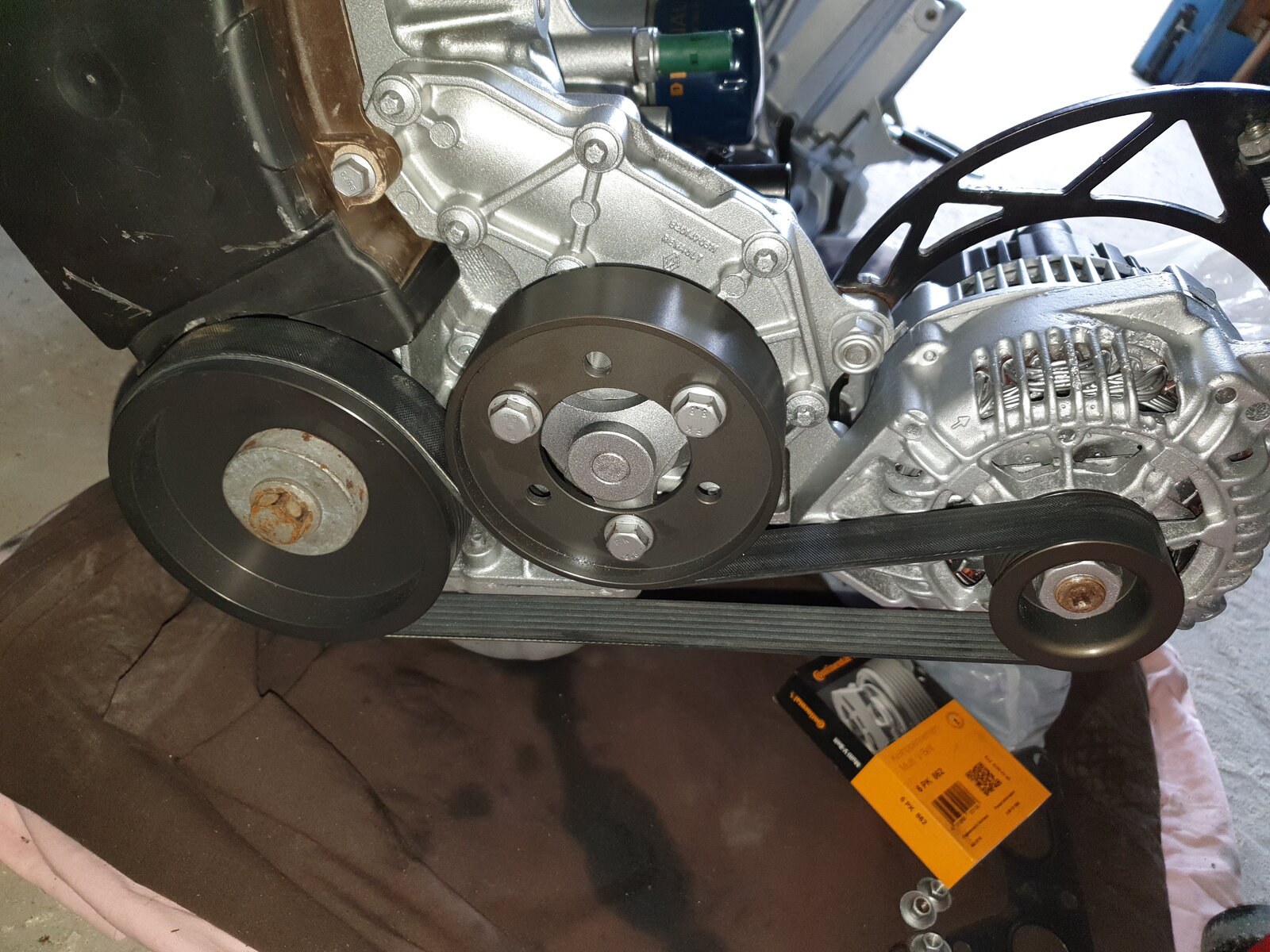

Locked the engine in place, removed the old battered crank pulley and fitted the new lightweight one I got in the kit.

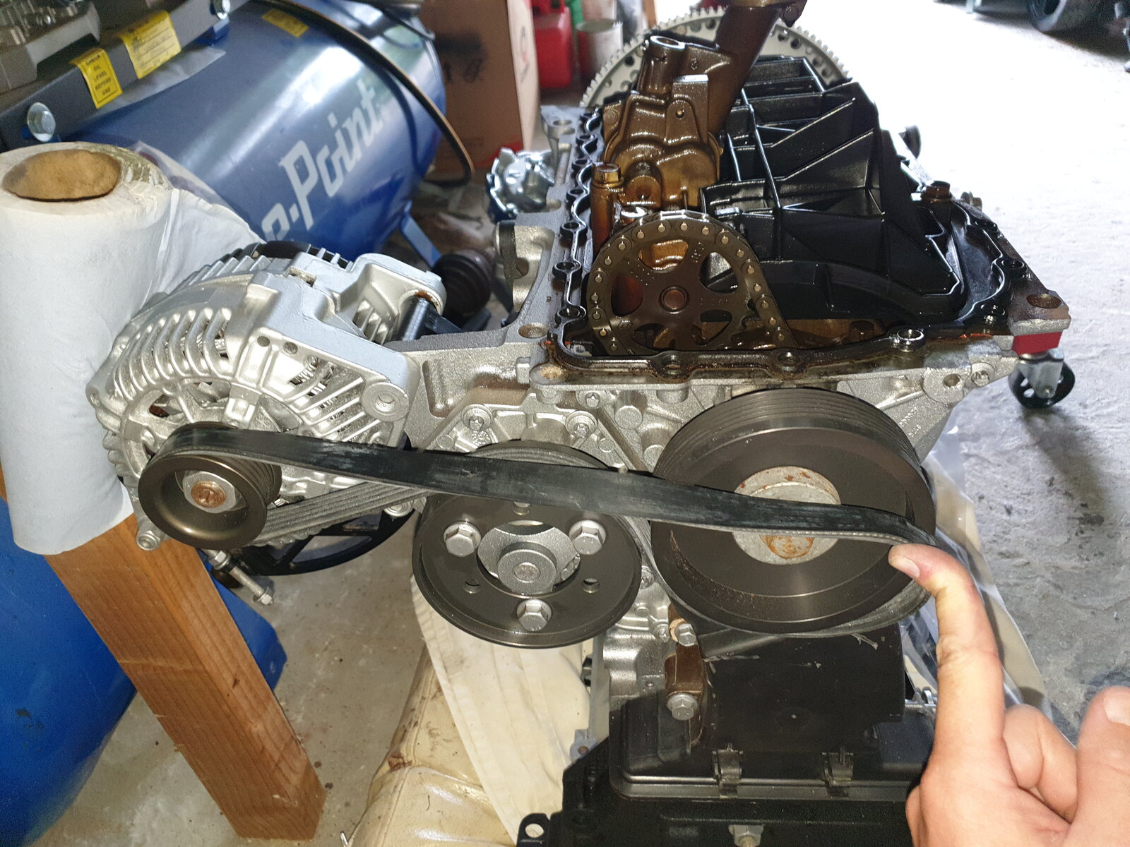

We then sat it on its head on an old sofa cushion so we could remove the sump to fit a new gasket. It had a slight weep before it was removed so what better time than now to do it! I also managed to get hold of a stretch belt to try.
We replaced the crank seal behind the flywheel because there was oil in the gearbox when I removed it. We then put it all back together and fit the belt. Think it was a continental 6pk 862mm stretch belt.

So that's the gearbox ready, engine ready, all the nuts and bolts to mate the 2 bits back together painted ready. The centre driveshafts bearing bracket painted. All that needs to happen now is arrange the boys to come round and get it thrown back in (without any scratches or bumps!) One weekend and we are finally getting somewhere!

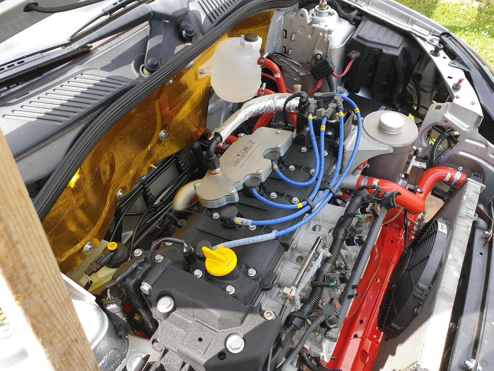

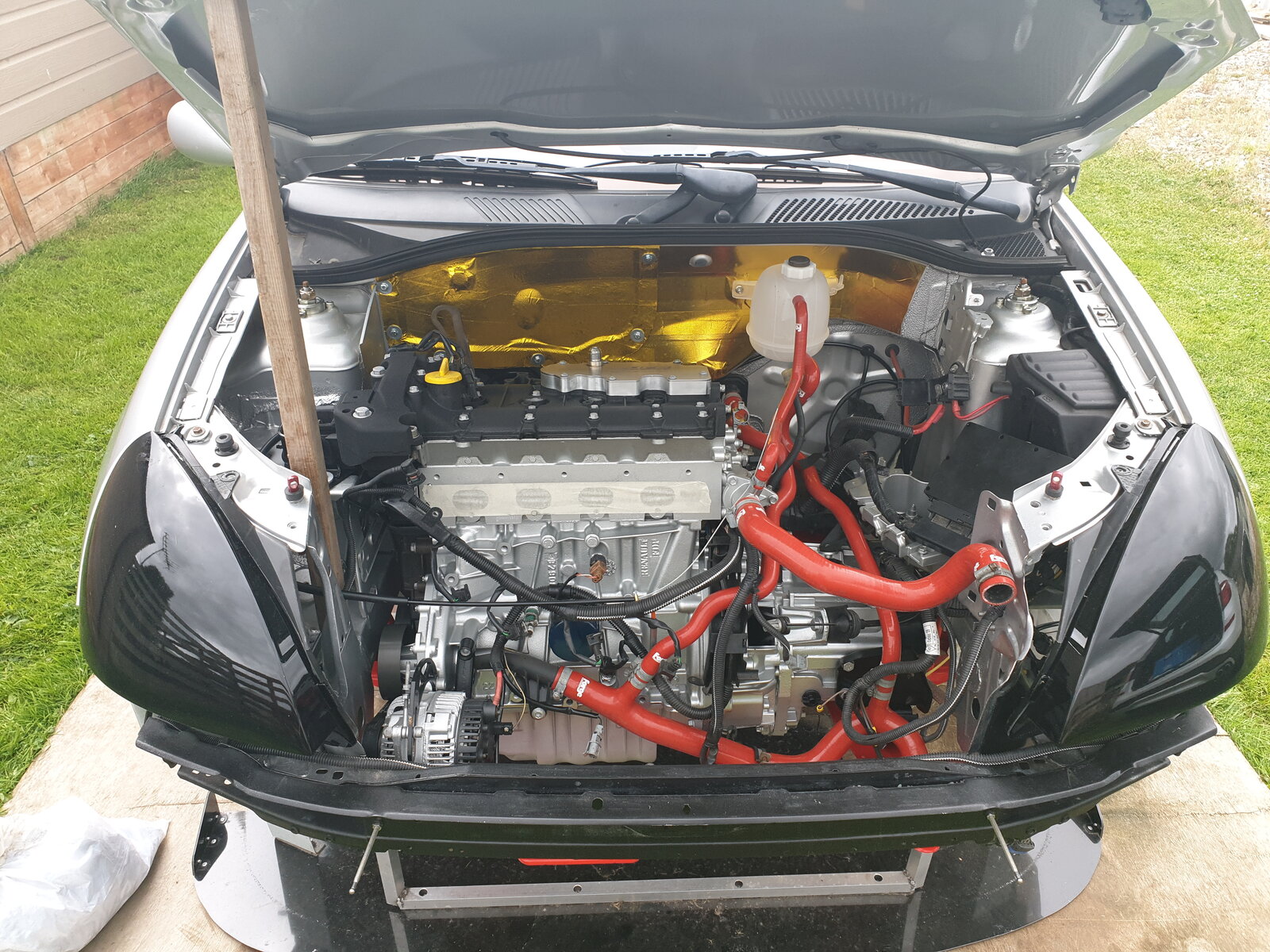

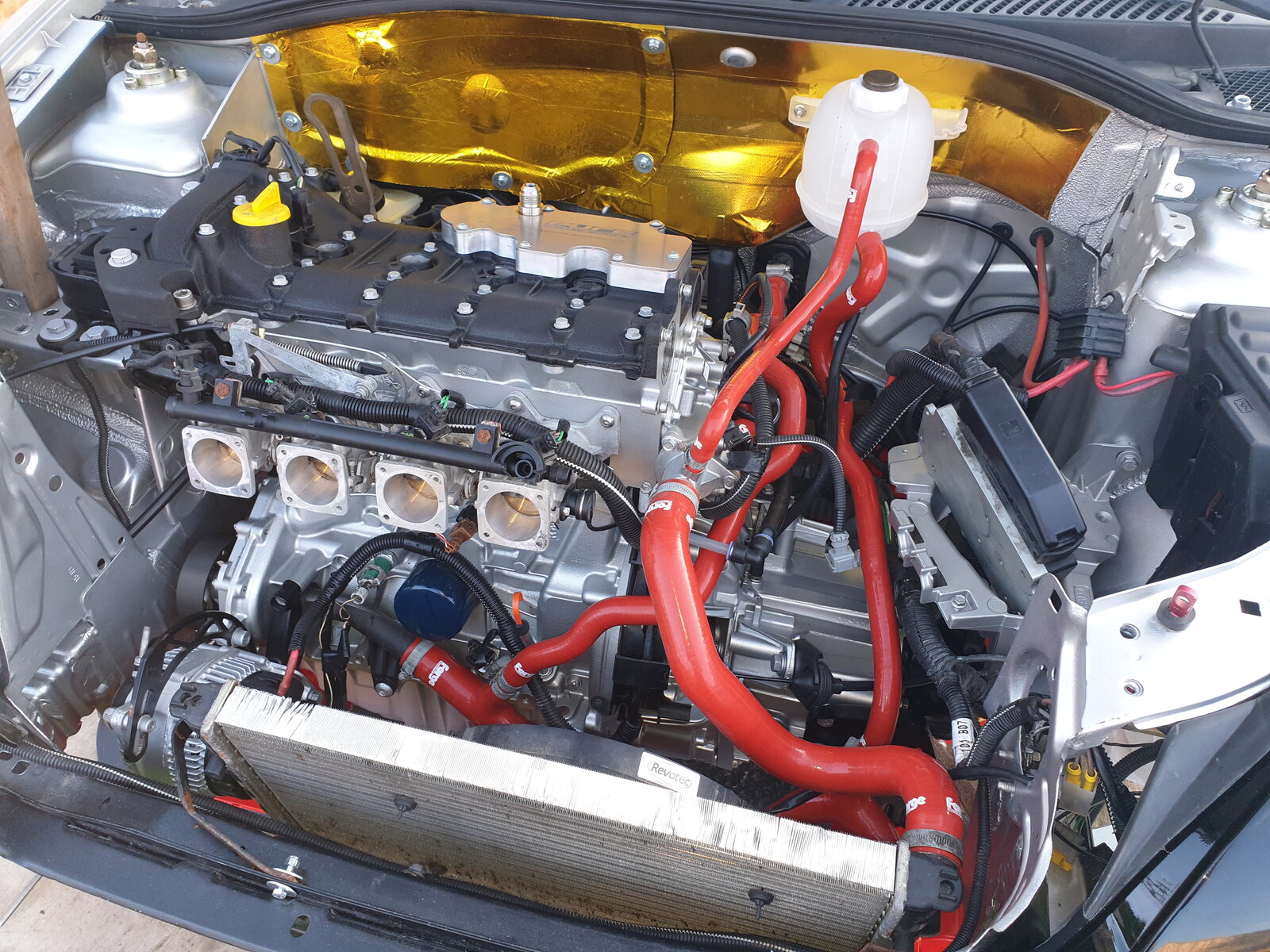

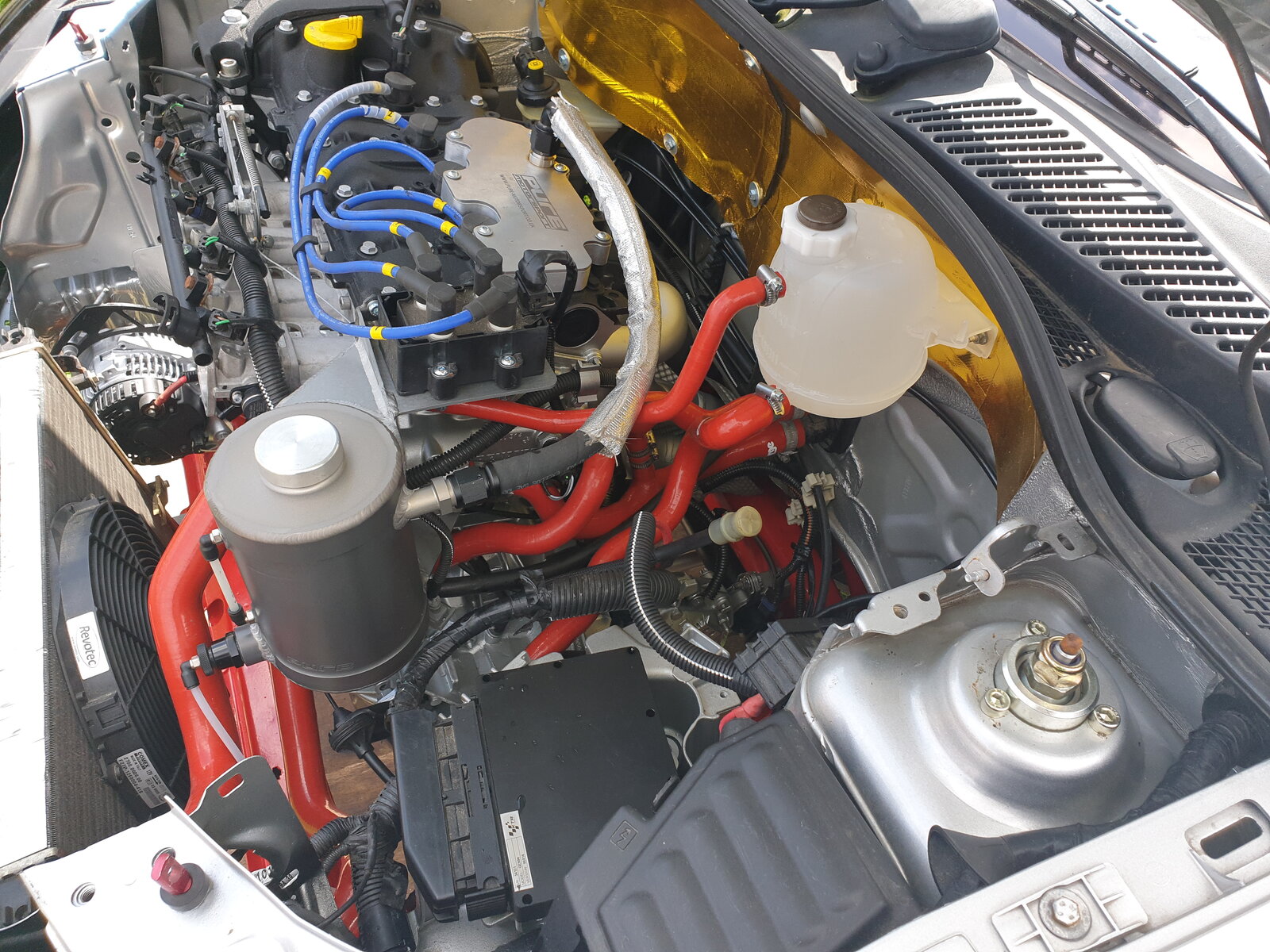

Anyway once they had gone I set about linking the coolant pipes up, wiring up and anything that I could do before putting the bodies back on.
At that stage I was going to pack up for the day and enjoy the sun but then I figured let's get it running first.
So rad back in, main part of the bodies on, I put some Redline MT90 oil in the gearbox through the wet side drive shaft hole so with the drag from the engine it wouldnt spin dry.
Threw some cheap engine oil in as I wasnt 100% sure there wasnt any grit from blasting in there, this was going to be basically run it up to temp leave it on idle for an hour and then drop it back out, change the filter and then put Millers motorsport proper oil in. But for now it was fine just to start it. Ran a brand new throttle cable to the bodies.
Filled the coolant with just water as I wanted to flush the system anyway and then gave it a crank to see if it would start. It wouldnt, after a little investigation I had left the crank sensor unplugged 🤪.
Plugged it in and hey presto!!
Taking shape nicely, happy with how everything has turned out so far.

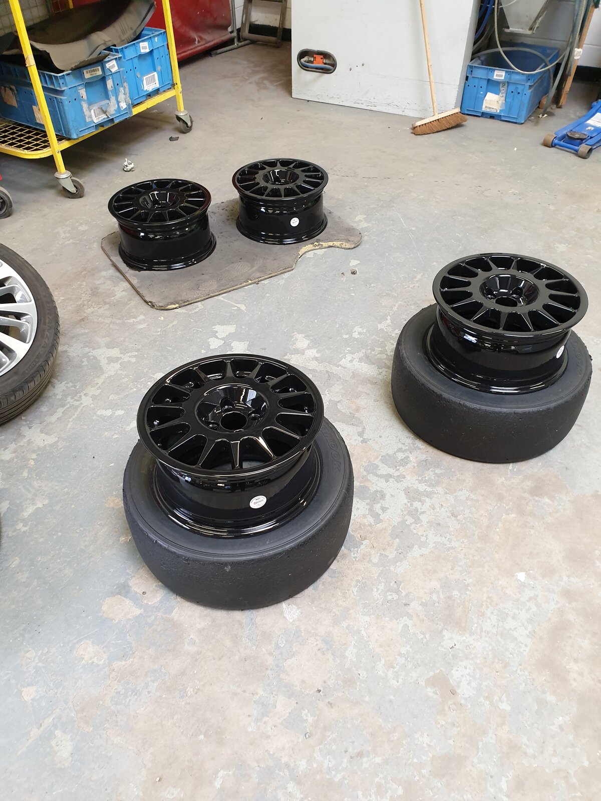

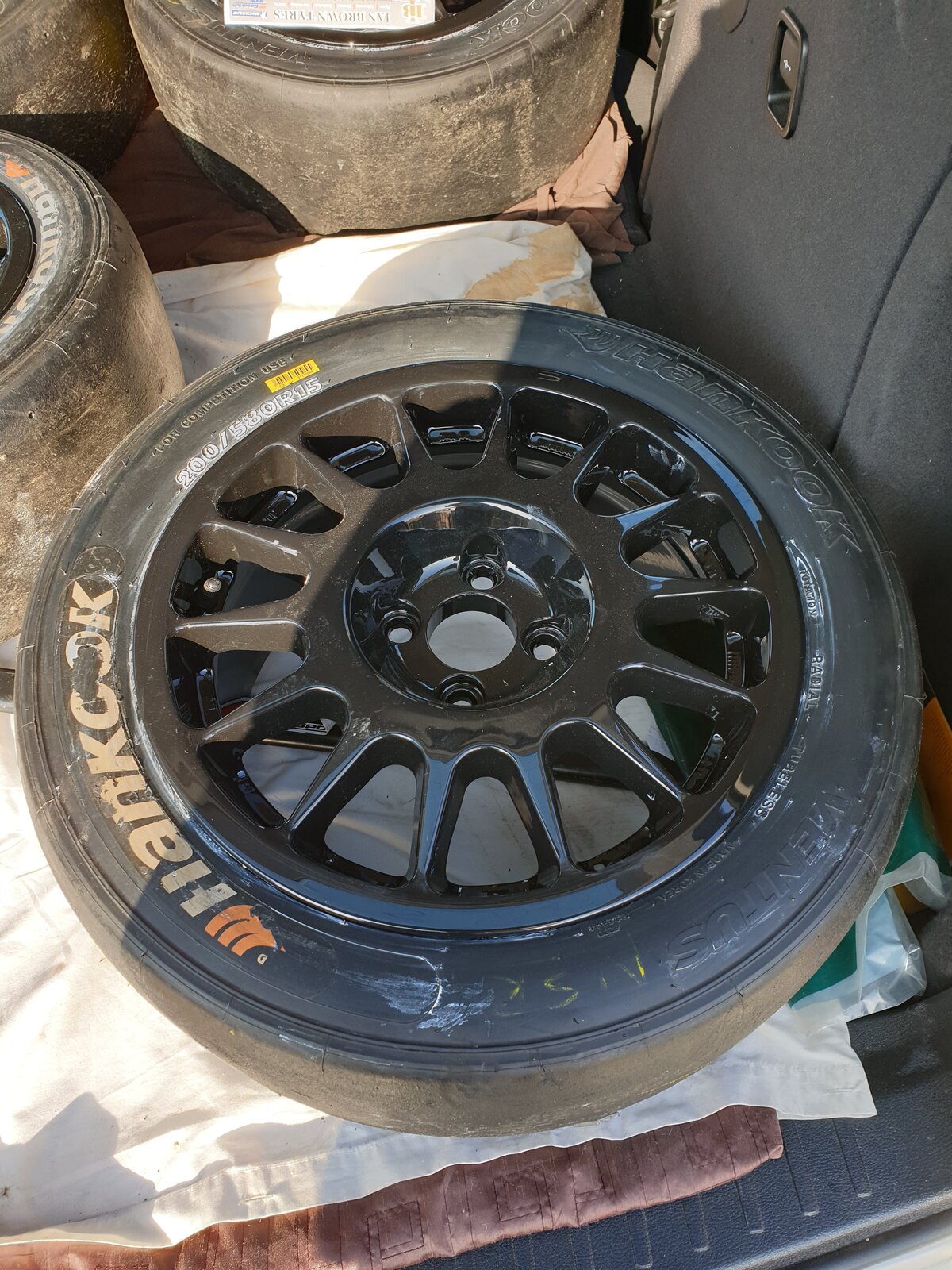

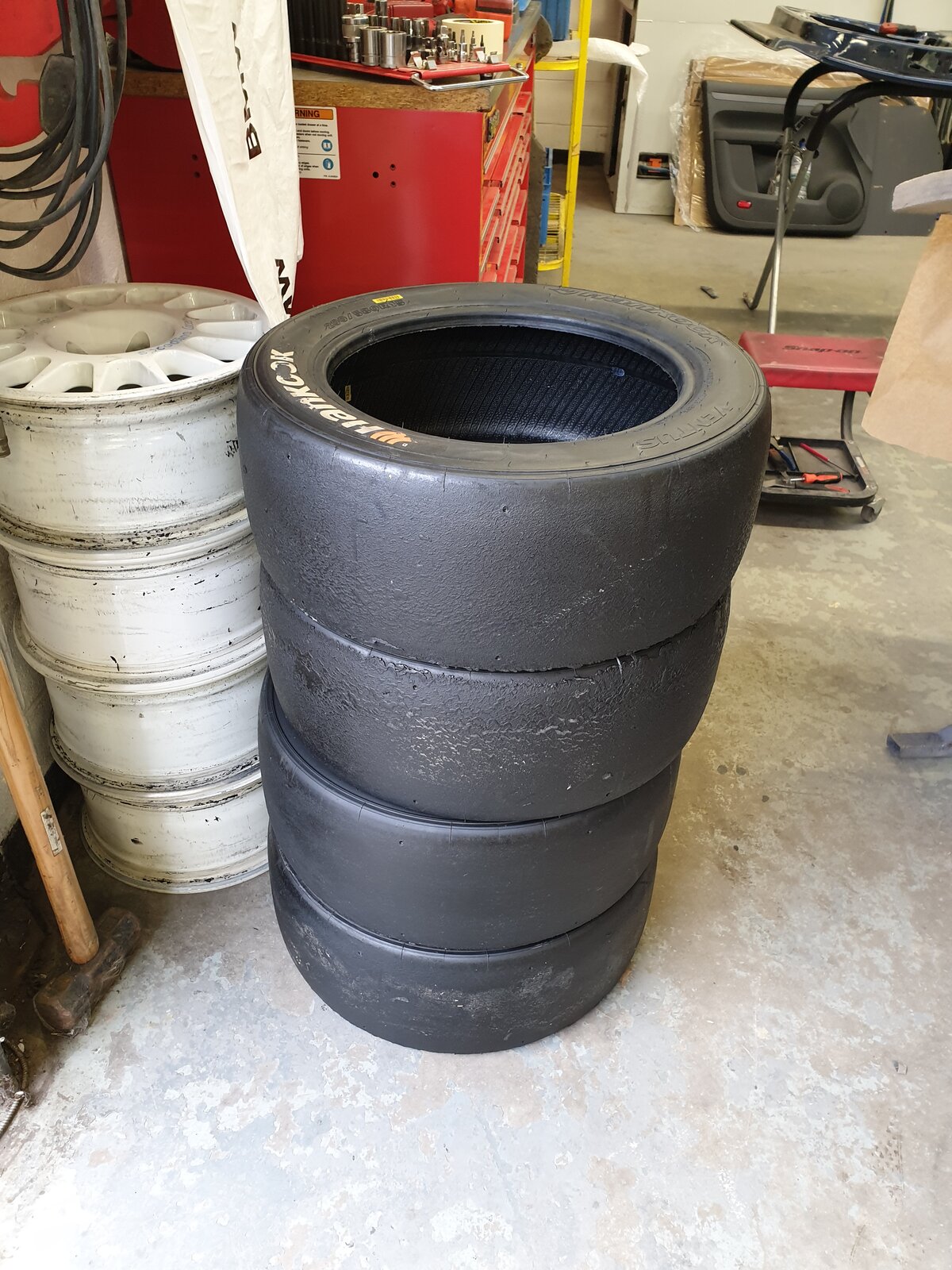

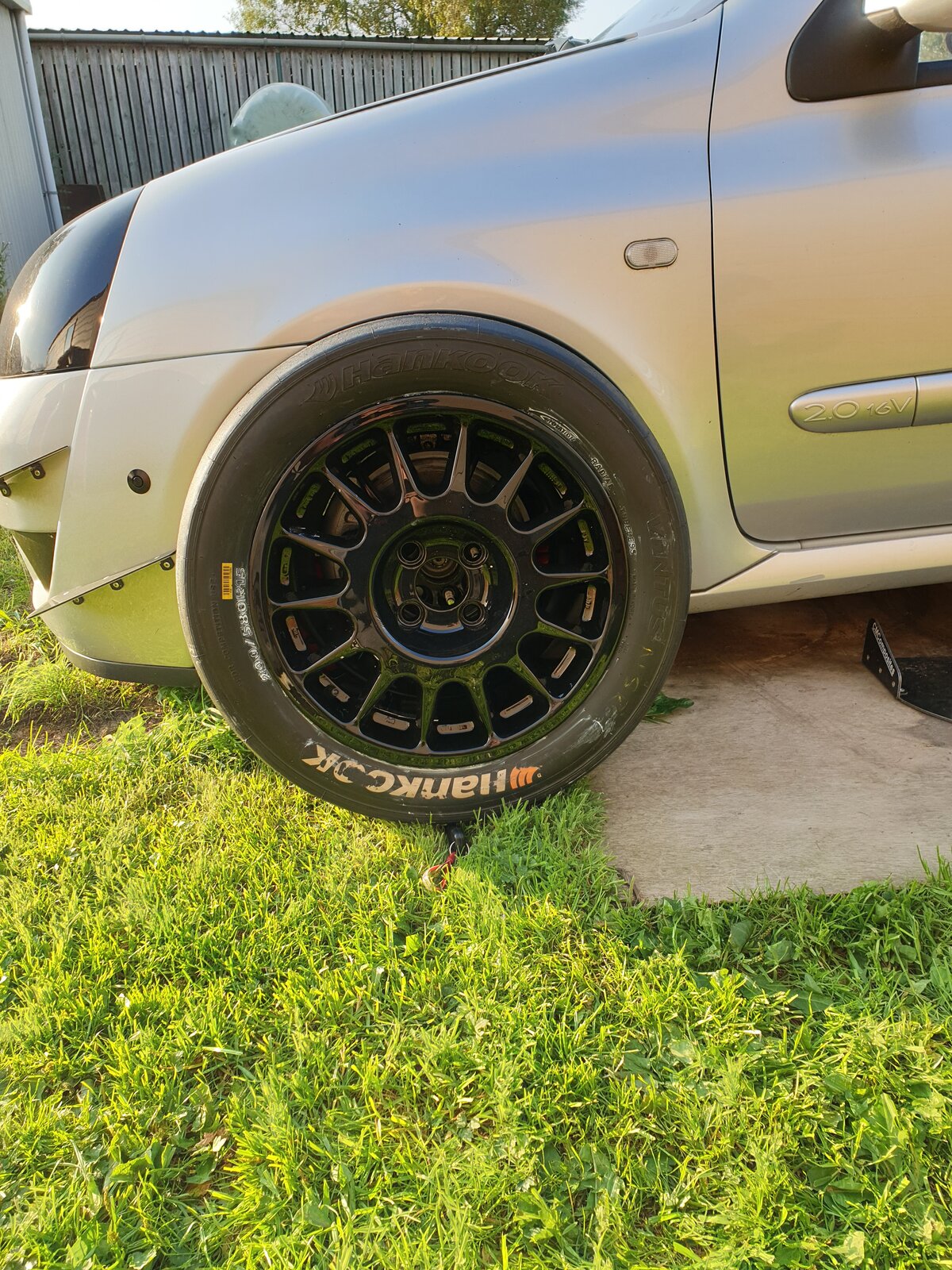

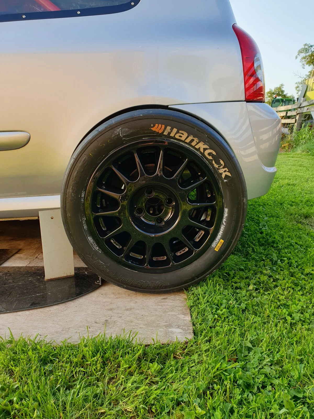

I got a set of 5 2118's in white with the car. They had R888r on 2 and AR1 on the other 2 with one loose alloy. I trashed them at Cadwell so I fancied trying full slicks. Managed to get my hands on some Hankook's, only been scrubbed in for £150 which was an absolute bargain!
So I stripped the wheels waiting for the new rubber to turn up. When they arrived the back 2 looked like they had picked up more rubber than they left the factory with!

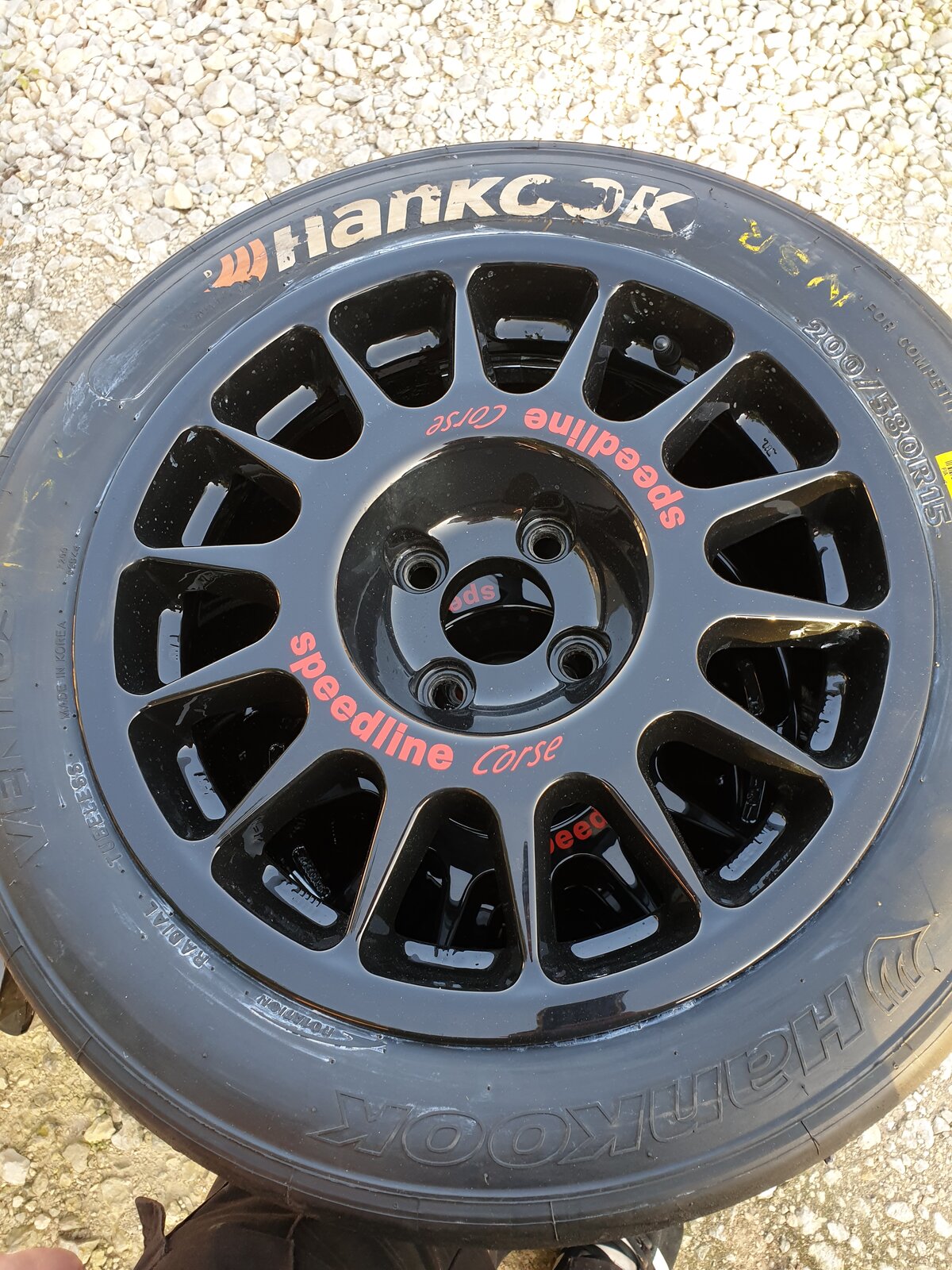

After looking over the wheels I thought I would do my car an injustice bolting the tatty rims back on to gleaming suspension components so I sent then for powder coating in gloss black,3 day turn round £150 happy days!
They turned up around 10am so I fit the rubber in my dinner hour ready to take home that night.

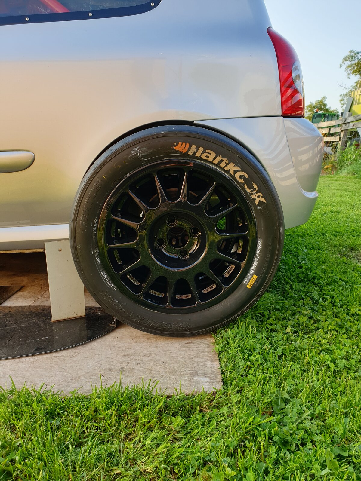

When I got home I couldnt wait to offer them up. They looked sick, but I wasnt sure if they were too big or not.
The next day the decals I ordered arrived so clearly had to fit them asap because race car. It finished them off perfectly.

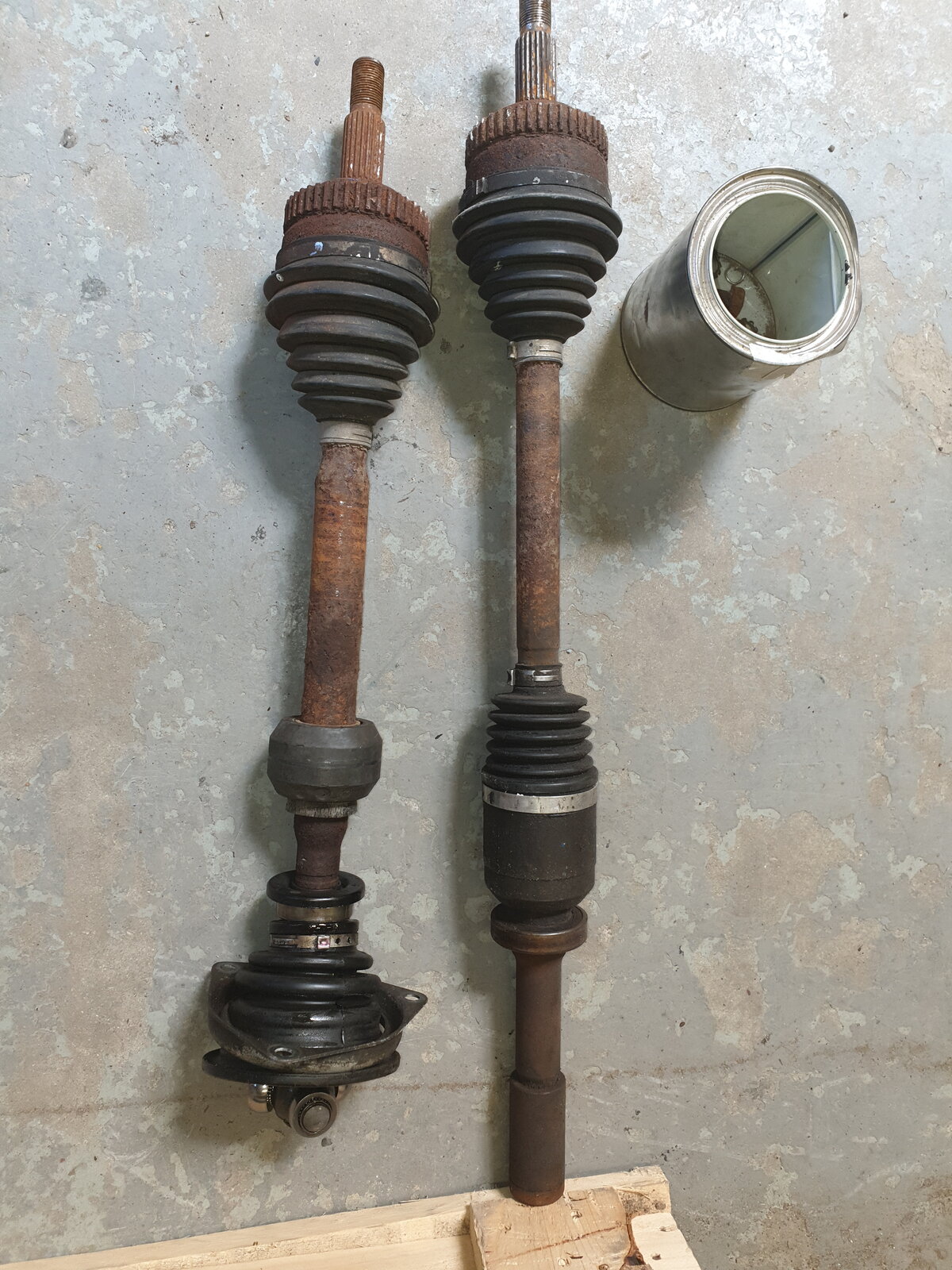

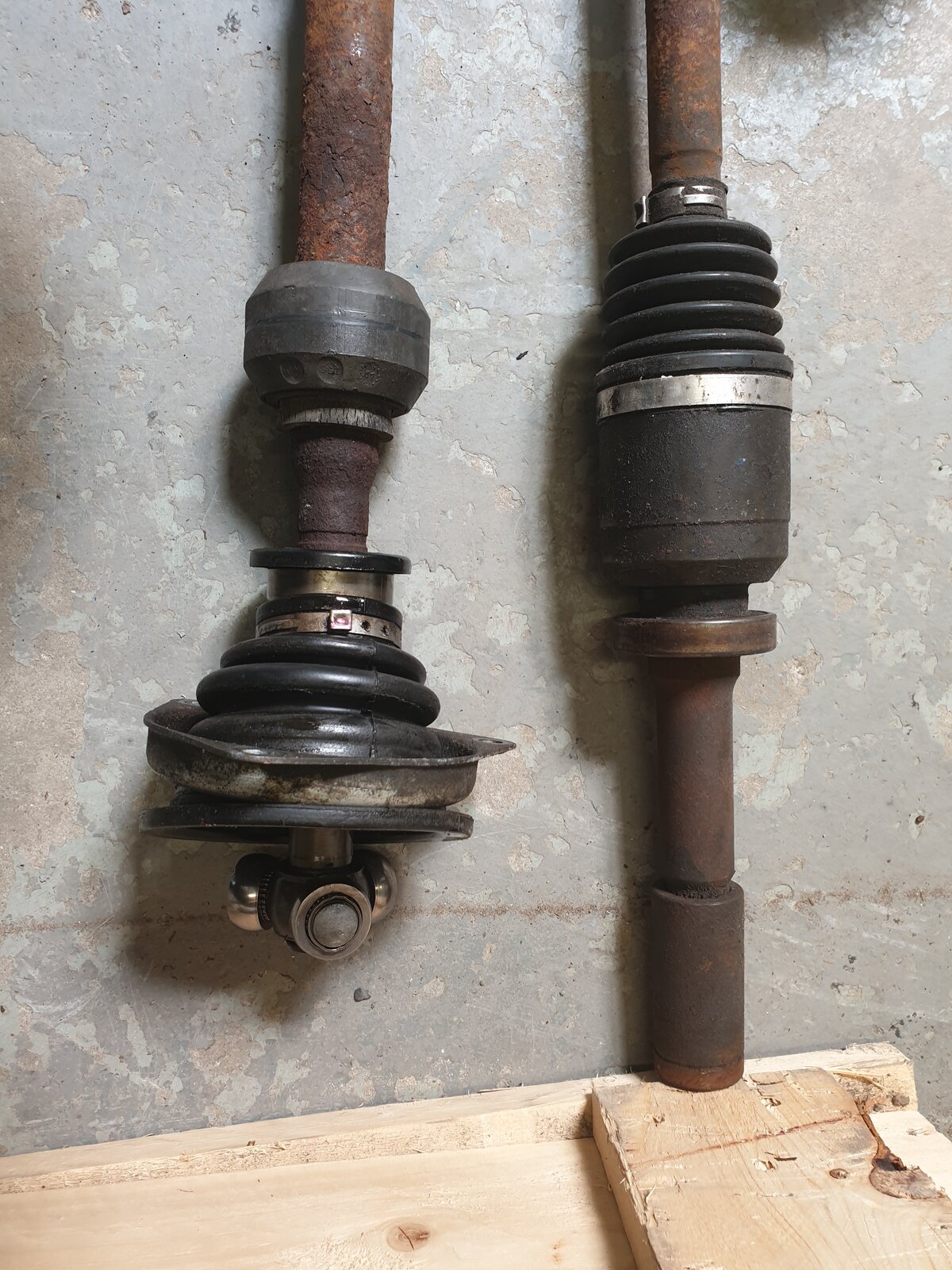

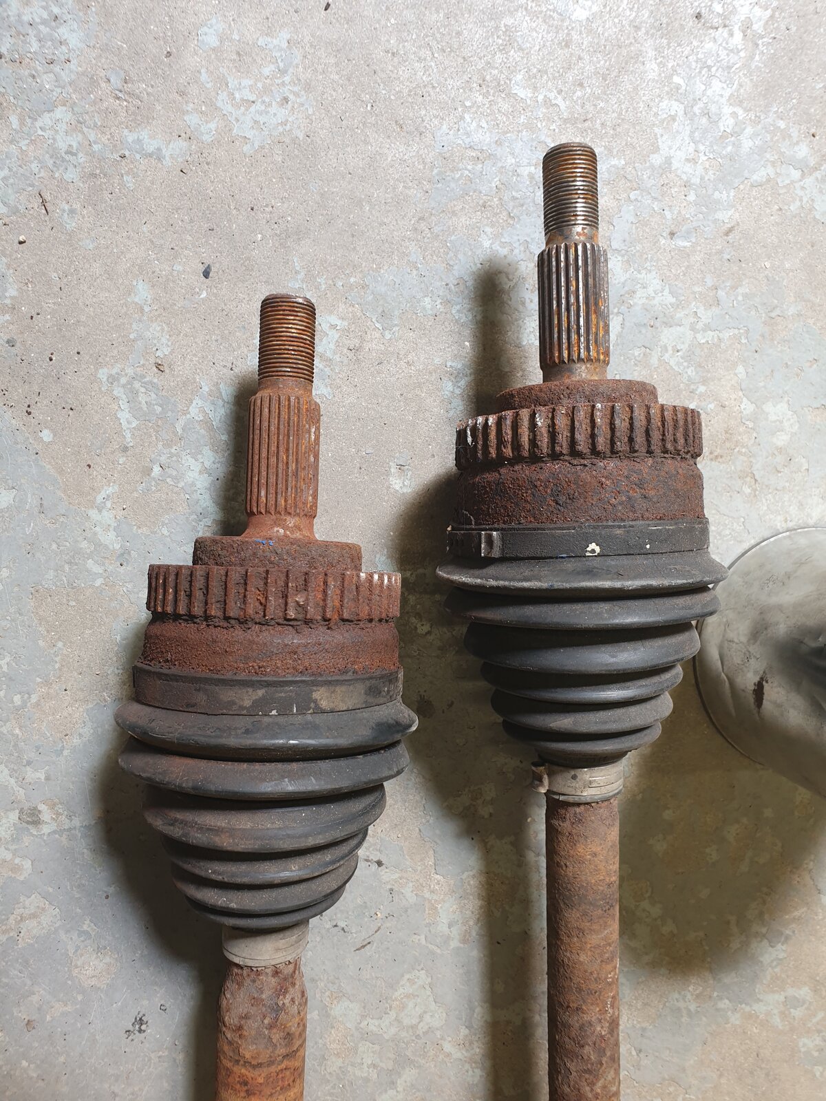

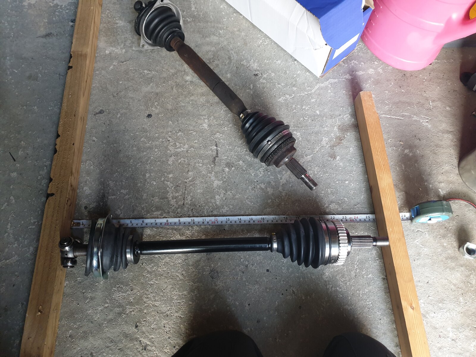

My drive shafts were pretty minging, 15 years of rust. So I sent them to Pages to be reconditioned. I explained to the bloke "I want these genuine shafts back not some cheap copy product that's already refurb off the shelf" clearly went in one ear and out of the other. If it wasnt for me taking pictures and measuring them I wouldnt have known any difference. But I knew they weren't mine so sent them back and made them find mine. Took 2 weeks to get them back, morons!
They were in a pretty bad way I couldnt put these things onto my shiney new front end.
Looked good but they weren't mine, note no weight on the wet side shaft which made me then check the length. Cant kid a kidda!

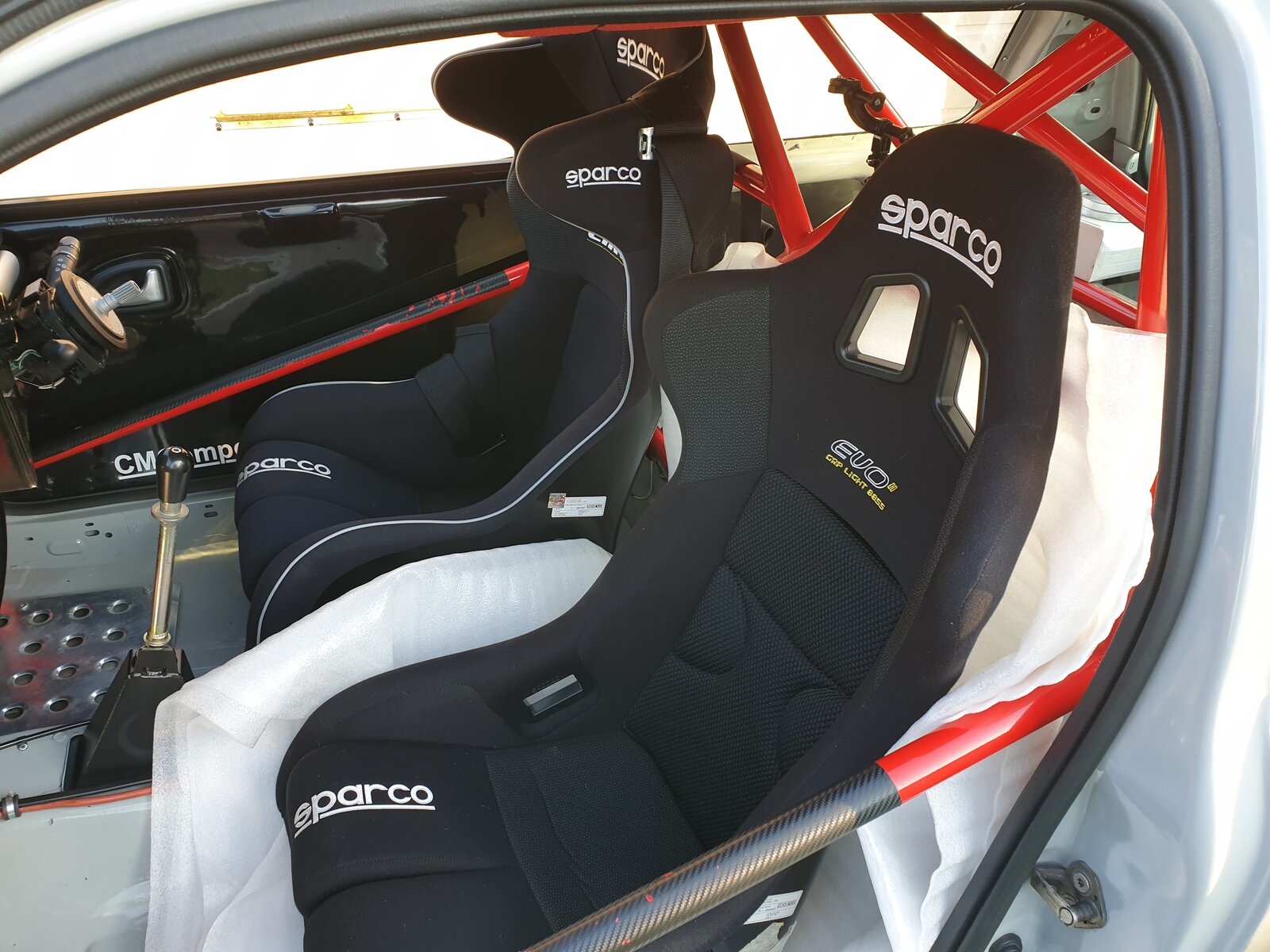

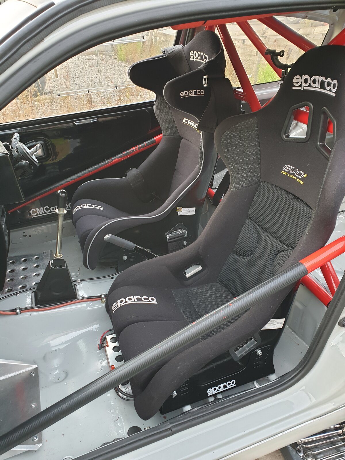

Ebay, great tool but I only for certain things. Most of its crap but those little gems you find like a brand new Sparco Evo2 bucket seat for £180!!! Couldnt resist, not a mark on it, same style as my drivers seat without the wings.
My buddy was going to pick his Box up from Northloop and whilst he was in Litchfield he collected the seat for me.
Spent a night after work getting it to fit nice. Obviously had to buy the same Sparco side mounts to match the drivers side.

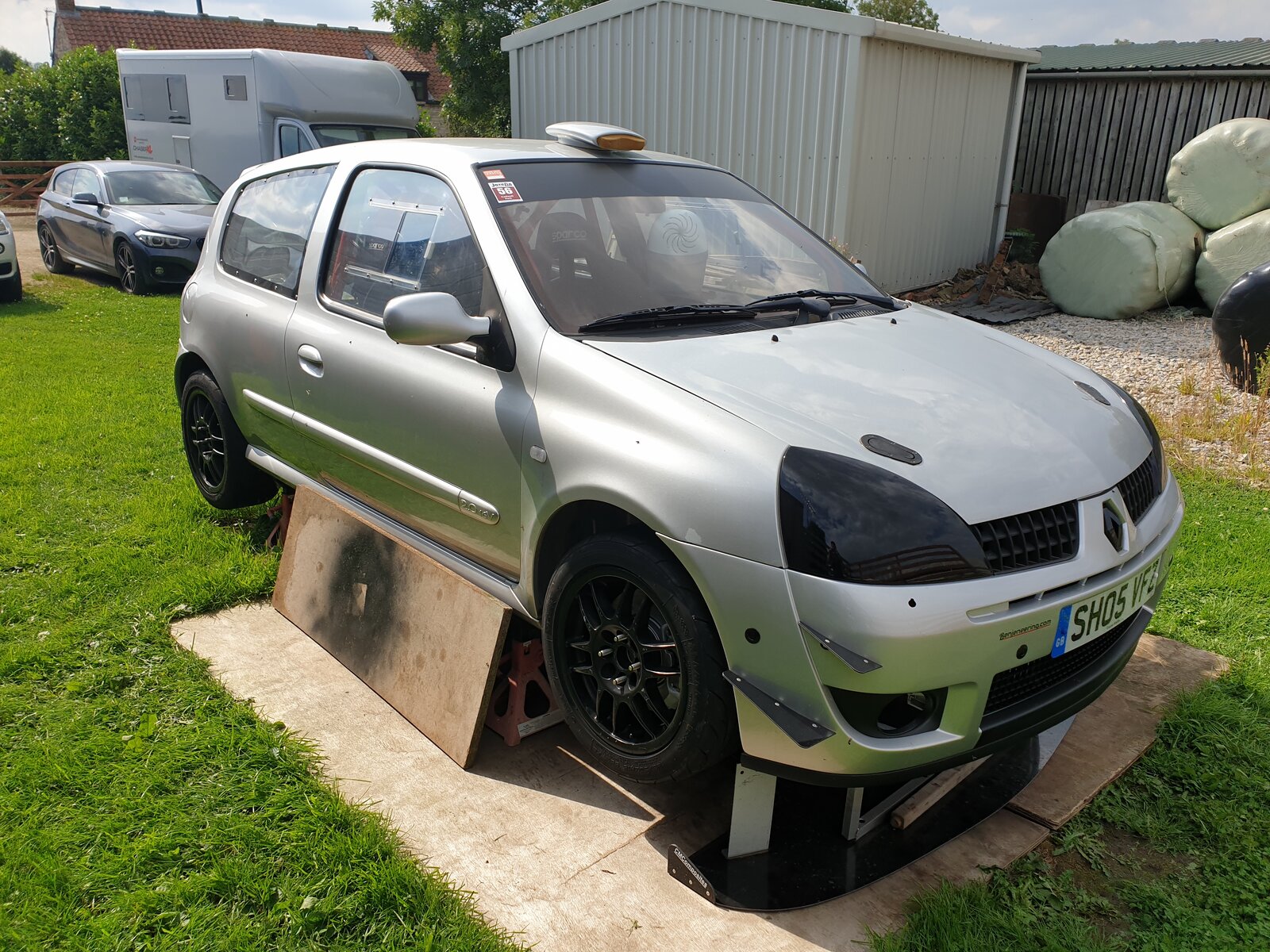

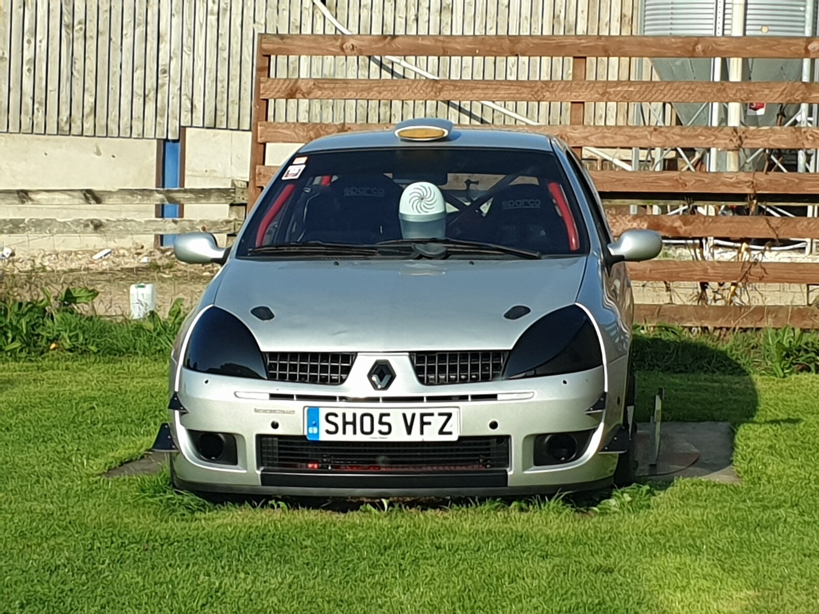

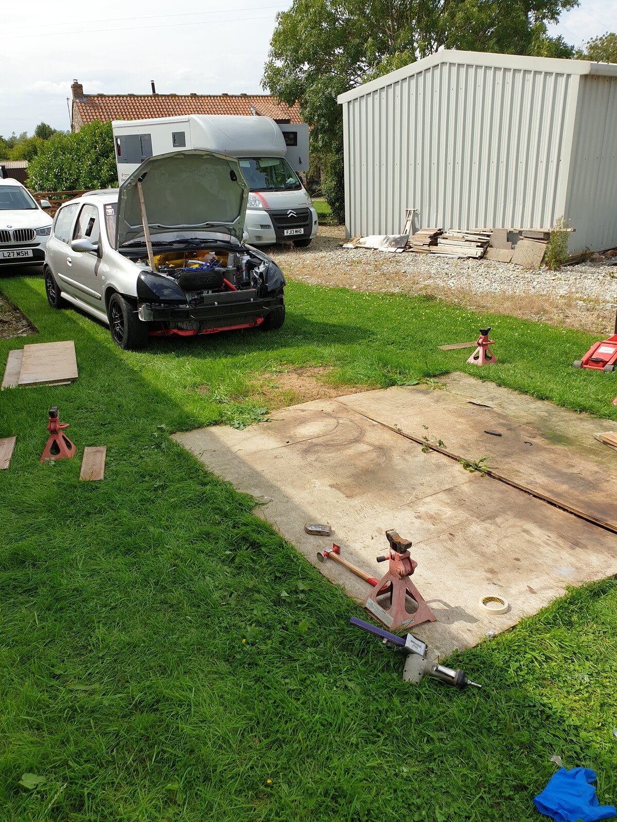

So that was the interior done and dusted next I slide the exhaust into the nice silver 182 manifold, attached the spring that hold it together which completed the under side. Bolted the wheels on and dropped it on the ground!
Actually able to drive it!!
I took it up the road and back maybe a mile in total just to check the brakes, the EPAS that I hadn't even checked worked, no rattles or bangs.
Sat there looking all smug with itself and like a car again!

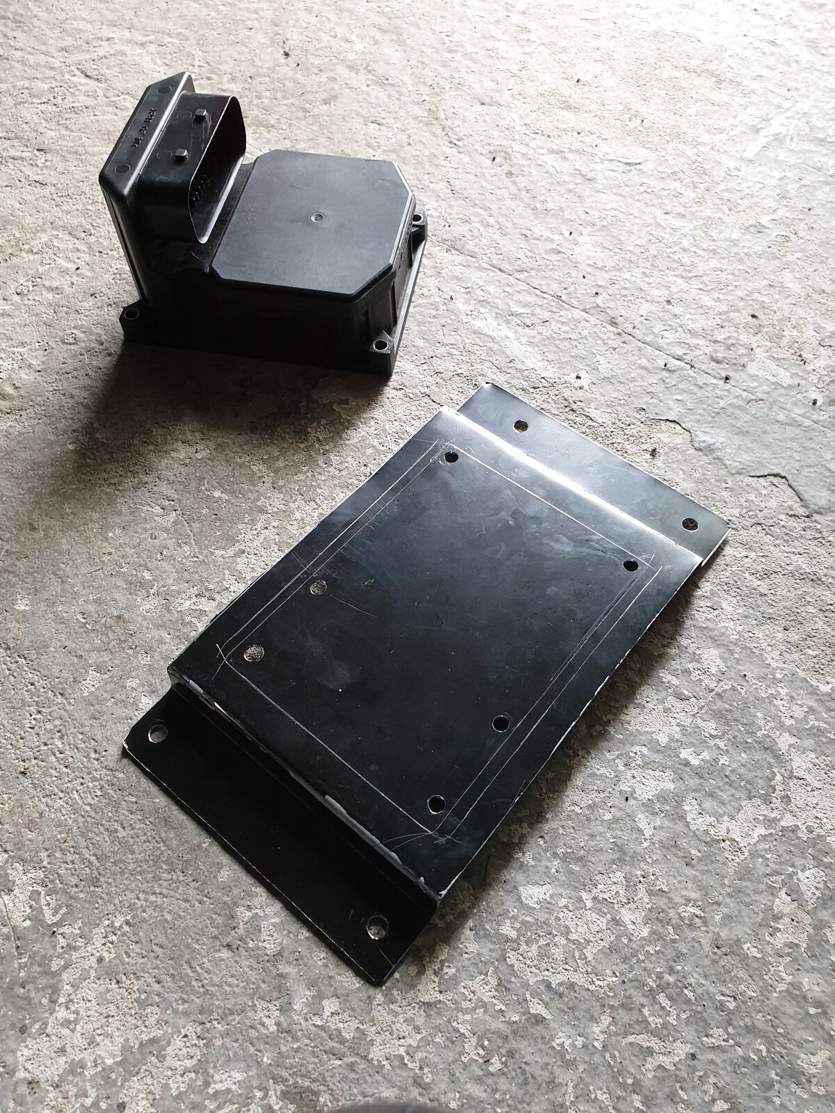

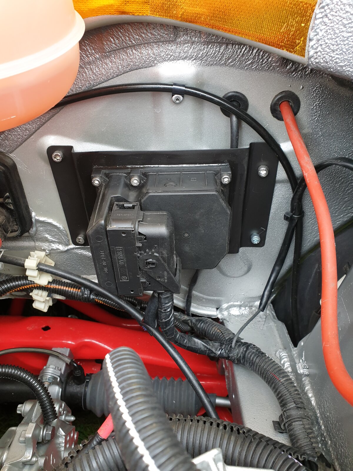

🤔 Then I realised I had quite a bit of work to get it ready for the MOT so I made a start on making a bracket for the ABS ECU to mount onto. You need this to run your wheel speed sensors for your speedo, I tried running just one front sensor but it only read 50% speed so when I was at 60mph it was only saying 30mph so I had to buy another front one for the other side which fixed the issue.

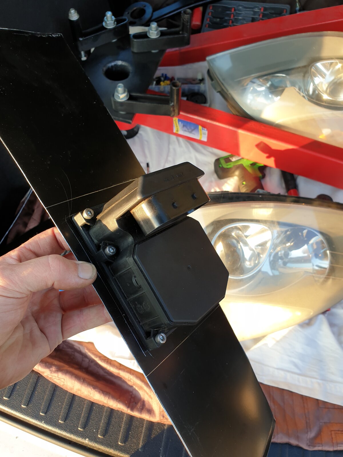

Started of with some sheet steel. I scribed around the ECU and then added 10mm for my fold lines. I centre punched the 6 bolt holes I needed to drill and then test fitted it before I did my bends.
Next I made two 90° bends at each end and cut the excess metal off that I didnt want. Drilled 4 6mm holes so I could attach it to the car and test fitted it. I rounded the 4 sharp corners off, sanded the full bracket and gave it a quick etch prime for the bare metal and satin black to finish.
The only place I could mount it where the wires would reach was on the bulkhead below the coolant header tank. It worked well tucked out of the way and looked neat enough. I ran a thin bead of seam sealer around the edge of the ECU to seal it against the bracket to stop water and moisture getting in and job done, works a treat.
