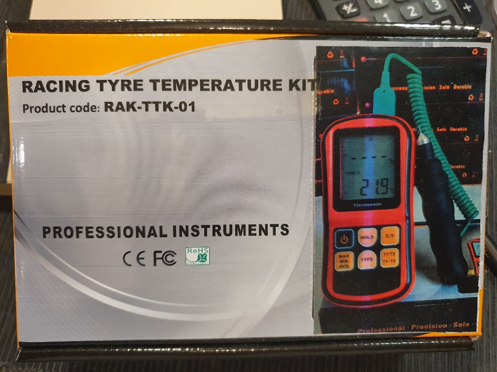

Sorry dad, I was thinking about next trackday I'm going to take the thermal laser from work with me so I can see what the crack is.
Ive bought this to have a play with
Sent from my SM-G977B using Tapatalk
