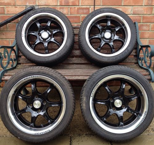

I was getting bored on my white hub caps so i started looking around for some white alloys, i could not find any 2an hand white 4 stud alloys so i found a cheap par of wolfrace eurosport alloys but they where black :(
What they look liked when i payed for them

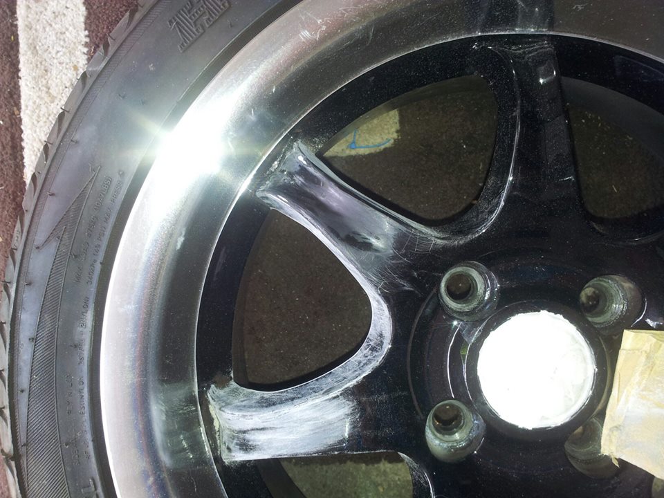

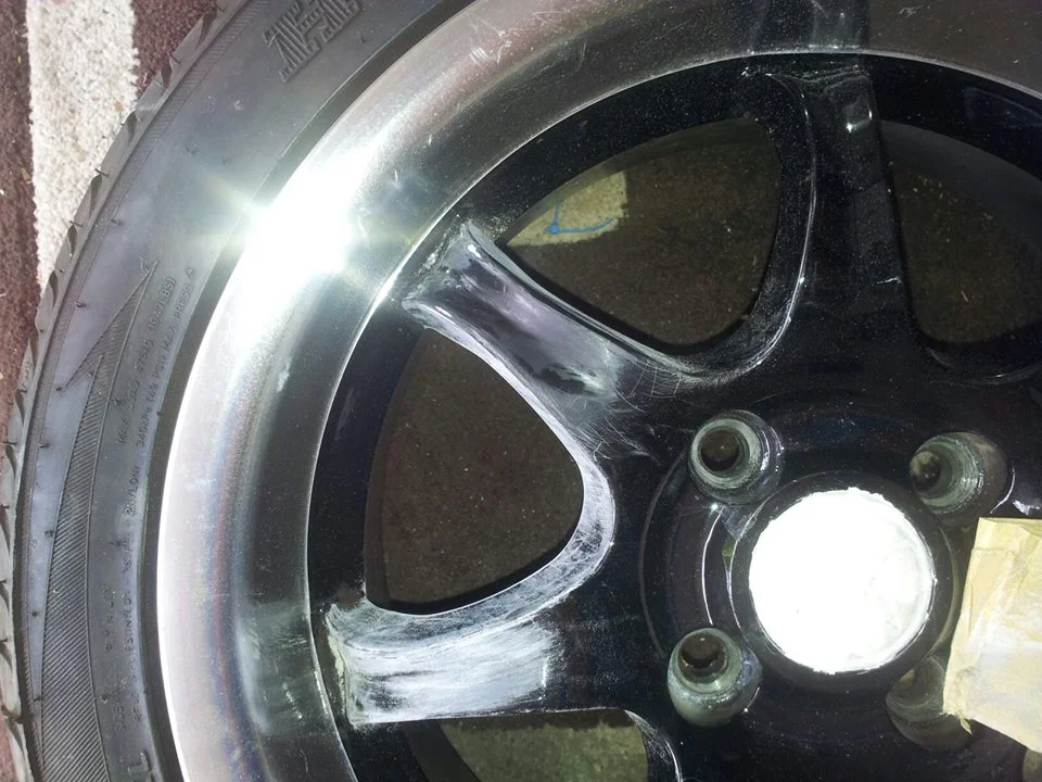

Sanding all the black shine off the alloy

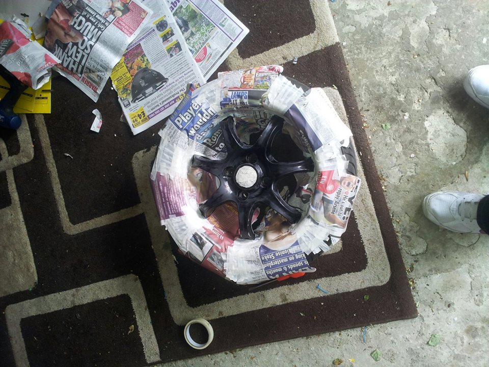

Taping the wheel up for over spray

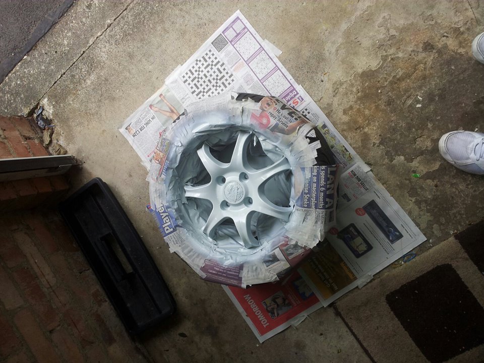

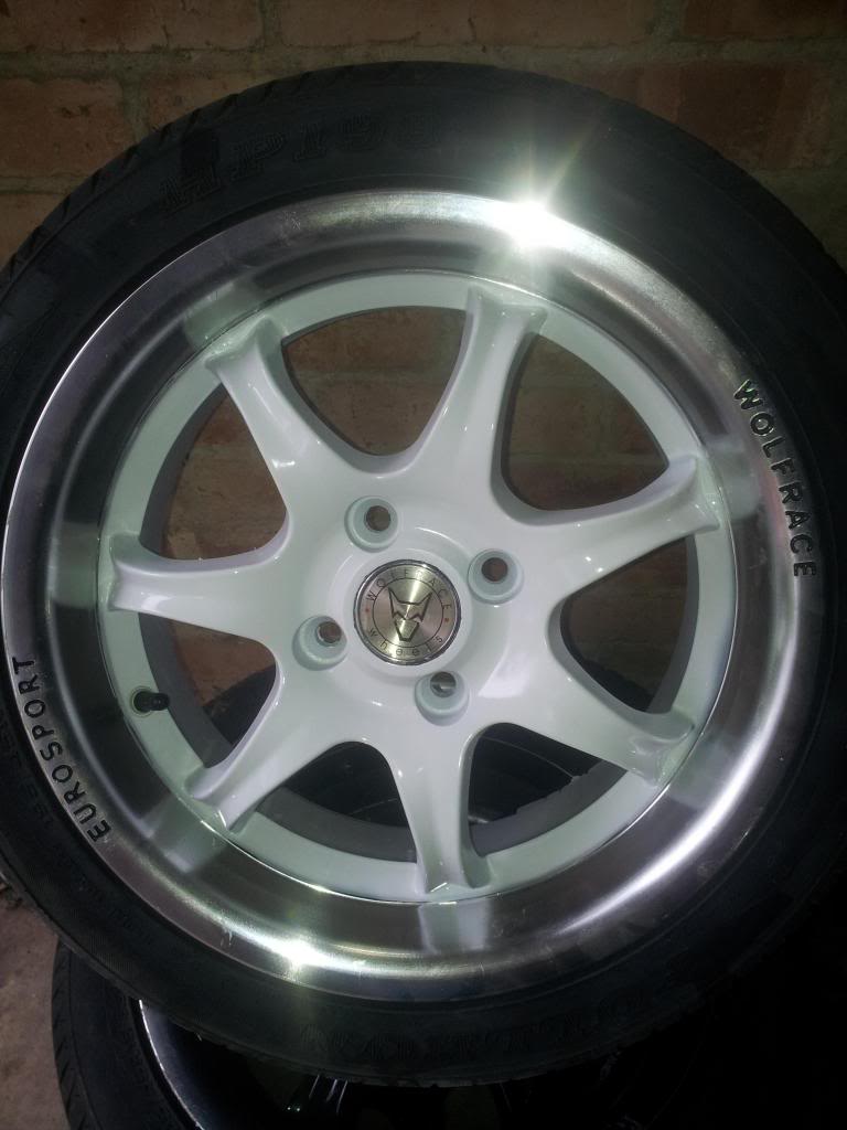

After 3 lays of primer, 3 lays of white and 1 coat of lacquer
Finished product

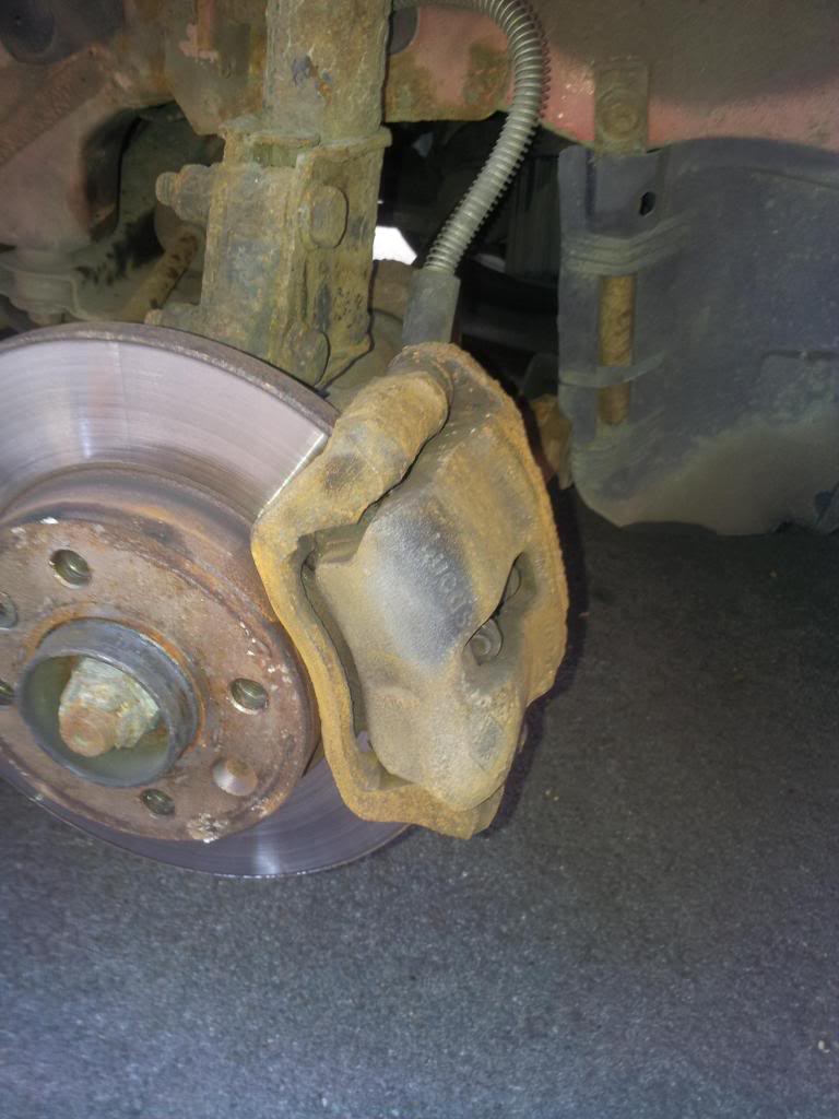

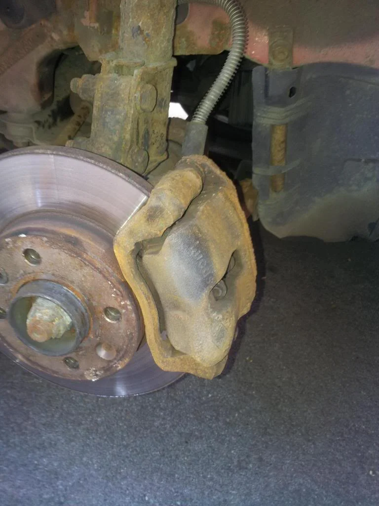

So then i put them on the car and seen the brake caliper look basically s**t lol so i had to solve the issue.

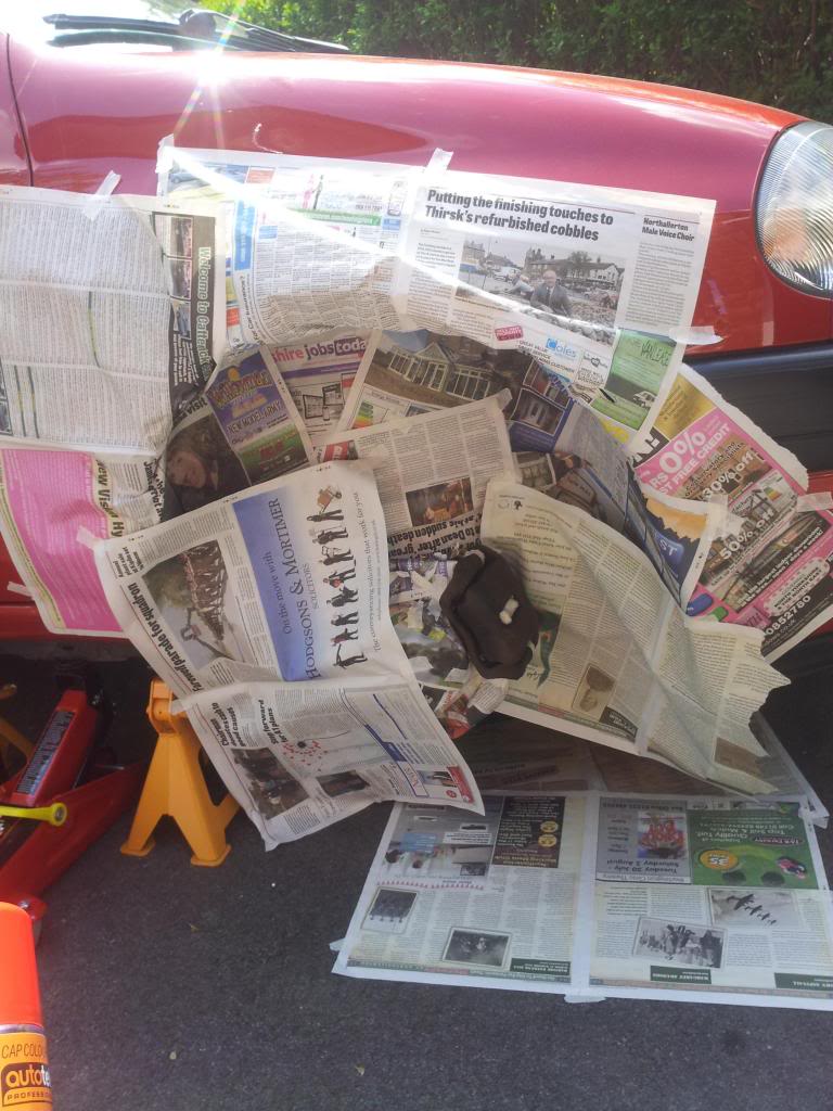

Cover up for over spray

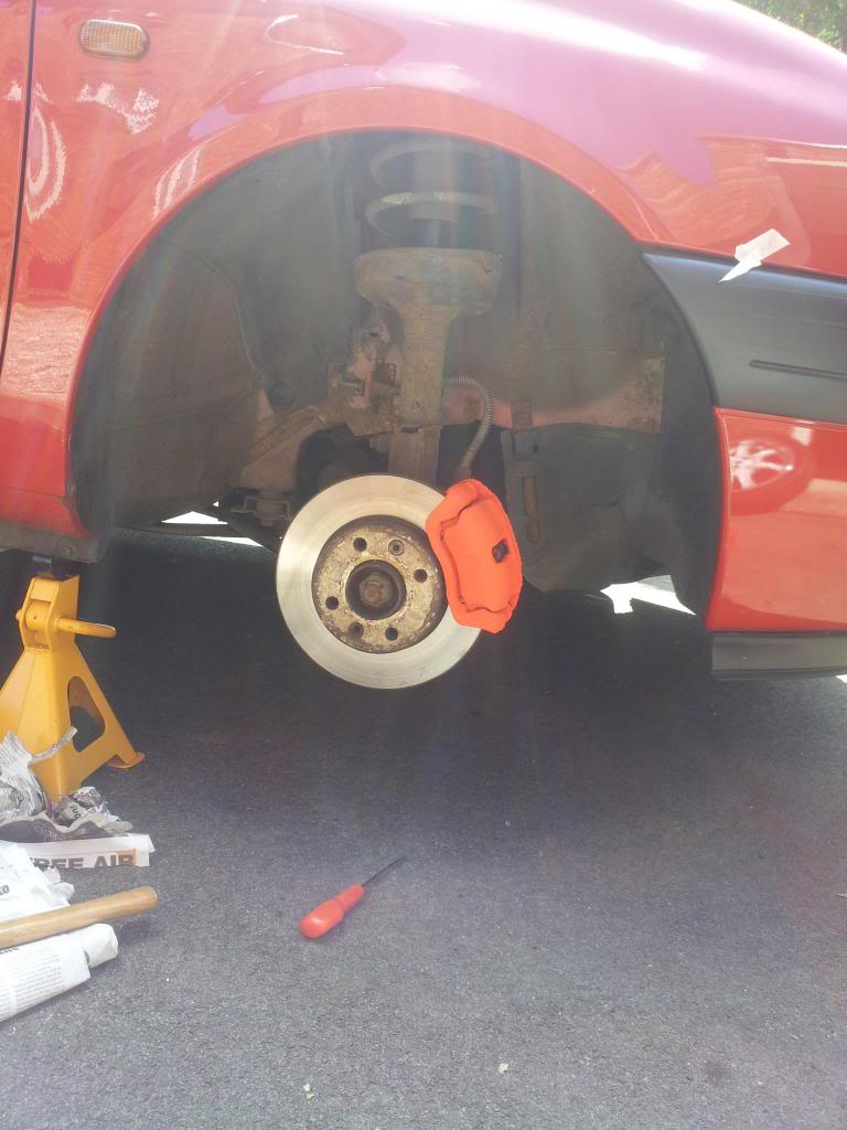

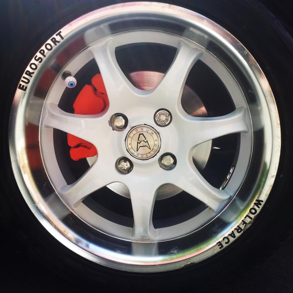

The finished deal

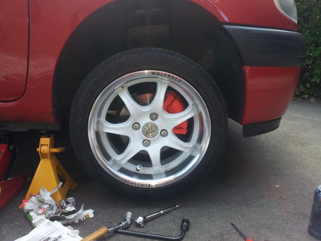

The finished product looking fab

Shame you scratched them bolting them on. :(
​Good job though!
If you're worried about scratching your alloys when taking them on and off get a nylon coated socket.
They're pretty good tbh :)
Hey that sound fab, may i ask where you get them, them only issues is the locking nut adapter as its quite big how do i get around that.
