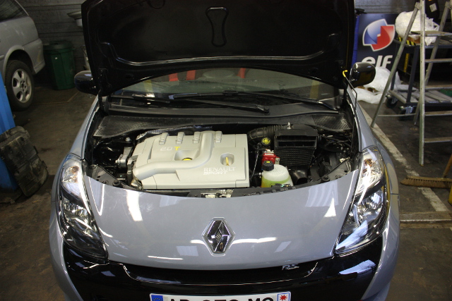

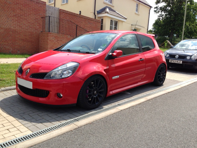

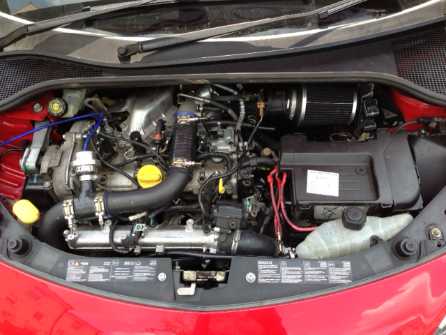

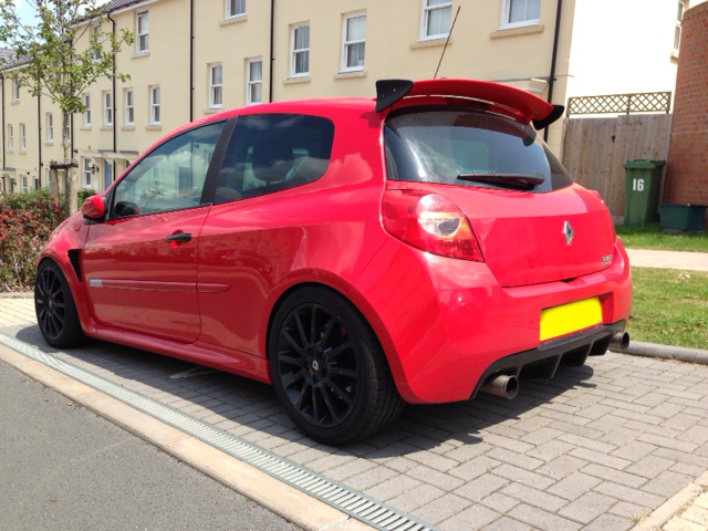

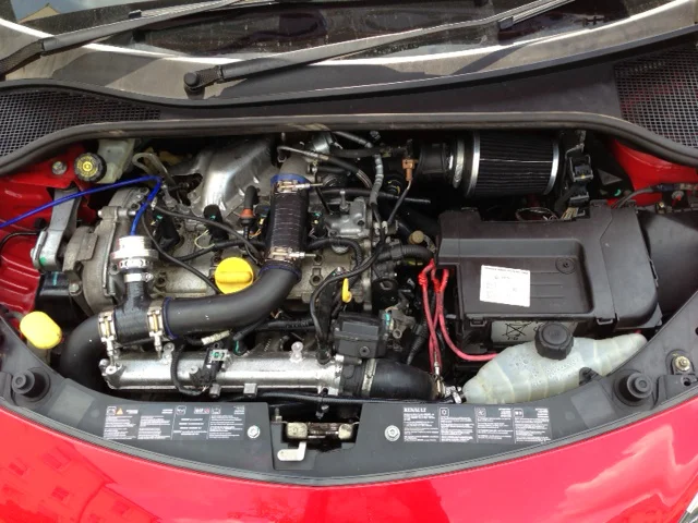

Hi there,
After my first Boosted Lunar Grey Clio 200 (Forged R26 engine, 300bhp)
I'm coming back with a new one. This time it's a Clio 197 :
Sport Cat
Custom Exhaust
Custom Intercooler
Forge Dump Valve
Megane R26 engine and Gearbox

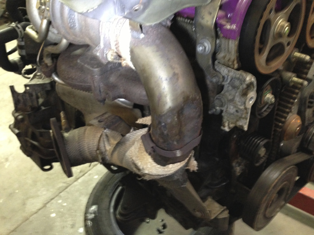

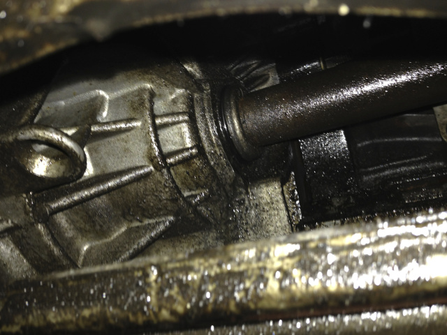

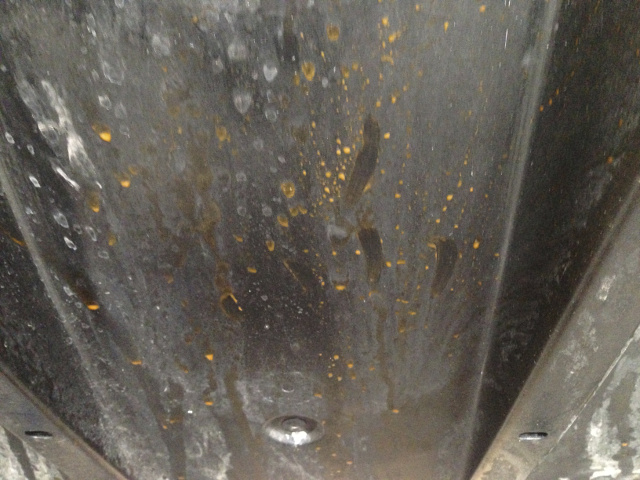

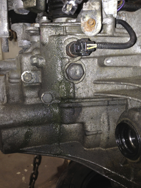

The car was already swapped when I bought it. But I had to do it again because that day I bought the car, It seems that I was blind :(

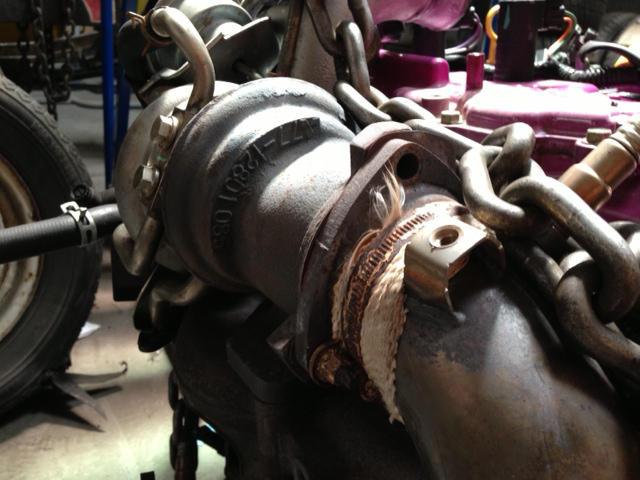

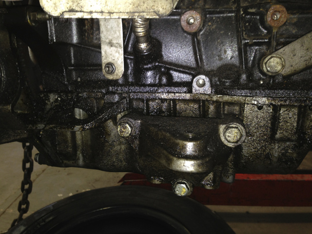

Lot of oil in the back of the car, coolant in the rear diffuser
Screws missing, lots of things not tied up
Decat

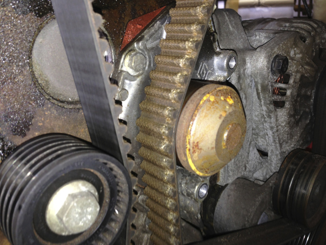

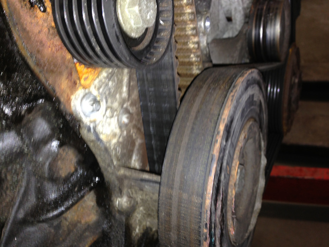

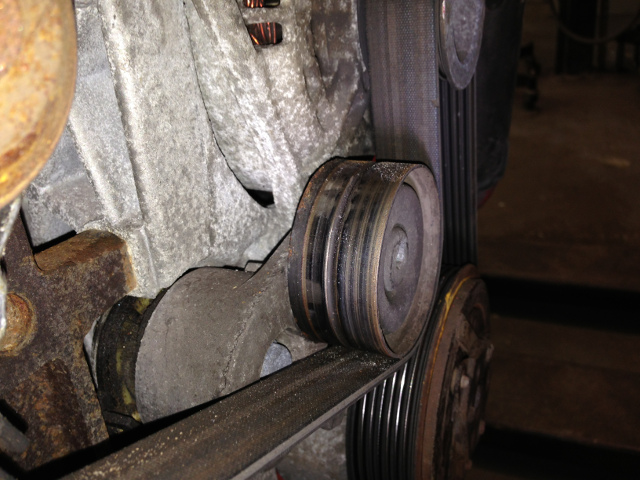

Cambelt (supposed to be 1 years old and 5000 miles)
Water pump was made on 01/2005 !!!
The two axles where dead
And other things where going wrong.
So I decided to replace the engine (the new one is 7000m !!!), Turbo (7000m), brand new axles, Auxiliary electric pump (it was missing from the previous engine), new injectors, spark plugs, Sport Cat...
After 4 days of hard work the car was finally rebuilt !
Now it's Racetrack ready :evil:

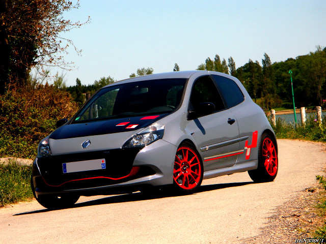

I recognise both of those cars, why did you get rid of the 1st one? :(
  Clio Turbo
Thanks mate !
Wanted something different ! I was missing comfort ! But the principal reason is that before, I was living in France, and swap is illegal ! So every time I was seeing policemen I was scared !!! :S

Yes I loved my Lunar Grey Clio ! But was to risky to drive it in France :(

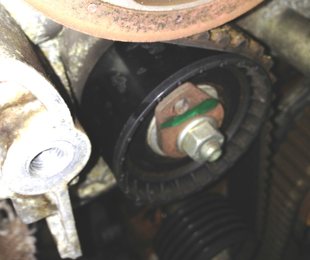

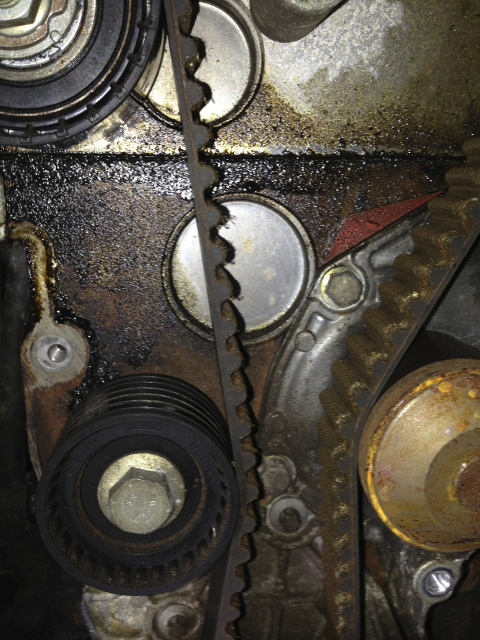

Yes that's a shame but I'm responsible of it ! I should have check it better than I did ! The only thing wich piss me off is the cam belt which was supposed to be 1 year old and finally was approximately 8 years old. All the engine supposed to be rebuilt last year but finally it seems that it wasn't !
Still need to do some improvements. 70mm exhaust, Megane coolant radiator, Oz ultrallegera, Recaro sportsters. It's going to be great :p I hope :clown:

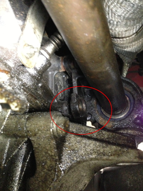

That's what you get for using genuine belts, ahold of banged a continental on, yes car has had some faults mainly because it got used everyday both on road and track, as I always said its not perfect and that was to be expected, I was unaware of leaks of any kind but oil level was always correct as well as coolant so I wouldn't really be looking for any, glad it's all sorted now though anyway as it is a great car, the car was always built to a high standard and no corners cut the only bit that concerns me is that the shaft bolt missing?,

I bought a swapped car, so it was obvious that it could have had some problems. But that's much much more than I expected. Only two miles after leaving your place, first problem, I couldn't accelerate because of misfiring. After changing the fuel pump it was all right. Cruise control ? Not working (my fault I should have try it when I checked the car), but that's all right I know what is the problem ! For those two points all right, I trust you about the fact that you never had any problems ;-)
But the next day, oil on my car park, on the back of the car, coolant on the rear diffuser, car was overheating after just 10 minutes of slow drive. The fan was turning on every time (at 103 104° and it should have turned on at 98°, but for that it's ok, it was electrical problem and was a bit complicated, I needed 5 hours to make it work correctly).
For the axles, I didn't noticed any noise neither , so that's all right for that too. There was a big slack on both of them so it was going to be dead soon.
But what I still can't explain the cambelt and aux... Everything was in bad conditions, the water pump has been made on 01/2005, so don't tell me that you change it !
I spent 3000£ to repair the car. Now it's all right, that's the most important thing ;-)

There's no way those belts are only a year old. They are in a worse condition that the 5.5 year old ones i took off mine a couple of weeks ago!
  Clio Turbo
Yes, even if the water pump was put on the car years after it's been made, the belts would have never been in those conditions ! both of the belts are not only worn but damaged ! But now I've got new ones on my engine so everything is all right ! But the previous belts could have broke at any moment...!

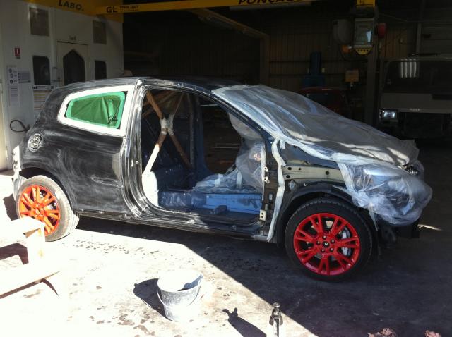

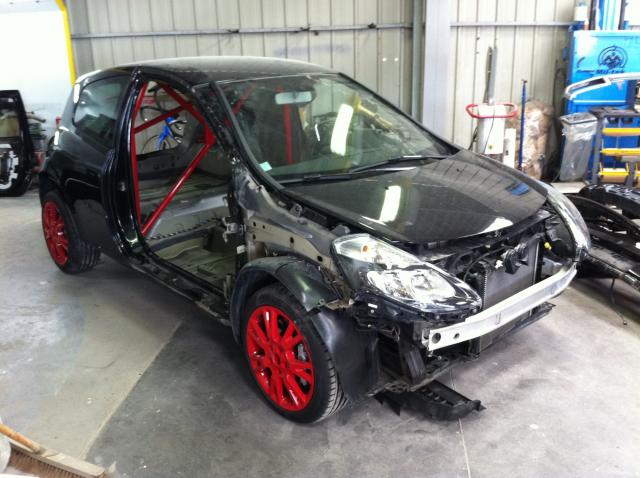

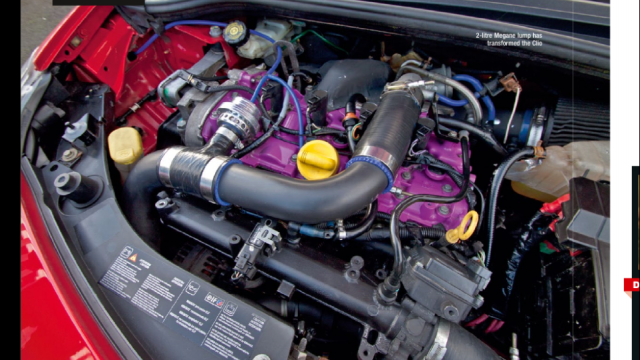

I built the previous one by myself. Paint job, swap, everything !
I'm using Megane ECU and Megane Loom. But you need to do changes on the loom and use a part of Clio loom !
