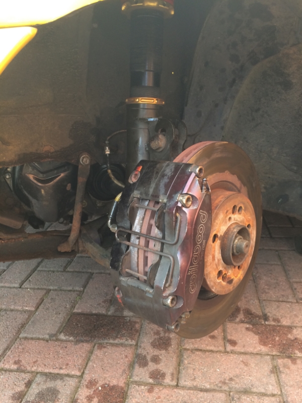

Brakes
Braided lines
Main front to rear lines routed through the car
Adjustable brake bias built into pedal box
Wilwood radial mount calipers and 295mm disks
Mintex F4R race compound pads
Altered handbrake location

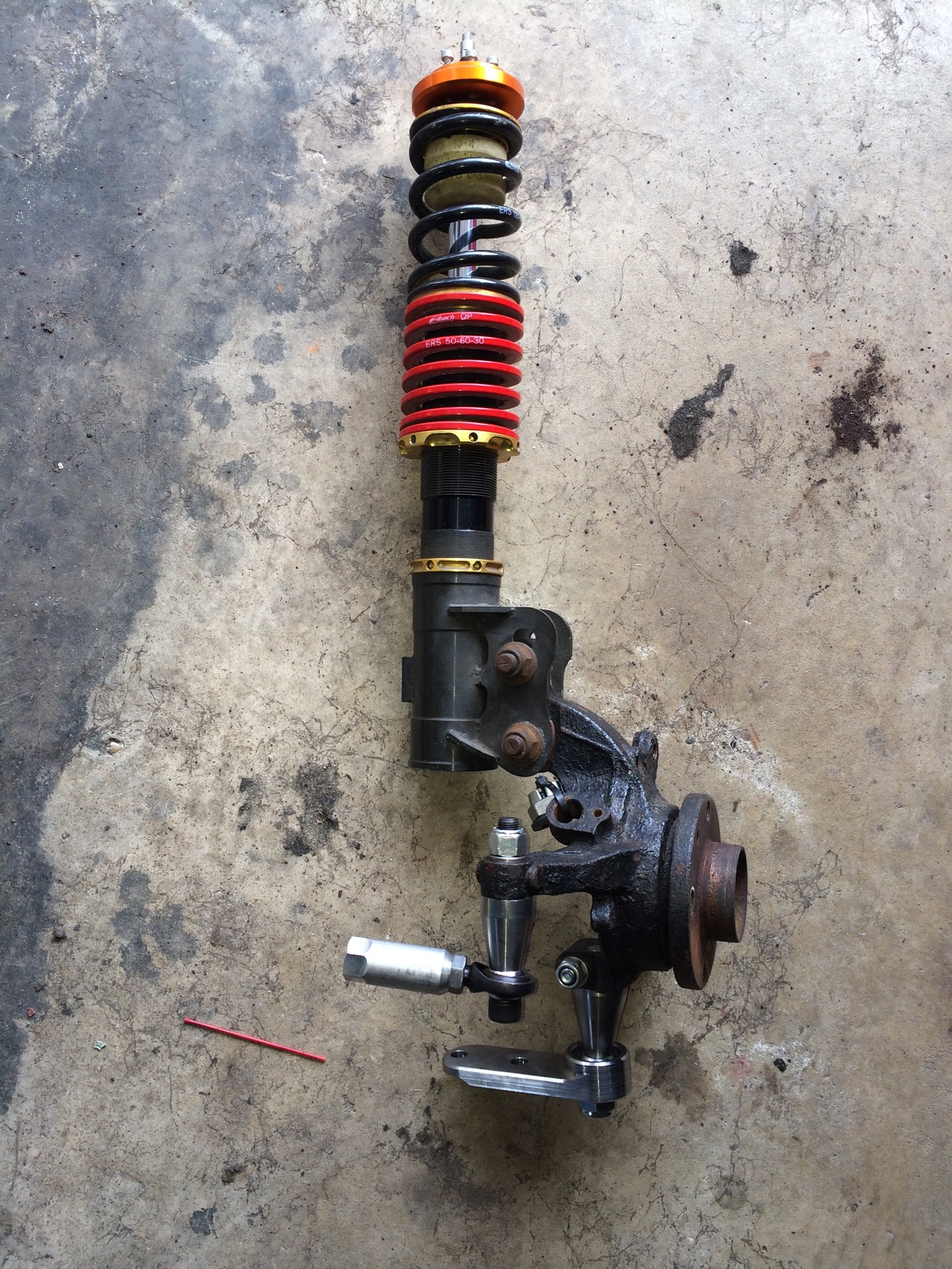

Suspension
AST gold top mounts
Custom Nitron R1 front coilovers
Roll centre correction kit with rose jointed bottom joints and track rod ends
Gaz adjustable rate rear shocks with rear torsion bar
Polyflexed 172 bottom arms
172 Hubs
