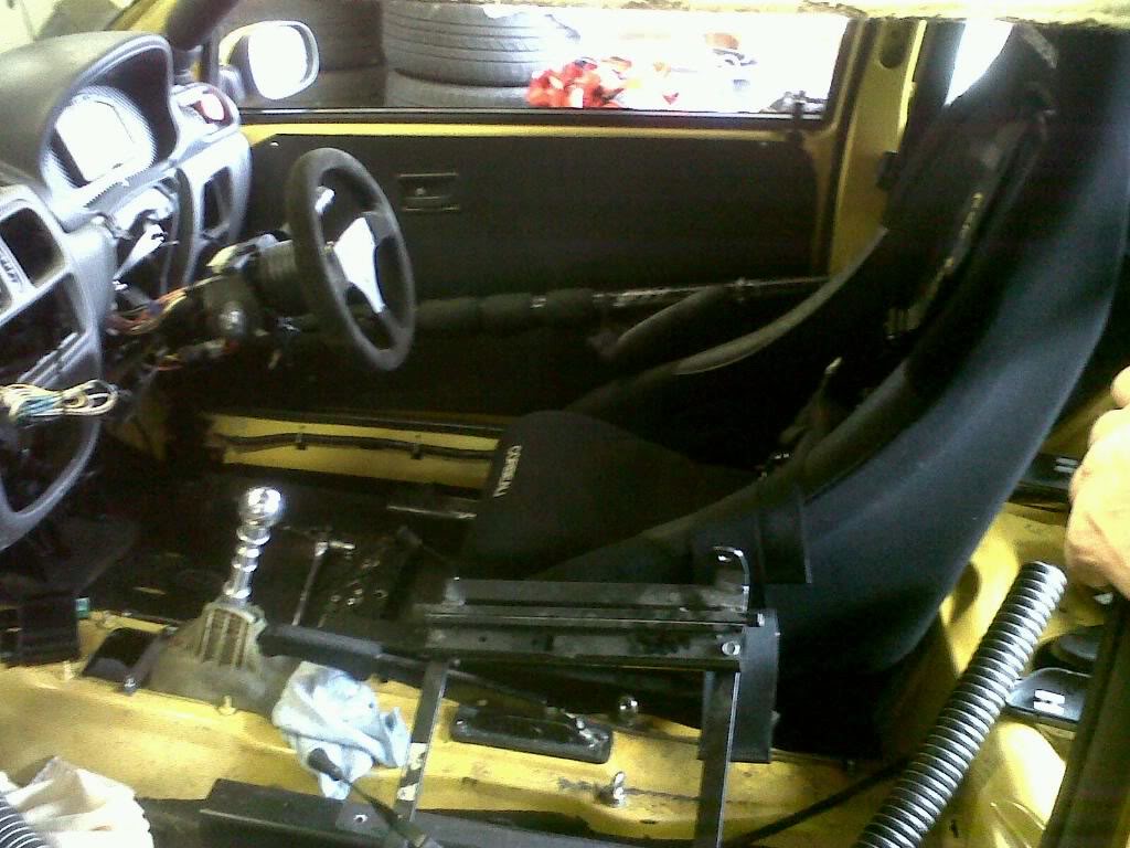

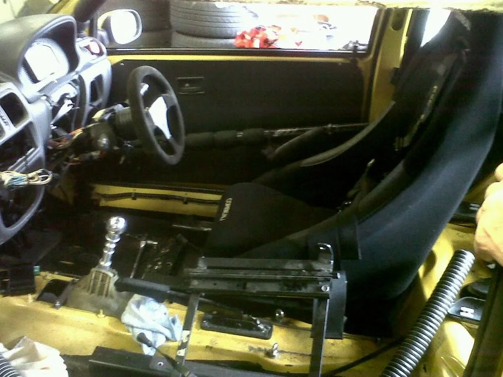

Made some progress this weekend but most of it was just stuff like wiring so not got pictures of that but got one showing the new driving position.
Have lowered the steering column down and have extended it and fitted a popoff boss for the wheel.
Also moved the gear lever back a few inches to keep it in the correct position relative to the steering wheel and seat.

The mrs tried it: "Feels more like sitting in an arcade machine than a car"
Was tempted to reply "Because racecar" lol
  182/RS2/ Turbo/Mk1
Yeah, if you compare it to the picture from earlier in the thread with the 172 clocks in a different clio, you can certainly spot the difference!
Probably halved the distance between the wheel and the gear lever TBH which can only help when driving it on track :)
Had also had to move the handbrake over to make room for where the gear lever sits as well, as it was going to hit it otherwise.

Too low? Just trying to visualise the driving position. Maybe it's the height of the original clocks that's deceiving things?
  182/RS2/ Turbo/Mk1
Too low for what?
I wouldn't want to parellel park it that's for sure as visibility is a bit worse sat that far back, but I see no downside on track really. You're not sat very low in the seat, my crash helmet is within a couple of inches of touching the roof still.

I know everyone has a different preference when it comes to a seating position but I was thinking more about the angle of your arms to the wheel. If you are still sat quite high does the wheel feel like its in your lap etc?
It was just an observation more than anything else Chip. Nice work with moving the gear lever back :)

Perhaps that picture is making it look even lower than it is just because I was holding my phone quite high when I took it (ie the phone was higher than the steering wheel) which is obviously causing a bit of a parallax error when looking at the picture etc.
I'll get a cheesy picture of me or the mrs sat in it at the weekend if I think of it when I am near the car mate, but because your legs are out so much straighter than normal it doesnt feel like the wheel is too low, its in front of your chest basically rather than in your lap.

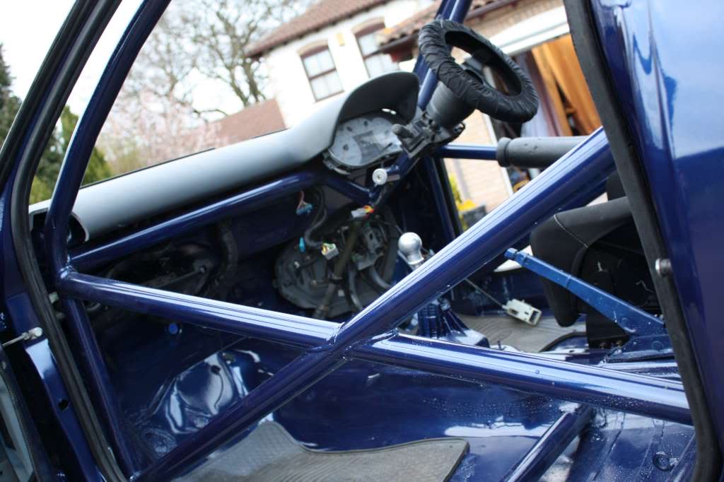

Sort of like this :
(although his legs when driving would be extended a little more than sat there relaxed like that so it looks closer to his legs than it will be when he is actually driving)
I can easily move it back up a bit though if I do find it feels too low when I get to drive it rather than at the moment where I can only sit in it and make brum brum noises, lol :)
  BMW 330ci sp/ 172Cup
^^now I like that driving position! I see what you are saying about the angle of the photo.

I think if anything he looks too close to the wheel, his elbows must be properly bent, but it obviously works well for him, lol, mind you it might just be cause he isnt strapped back in properly yet which would no doubt pull his shoulders back and so straighten his arms more.

Have altered the way that I have dropped the steering wheel down now so that its a fixed block on the mountings nearest to you and on the one further away its on two threaded sections with a nut above and below the brack which means I can loose the nuts off, move the column up or down and then tighten them up, not as easily adjustable as a proper movable column of course but at least it will allow me to tweak the driving position a bit.

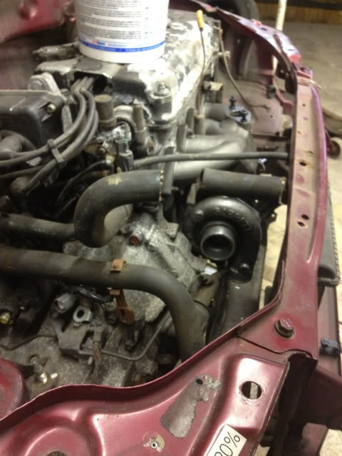

Yeah I have a spare frontend that I am doing the engine side of things in parallel with developing the car itself.
The ECU I am running on the cammed williams lump in it currently is the same one that I will be using the honda engine, so it means I can get the dash and wheel speed sensors and all that side of things all up and running with the current engine properly and then no that it will all just work when I swap to the honda one.
So im sort of doing it in 2 halves, one just for the mechanical changes to accomodate the honda engine, and one for the rest of the car.
This is the engine currently in the spare front end I am using for mocking up that side of things:
