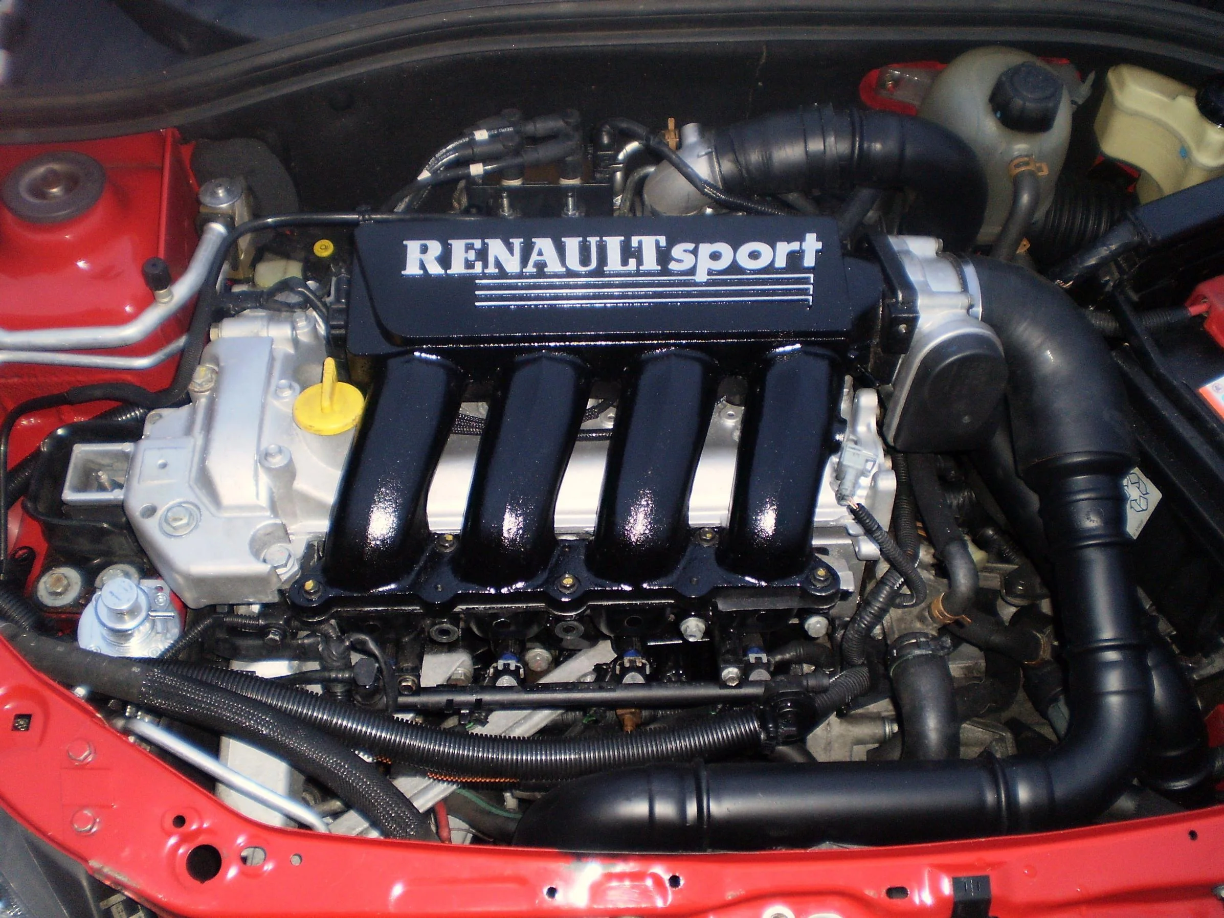

Hi,what pictures do you need? The car itself is a totally mint standard looking trophy, not even a stone chip dent mark as the car has only coversd 30k , you can' t even tell that there is an intercooler up front as it is all in matt black, the only indication is the exhaust, not even a dump valve as the megane turbo unit has a re circulating valve on the turbo, when the car is finished I will upload any pictures or information any one wants, thanks daz

  Turbo Trophy Evo 8,
Hi as requested
ATTACH=CONFIG]59944[/ATTACH]
